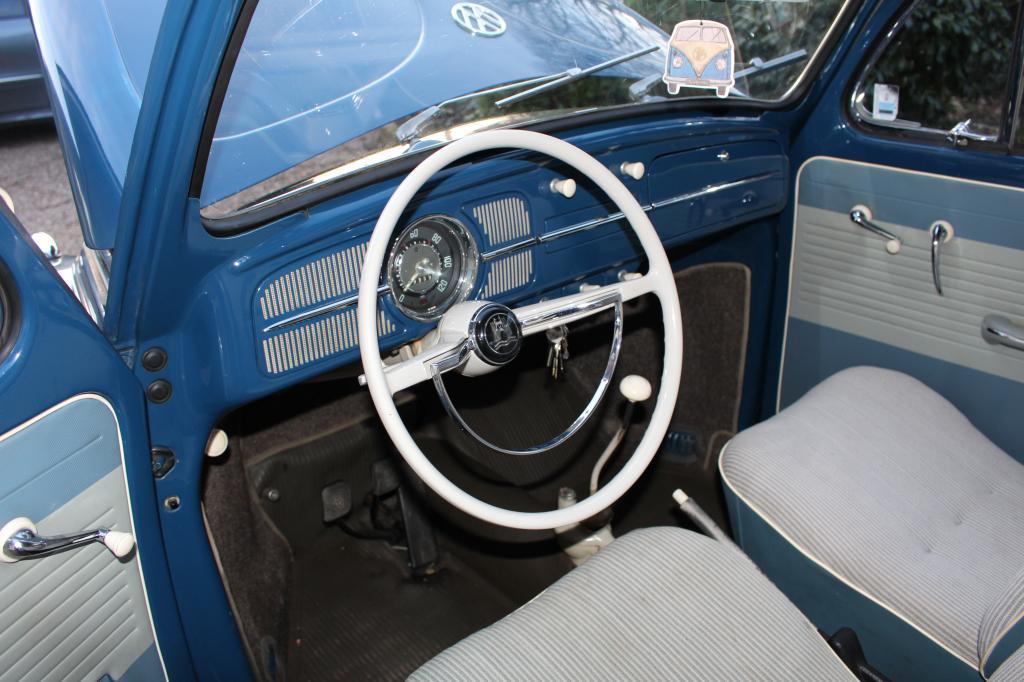

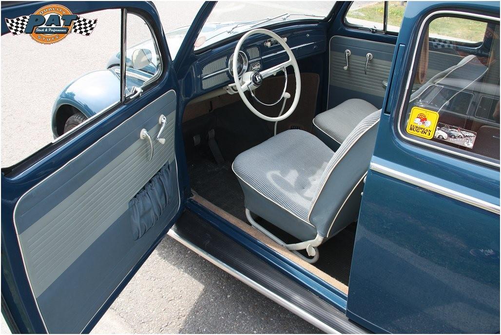

Here's a photo I grabbed off the internet.
White steering wheel,
Black mats,
White column,
White gearshift and brake lever,
White frames,
And I don't think 1960 models had grab handles.

That's a good start. Wish I could see the column better.

Is that white or Silver beige?

I would assume silver beige.

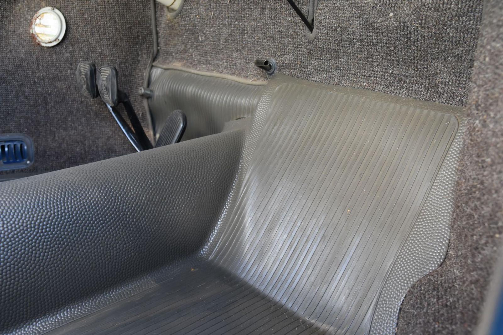

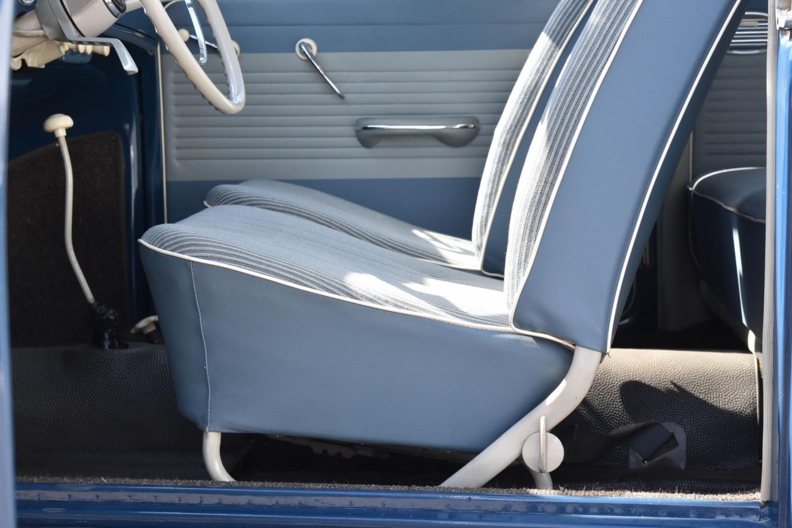

Here's a few photos where you can see the column and shifter better.

steering column, gear shift ,hand brake lever, steering wheel and turn switch, seat frames, rear support bar- all L 471 stone beige on the deluxe models
gray floor mats and rear seat kick panels
no factory installed grab handle

GREAT INFO GUYS! Thank you! Both of those bugs posted have different steering wheels. Which is the correct one? The half circle horn bar or the straight one?

straight one is just broken

Crap. Looks like I will need to get a new steering wheel.

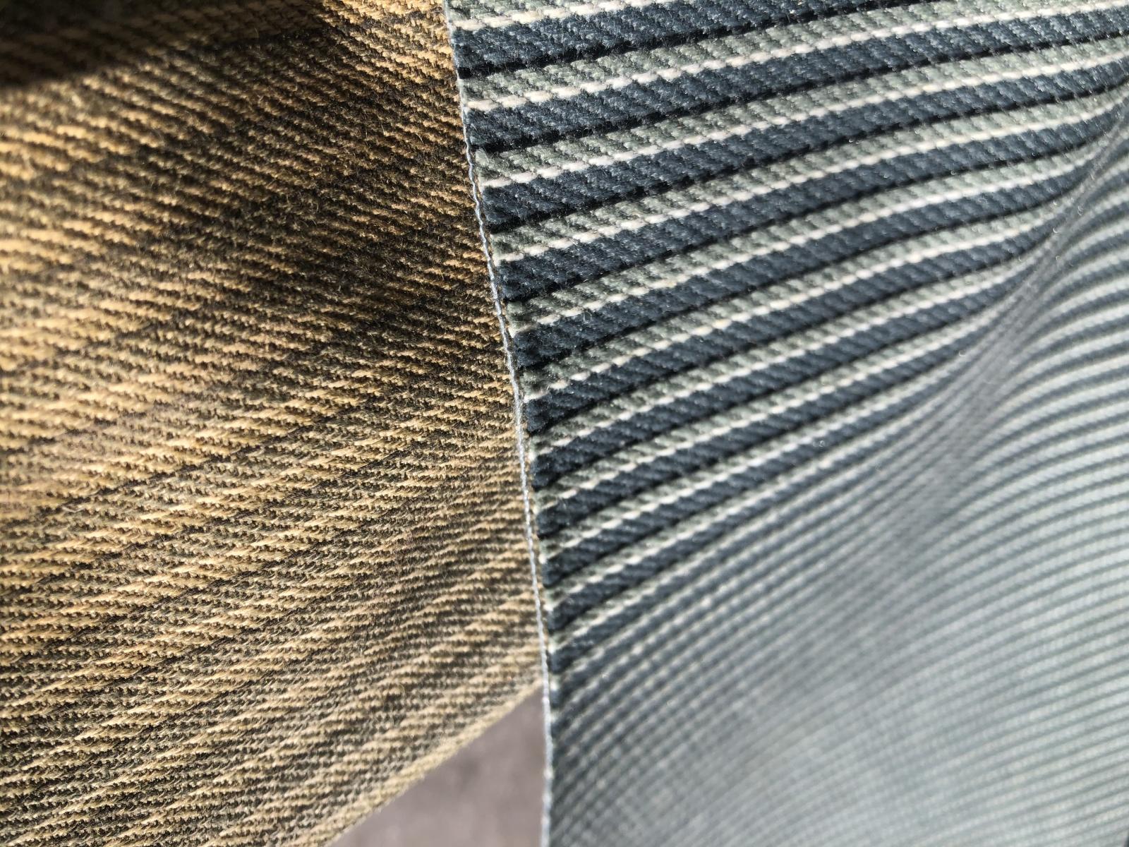

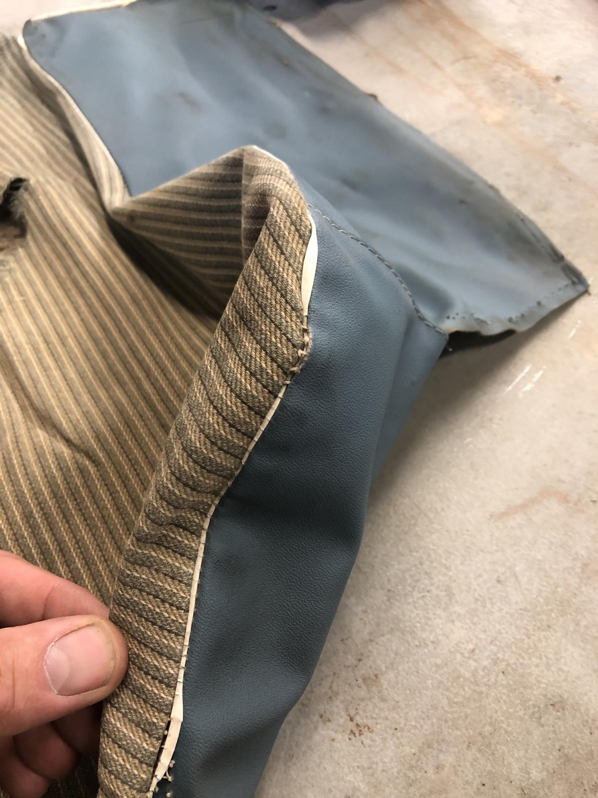

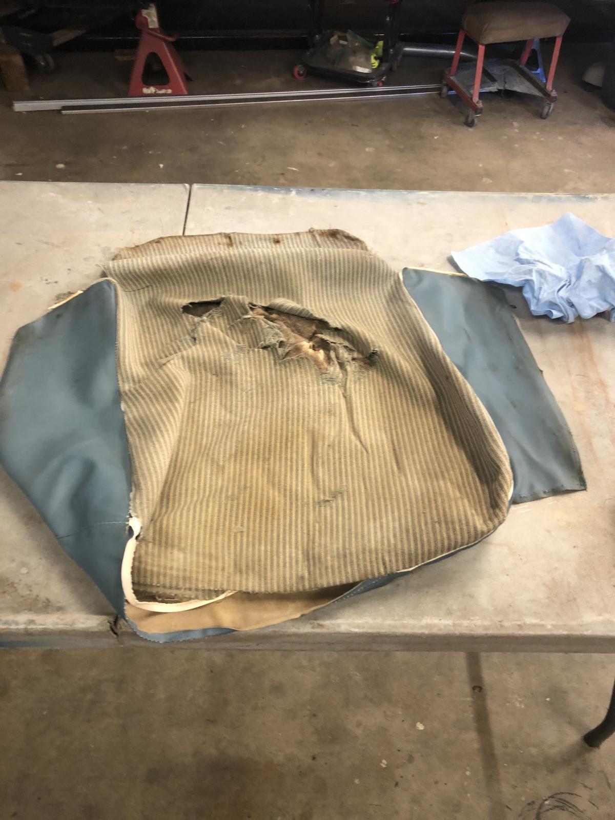

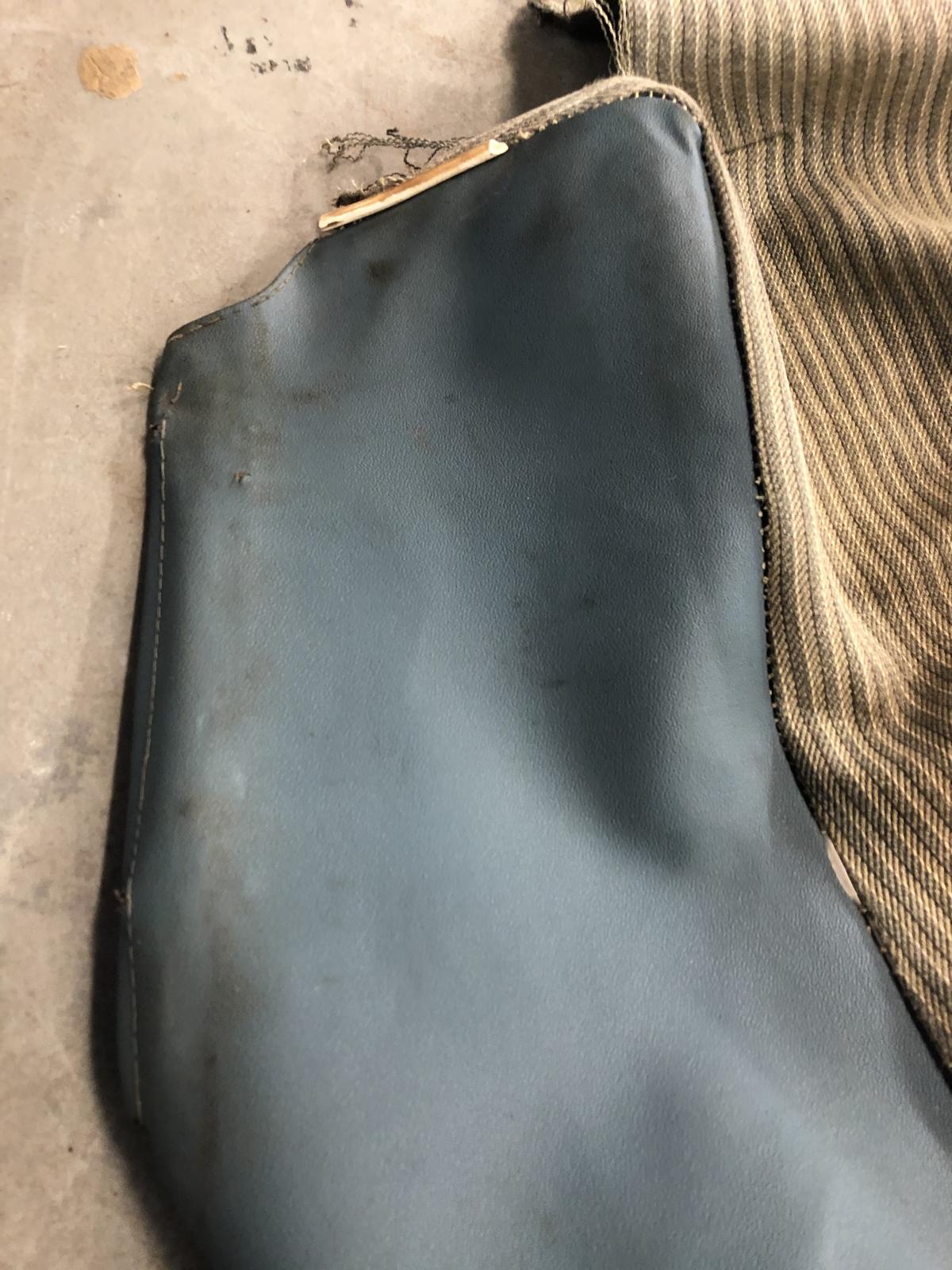

My daughters Indigo ragtop had the stripped wool interior. I found a source for it in Germany, so for the mere price of $165 a square meter....feast your eyes....
It is an exact match. Must be the OEM supplier...amazing.

How many meters is it going to take to do the whole interior?

I bought 4, should be plenty. I did my sons with 8yds of vinyl, so the plan was 4 of this and 4 of the blue
