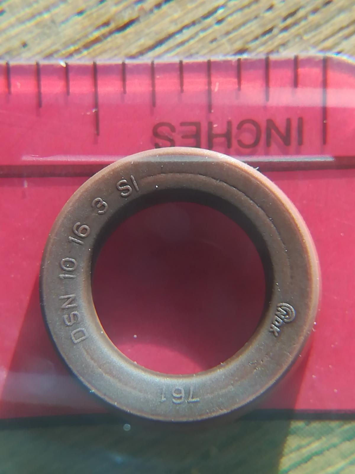

I'm looking for a rubber metric oil seal 10mm ID X 16mm OD x 3mm Height. Its for the shaft in a butterfly valve. SVX actually. I've tried but I can't find this seal. Can you help me locate this seal?
From my other post: I'm looking for the axial shaft seal for the IRIS valve. I think this seal is the source of the oil pooling on top of the engine. If you have replaced this seal, where did you buy it?
SVX Inductive Butterfly valve under intake manifold:
NEED THIS SEAL:

Thanks for the lead, but they did not have this seal. Any SVX owners ever replace this seal, its leaking oil onto the top of the engine.

Thanks for the link to the part. Subaru thinks this is one part, the VALVE ASSEMBLY-INTAKE CONTROL and wants $270. The seal needed should be like $5. I have a new PCV valve but looking the system over is a good idea and I will.

I've ordered a similar seal 10x16x4, harder material than original. The good news, Isaac at The Seal Connection in San Leandro, CA said he can make the seal, yes make new seals. About $75 for 10 seals. I share this because it was news to me that a local supplier had the ability to manufacture seals.

just order a set of 3, it was the minimum order, I only need one, sell you one of my spares for $5.00 shipped.
Please clarify, did you get the original rubber 10x16x3 or the more available 10x16x4. I'll buy your extra 10x16x3 rubber seal. Where did you find this seal?
