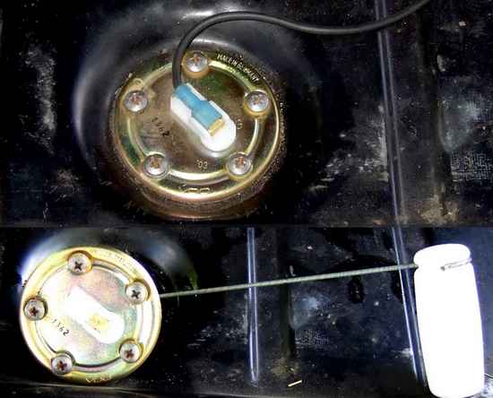

I also bought a new VDO 68-77 Bug sending unit, mostly just to have in my parts box for now. I notice the stampings on it are different than the last one I got a few years ago. I just checked the resistance, it was about 78 ohms at the bottom, and about 8 ohms at the top. However the top is higher than the gauge can ever reach installed, it rises above the plain of the mounting flange. When it's about even with the mounting flange it was around 20 ohms.
FYI, here's a comparison photo between these two VDO tank units, the one I got several years ago for my Baja on the left, the new one on the right.
