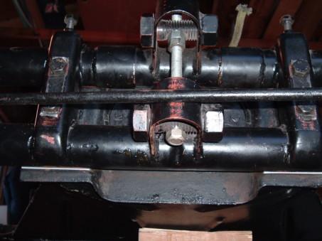

OK so...I am temporarily trying to put in an old school select a drop beam in my 64. I got this thing way back and am planning on lowering the original beam with proper adjustors and narrow it a bit while I'm at it. While I save up the cash to get the parts and a good welder to do it for me I thought I would put this in to get her on the road.
However I bought this thing so far back I can't remember the order the nuts and spacers go on. Help!
Also wondering if that bottom nut should be tacked to the threaded rod. Would hate to lose it during a ride. It also seems that the lower horizontal bolt ( the 1' one) is threaded. I assume that all I do to adjust the ride height is turn the bottom nut?
