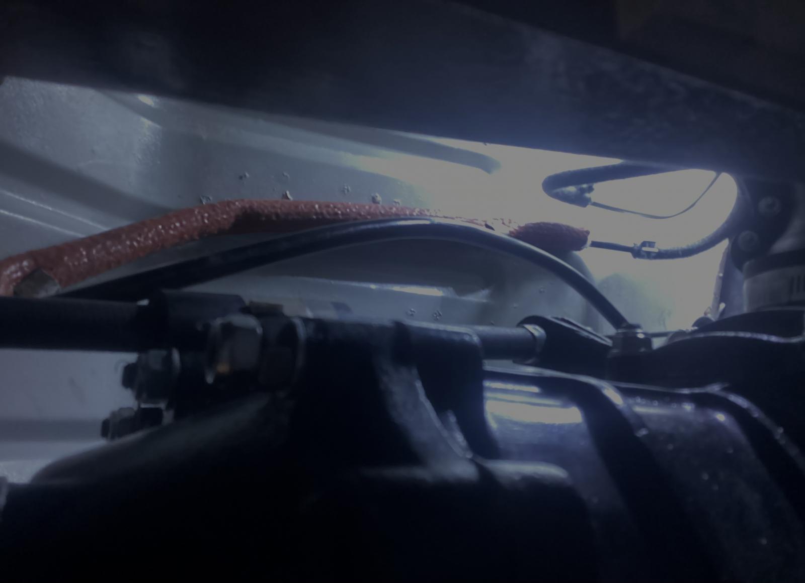

Hey BarryL, the weeping seems to have stopped
But it could also be due to the box being drained. We’ll see when I refill it in a day or two. Brake m/c still has a drip.
I could remove and tape, but I am not a fan of Teflon tape bits clogging brake ports. Not sure if more brake paste would help.

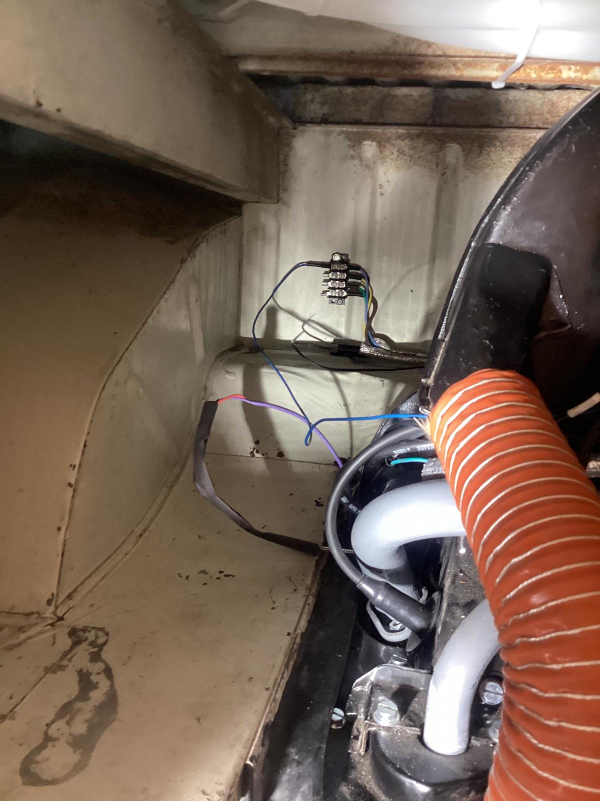

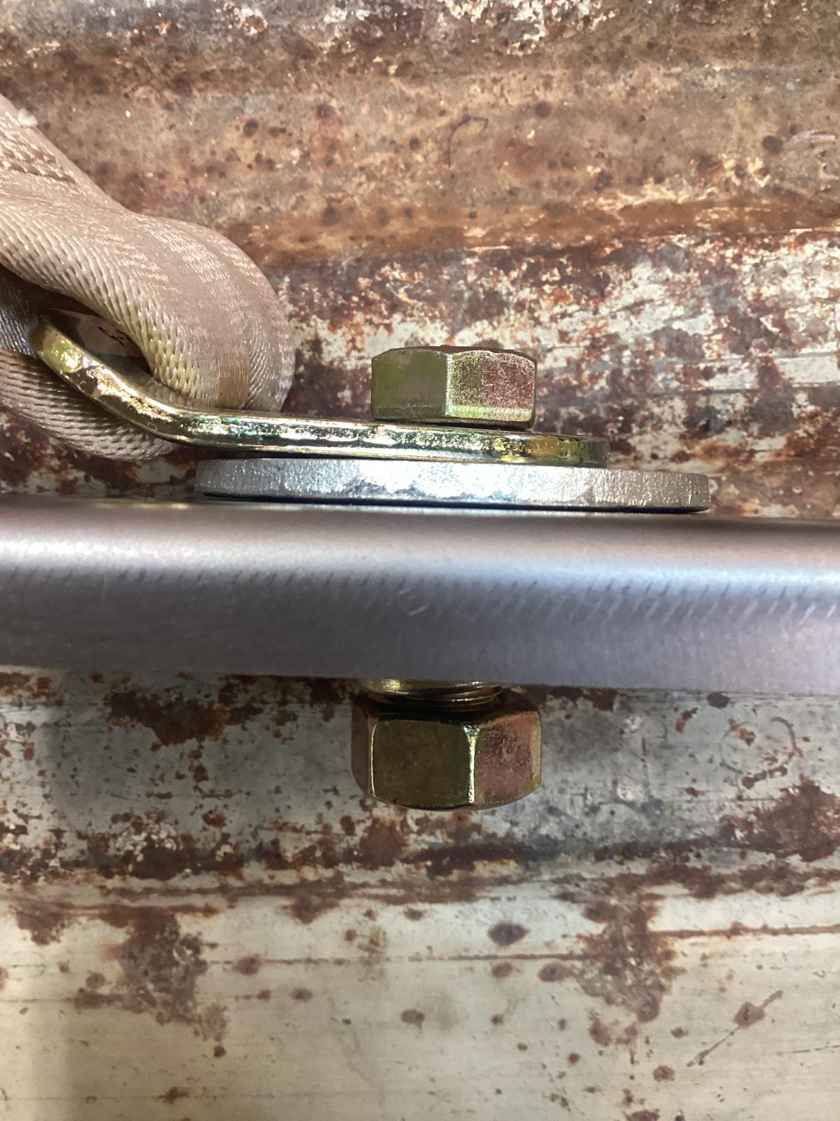

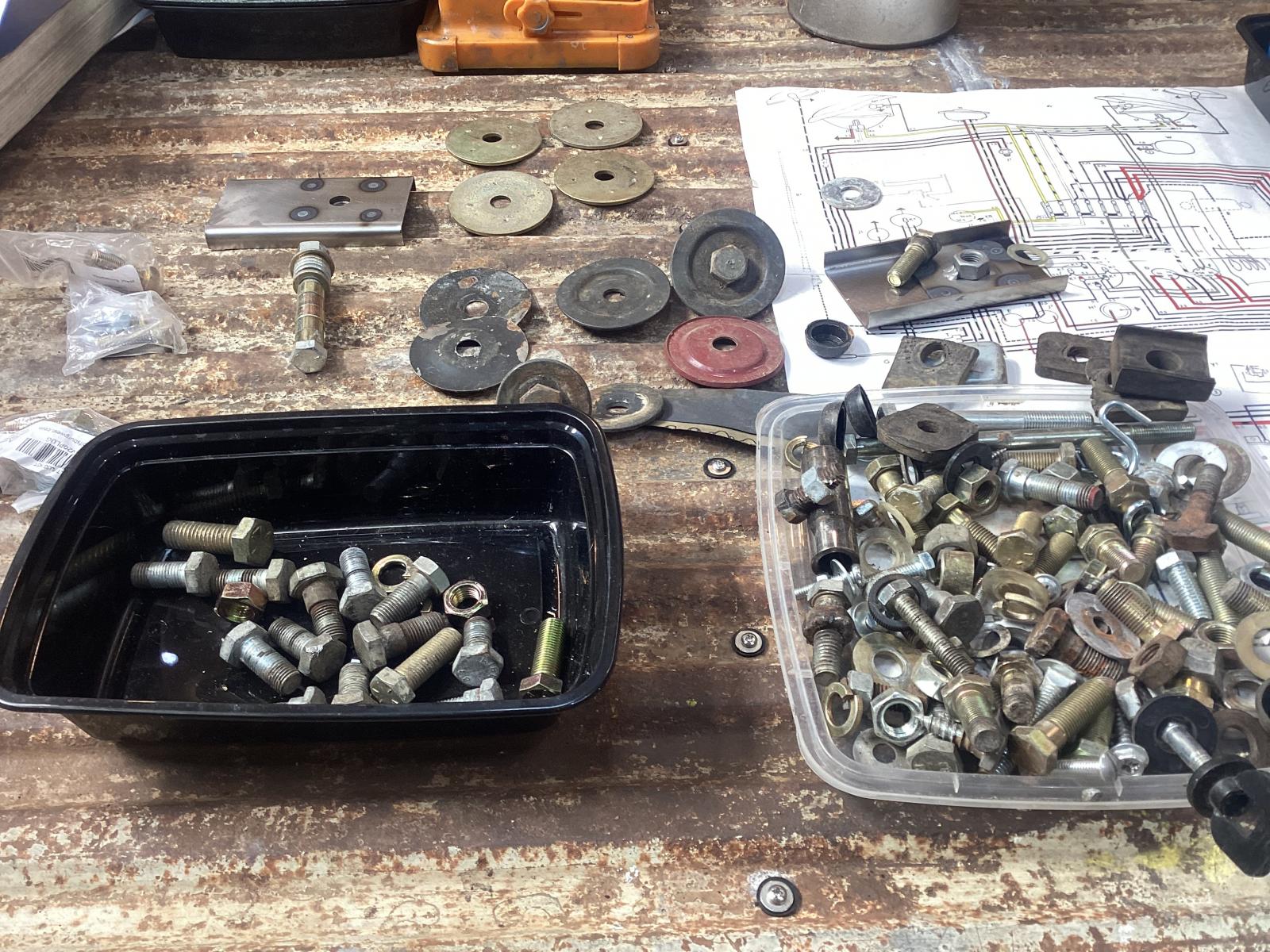

Thanks to Tony I was able to put the reserve tap assembly together. I don’t have a welder so used a big sheet metal screw; I’ll add another to keep it from twisting. I suppose I could also use body epoxy for belts N suspenders.
For now I used the factory clamp from my Deluxe reserve bracket, but I noticed the side mirror clamp is nearly the same; I’ll try one of those so I can keep the VW Deluxe tap intact for the next person.
It isn’t perfect; not only is the tank opening a bit out of place, so is the hole for the cable. This makes the cable have an angle relative to the reserve arm. Sometimes the knob in the cab doesn’t always seat… but I gather that happens sometimes anyways. Anyone who has a factory setup is free to offer tips. Next step is to test where ‘off’ at the arm leaves the knob assembly in cab and mark it.
I have dozens of non-factory holes in the truck - kind of liberating, as not so much trauma adding more! - and I think I figured out a few:

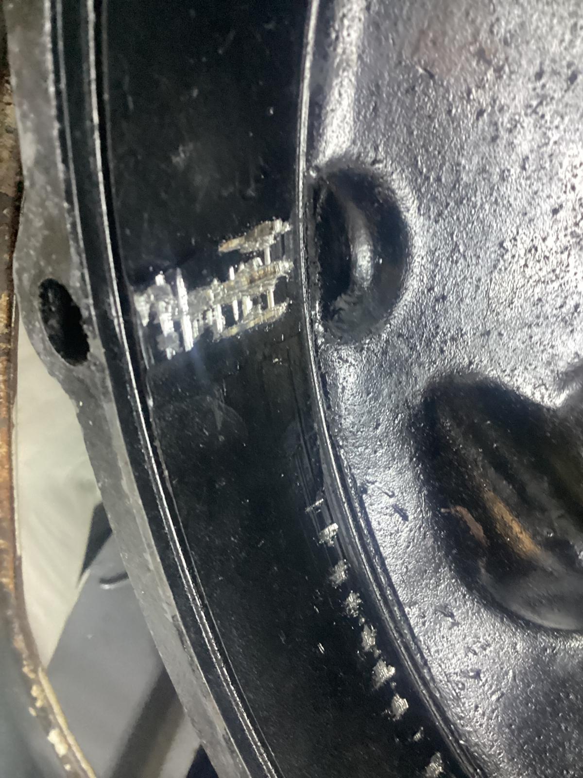

First off, the bellhousing is not clearances even though it seemed to have been
See https://www.thesamba.com/vw/forum/viewtopic.php?p=10212696#10212696
Sample
Funniest thing is that it only scraped in a few places when spinning motor and seemed to get better as motor went in( I was thinking maybe engine was tilted a bit, causing rubbing on low side) but when fully mated the motor would NOT budge.
But I didn’t know that for a while. First hour was spent getting motor onto input shaft; I assume the split motor compartment is a touch smaller than a bay? I do have an aluminum case and a FI fan housing, but still…

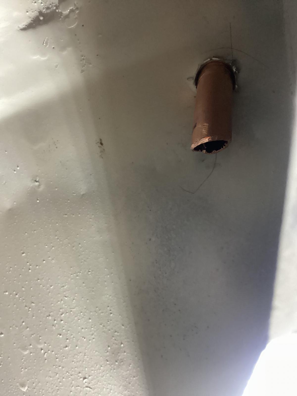

Orange stuff over gas line is fireproof but I’m using it mostly to prevent metal line rubbing

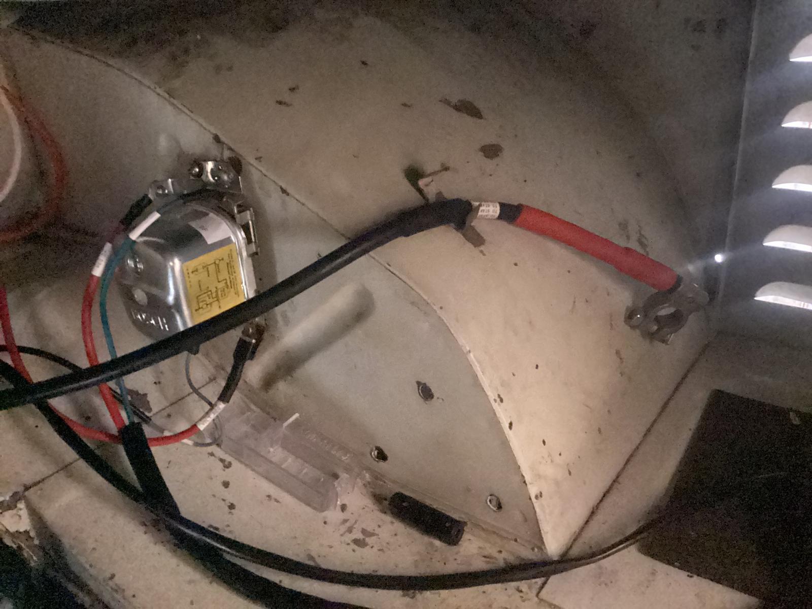

Am rethinking the positive cable. Stock from WW, but stiff as a pipe; it can’t have too many strands in it. This is bad, because the terminals on my battery are both on one side. I can get it to work, but will be stressed.
I am stressed enough; my positive cable should be relaxed and flexible.

Realized my wrench was never going to be able to turn motor enough to scrape out bellhousing, and I ain’t using the newly-rebuilt starter for it, so decided to pull engine. Which was stuck but good and took another hour to get out of bellhousing.

Using files at first to take down the upper bosses, I was able to get engine in and slowly tighten bolts as I rotated engine with wrench; took about 3 hours, but got it down to where there is only a slight scrape at one spot. Motor is out, and I'll dress spots with files a bit more, but I think the first startup should hone that small scrape right out.
It's possible the aluminum engine case is made just enough out-of-spec to hold the fw a teenyth of a mm different and rub and the stock cases would not have. Or maybe the fw is just a hair wider and deeper at teeth. Or it isn't on crank right and will wobble off the first hundred miles; who knows? I trust the shop, but with this truck Murphy is the driver. Might have to change its name.

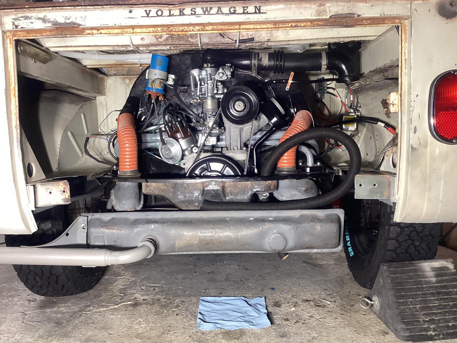

Put the engine in. Turns with no scraping on tranny so that’s good. Put the electrics on; WW harness didn’t include the wire from generator screw to regulator so I added one. Hope that screws the correct one - it goes to body ground.
Attached tach wire and Cht harness. Not happy with setup but will do for now.

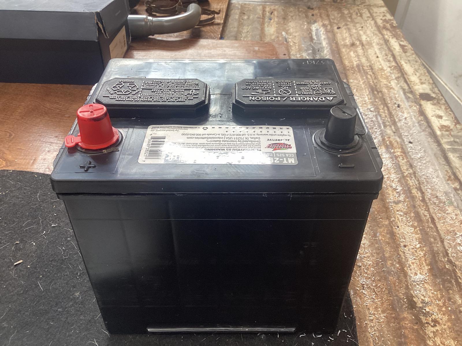

Battery in. Not hooking up just yet.
Since my fan shroud is from a fuel injected motor, it lacks some clips; that weird metal bit will do until I find a proper one.

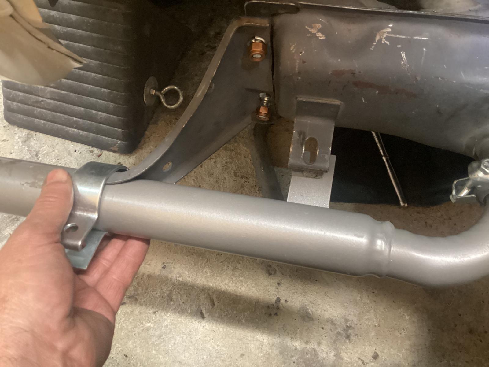

Hmmm. Tailpipe will need some work. Do I bend tab on muffler or tab on tailpipe?
Everything but heater cables (no levers) and air cleaner in; cleaner preheat needs kludging to make one.
Need to: fix tailpipe anlignment. adjust clutch. Adjust Accel cable. Adjust brakes and e-brakes. Put gas in tank and check for leaks. Connect battery. Cross fingers. Turn key.

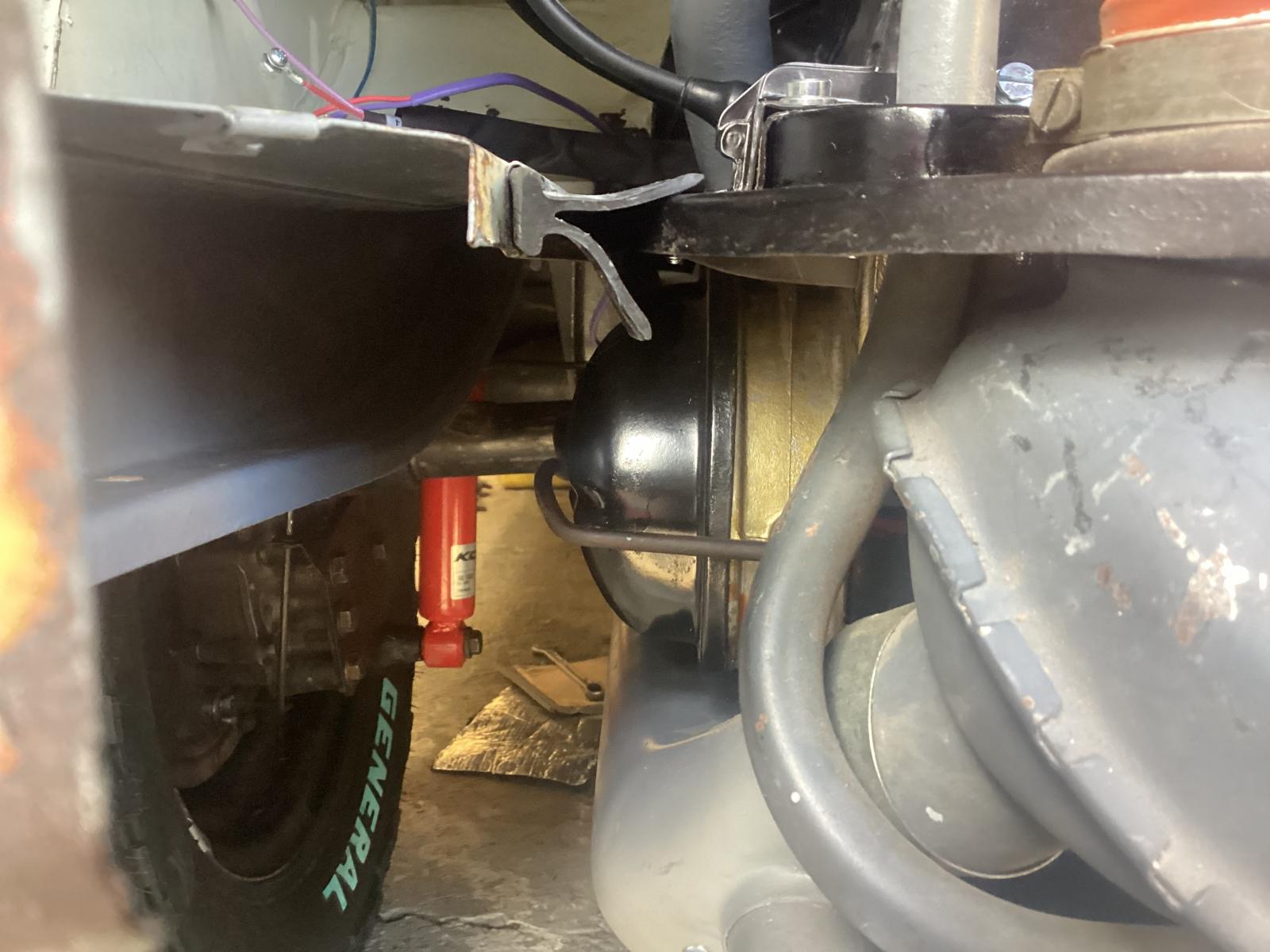

Got the driver rear wheel mostly adjusted - I hear some drag on a half- turn that I think is the Ebrake cables fault as it comes and goes. Or uncentered shoes. Went to pass side and my Jack apparently blew its seal as it won’t stay up now. Hard to even slip a stand under the car since you need to pump continuously. :p. Another chore for tomorrow…

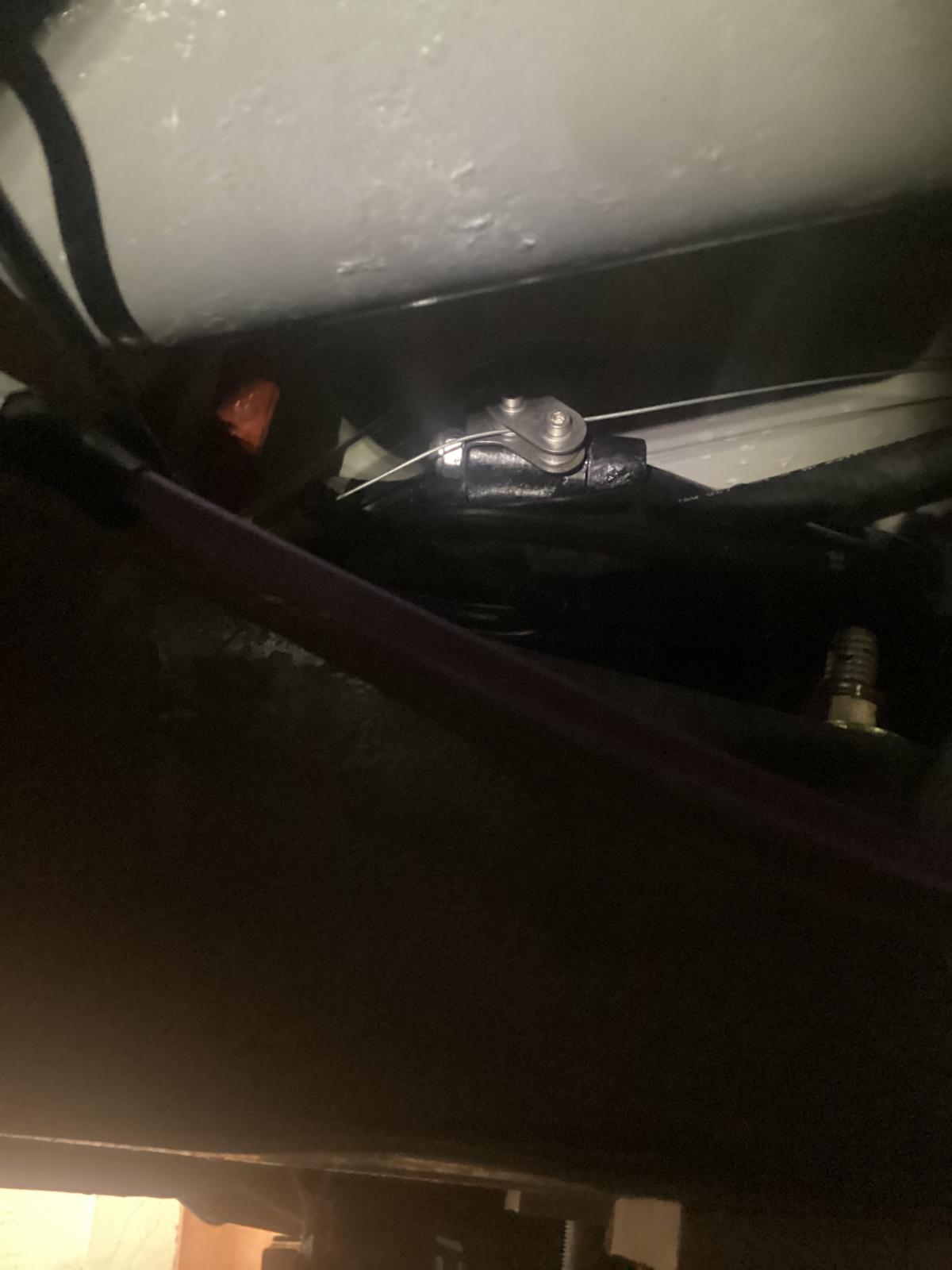

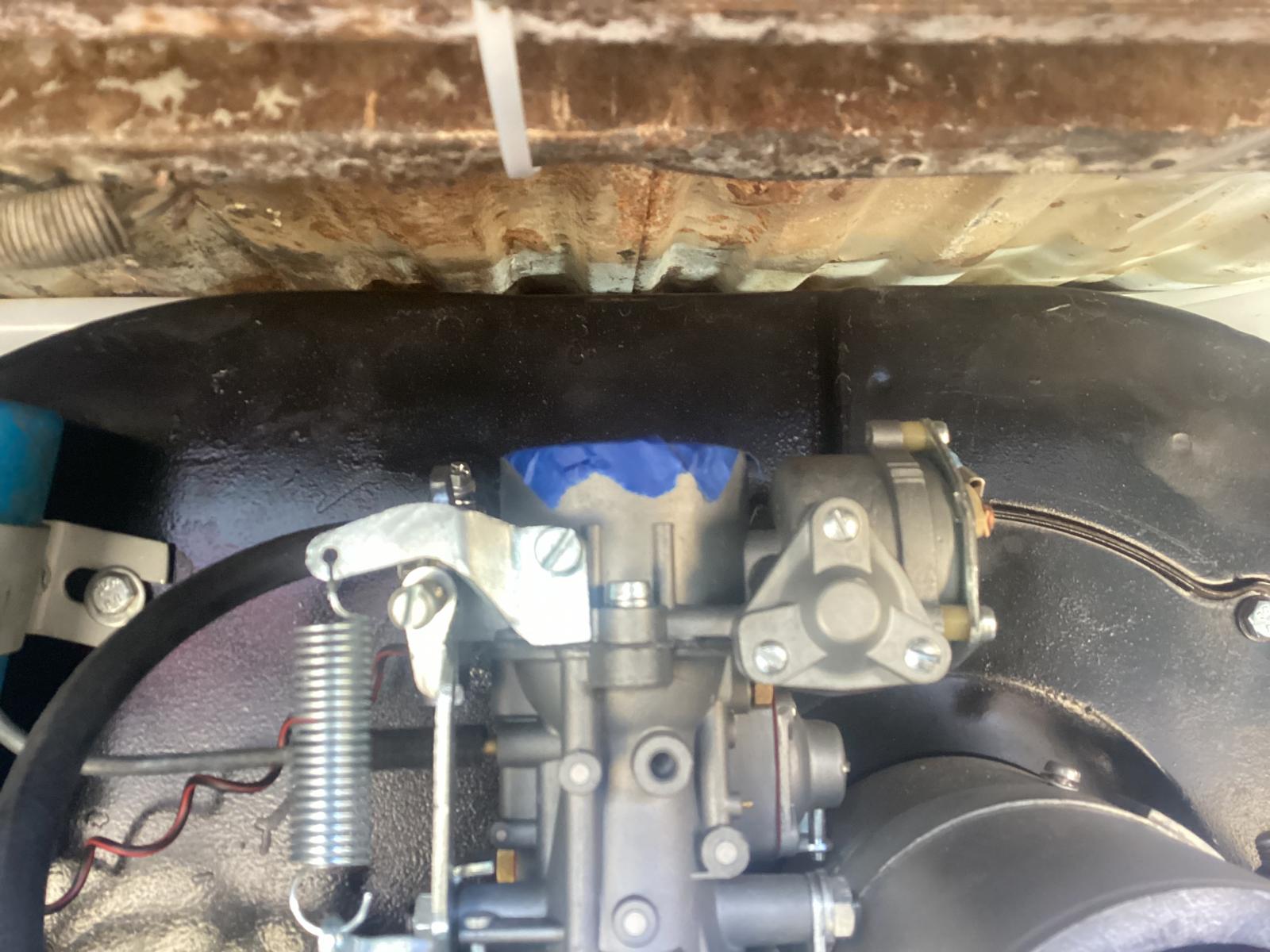

Which didn’t happen, because the Accel cable is too long,despite being the proper one for the bus. Getting it anywhere near adjusted for proper pedal position puts the end so far past the arm that it catches the perpendicular section on arm and stops. Further and you are past the ferrule and on the cable, so even trimming cable end isn’t quite the solution. I have a Buttys Bits linkage and the trans rollers (in place of Bowden tube) and was worried they would make the cable too short! I suppose the linkage could extend farther rearward than stock, but I hadn’t heard of others mentioning it. I need to pull and measure, then check stash for other options to try…
Tailpipe does not fit properly, as the muffler tab and pipe tab are separated by a good 3/4” when gasket and support arm are in proper place. May just use nuts for spacers and say the hell with it.

Sorted out carb issues - put 'proper' arm back on, and filed down bottom of clamp a bit; swapped position of Butty's Bits roller and bent frame tube upwards a tad. Cable is still too long by a good inch, but at least the angle made by accel cable by trans is better, and carb and pedal are functional.

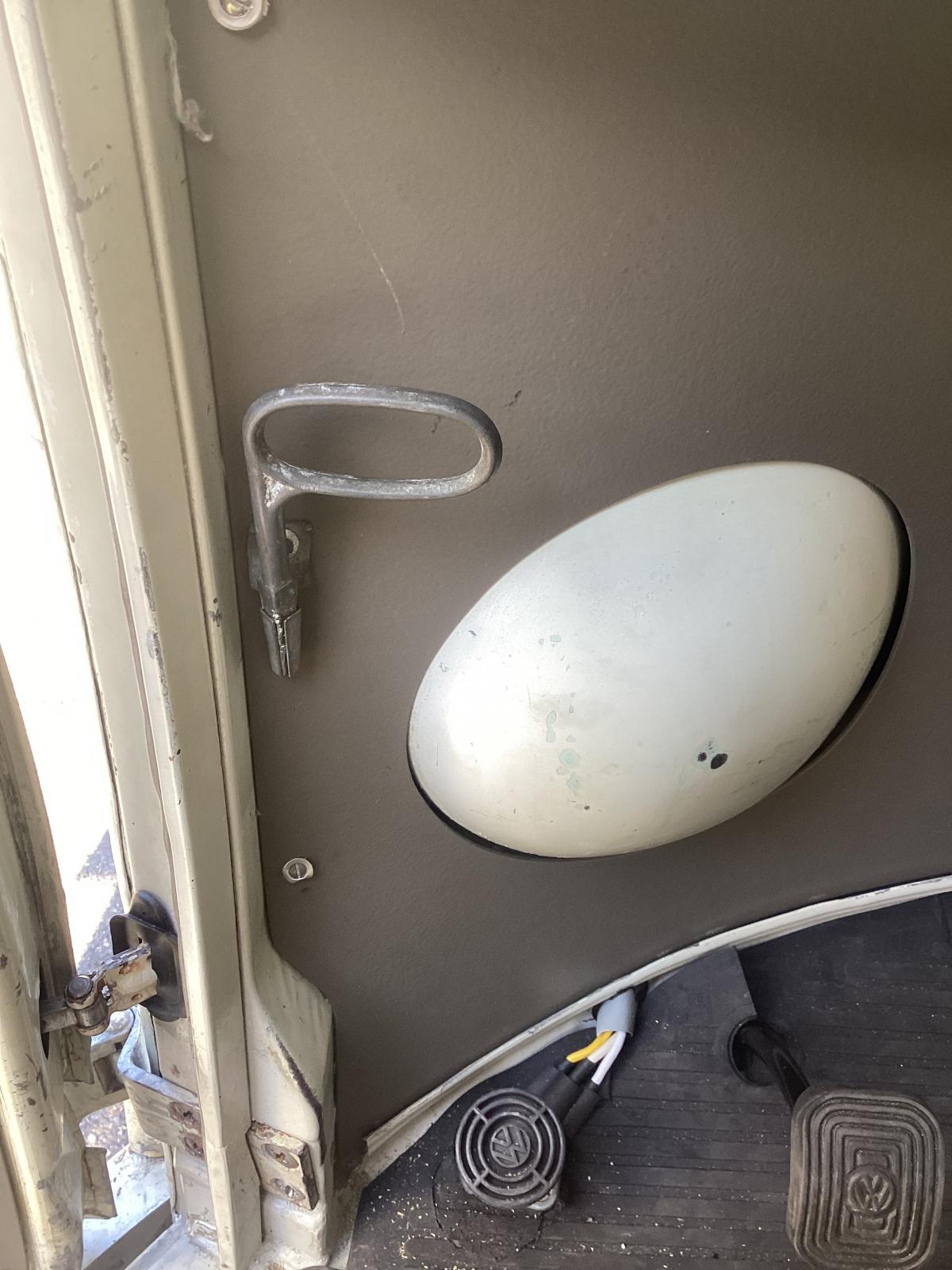

Nice mirror from campingbox - mine was tinny-lookin' repro. But what is the hole in the arm for? I assume aftermarket stuff or am i missing a piece?

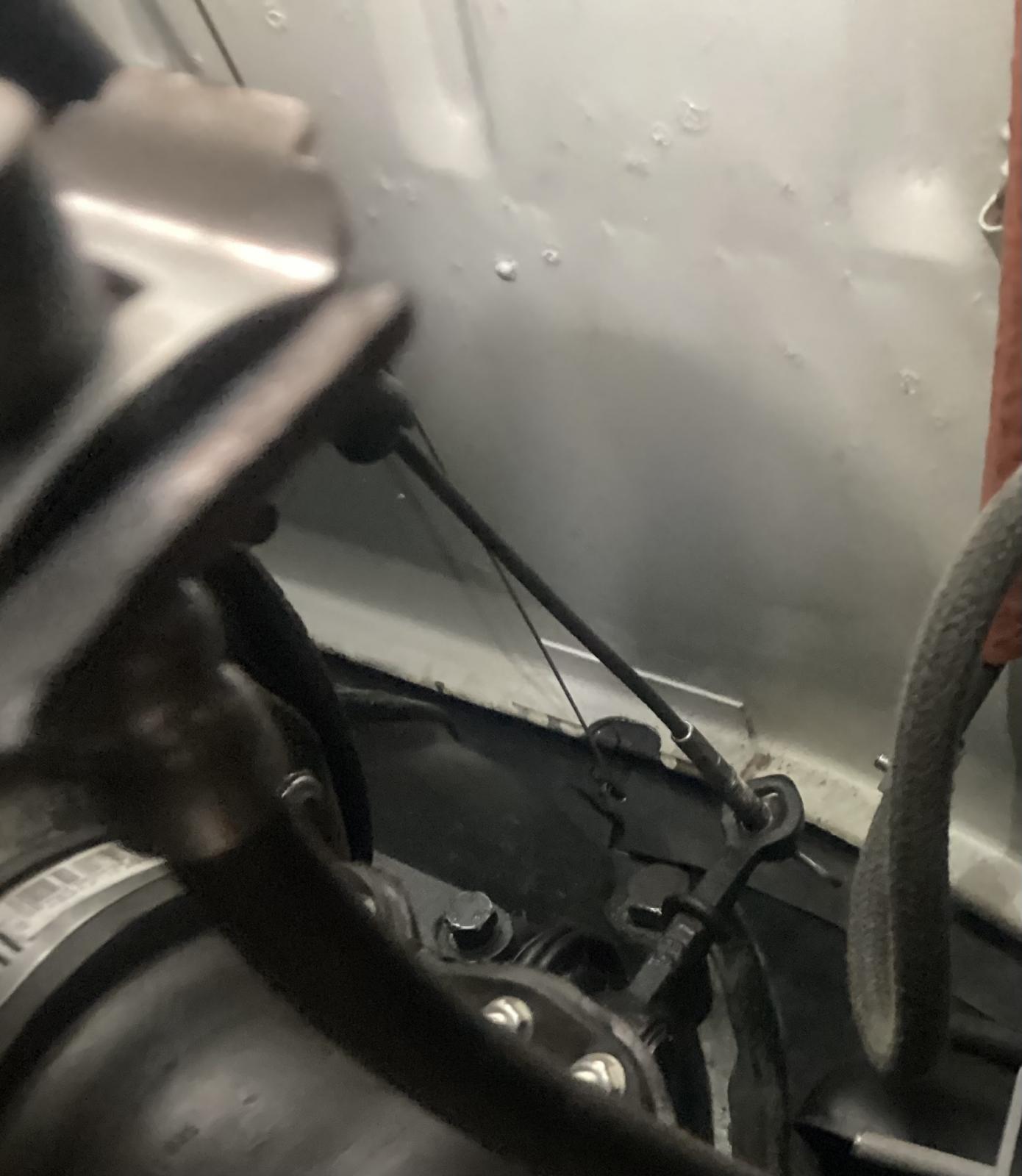

My understanding is that if you're going to use a clip to hold the tube which goes through the fan shroud in place, you put it on the forward side of the shroud (closest to the front of the vehicle).
The accelerator cable bowden tube (the flexible sheath) should terminate against the foremost end of that tube (closest to the front of the vehicle) and moving the tube in and out therefore adjusts how much the inner cable projects rearward from the shroud.
If your cable is projecting too far, you need to shift the end of the bowden tube forward (further away from the front side of the shroud).
Normally you'd do that by pushing the metal tube that goes through the shroud further forward, but with that jubliee clip on the rearward side you're limited how far you can do that by the thickness of that clip.
If you shift the clip round to the front of the shroud and pull the metal tube further forward, then secure it in place it'll effectively 'shorten' the cable by that distance.
If that still isn't enough to make the cable the right length to marry up with your carb, you could try fabricating a longer metal tube, so the bowden tube terminates even further forward.

Thank you for that succinct description! That's great insight to how the Bowden tube performs.
I have a number of variables from stock on this setup, the frst being a Fuel Injection fan shroud from a late Beetle (best airflow setup). I had to drill a hole for the accel tube through it which may not be perfect;ly positioned , and the local shop suggested I secure it fore and aft - which I had done on the last motor I ran it on. And I am attempting to make the best results using the cable, the tube, and a set of rollers to keep the cable off the trans case and in a consistent position rather than the flexible sheath.
The Buttys Bits accel pedal assembly adds a portion of that extra length, and the lack of 'proper' Bowden/fan shroud tube adds more, but I do see others running without 'correct' parts so it can be done. Just a matter or trial and error - in my case, mostly error! I think the 1/2 shorter cable will take enough off the total to allow a better position for throttle response, and future adjustments for stretching.
The longer tube is an idea to explore as well; I do have a billet version that is slightly adjustable as well. And an extra FI shroud for better positioning next time I drill! And yes, trying a Bowden tube is a good idea once I get the damn thing going. I do know the one I have is too long (24") and hate to cut old parts. Will get a repro to experiment with.

Measured Buttys bits Accel setup and it’s a few mm difference from stock, but negligible as far as the extra cable length at carb end. As long as I can get a good throttle response…. I have a shorter cable just in case.

Brakes were terrifying, so I adjusted them a bit more today. I’d rather have drag than not stopping! Both switches on the m/c were weeping, so I put teflon tape on against my better judgement. Need to bleed again…

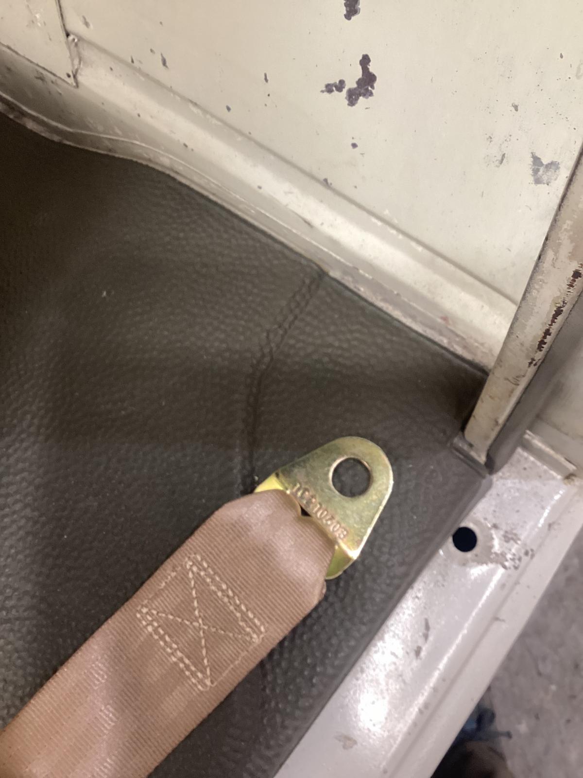

Bus did not come with seatbelts, but those ‘aviation’ style belts were added at some point. For now, I am just replacing in kind, with the addition of some plates over the doglegs that really need welded in or properly impact-epoxied. Soon. Meantime, here’s the setup. Had lots of hardware to choose from. Probably don’t need the double nut.

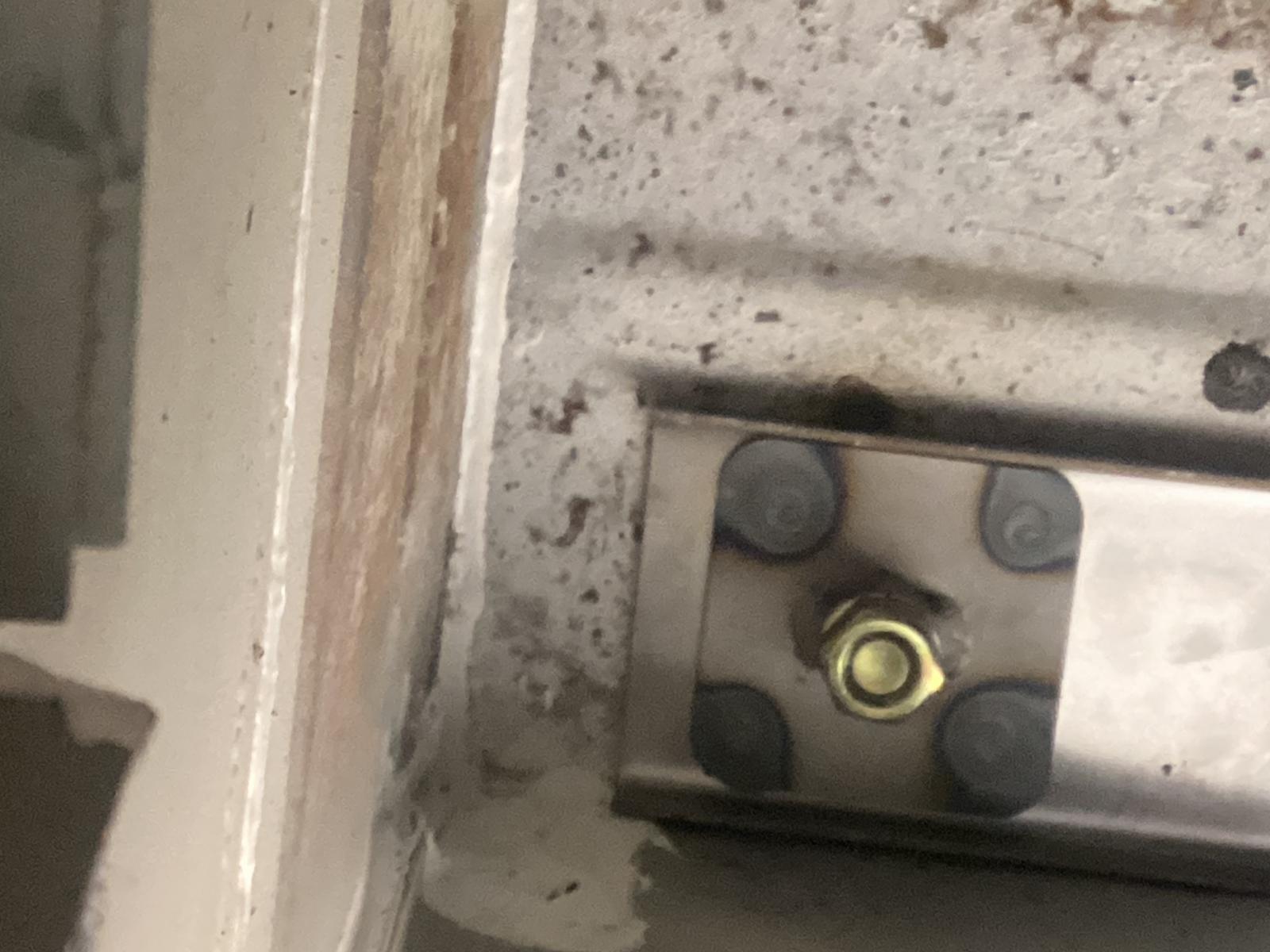

I have slats, but not ready for them yet. I debate doing the Rivnut thing. Glideking used 6mm; any reason not to use smaller? Meantime, to keep some rain out, I put in small screws, 2 rubber washers, 2 steel washers, and a nut in each hole. Contortions galore.

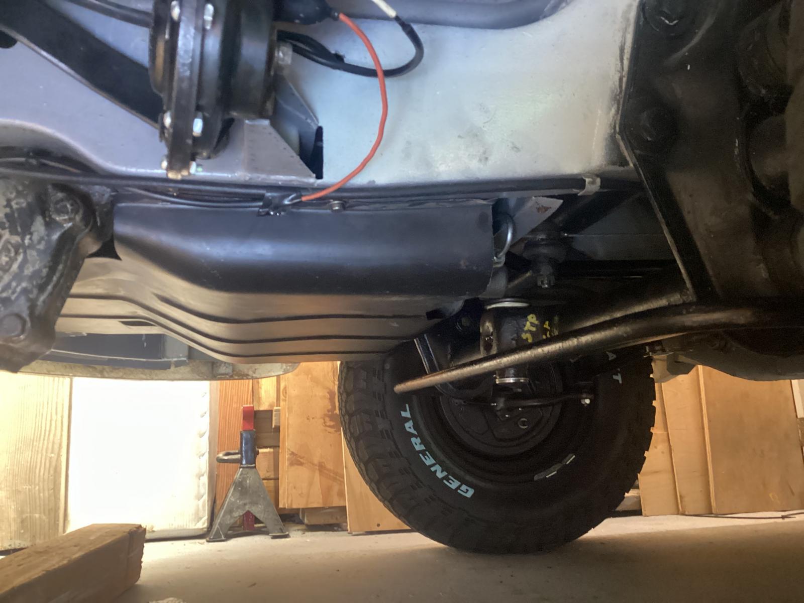

A little maintenenace; this is why I bought the Assistent. I can actually open the doors out here to work on them!

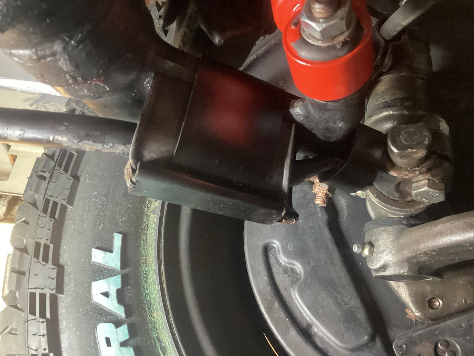

Minor bumper issues; the left bracket is mangled (right as well but less) and it's a little tight and droopy back here.
Couldn't fit my homemade light bracket in the space

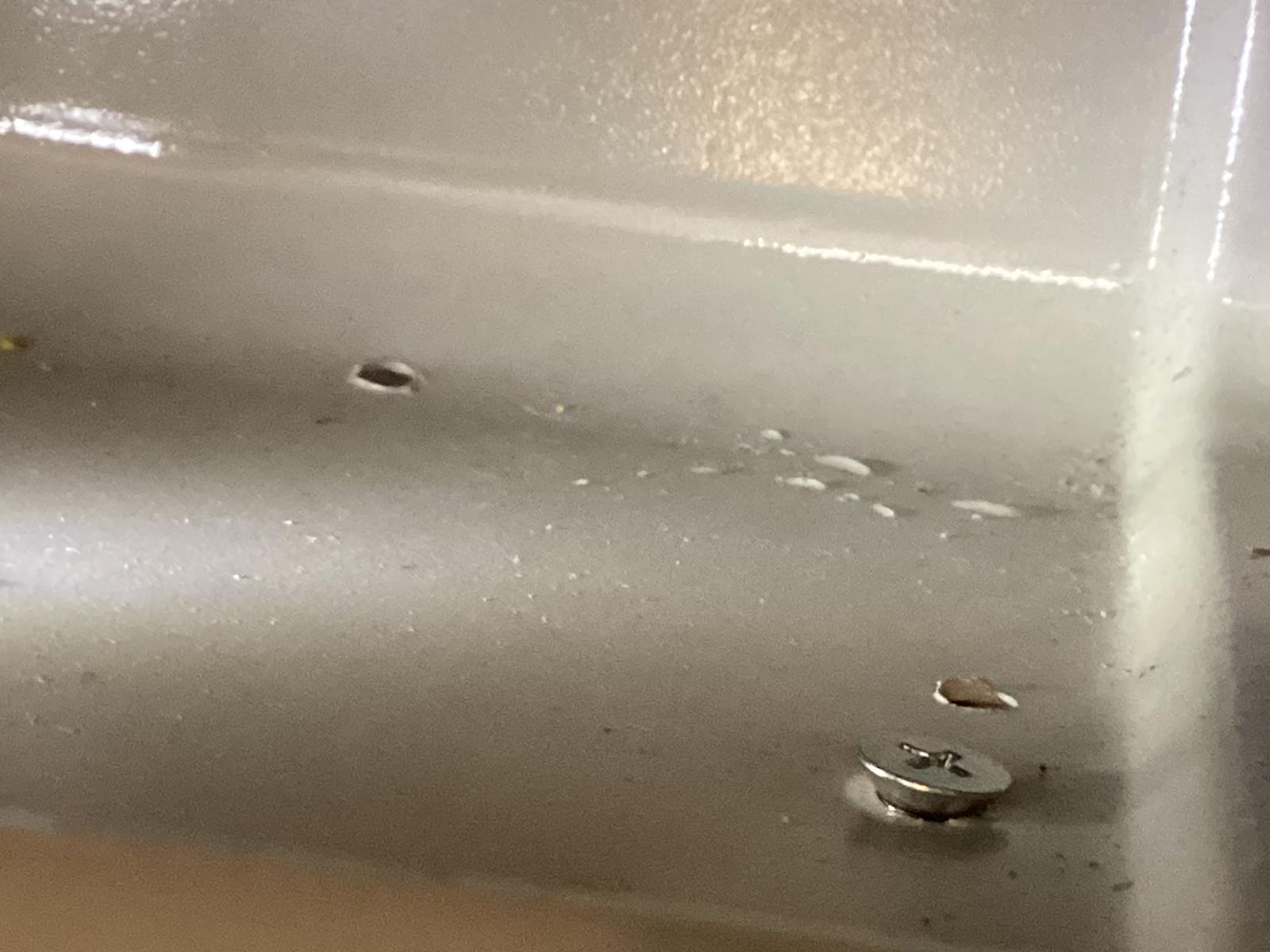

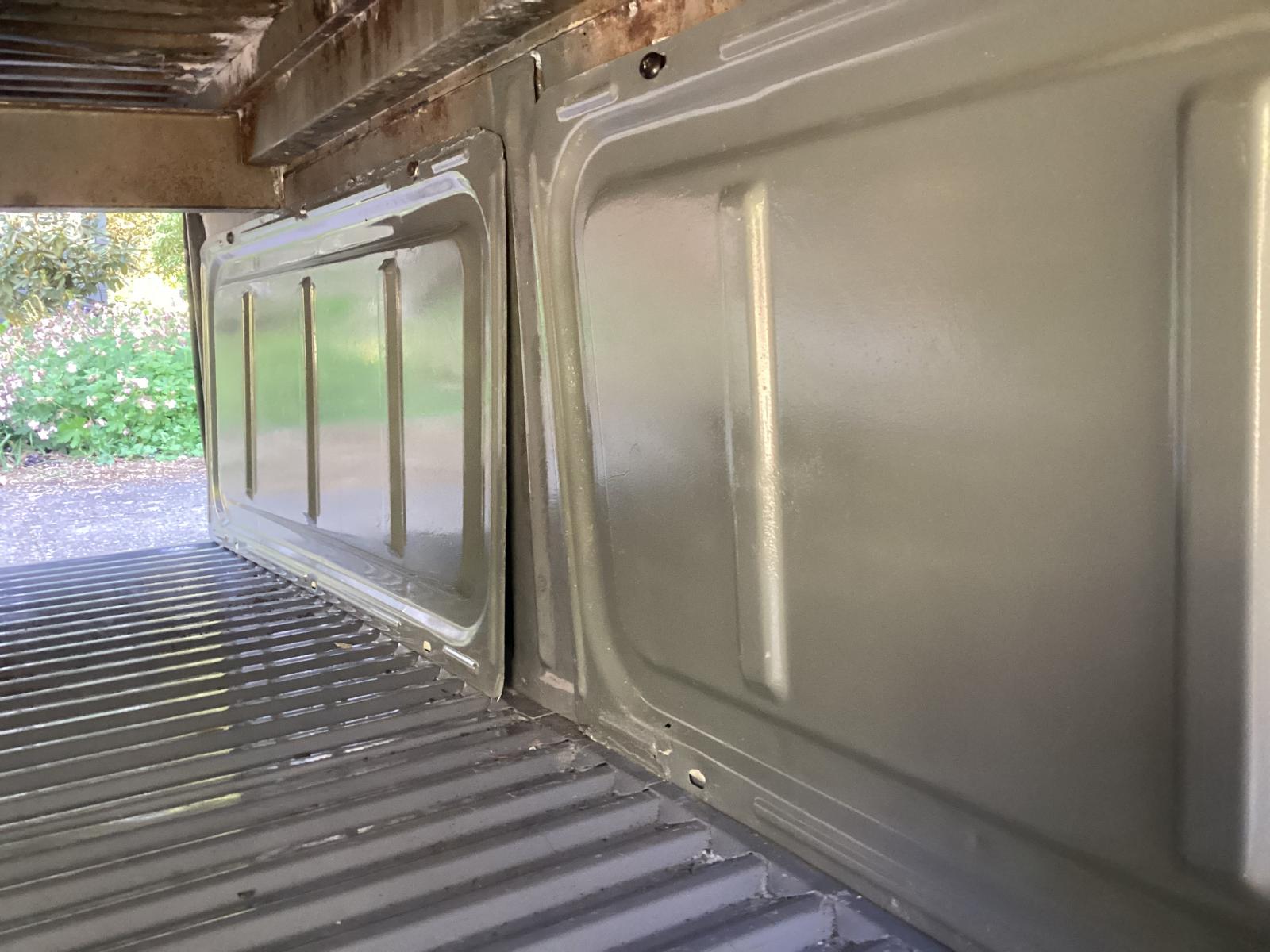

gas dividers don't quite fit due to replacement floor - not sure if metal is at issue, or frame is bowed up a bit here. Dont want to bend the panels so still thinking about a fix.
Minor leaks from bed, and I think from wiper shaft.

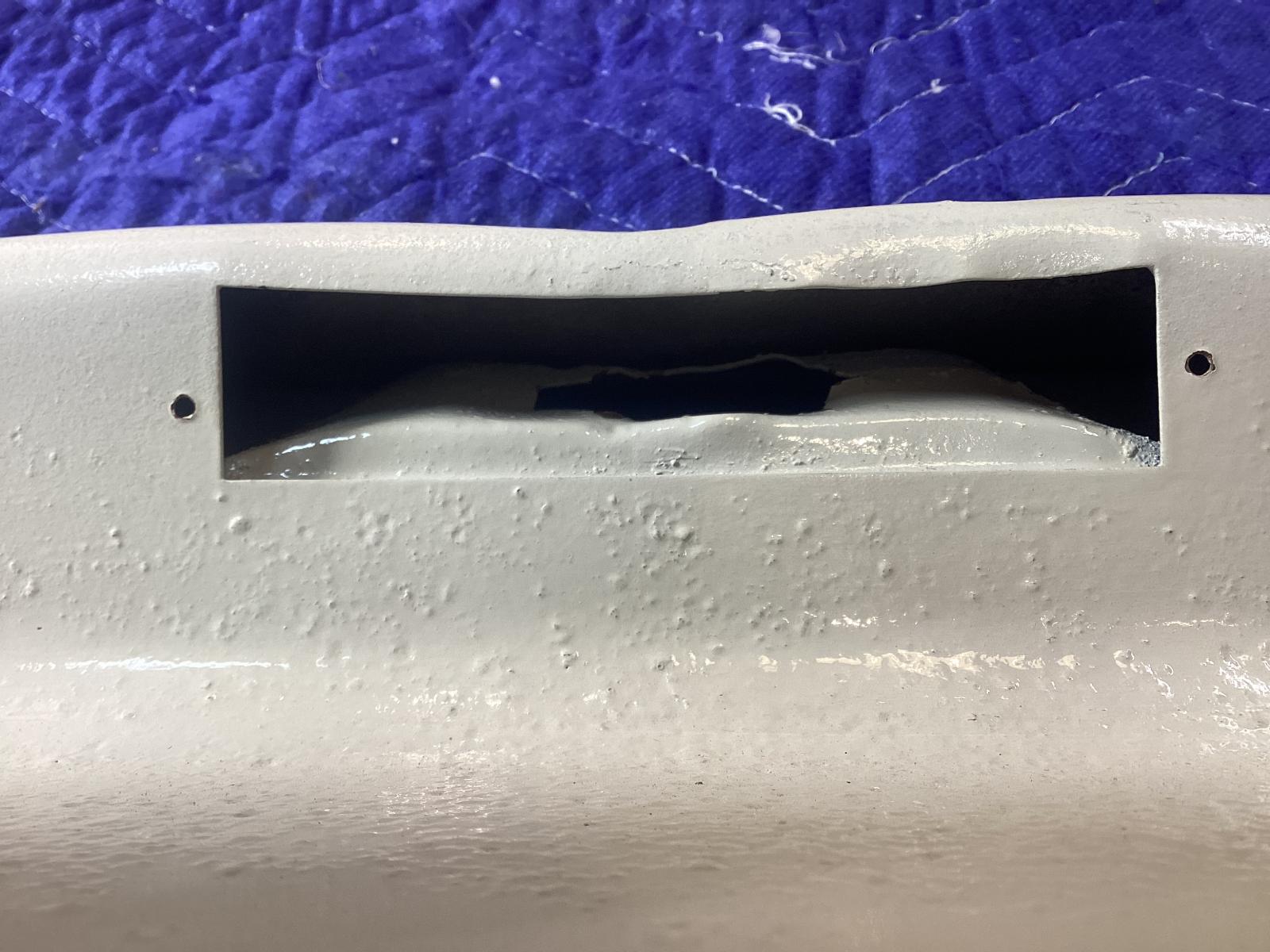

Need a 'jaws of life' style device to open the license light cavity...

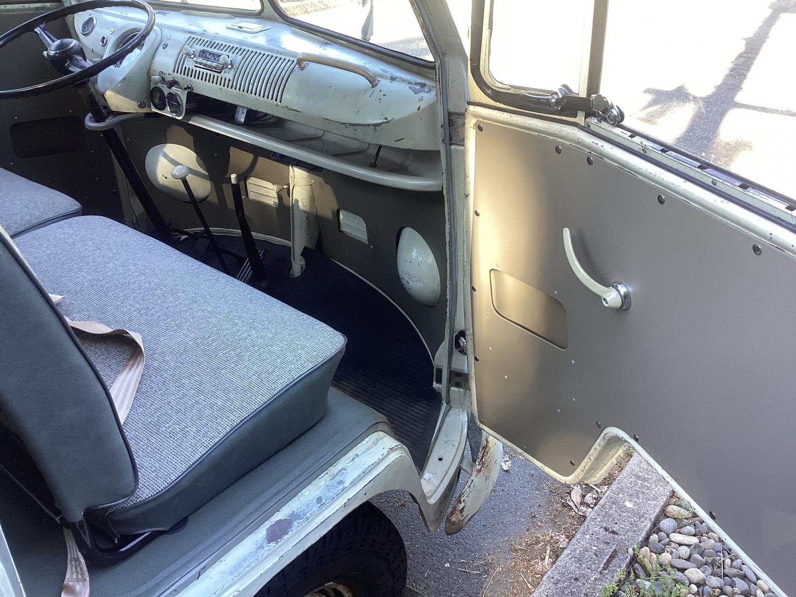

But enough niggling - here he is, in (mostly)finished glory:
Apologies to Clara for the abuse her beautiful panels suffered!
Finding year-of-manufacture plates with 261 was fun.
Rattlecan of 2-stage epoxy nose paint is supposed to be L87, and isn't, yet another from same company on right gate seems a close match. Would rather it be other way, as gate is easier to try again! Maybe new nose paint for birthday 60...
With the exception of the rear and right gates, EVERY inch was covered in white house paint, removed with acetone and 0000 steel wool over months - what you see is exactly what I found beneath. I dug out most of the bondo and just left a few patches that looked like more trouble than it was worth to remove, and painted them to keep out water. Definitely a patina car. I assume the rear gate is Turkis, which is ironic because the donor nose - under the clown-orange - was originally Turkis as well. I do have an actual perlweisse left gate, but the bottom is somewhat rotted so used the one that came with the truck. I like the roof - have no idea how all the paint burned off, but right gate had similar fate in Texas sun so maybe that's it? Though why no other spots... In any case, I should probably paint it, or at least figure out a rust-preventative protocol. Need to pound treasurechest doors to proper profile, as well as engine hatch; might just treat the bare metal afterwards and leave it.
Everything works, even the eflasher 'step-on-brakes-and-engine-goes-on/off-in-time' feature. Certainly DRIVES like a truck; I have adjustable Konis on all four wheels and no doubt need to adjust. Steering geometry is off and needs addressed, and a swaybar will be installed after adjustment. A few rubber bits need installed on outside. I have a "STOP" light that needs a bracket to insall on left bumper towel rack, and bed slats that need drilling before install. I suppose one is never 'done' as you spot things that need redoing or you'd like to add... but for now it's time to enjoy.

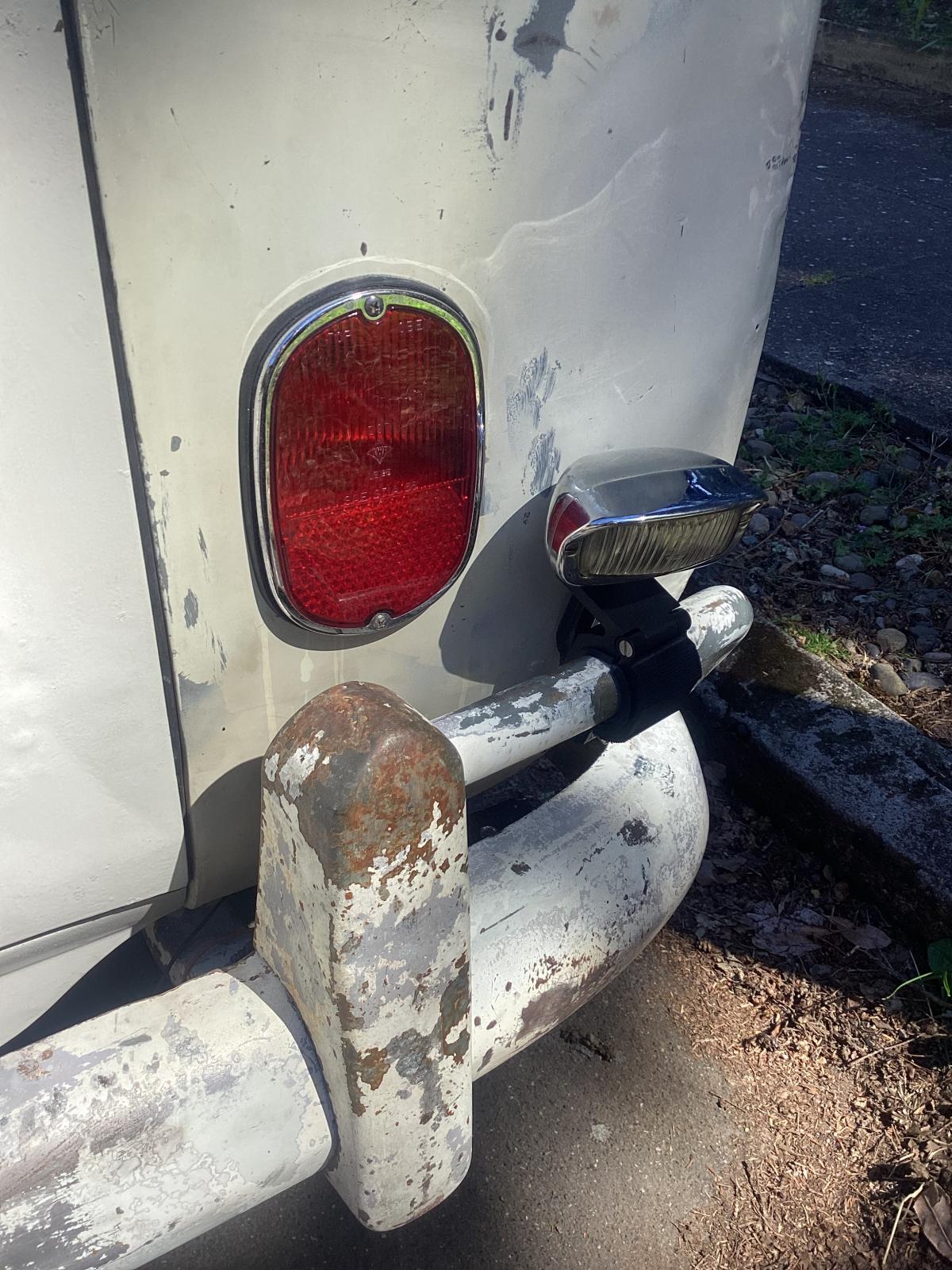

PostPosted: Tue May 14, 2024 3:40 pm    Post subject: Re: Raoul the 65 singlecab Reply with quote
Or fuss some more. These work, but ugly Jeep-ass looking things. Damage to bumper brackets prevented my mounting them tucked under towel bars. Gotta figure something else out soon as these are embarrassing.
Drilling bumper works for reverse light as last resort; stop would need a hole drilled in body by taillight so trying to avoid both.

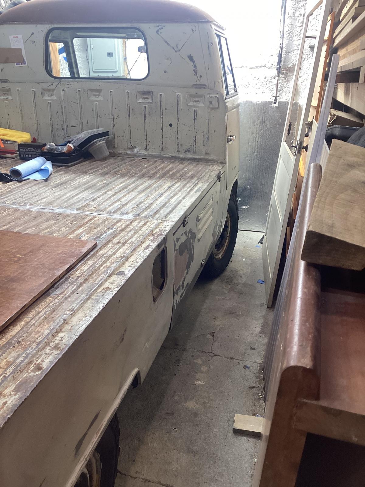

Good point! The water in parcel tray under wiper shaft area may be unrelated to water on floor... The rain hit in the middle of a high, narrow bridge so i was not able to do more than glance for water on top of dash.
I did find that the bulk of the water in the treasure chest was due to doors not conforming to body line, and wheel spray going in past the seals; most of my screws-and-washer setup in slat holes worked pretty well.
Hopefully it at least drizzles this weekend and I can track down the cab issues. I did tighten the wiper shaft nuts on the outside a bit more.

I’ve been having trouble getting any pep out of the truck, and it won’t go over 40, found the throttle arm wasn’t being pulled all the way down. Adjusted the cable and…
Well that ain’t good. Clearly on cable not ferrule. Seemed to go in rollers ok, rubber clear of shroud tube, no obvious kinks. Just too damn long.
I was using 211721555C, which is for 65 from chassis 215036651 so it should have been fine. I tried replacing the rollers with a stock cable sheathe, but it was also too long
Cut it, of course it ended up 1/4” too short, but it still reached; same problem. So used the earlier cable (55-65) and wah lah.
Also shortened the barrel clamp so it had no friction against spacer preventing full travel. No idea yet if it solves the speed issue.

Put on the splash pan; a bit of a challenge due to aftermarket pan, 50 years of frame stress, and replacement sheet metal. Got enough screws in to keep it from rattling.
Put on a sway bar as well (anti-sway bar for the purists). Not happy with the placement of the rubber bits, but it went on ok. Let me know if it looks wrong.
Would love to drive it to a local show this weekend… some 45 miles. Not sure it’s gonna be a good idea. Still can’t get it over 40 and the front end is slightly out of alignment. At least the road I break down on will be filled with sympathetic drivers!

I mostly have everything I need, so the swap was not burning through my cash. I did buy a few new 4-prong 12v t/s flasher cans to keep on hand if the square early bay box quits. I was surprised by how many clearly knowledgeable people told me flatly that NO split bus ever came 12v from factory.
Speaking of electricity: noted that when I have the radio on, and hit the brakes, the station goes away and hash was heard. The same happened when the parking lights were turned on - both these bulb sets are LEDs, so that means those bulbs are messing up the signal somehow. It seemed to go away when we were closer to town and station was stronger.
Also, the needle on the gas gauge was twitching up and down; not sure if votage issue or sloshing fuel. I did note that when tank seemed full Brazil VDO sender from 90s read 3/4.

Right after the second pic, the bus stopped moving, and the pedal stayed on the floor; luckily a downhill sidestreet was right there. Nyloc nut had backed off the Butty's Bits accel linkage and the arm fell off the pedal. Nut stayed in cabin, and I was able to get it on with some difficulty and get moving again.
After all that smooth sailing, the bus nearly broke a mile from the house! I live in an area of many steep streets, and one has a sharp angle to get to it; you can see the gouges in street where all the trucks illegally turning here get stuck.
I pulled almost all the way into the downhill lane (flatter) and started going up; instantly the car began bucking violently and hopping and banging. After 4 or 5 terrific hops it settled down and went forward relatively quietly. It could have been in 3rd instead of 1st (it does that), but shouldn't the engine have died under that load instead of bucking like a rodeo bull? When I have a missed shift on a gentler hill, it bogs downs and bobs a bit, but it's never leapt from the ground and slammed back down before. I wonder if one wheel was slipping or the extreme angle and slopes made the rgbs angry. Let it idle on a fairly level stretch a moment, and clutch wouldn't grab cleanly; you could feel a mushy sliding and the engine started to bog. Left it sit another few minutes, carefully let in clutch - and it shifted and went on like it hadn't happened. We looked behind, and did not see all the trans fluid running downhill, so that is good. My local shop ridiculed me for wanting a midmount, saying I would never need one to prevent a split gearbox. Well... "

By the looks of people as I left the dragstrip I assume I have exhaust leaks, so checking for those when it gets a checkup. Thought I heard howling from newly-rebuilt trans, but that could be tire noise. It wasn't alwasy there. Last, my kid rode with me on way back, and complained of gassy exhaust air in cabin the whole time; the heater boxes are not connected to tube yet, but even with flap under dash closed it was really strong. Was never an issue in the bay. Normal? Or will connecting HBoxes solve it?

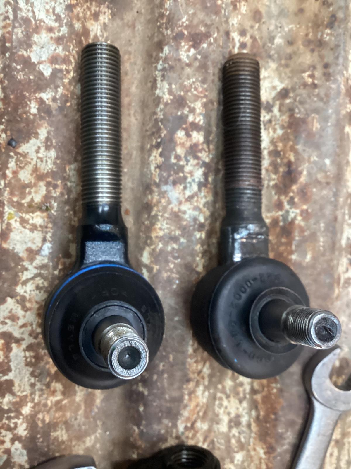

Tie rod fun.
Took the bus to a hot rod shop for an alignment cuz other shops said they wouldn’t do it…. Was worried the Detroit Iron guys would laugh, but they actually were reluctant to give the truck back. They liked.
Anyways, they didn’t get far because the adjustable tie rod was A) slightly bent and B) they could NOT get the ball joints in far enough to adjust. Needed another 1-1/2” and could not move them in further. Got it home and checked: correct tie rod and ball joints! Put in a new tie rod and everything seems fine. Only thing I can figure is that old rod had rust or dirt so firmly packed you couldn’t get the ends through it.
Shop prefers cotter nuts, but all the new stuff lacks the hole in ball threads, so nylocs it is. They also warned not to mix them, as they view nylocs respond to stress differently than a cotter/castellated nut. So at least they were happy it was all matching now.
