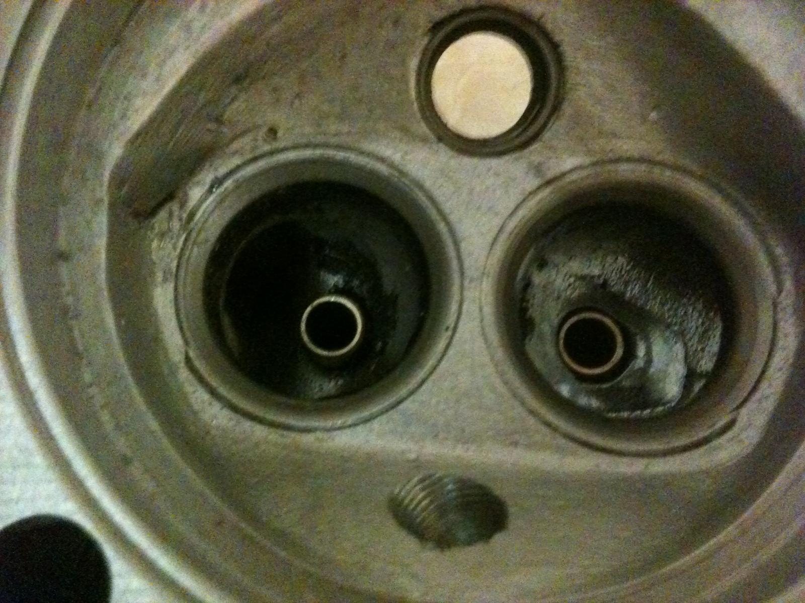

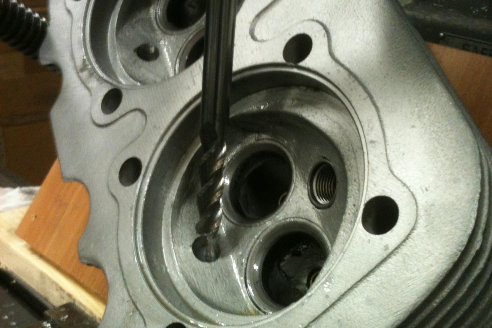

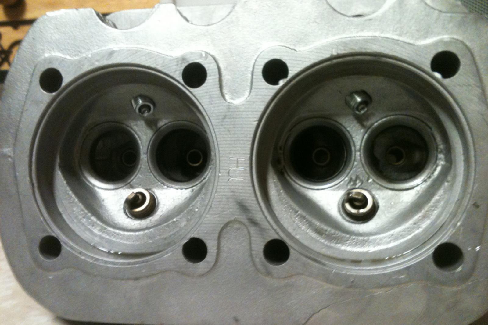

Sorry for the delay but after looking high and low Evil or Very Mad I finally found the *&^%*% disposable camera I used to take pictures of the head work I did in making my heads twin plug...
I needed a small plug in order make this work. Used an M10 x 1.0 sparkplug with a 1/2" reach. It was hard to get it at the correct angle but it worked...
Tooling:
Extra long 9mm endmill, Extra long 5/8" endmill to create the flat gasket area where the sparkplug seals, Extra Long 7/8" endmill to hog out the fin area so you can install the sparkplug with the socket, and finally a m10 x 1.0 thread pitch tap...
These are all the pics I have, I lost a few in the roll due to heat and it being in the garage for years behind my bench. I hope this helps anybody that wants to attempt to do a twin plug. It's not for everybody, it does take a long time, but it was worth it for me. Confused

GREAT PICS! Thanks so much for the angle information. When I tried doing it myself, my problem was drilling from the fin side, snapping off fins, and if you are off even a small amount, when you flat spot the bottom for the spark plug seat, you can cut into the combustion chamber. I was surprised to find that a Forstner bit cut the aluminum amazingly well when combined with a good cutting fluid at 10% concentation. I use Master Chemical TRIM E206.

Volk, It was very hard to get the fin area right, I had our grinder take down the neck on the 7/8" end mill to about .400 in order to clear the fin area where the push rod covers meet the head then I used the adjustable stop on the Bridgeport to take off the fin area .010 at a time. Big endmills tend to dig into the material so using the stop kept it from pulling into the material and snapping off a fin. I did not use the same end mill that was used to clear the fin area to make the seat for the reason you mentioned. In order to not cut into the combustion chamber I took a 5/8” end mill, also had the neck ground down to .400, and used it to make the seat area. Making the holes was hard compared to making the dist drive. Laughing

I think what Henry's concerned with is the exposed threads overheating to the point that the they pre-ignite the charge. I've heard of this happening. I suppose you could mark the exposed threads requiring polishing?
The 36hp head is one of the few I never examined for dual plugs .. it appears from your photos to have far less material behind the combustion chamber than 40hp & later.
Does your top plug protrude more than stock ?
For some reason, I didn't have the fin break-off problem during machining that I had initially feared. In a week or so, I'll locate the various cutters etc that I had to assemble, as well as a demo head .. perhaps even a 36 hp head from somewhere. I'm curious if there's any possible way to get both sides to point toward the exhaust, like these dual port heads:

Gears, the additional plugs protrude about the same as stock, if anything, they might be a little longer on one side due to the angle, but shorter on the opposite side. I have not had any problems so far, I can switch between plugs so it runs the same with only the top plugs or the bottom plugs running by themselves. I think if a problem like glowplugging occurs in the future it can easily be fixed by switching to a 3/8" reach plug instead of the 1/2" ones I am currently running.
I was also thinking of pointing both sides to the exhaust but I think its impossible with these heads, they are way too small.

I went through a few heads finding that sweet #2/3 plug angle .. and it was "barely". It might not be possible to place that plug exactly where we want, but a 36 hp collapsable pushrod tube might allow it.
Yes, I'd put in the shorter reach 10mm plug. You're already way ahead of of the curve with dual sparks, so I don't think you need to protrude so much.
A secondary issue with exposed plug threads is carbon buildup. This can chew up the threads when the plugs are removed.

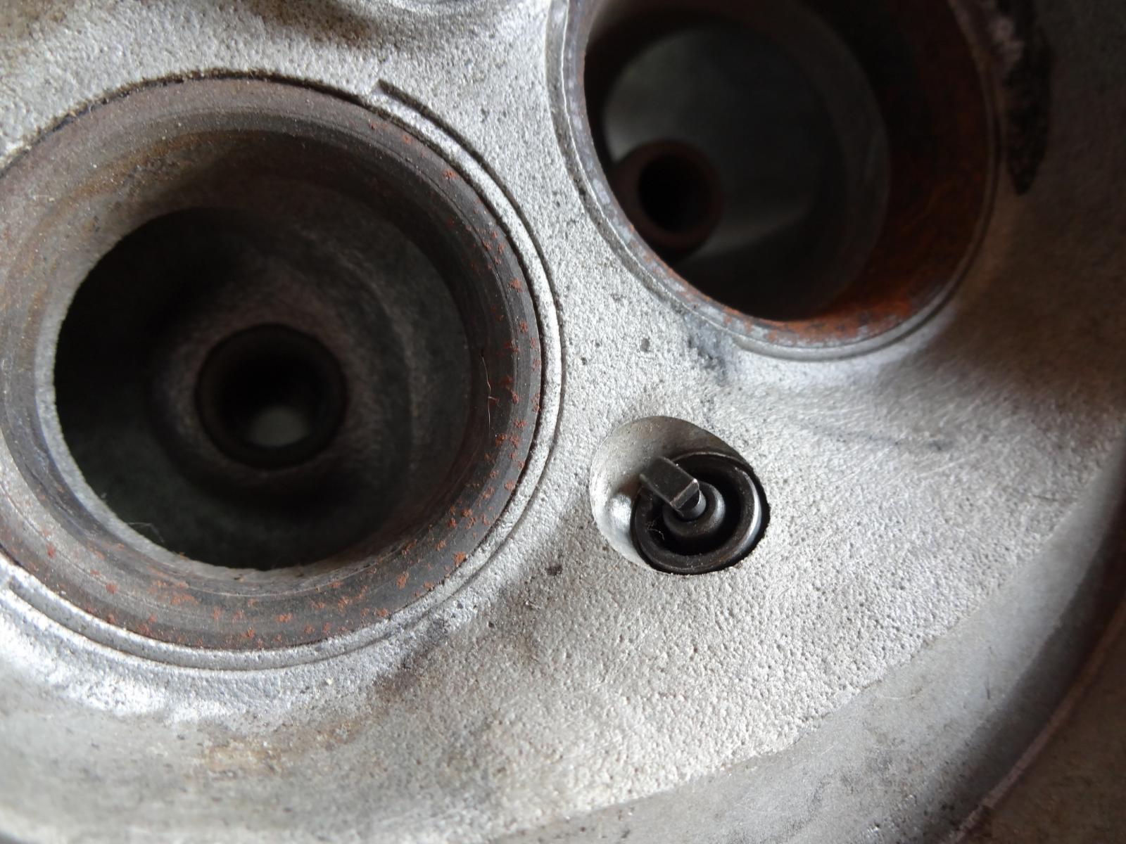

PostPosted: Mon Feb 18, 2013 10:54 am    Post subject: Reply with quote
I don't know how much this post will aid in dual-plugging 36hp heads, but hopefully most of it is applicable. I'd still like to find an old 36 hp head locally to play with.
My original goal was to find positions for both lower plugs that were as "straight in" as possible, with both angling away from the intake valve, and with both easily accessible (without having to first remove other parts).
It's difficult to begin a straight hole in an angled surface, so I modified the tip on one of my long drills to act as an end mill.
After drilling my 5/16" hole all the way through the chamber and through the fins, I flipped the head over, enlarged the drilled hole to 11/32", stopping just short of the chamber. I then used 7/8" and 5/8" end mills, as well as my custom lengthened 10mm tap, stopping short of threading into the chamber.
In order to keep from breaking fins, the head must be solidly mounted (steel or iron mounts) in a Bridgeport mill. With even the slightest unwanted vibration, chances are high that fins will snap off .. so I opted to mount the head as solidly as I could and adjusted the milling head for final angles.
I took pains to keep the lower plugs out of the airflow as much as possible. The sharp machined edges in these photos still require smoothing out (this is merely a pattern head).
#1 plug: https://www.thesamba.com/vw/gallery/pix/1027340.jpg
#2 plug: https://www.thesamba.com/vw/gallery/pix/1027341.jpg

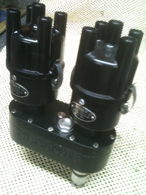

This is a great thread! I found it when searching for any info on dual plug ignition setups. My search brought me to a page in the middle of the thread. As soon as I realized that I went to the beginning and then couldn't stop reading until I got to the end.
What is the center-to-center distance of the two dizzies? I may have a different application using two larger diameter Bosch distributors.
Thanks.

The C to C distance of the dizzies is dependent upon the pitch diameter of the gears you are using. I used 3 gears from Stock Drive products, #S10T12M035S1012, the pitch diameter for those gears was 43.75mm that makes the C to C distance of my dizzies 87.5 mm (center gear + 1/2 of right gear + half of left gear).
Since you will be using larger Bosch dists you might have to select different gears with different pitch diameters. I would start with the diameter of the drive shaft in the dist and go from there. If you need more space between the dizzies, then get a larger pitch diameter gear, keep in mind as you get a larger gears the gear housing will have to be larger also. If you have any other questions, let me know.
