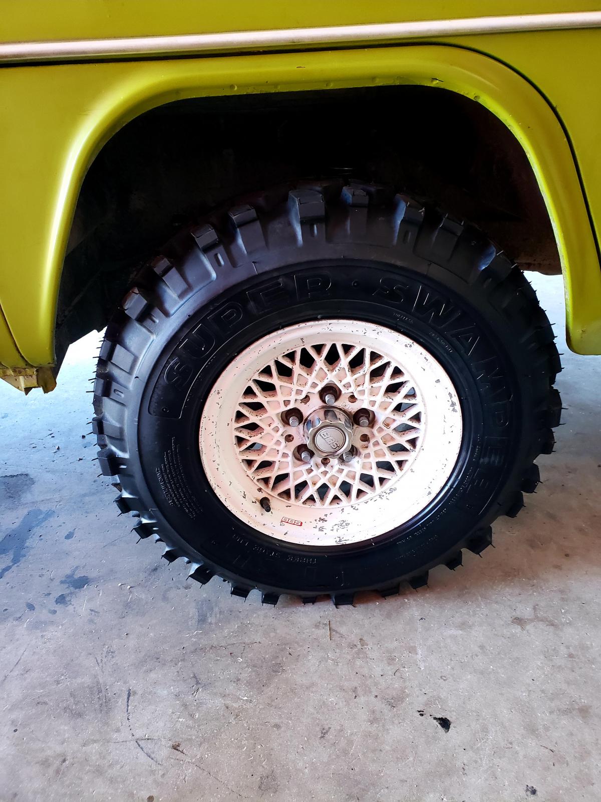

PostPosted: Wed Dec 06, 2023 1:39 pm    Post subject: Re: Off road modifications for your bus FAQ Reply with quote
64 ragtop volks wrote:
Nice! You're going to have to invest in a more powerful stereo to offset the tire/road noise with those...

PostPosted: Wed Dec 06, 2023 3:15 pm    Post subject: Re: Off road modifications for your bus FAQ Reply with quote
the tires do have a humm, but its the sound of my people! hahaha. its nothing compared to the yuge nitto mud grapplers on my big truck. so far my little solar blue tooth speaker sitting on the dash has more then enough volume to deal with the road noise. we will see after these tires get some miles on them. the buckshot mudders i took off had about 50% tread left, and were starting to get loud.

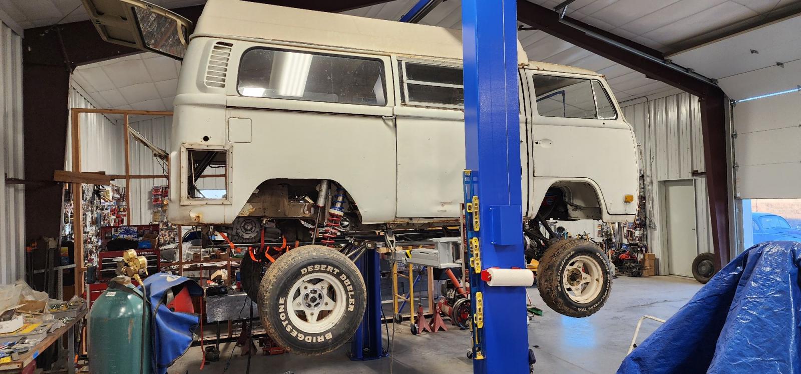

Y'all might be looking at the offroad capability but I am struck by the ease with which you could take the battery -- big batteries -- out that hole on the side of the motorbox. Why has no one ever considered cutting a hole there and... I don't know, maybe like, making a battery access door out of fiberglass? A concept like that would be legendary! This is problem in need of a solution. It would have a certain elegance and simplicity!

PostPosted: Fri Dec 08, 2023 9:23 pm    Post subject: Re: Off road modifications for your bus FAQ Reply with quote
Now that's a battery door!!

PostPosted: Fri Dec 08, 2023 9:51 pm    Post subject: Re: Off road modifications for your bus FAQ Reply with quote
No doubt!!!! Looks like he’s got one on the other side for the camper battery as well.

How often do you guys need access to your batteries?
I was debating on putting the batteries there. Or possible the diesel for for the heater. My choices are to weld a sheet of metal over it and close it off.
Cut it to the size of a lockbox door so there is a key entry. Just weld flush
Or put an air duct there
Was thinking of putting a duplicate of the top duct down below. For my air intake.
Or reversing it for airflow out of the engine bay. I have my cherokee radiator where my gas tank used to go. [/quote]

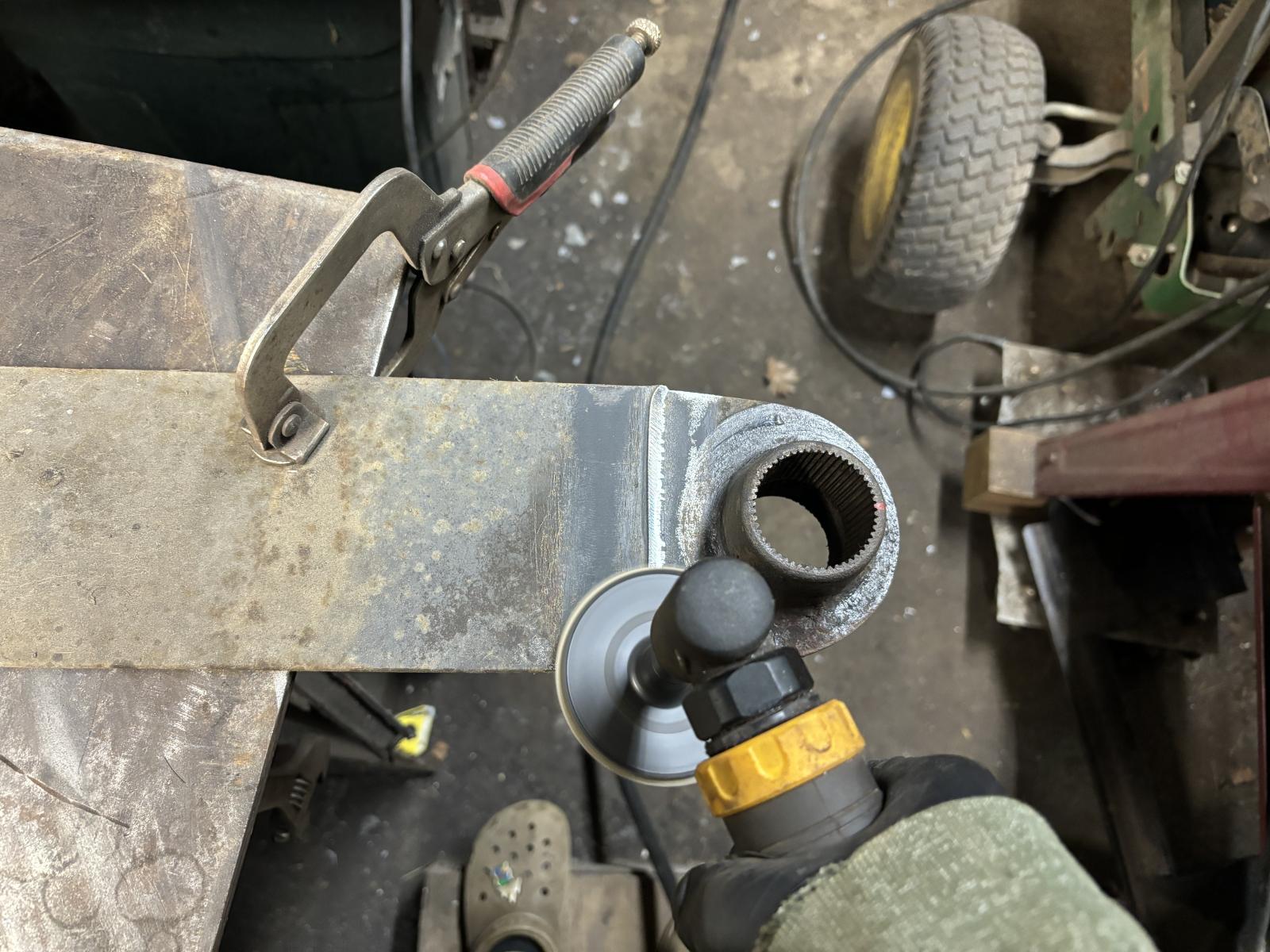

leveled bus out, had to re index rear 1 outter spline( the sensa trak coil overs lifted front about 2 1/4", got the t3technque high angle cvjoints just, same as the empi hi angle ones, cv spacers, and their neo cv grease. tires are 28x8.5x14 swampers. adding the diesel heater is game changer! ran it 27hrs straight with no issues

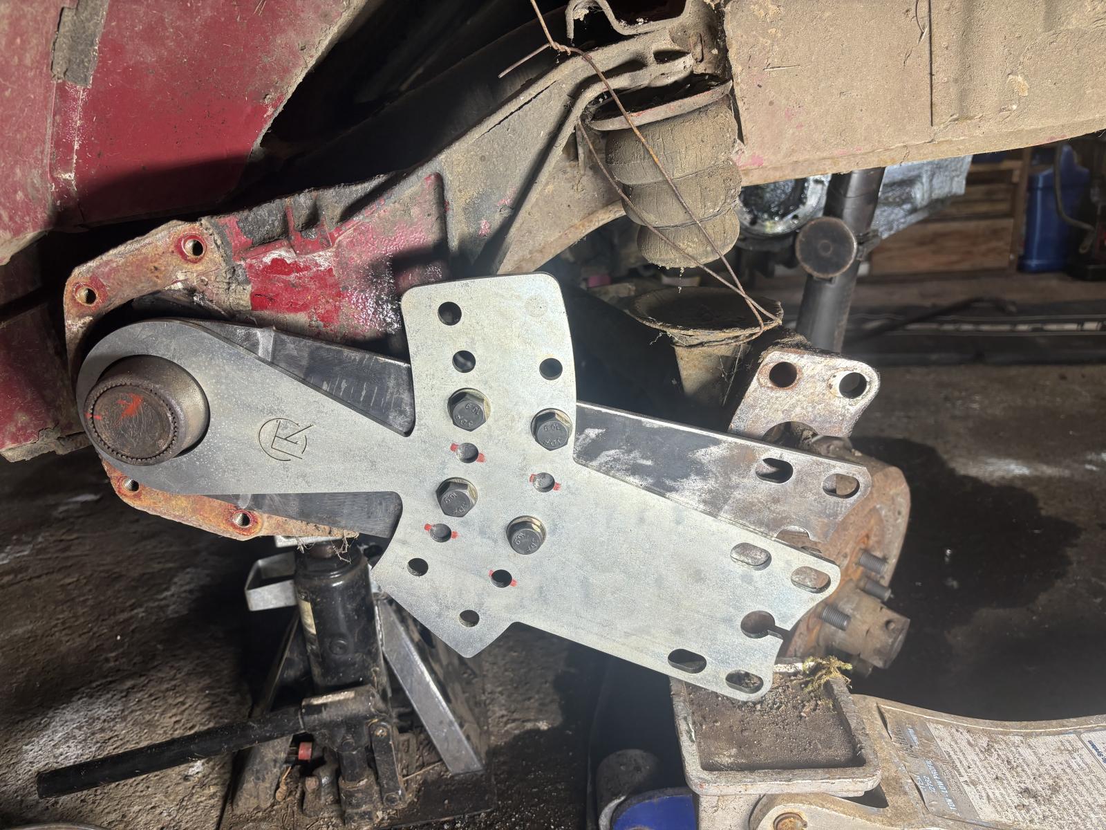

PostPosted: Mon Feb 26, 2024 10:51 pm    Post subject: Re: Off road modifications for your bus FAQ Reply with quote
I got the Fresh Kustoms drop plates installed, well part way. I had to clearance the bump stop towers for the bolts to clear and I had to order some new springplate bushings because all of mine are toast. Looks like in 75 I guess they decided to do away with the big support between the torsion and bump stop. I’ll pull it apart again and clean everything up with some undercoating.
