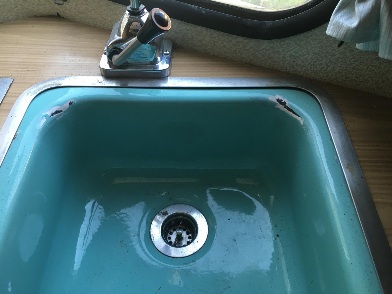

Anybody have a replacement for my damaged Eriba Puck sink? I’m in California.
Looks like something heavy fell on this one in its previous-to-me history.
It’s 10.75” wide by 15.5” long and 5.5” deep, interior measurements. I’d love to have an original in better condition for my 1971 Puck, however, would make do with stainless steel or some other material.
Also, I’m curious to know what experiences folks have had contracting out replacement of the interior liner. What kind of artisan did you choose, and what was the approximate cost? Any unexpected difficulties getting someone else to install it?
s.e.charles
Joined: March 26, 2015
Posts: 270
s.e.charles is offline
PostPosted: Sun Aug 11, 2024 8:09 am    Post subject: Re: Eriba Pucks Reply with quote
i've not personally used tub liners, but do have some first hand experience with refinishers.
years ago, i used a company franchise of Miracle Method. it was basically two days of prep, two hours of nasty spray, and a 3 day drying period. this was for a tub in place.
the other was a removed sink, but cannot remember the company. the product was fine, but the technician sprayed it in a dusty garage with pi$$ poor lighting. the surface 25 years later has held up to use, but still has specks imbedded & an uneven thickness in coat which shows as grey in bright light.
i would urge you to remove it, send it out, sans the trim ring/ drain in order the finish gets under them so it is virtually a single sheet of high tech coating without seems.

Great idea! I wonder if I can match the aqua blue? I’m not super-worried about returning the Puck to absolute authentic original condition, but it’s nice to not create new junk for the landfill. I will look into refinishing. Thank you!!

PostPosted: Sun Aug 11, 2024 8:29 am    Post subject: Re: Eriba Pucks Reply with quote
https://www.nufinishpro.com/pasadena/
https://youtu.be/X8YwhUtABu4?si=DlXQ7if0LIc32w8i

Thanks for the links.
First estimate from a different place came in at $500 and that’s for white porcelain, not even the blue color matching, which is vendor-talk for they don’t want my small job.
I’ll check a few other places.

The sink — I’m looking into resurfacing it. I haven’t found a source that has a replacement the same size. Sure, I could go with a different size sink, but this sink is sized to fit the cabinet divisions below the counter top, so I’d rather use what I have rather than complicate things below the counter.
