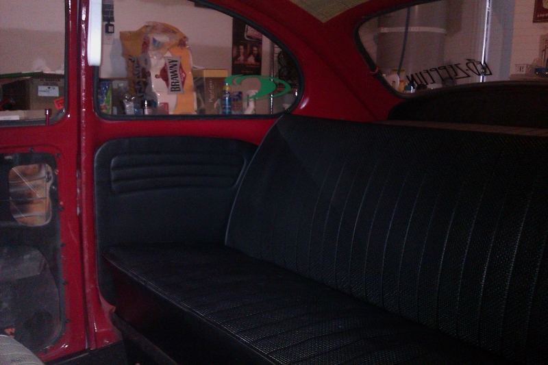

Picture of the door panel installed, well passenger side but the driver's side looks the same lol, and can kind of see the assist strap installed there in the top left of the pic.

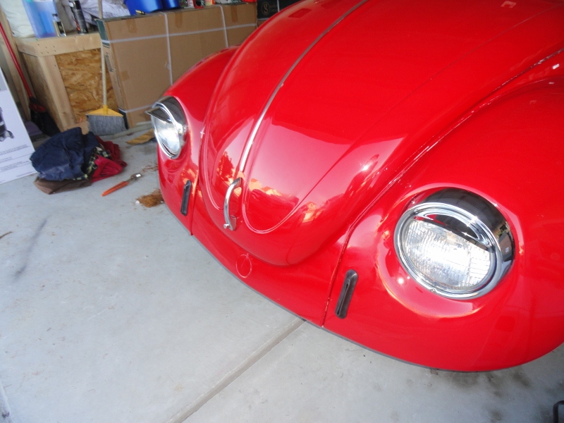

New fender beading is only $14, I'm getting the new stuff and installing it. Definitely like the look of the black beading better, and already planned on scoring it with a very sharp razor knife to avoid peeling unnecessary paint off. Not on top of my priority list though, getting the rest of the car finished first.

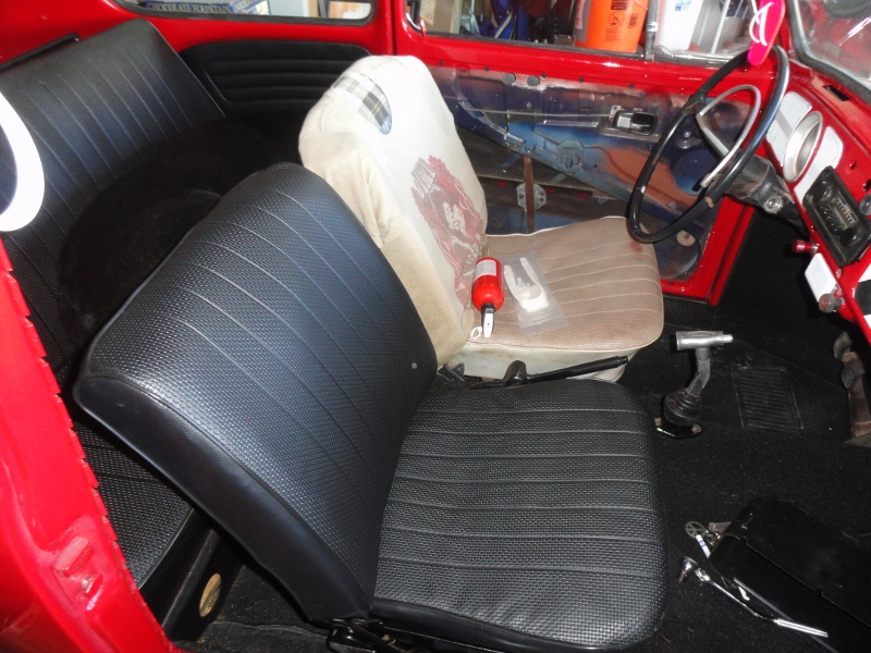

It has been too long since I've been able to do anything with my project, but today I devoted the entire day to it. Got a good bit accomplished, here's an update on my progress:

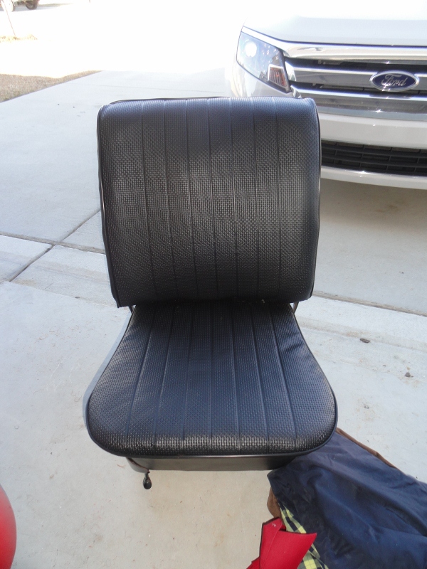

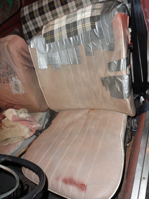

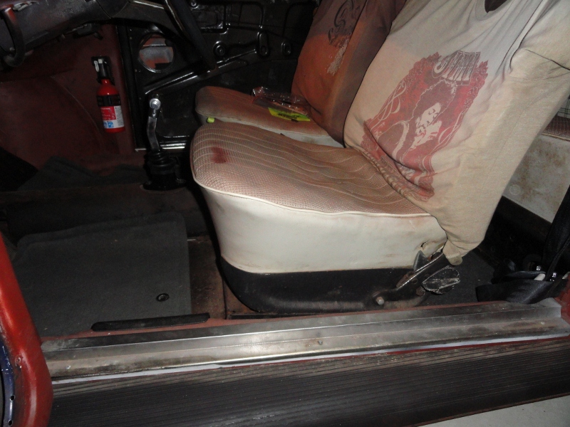

What the seats looked like before
Getting the bottom done
Took it all the way down and sanded/painted

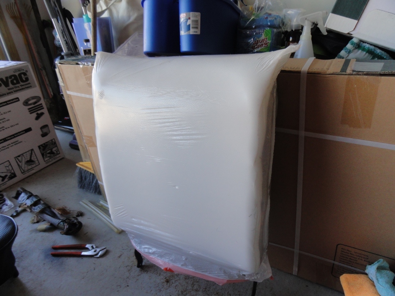

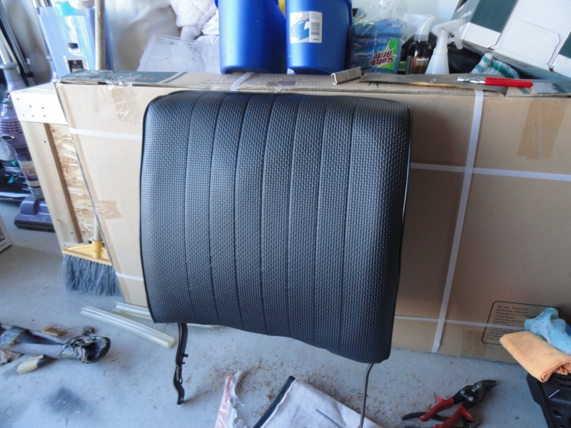

Made my own cushions out of foam padding from Wal Mart. Slid a garbage bag over it all to ease in the install of the new seat cover.
After throwing the new cover in the dryer for 10 minutes, it slide on easy
Finished product. Not too shabby for my first time ever and only had the bits of info that I've read on here to go off of as reference.
Compared next to the other old one (that's my pup sleeping in the backseat)
Got them both done
Then installed the new 3 point seat belts. The driver's side seat came out way better than the passenger.

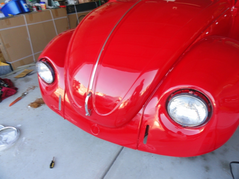

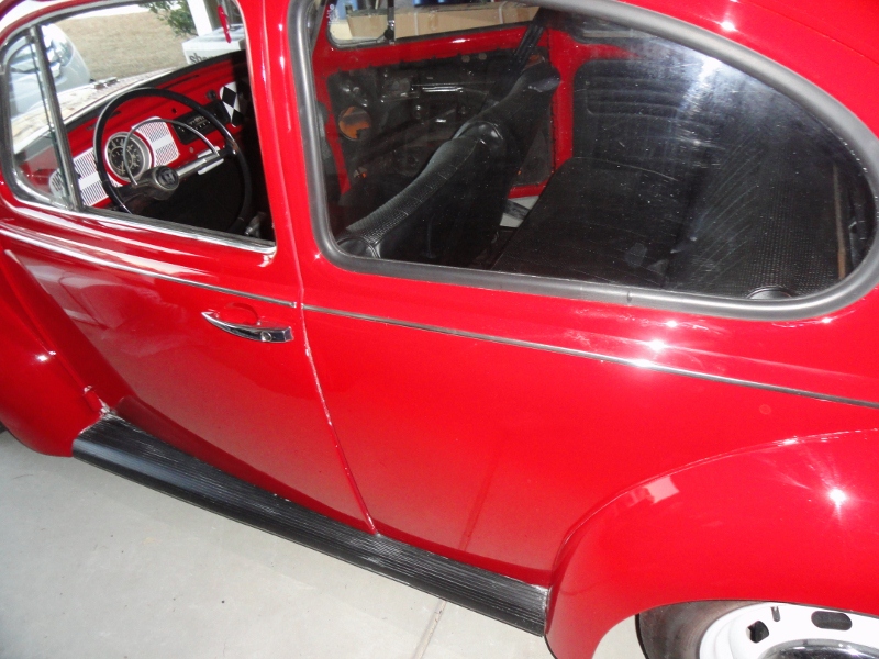

Then I went up front and decided to put on the new headlight rings and eyebrows. Went with the premium headlight rings, not the cheap stuff.
Then put the new chrome trim back on. Took it off so a buddy of mine could buff out the paint, well that hasn't happened yet so I put the trim back on so it wouldn't take a chance of getting damaged just lying around.

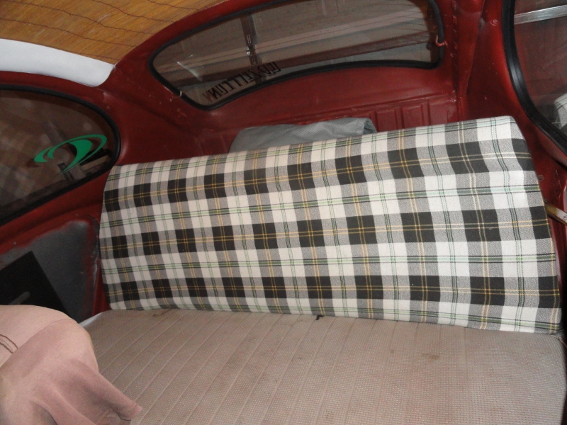

Found some older pics of the bug before I did anything to it. Didn't know I had these, really shows what the back seat looks like prior to dying it.
Didn't have a chance to do anything today with the bug, probably won't have time tomorrow either. Monday should be a productive day though. _________________ It's good to be buggin...
