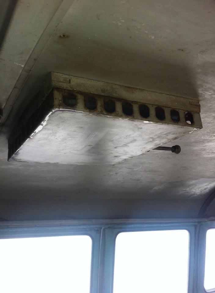

hi! great job! Smile do you know if all barndoors with the air vent where ambulances? i just bought a 54 barn door.. the seller does not know much about this car..it will take some time until i have it back home.. i ordered the Volkswagen certificate.. here are some pictures:

Your bus is not an ambulance. Note the difference in shelf height behind rear seat to the pictures above. Still a very interesting bus with the rare opening hatch option/roof vent. Please post more when it's in your possession.

Hagi, I think it's a Taxi

Hagi , your air vent is much further back on the roof than mine - I believe the roof vent could be ordered at the factory - Im sure someone in the UK has an early bus with a vent that is not an ambulance .
