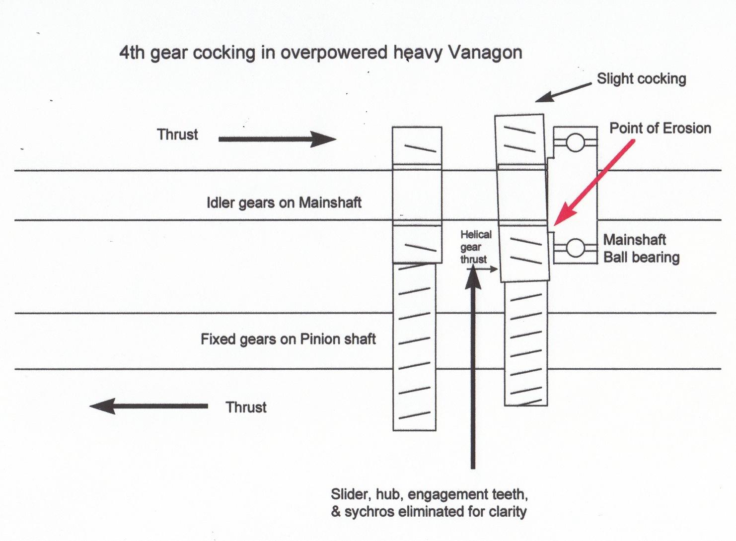

Hi Pchill and Andy Bees:
I think that the cocking of the 4th gear occurs not due to tapering wear (hence little or no evidence of gear bore wear), but due to the designed-in clearance, plus, when gearboxes accrue miles, the additional clearance caused by wear on all surfaces and on the needle rollers too.
Since the ID of the mainshaft bearing and the thrust surface of 4th gear turn at the same nominal rotational speed, there really is no other available explanation. (I say nominal because there may be some harmonics in the gear mesh and/or arising from the engine.) The open question is really how much of that erosion is due to cocking and how much is due to pure axial thrust forces. I don't think it matters since straight-cut gears will eliminate both forces. With both axial and cocking forces eliminated, oil can occupy the space between the mainshaft bearing ID and 4th gear, instead of being squeezed out. Then, (assuming my theory is correct), the metal erosion should not occur.
My thought is that the brinelling and false brinnelling are likely not a serious concern for most of us because most of the transaxle's life occurs in 4th gear, where the condition of the gear bore and needle rollers are not so critical. If the brinelling were to be found on 3rd gear, for example, which is spinning on the mainshaft most of its life, brinelling of either flavour would be rather critical.
Rather, the brinnelling and false brinelling are mainly some evidence of the beyond-design-parameter forces involved when re-powering. Even with straight-cut gears of the same material, we might very well see these brinelling clues. But the GT gears are made of better alloy and hopefully will not experience any brinelling.
To Andy, I don`t think that the engagement of 4th gear through the slider and thence to the drive hub and thence to the mainshaft is sufficient to lock 4th gear in a way that prevents 4th gear from cocking nor from the oscillating I have been struggling to describe adequately. In a nutshell, I think that the 4th gear, when high torque is applied to it when in gear,
1. is not perfectly concentric with the mainshaft due to bearing clearance; and
2. Is not perfectly vertically aligned, but instead, is cocked at a slight angle, due to the axial forces applied on one side of the gear - - specifically the side that is in mesh at any time with the fixed 4th gear on the countershaft. It may help in visualizing this to think of a swash plate at a very small angle of inclination.
Regarding the rumbling of the transaxle at idle speed in neutral, for what it is worth, my transaxle has done this from day one after the 2012 rebuild, once the gearbox is up to operating temperature. On cold starts, the Swepco 210, like a fine molasses, quiets all the gearbox noises.
If anyone has installed the straight-cut gears and had a chance to examine the interface between 4th gear and the mainshaft bearing after putting some miles on the gearbox, please chime in.

I offered up an explanation for the wear shown in the pictures in a previous post. I believe the wear shown could have nothing to do with driving.
What people forget is that it takes the same amount of power to make the van go 80 mph regardless of how much you have. Getting to 80 faster is a different story but that’s not what’s discussed in this thread.

Good post Howesight but I'm not on board with "cocking" of the gear. The axial force relatively uniform across the mesh. It would be visibly evident if the contact mesh was skewed towards one side of the gear and the bore would be tapered.
Yep, have seen lots of brinelling, thrust erosion, no evidence of gear cocking. If there was gear cocking, the erosion lines would be wider on the ends, narrow in the middle, but they are straight, and equal width beginning to end.
The eroded thrust faces are 'square'.
Pchill2 wrote:
I do agree with the loose fit of the gear and bearing to the shaft. The false Brinelling on the inside of the gear bore shows a stationary vibration. The 4th gear is always spinning when the vehicle is in motion.
When "in 4th" the gear is spinning, but it's locked to the shaft thus the needle is stationary in the bore, and on the shaft. But the bearing itsef precesses due to diametral slop. So the needle bearing does rotate, but very slowly. Someday I should measure the slop and figure out the rotational speed (for fun) but for now, logically the bearing should rotate by precession while in 4th. Which is GOOD.
......Until the brinnelling gets too deep, then precession cannot climb the needle out of the "line". Then next time, --->if<--- the needle stops in "the line" it stays there and continues to erode the line deeper ----> after the oil depletes.
I don't see a situation where these can get brinnelled while stationary. Think of a "dry gearbox" with a tag stating "no oil" and transported by railcar across the continent. There would be assembly lube which should prevent that. And there's no centrifugal force to deplete the lube. I don't see it happening due to transport. Not on our gearboxes. And if it was only an 'image' in the sheen, it would disappear, burnish away in-use.
Pchill2 wrote:
Couple this with a ton of folks reporting noises when idling in neutral and it makes me lean towards some harmonic vibration.
I suspected some kind of unexpected violent condition (like resonance) for years. But we could never find any indication. Then corrosion fretting came along and it has too many telltale signs to let it go. It's our current darling.
Corrosion fretting does not occur in the presence of lubrication. It must be "metal-to-metal", =dry. Idling 800 RPM, in neutral, is super-lubrication.
Noise in neutral is generally the mainshaft bearing. It can make noise once it's wallowed out its bore. Then it can't transfer heat, and the bearing just wears faster. And there's the electrical assault happening in this 3rd decade of corroded steel bolts in the magnesium cases. And in a Syncro neutral noise can be the granny idler gears just chattering loose. Gear chatter sounds similar but different than a bearing.
Pchill2 wrote:
If the false Brinell marks were actually Brinell damage it would have been due to shock loading. Until they are measured I assume they are from stationary micro movements from vibration. As could be the wear on the thrust face.
Doubt there is a shock load that could produce a "real brinnelling" that is accurately consistent around the shaft and bore. It would be on one side of the shaft.
Pchill2 wrote:
I do agree with Sodo on the lack of lubrication on the thrust face but don't think that is correlated big engines due to the nature of the failure.
Many Vanagons fail with stock engines.
I think it is related to mashing on the pedal for hours, no letup, ---->and the subsequent oil depletion. The big engine would just thrust harder and thus erode the thrust face quicker.
And as the theory goes, the WBX periodically downshifts, which floods 4th with oil, stopping the erosion (until it depletes again).
While the big engine remains in 4th for longer as the driver wears a smile. Wink

It cannot get brinelled while stationary. It can get false brinelled. These have two different failure modes.
Sodo wrote:
Idling is super-lubrication.
Not while the clutch is depressed. The 4th gear is high and dry as is the mainshaft bearing.
Couple that with folks using some super high viscosity lubricants and you'll likely not be seeing much oil in the gear anyway.
This is what I'm saying is causing the damage. Vibration of the gear face on the mainshaft bearing due to poor fits.
You asked for some independent research. From the threads I've seen the common component is noise near the mainshaft area of the transmission while idling.
Howesight claims to have a noise while idling cold. Perhaps push the 4th gear into the mainshaft bearing with a screwdriver and listen for the noise to change?

The ^^gear cocking^^ theory illustrated from Samba discussions circa 2017.
Howesight wrote:
2. There are also unequal forces on the 4th gear idler (Paul Guard referred to this as "gear cocking";
the problem with the gear cocking theory is that evidence suggests it does not occur. The 'false brinnelling' lines would be narrower in the center than on the ends if there was gear cocking. But they are perfectly parallel.
And the thrust erosion is perpendicular.
Howesight wrote:
3. Due to the bearing clearance between the mainshaft, rollers and inside diameter (ID) of the 4th gear idler, the idler gear itself can move in an oscillating manner best envisioned by thinking about a hulu hoop in action on somebody's waist;
I've been calling that motion 'precession'. It's amplitude is equal to the bearing clearance.
Howesight wrote:
5. If you think of the idler gear as cocked (not running perfectly vertical) while the thrust surface of the mainshaft bearing remains truly vertical (or very close to vertical), then you can visualize the contact between those surfaces is not constant. Instead, the location of the actual contact between these surfaces is constantly changing and as such, there is localized contact followed by localized separation. These repeated compression and separation events are, I theorize, what causes or at least contributes to the metal erosion.
That was our theory in the past but it has fallen out of favor seeing no evidence of gear cocking. I don't think gear cocking can result in perpendicular erosion.

Sodo wrote:
Perhaps the proper name is "Mechanical Precession".
Incidentally, this realization was seeded by Howesight's prescient post back in 2016 which alludes to corrosion fretting but does not use that term.
Samba history here: Syncro Transaxle failed 4th and mainshaft bearings (Pic Heavy.
Paul Guard, Tom Lengyel and I have all repeatedly expressed thanks to Howesight for digging this up, but he won't leave Canada so we can't thank him in person.
Then it took awhile to put it all together because we're not drivetrain engineering professionals.
Strangely, Howesight appears to have departed from his 2016 conclusions - that we have embraced. We think he is mistaken. Wink
From: Wikipedia
AND its not oriented exactly per discussion, but helps visualize how the diametral difference in the gear and shaft may possibly rotate the 4th gear needle bearing rollers/cage.
Someone good with 360Fusion could make us a 'real' animation for our discussion and I bet readers would appreciate that. It could be an 'incremented' rotation which would be difficult to animate.
The green arrow is the 4th gear and mainshaft locked together (see below example 65mph and 3600rpm).
The blue circle (and square) is the needle bearing/cage 'precessing' inside the locked 4th gear (432 RPM below).
OK so this is how it's supposed to work, how the needle bearing does not ruin the shaft and bore immediately. But what stops the needle/cage from rotating. and what starts the longitudinal erosion that the needle settles into? And how could they possibly be "so consistent"?
QUESTIONS>QUESTIONS>QUESTIONS
But in any case we are confident there is non-rotational 'micro-motion' at the thrust surface and the red oxide would not occur unless it was "dry" of oil. We are pretty confident that corrosion fretting is the cause of the thrust erosion and the longitudinal shaft/bore erosion that we call perhaps in error, 'False Brinnelling'. There is no evidence of rotational thrust abrasion.
PChill2 alludes to a resonance condition causing the violent forces to generate erosion at the thrust face. This was one of our past theories too. My theory was not 'at idle' but at somewhere high on the engine's torque curve. Perhaps even keyed to gear tooth vibration (noise). But there was no apparent difference between weddle-big-tooth gears (noisy) and VW fine-tooth gears (quiet), so that didn't go anywhere. We (Tom Lengyel and I) talked about setting up microphones to listen for a resonance condition that "could be audible" at a fairly specific RPM. But not seeing any correlation to tooth-size, we lost interest and never did it.
There could be a resonance that contributes additional erosion.
But the precession has re-risen as the culprit in ~2021, its purely the gear teeth trying to separate, the force shoving the idler gear to the far side of the needle bearing slop
Simple (occam's razor!).
And that amounts to a 'radial' oscillating motion at the thrust face.
The amplitude of this motion = the needle's bearing slop.
One cycle for every rotation of the gear/shaft when locked in 4th.
