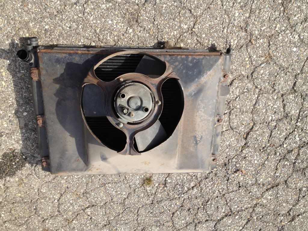

While waiting for the temperature to rise from the low 40's into the 60's so I could paint the engine compartment, I pulled the spare tire carrier and the radiator out..... Found more of my missing antifreeze!
I'll be putting in a new radiator, the fan shroud though........another rusty thing to clean up and paint! The motor I'll clean and lubricate before reinstallation.......
I will probably install a new temperature fan switch and wire in a manual fan switch on the dash.....just in case! .........

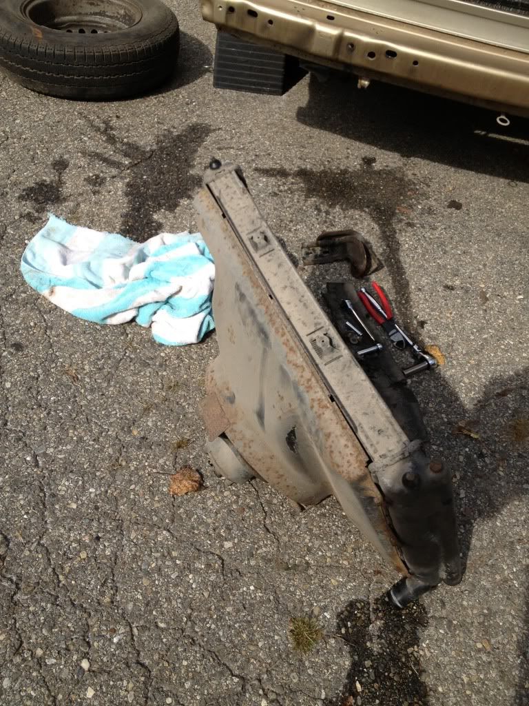

Sadly, but not unexpected, once the radiator came out there is of course more rust to contend with. I had felt it previously with my finger tips, right behind the front bumper on the radiator side is a seam...... Yep...a RUSTY seam! About the worst one that I've found on the car thus far.......
Also some other minor rust mostly beneath the driver area..... Better to get it now than let it eat my Van!.........
Heavy Sigh...... Rolling Eyes
I think the key to having these units in the rust belt is a yearly crawl through program. Once a year crawl everywhere and fix any minor items such as these before they become major. That's why I do not like under coatings, they hide the rust until it has done way too much damage.

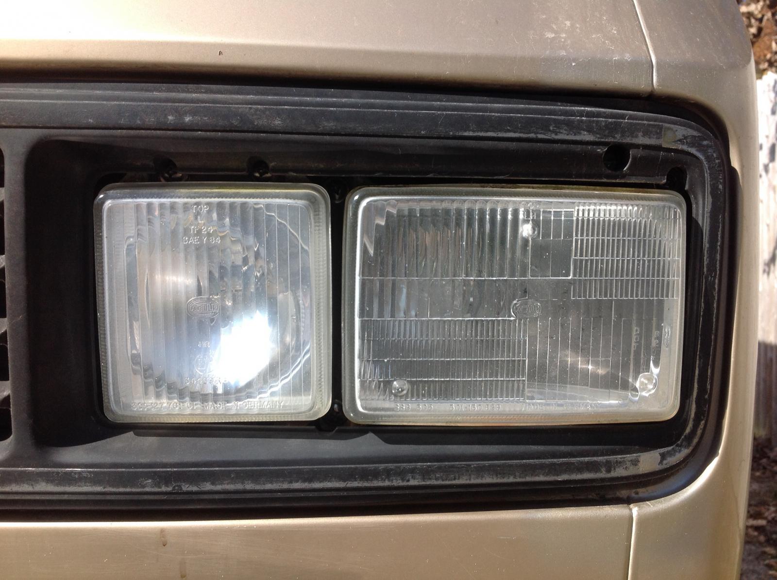

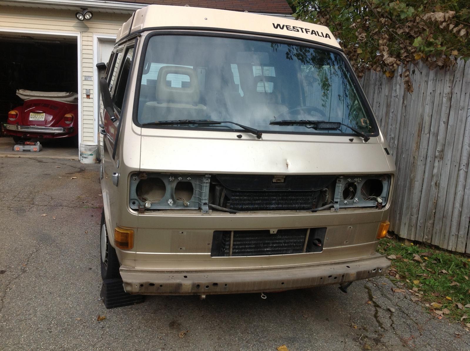

I put the tail lights back in using Stainless Steel screws, installed the headlamp buckets using Stainless Steel screws, installed the grills and mounted the bumpers. I now don't need to store them and the Van doesn't look quite so much like a carcass in the driveway! I used new stainless steel bolts with an antisieze for the bumper mounting. The old ones were pretty well gone and made me wonder if they we going to snap off while I was carefully removing them!
It does look blind however! I just can't wrap my head around $83 for headlamp hardware!
I also painted the screws for the mouse screen and fresh air intake black so as to not be seen through the grill.
It was kind of nice digging out baggies of parts and putting them ON the VW when I've been taking stuff OFF for so long! Smile

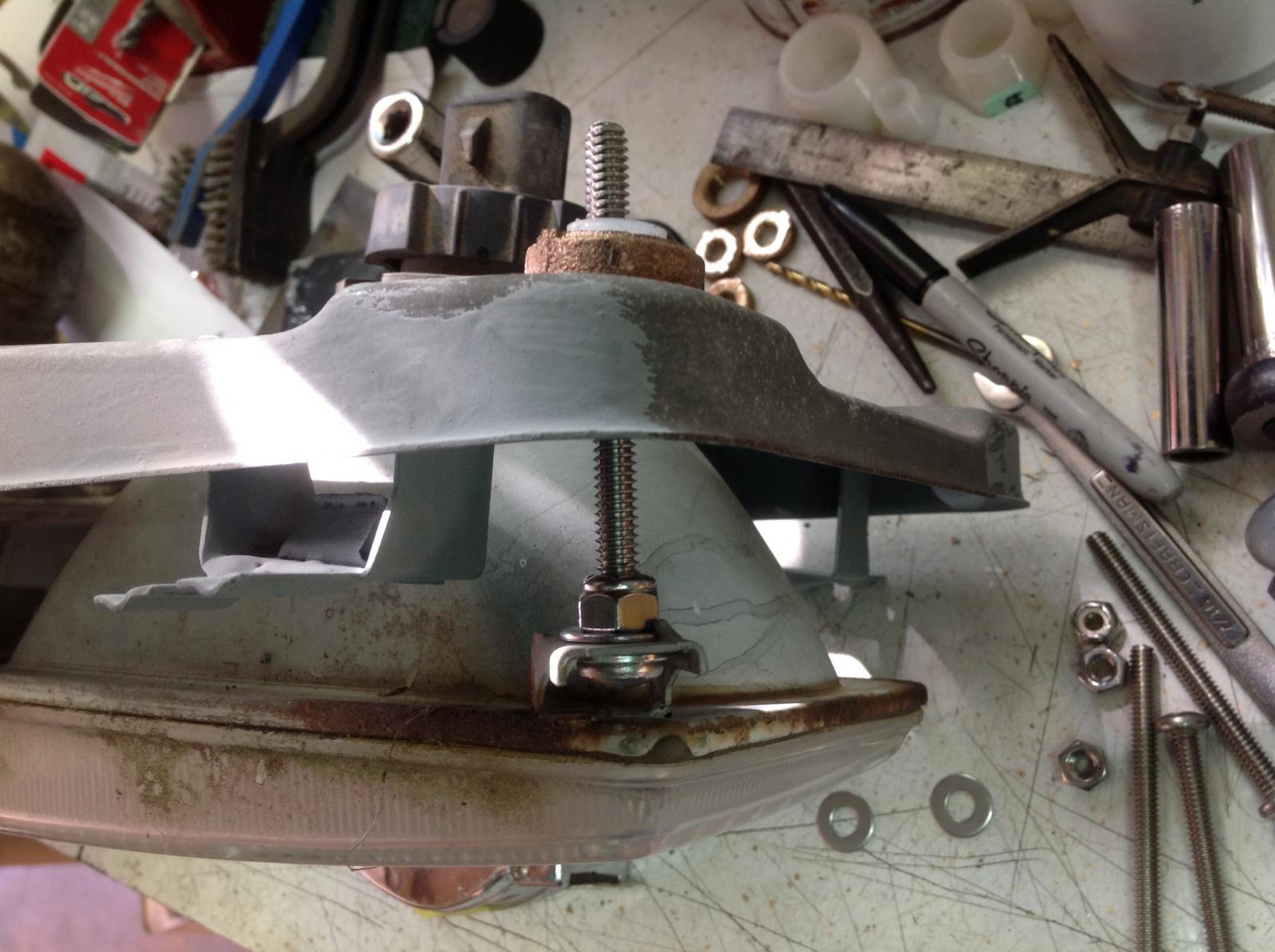

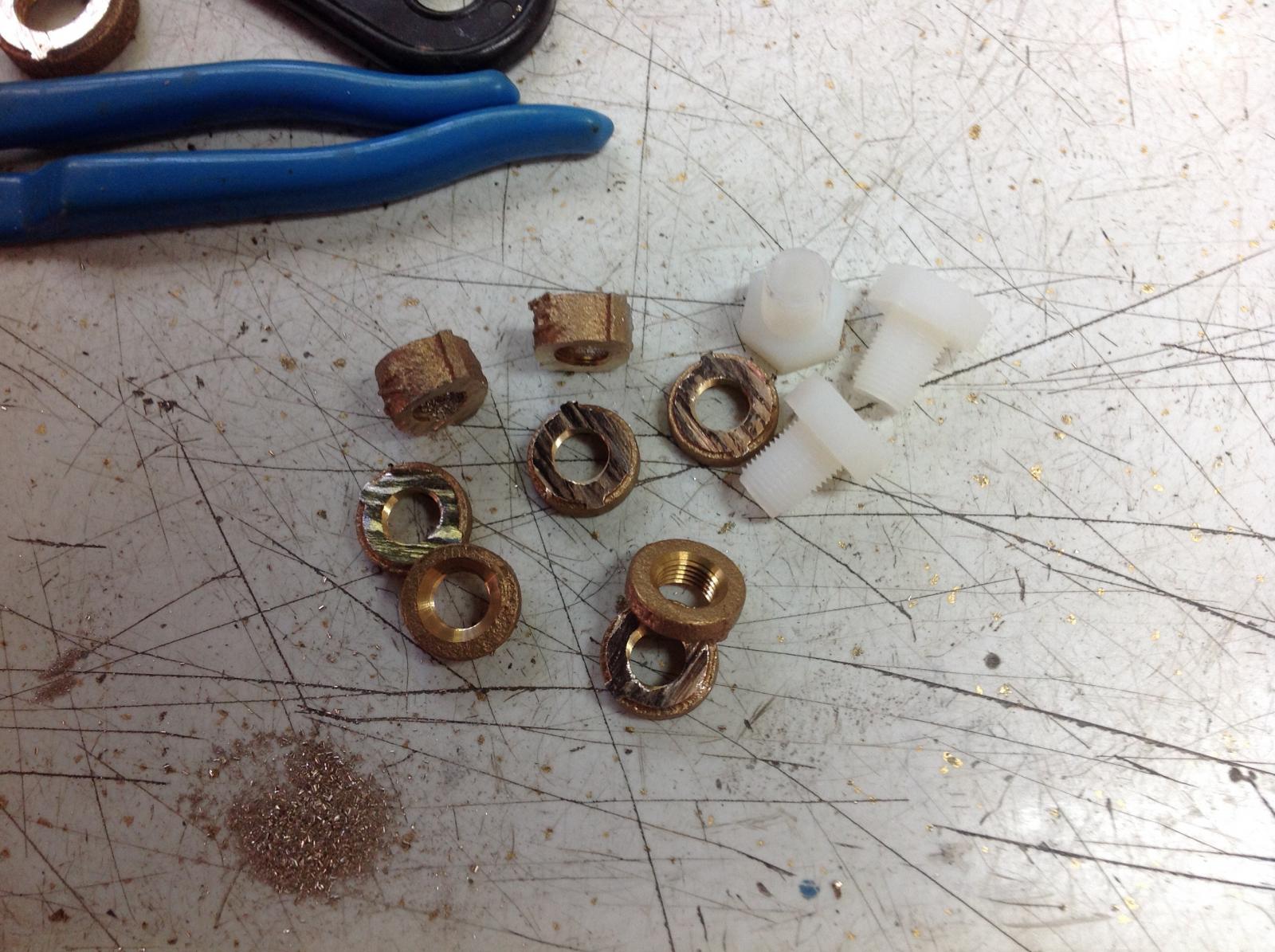

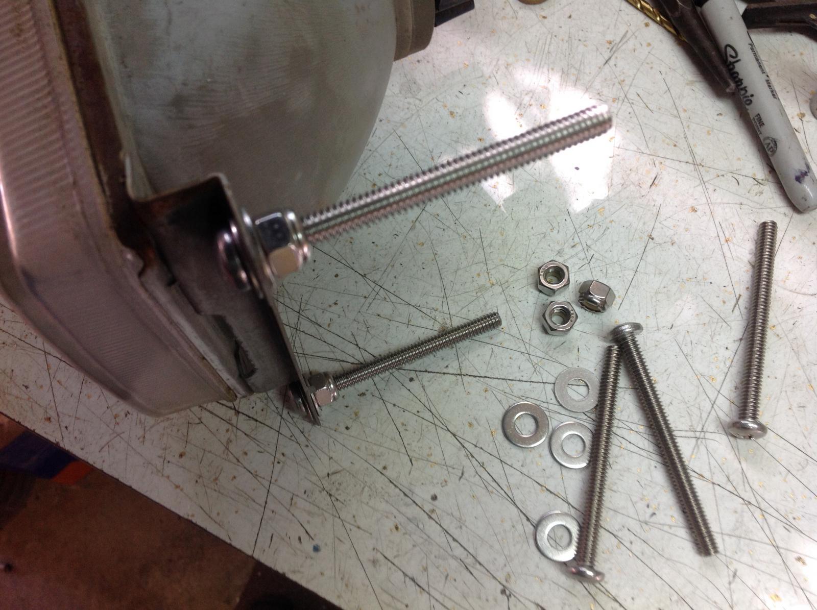

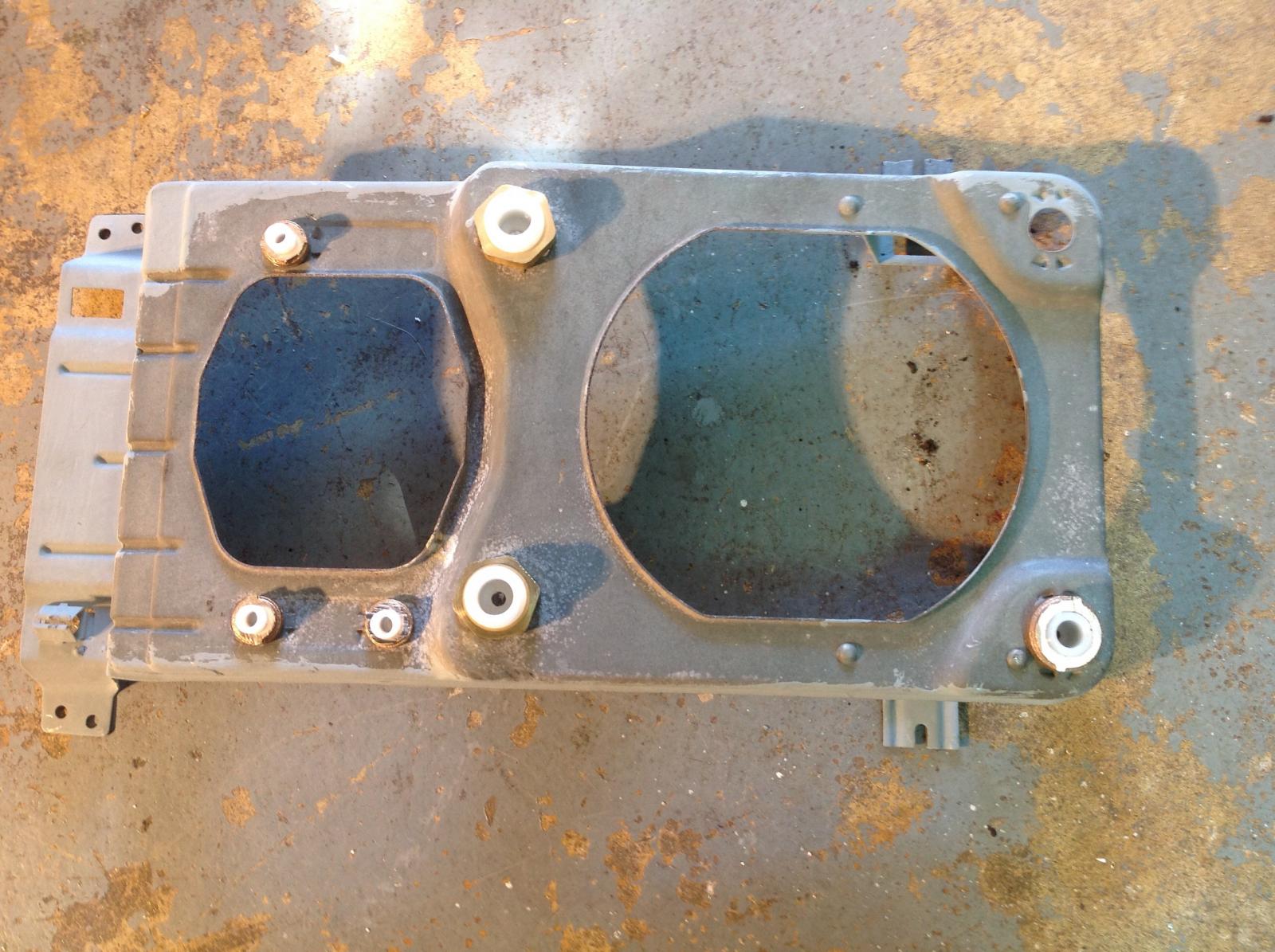

Headlamp mounting.
As I've mentioned, the thought of spending $83 on headlamp mounting hardware disturbs me. What further disturbs me is how long will it last before it crumbles like my existing hardware? Not one piece of my 12 mounting points is reusable!
Here is what I have.......
I've read many posts about how to make repairs and honestly some of them are good ideas. What they all fail to consider is longevity when exposed to the harsh environment that headlights are subjected to.
Massive amounts of rain, rain water thrown up by other cars, Winter de icing chemicals dissolved in the rain water water or melted snow and thrown up into the headlamp mounting all this equates massive corrosion and rust rendering many of the work arounds useless for the long haul.
These work arounds are fuel hose and hollow wall anchors, brass plumbing fittings, even soft drink bottle caps!
http://www.thesamba.com/vw/forum/viewtopic.php?t=385347
http://www.thesamba.com/vw/forum/viewtopic.php?t=456788&highlight=headlight+adjuster
http://www.thesamba.com/vw/forum/viewtopic.php?t=397173&highlight=headlight+adjuster
http://www.thesamba.com/vw/forum/viewtopic.php?t=393147&highlight=headlight+adjuster[/quote]

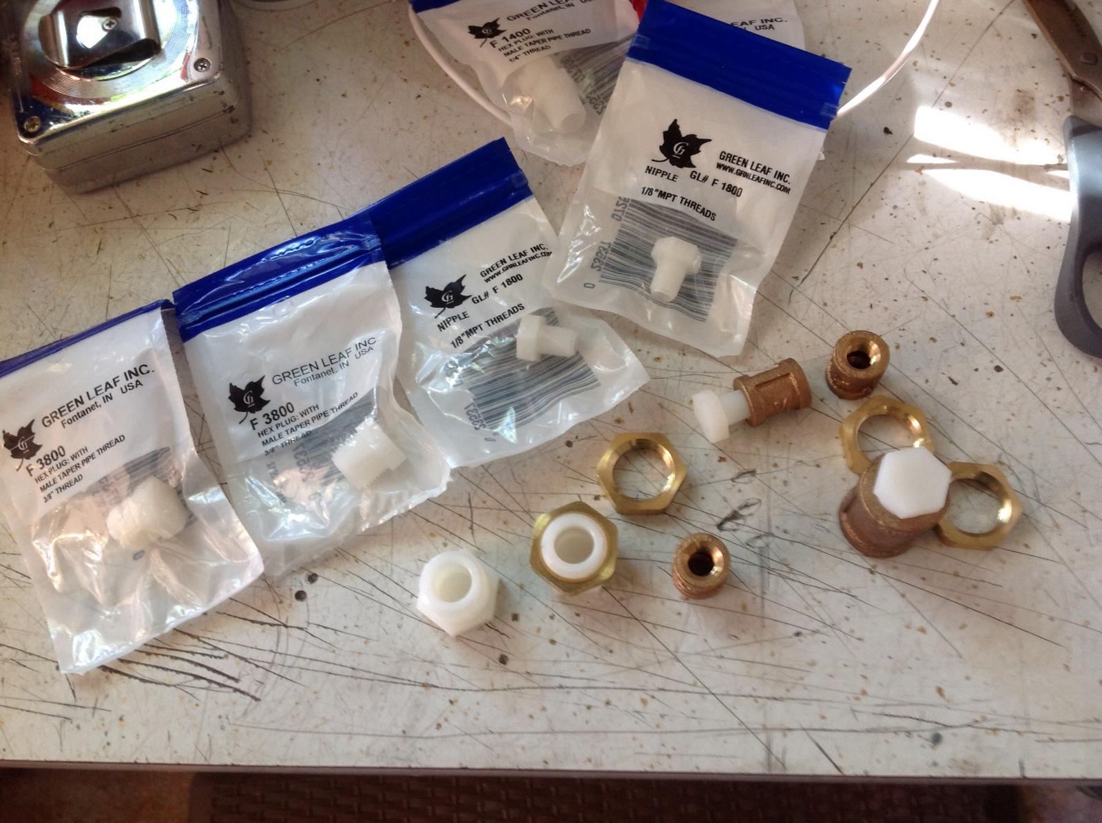

No, I want something long lasting, something simple, something easy to create and something off the shelf CHEAP!
I want nylon, and I want stainless steel without the fragile little connectors to each headlamp bulb.

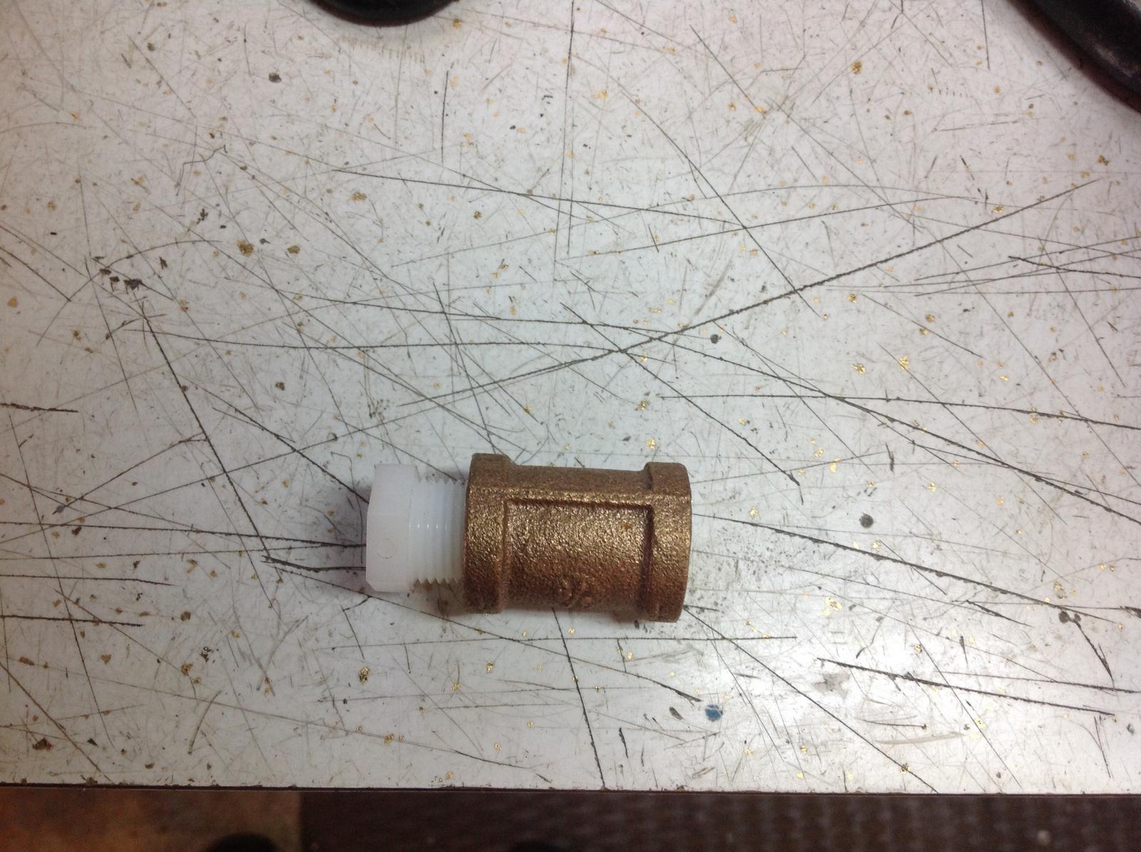

The brass plumbing plug...... I like that idea! They screw into the housing and a thread is cut for screw with the washers to hold the lamp.....I like that Idea...... The fuel hose concerns me because of decay but not totally eliminated....... The brass plugs will corrode and seize onto the threaded screw, be it ferrous, brass, or stainless steel, I've seen this all too frequently.
Ok..... Here it is!
Nylon thread hex head plumbing plugs!
The top hex is about 1/8-3/16" thick, enough to hold a thread cut into it.
These plugs are available in a variety of sizes.... 1/8" 1/4" 3/8" 1/2" 3/4"......
I found that the 1/8" the 3/8" and the 1/2" all fit into the headlamp bucket without modifying the bucket!
Only the 1/2" plug screws into the housing, the others are sized to slip I tot he existing holes.
I need to hold the nylon plugs in....... Hmmmm..... Nuts on the back side! Brilliant!
But....
They only make a 1/2" pipe threaded nut..... Ok I'll buy them, what about the other two sizes.........
Hmmmmmmm
Bronze pipe couplers! Threaded both ends......cut a little off to make nuts!
My shopping pile........

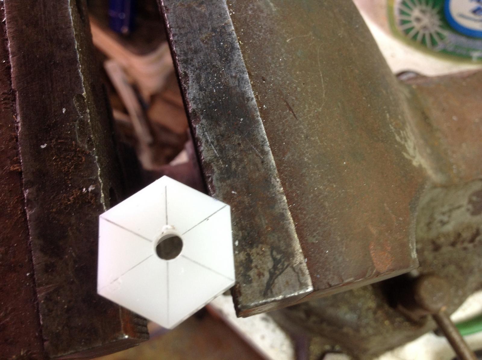

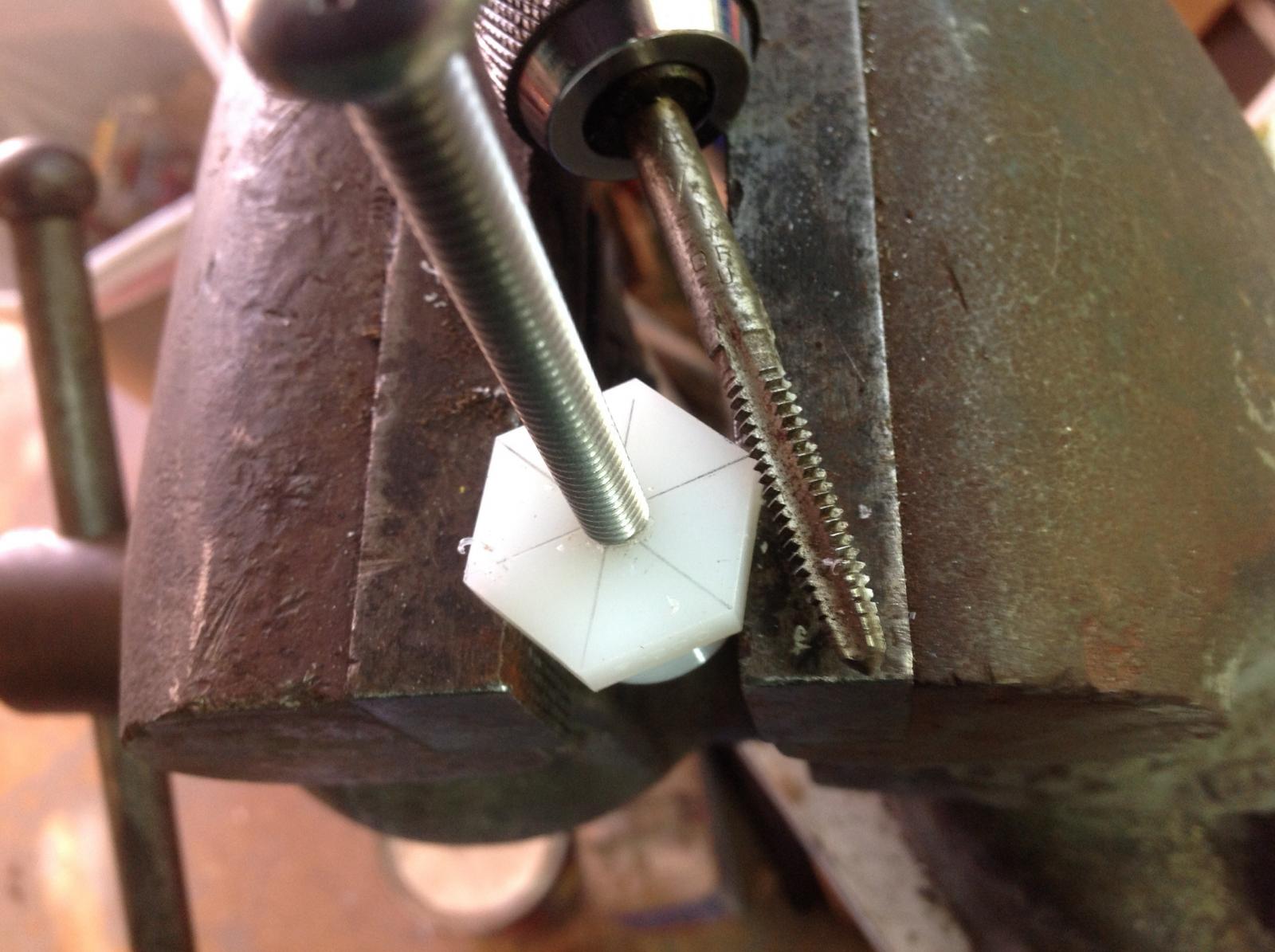

Ok, I need threaded holes in the nylon plugs....... Easy! Just connect the six points with a line across the center, where they all intersect is dead center!.......
Center punch the center and drill a #3 sized hole (tap drill size for 1/4-20 threads)...........
I used a 1/4-20 tapered tap and did not run it fully through to give some tight threads in the nylon to help prevent vibration from changing the adjustment as you drive........
I did this for all 12 plugs for both sets of headlamps.

The 1/2" plugs I got "nuts" for, the other two sizes, I have to make nuts.
No problem, I've got the bronze coupler..........
I clamped them gently in the vice and sliced off both ends making a pile of bronze "nuts" for the thread sizes I need........
I then put the nylon plugs into the holes as required and threaded on the nuts to hold them firmly in place........(all of the holes are not used)
Front side........
Rear of housing showing the nuts.......
I then took my 1/4-20 stainless screws (I used 3" but they were too long, purchase 2" screws) slipped a stainless steel washer over the screw head......
Slipped the screw into the hole in the lamps.......
Slipped another stainless steel washer on the back.....
And threaded on a stainless steel nylon locking nuts squeezing the lamp gently between the washers........ Loose enough to turn, tight enough to not vibrate........
I then screwed the screws into my modified nylon plugs.........
I mounted the assembly back in the Van.....MAKE SURE THE SCREWS DO NOT PROJECT INTO ANY WIRES BEHIND THE LIGHT ASSEMBLIES!!!!!!!!.....
And put the grill back on........
The new screws allow you to adjust the headlamp aiming without having to remove the grill.......just like the factory design!....... You can see the screw heads visible .........
Material list.......
6 - 1/8" Nylon Plumbing Plugs
2 - 3/8" Nylon Plumbing Plugs
4 - 1/2" Nylon Plumbing Plugs
3 - 1/8" Bronze couplers
1 - 3/8" Bronze Coupler
4 - 1/2" brass nuts from the plumbing supply house
12 - 1/4-20 x 2" Stainless Steel Phillips Headed Screws
12 - 1/4-20 Stainless Steel Nylon Lock Nuts
24 - 1/4" stainless Steel a flat Washers
#3 drill
1/4-20 Tap
Hacksaw
Pliers, Screwdrivers and wrenches as needed.
Drill
The whole supply pile set me back maybe $25. Still a fair amount of coin but consider this will last for a mightily long time! If it does fail, it will be a $1.50 Nylon plumbing plug! You win't be buying $83 worth of hardware yet again!
