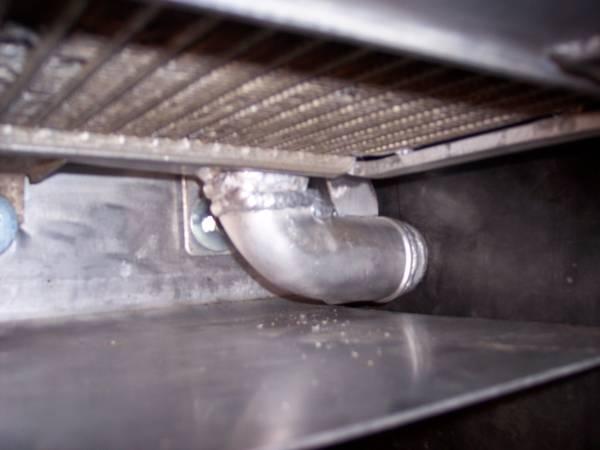

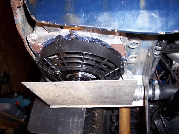

AndyBees wrote:
OlisGarage wrote:
I'm interested in hearing how it performs! I know markward and a few others have cut out the bottom of the d pillar and generally report descent performance.
Below is a pic of how I set-up the air-cooled Inter Cooler for my ALH TDI.
The Inter Cooler is isolated from the engine bay. You are looking through a piece of plexiglass. The Inter Cooler has a fan mounted on the bottom which pulls air downward. I fabricated a cover forward of the fan to protect it from road debris coming off the left rear wheel.
You can also see how I modified the EGR on the Intake. Where the valve stem was located, I tapped the hole to install the Turbo pressure fitting.

AndyBees
Joined: January 31, 2008
Posts: 2621
Location: Southeast Kentucky
AndyBees is offline
PostPosted: Fri May 16, 2025 2:06 pm    Post subject: Re: Oh no! Another Vanagon TDI swap Reply with quote
1988M5 wrote:
AndyBees wrote:
Well that's different and cool (pun?). Ever think about putting a video cam facing it and injecting some visible smoke to see the air dynamics? Possibly running an elephant ear backwards to see if it could PULL the hot air through it (Venturi effect)?
BK
There is obviously a fan mounted on the bottom of the Inter Cooler. The plexiglass keeps the engine bay hot air out. On the highway, the OE top vents direct air into the well (ram affect, I suppose)
Also, the fan is protected from debris off the highway and left rear tire with two pieces of aluminum sheet metal. It might have the elephant ear backwards affect. It is simple and does show a substantial reduction in IAT temp compared to the ambient air temp.
Below are the only two photos in my Photo Gallery of that set-up. (These are rather old photos. I did clean it up a bit later.)
Without the fan installed
Below with the fan installed
