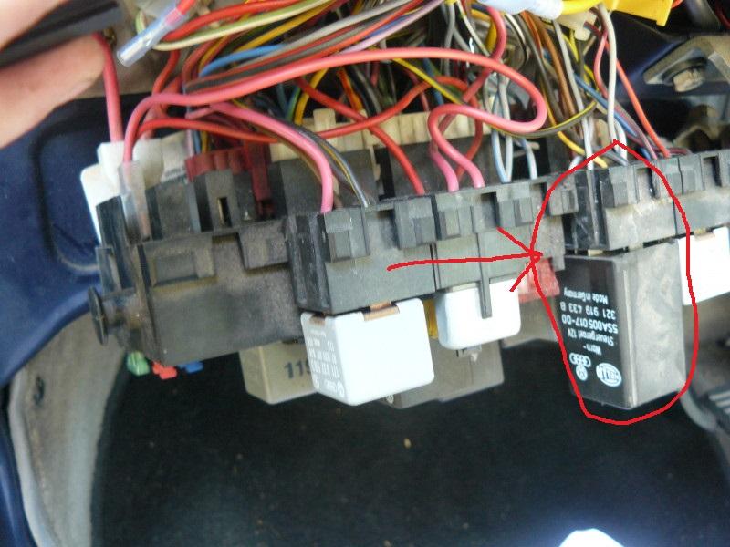

PostPosted: Mon Mar 03, 2014 11:41 am    Post subject: Fuse Box Relay Reply with quote
Allo friends,
While installing some headlight relays in my wife's 89 Bluestar this weekend I noticed an empty fuse relay holder. When checking the forms today for work comparisons and things to watch out for I noticed this photo and the large relay that is absent from my wife's fuse box:
Can anyone ID this relay and tell me what it influences?
Thanks,

I think that is a seatbelt/door chime relay?

PostPosted: Mon Mar 03, 2014 4:38 pm    Post subject: Re: Fuse Box Relay Reply with quote
DeadSetMonkey wrote:
door chime relay?
yup. The annoying La Cucaracha noisemaker that goes off when the keys are in the ignition and the driver door is open.
You aren't missing anything.

Thanks guys, agreed, no need to track one of those down, and it explains why it is missing in the first place.
