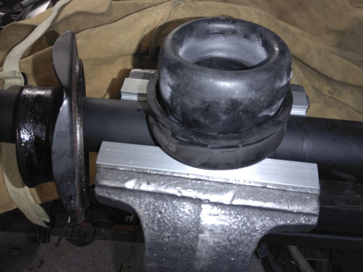

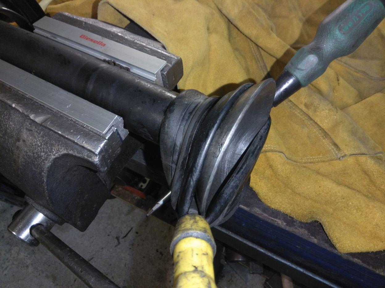

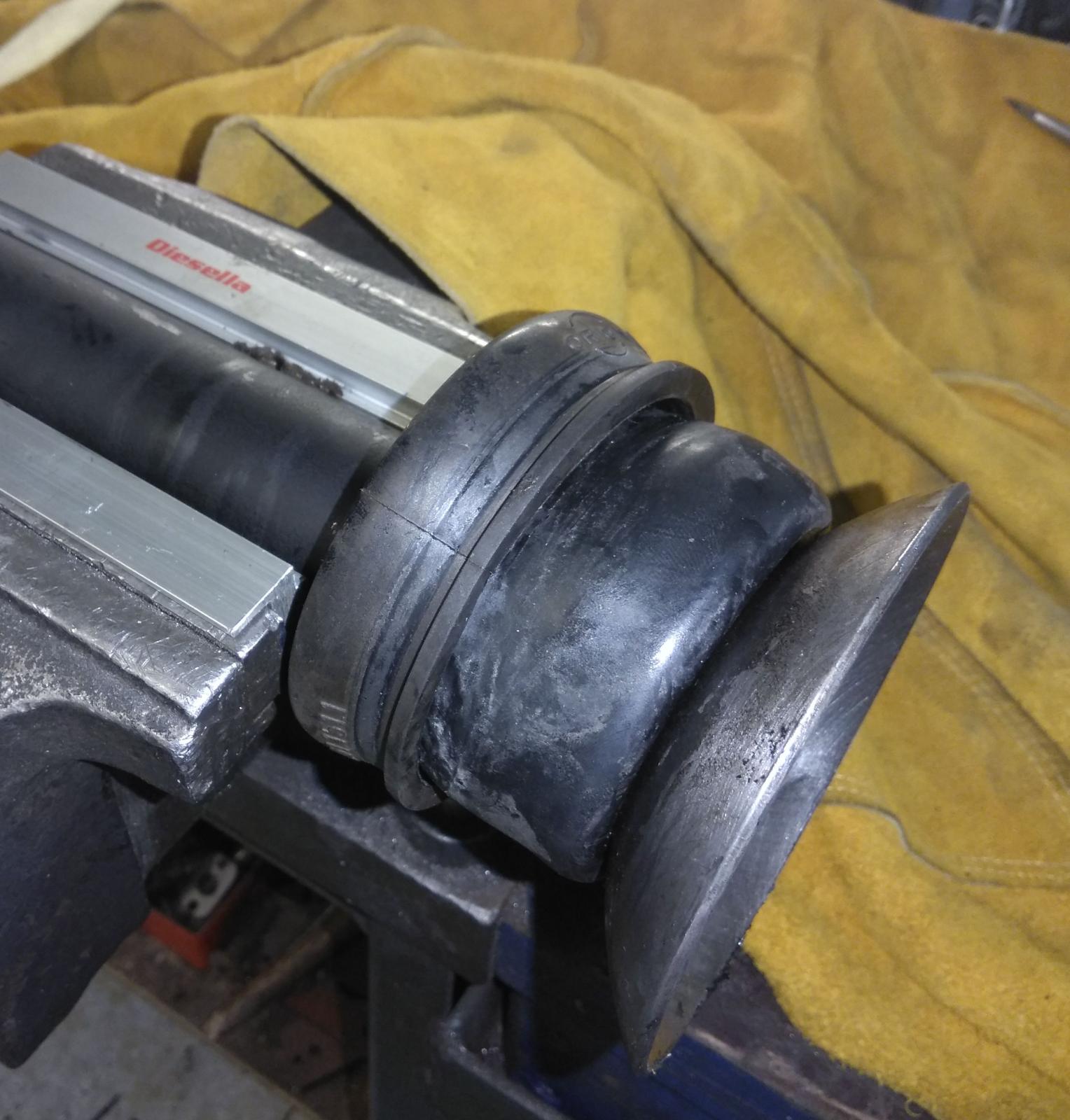

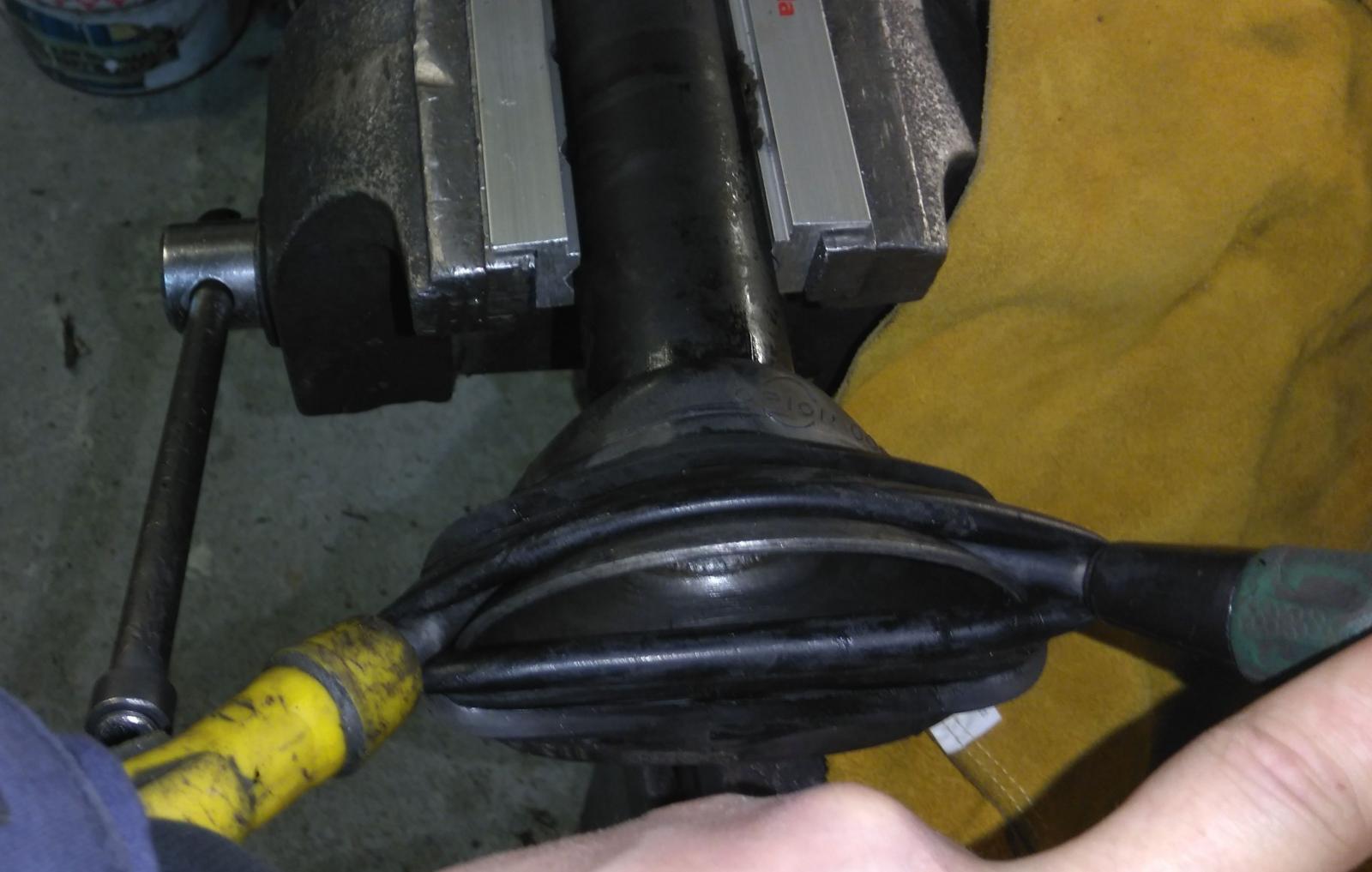

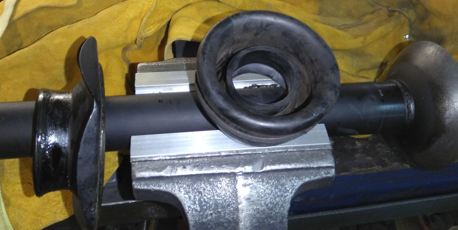

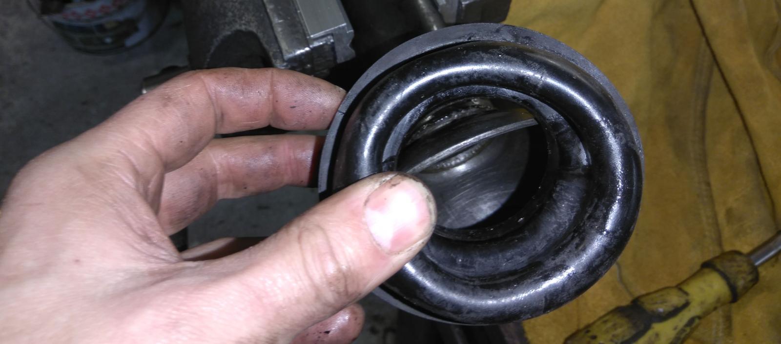

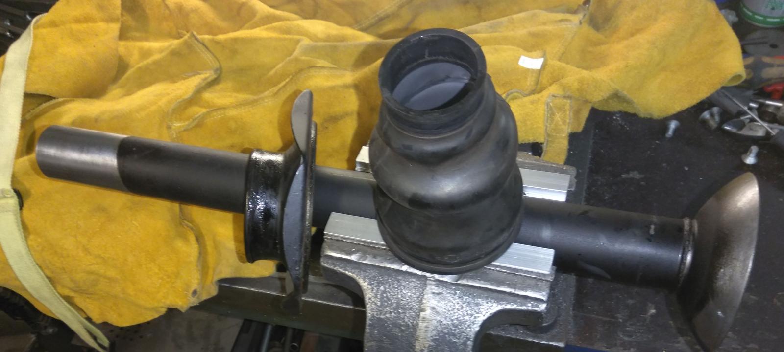

I took couple of pics.
It was too easy just push the rubber on the other end Smile
Turn the rubber like this
Put it correct way on the tube flange
Push two long flat head screw drivers so the the ends are behind the tube
Then just let it go easily
Then just turn the rubber correct way back. Ready!
Mika

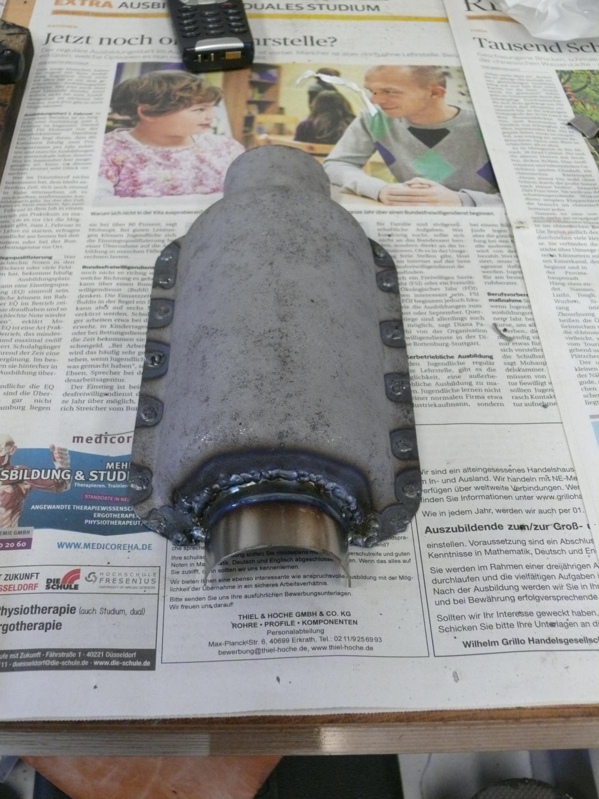

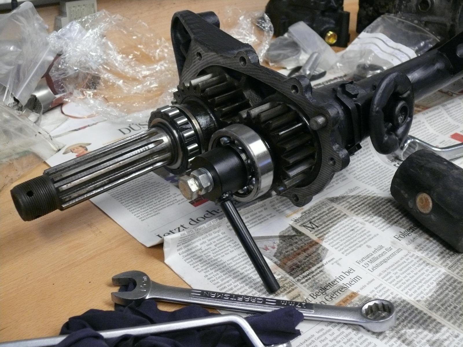

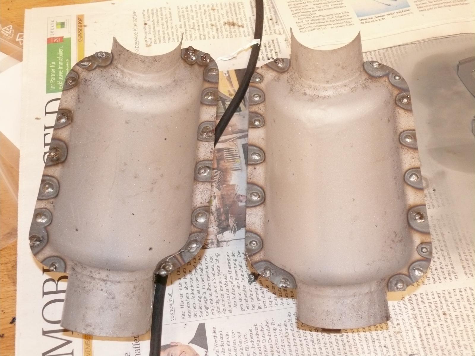

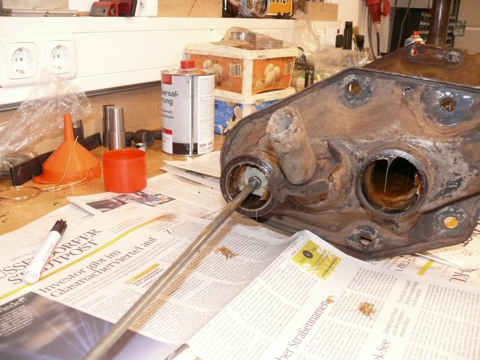

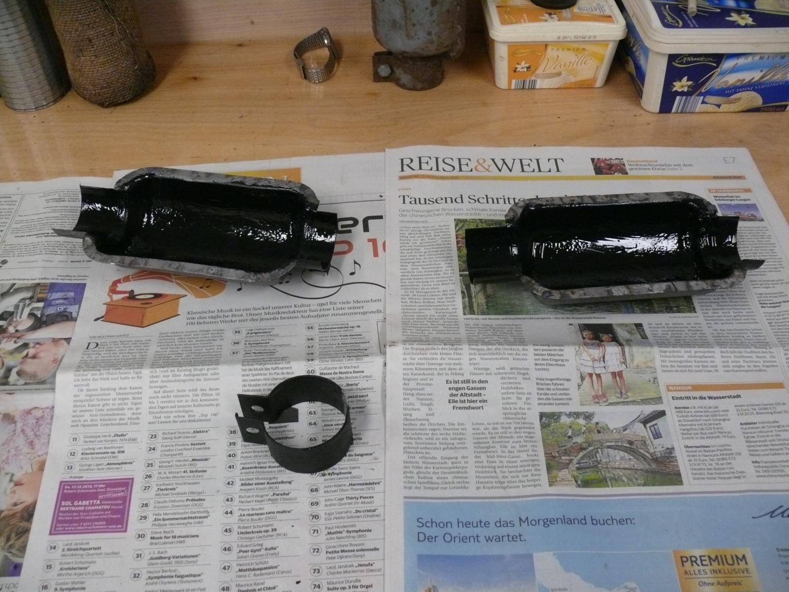

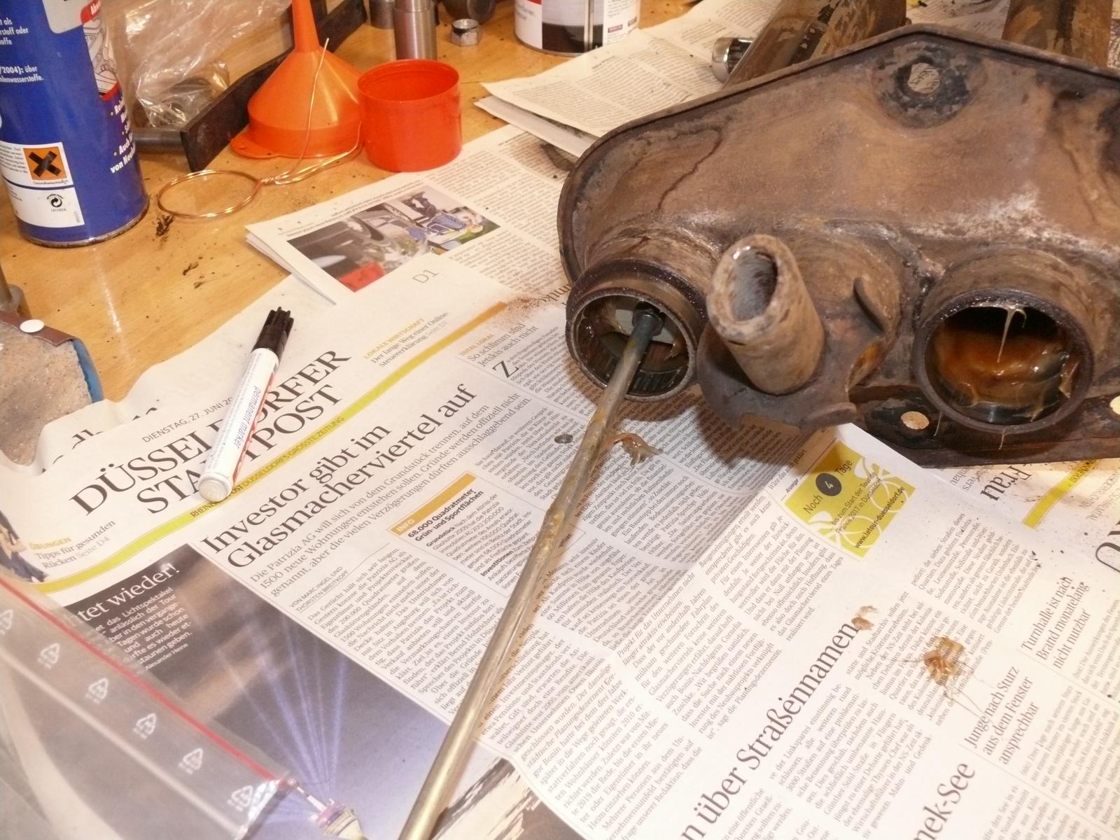

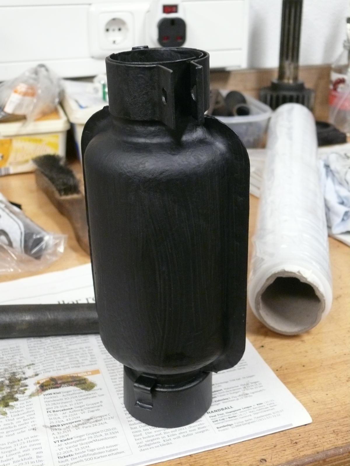

I finished rebuilding one of the heater silencers. I sand blasted the parts inside and out. Then I welded up the holes and replaced the ends on the side with the adapter from 50 mm to 62 mm.
All parts are basically ready for reassembly, but this time I am going to paint the inside.

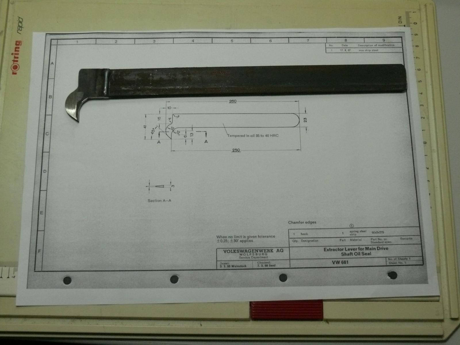

Then I made two more tools.
1. VW 690 "Installing Device for Rear Axel Shaft Ball Bearing"
2. VW 681 "Extractor Lever for Main Drive Shaft Oil Seal"
I am also almost ready to put the rear axle back together. I cleaned everything installed most of the bearings. Sorry no more pictures yet. I will make some before putting everything together.
I do wonder if it would make sense to flip the drive shafts from left to right, because there is some visible wear on the paddles. Any thoughts on that? Both sets of drive shafts which I have show the same type of wear.
I am sure it'll do many more km if I install it on the same side, but if I switch sides the wear would be more even.

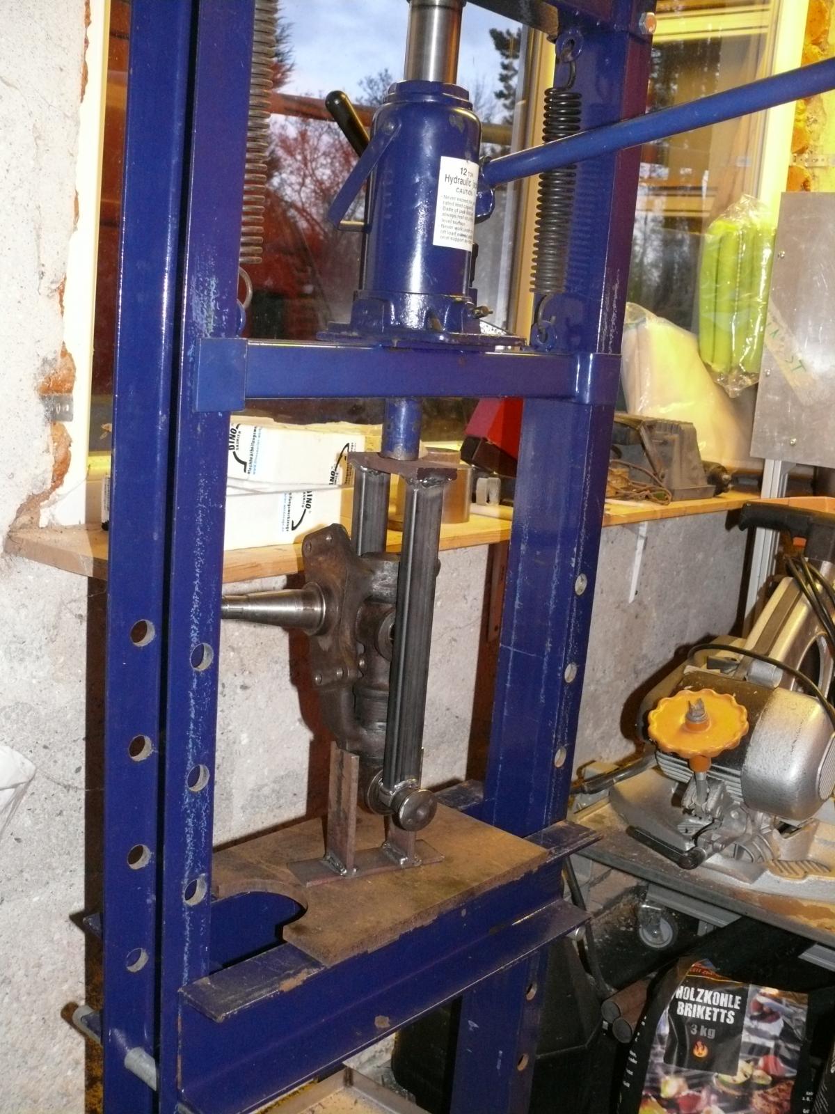

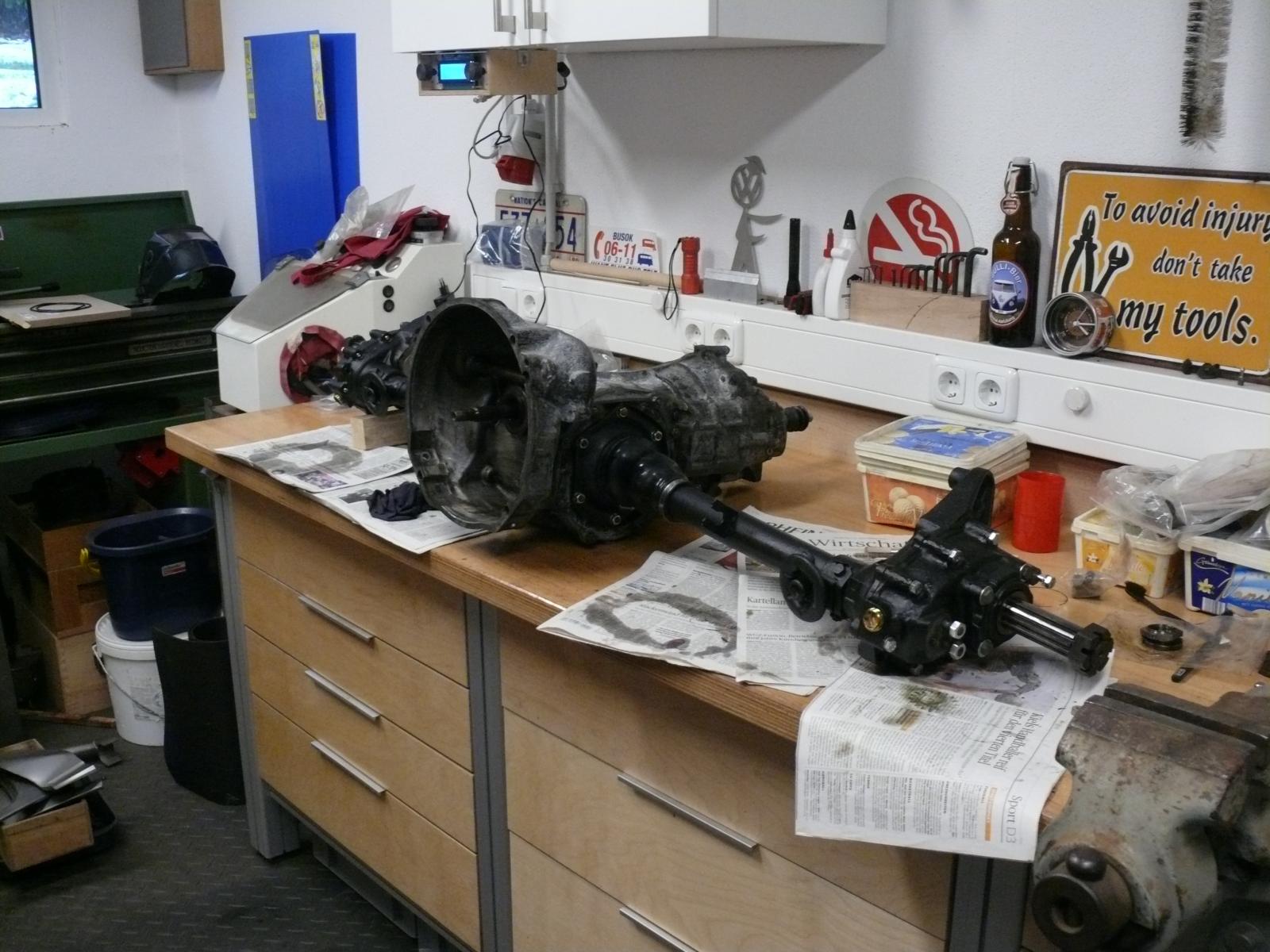

Some more progress. Finished the transaxle. I decided to swap the drive shafts and the differential gear that goes with it from left to right. That way I will put less wear on the already worn paddle.
Today I made a new set of tools to pull apart the kingpins. This worked nicely and I was very please to see, that the parts had survived the last couple of decades since I had to replace them in the 1990ies.

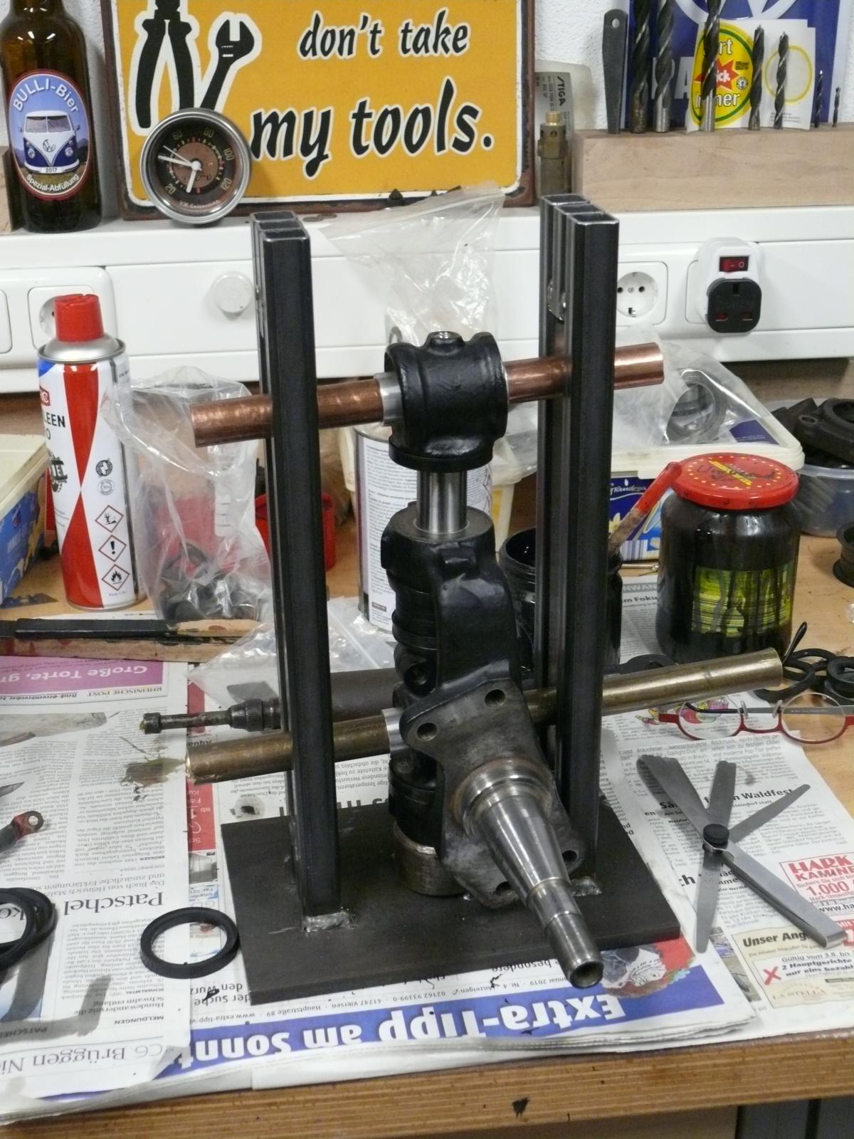

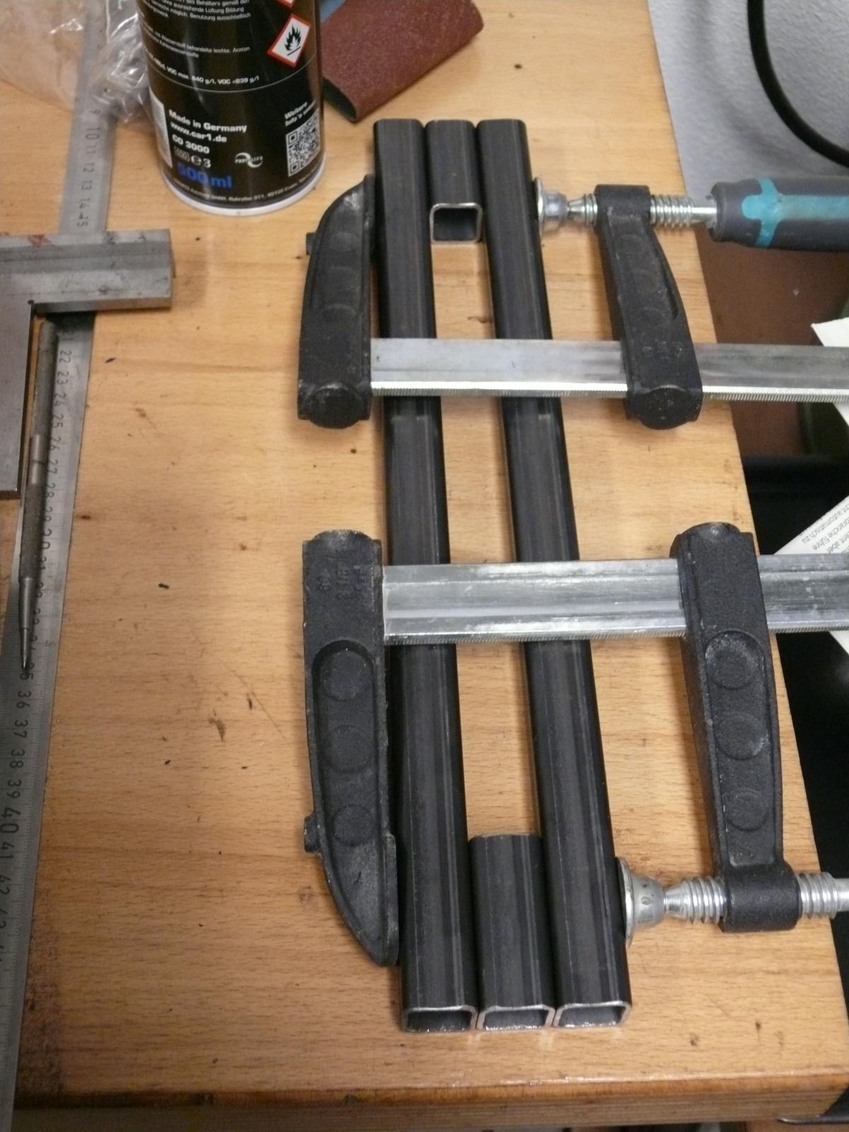

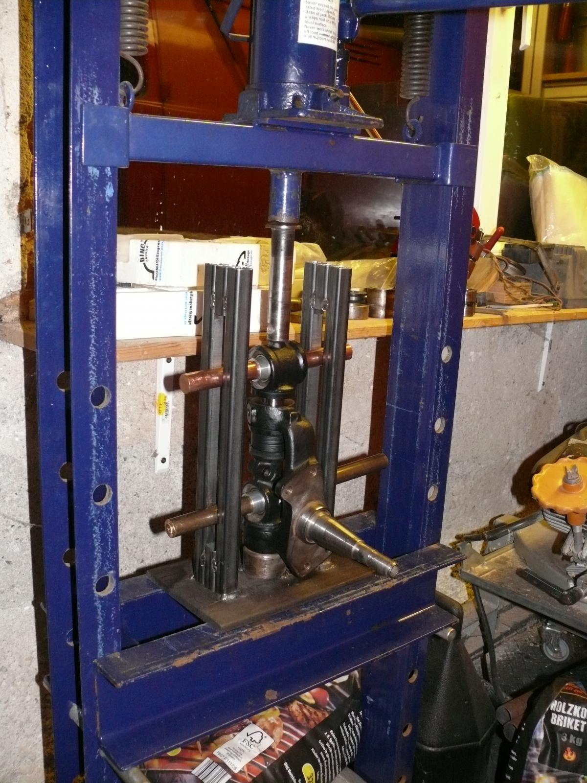

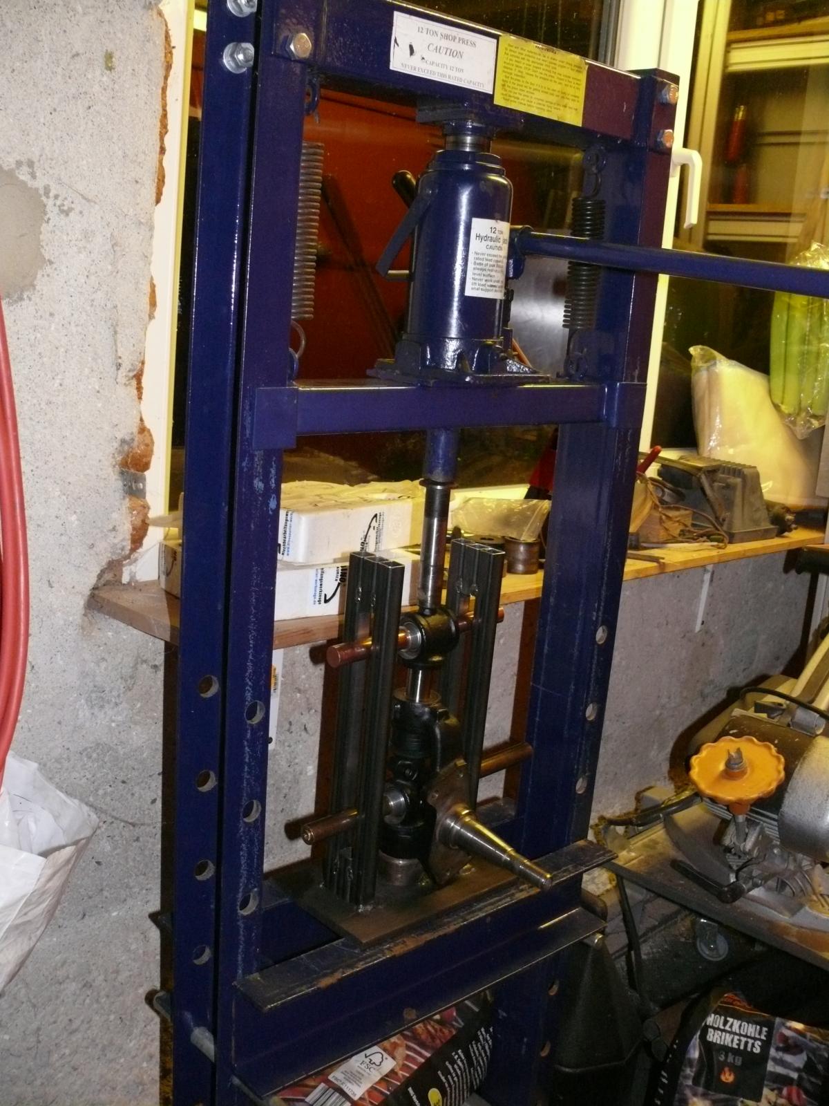

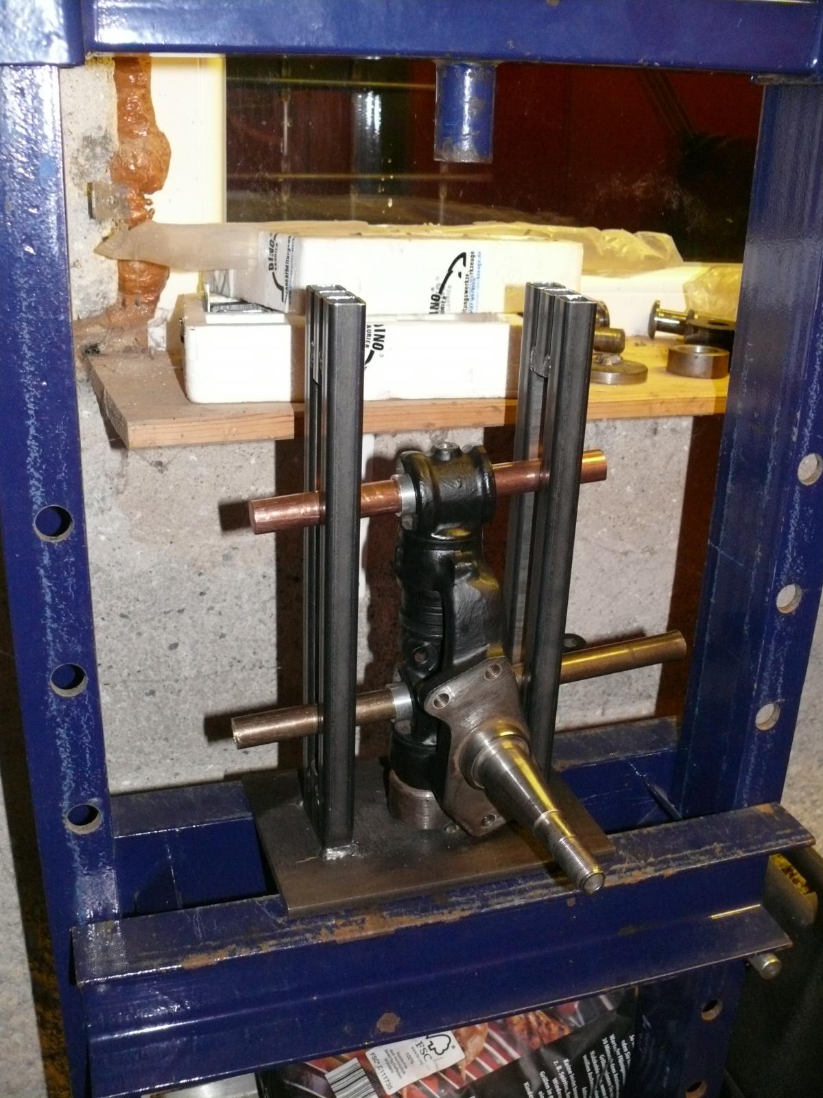

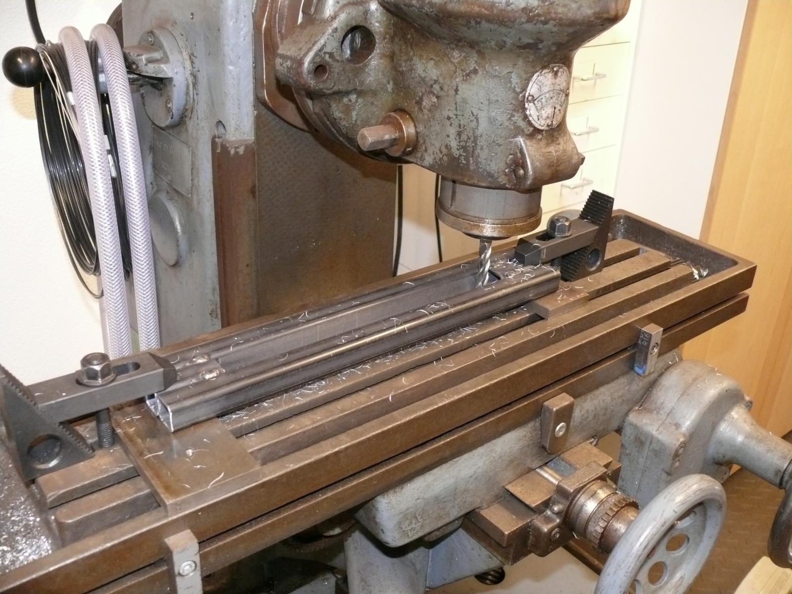

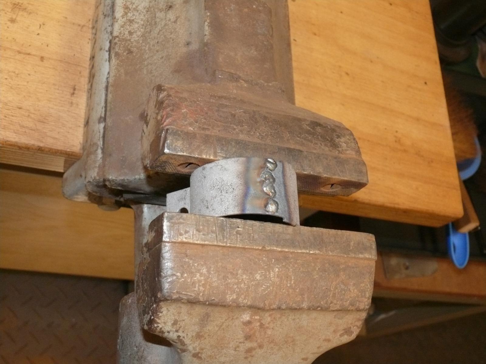

Swissbulli asked me about the tool to line-up the spindles when pressing them back together again. Therefore I decided to get it done. Turns out it took me longer, than I had anticipated.
I used 20mm square tubing and I figured, that i would get a slot 20mm wide to guide the 20mm round stock to keep the kingpins from twisting.
Cutting the tubes:
I welded the tubes together like this:
It turned out, that the tubes warped slightly and the slot was just too tight for the 20mm diameter round bar.
I had to fix that using my trusty old mill:
Tomorrow I will weld the parts together like this:
- Michael

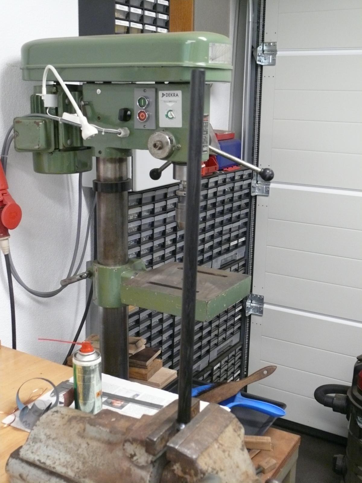

PostPosted: Sat Feb 09, 2019 12:32 pm    Post subject: Re: Restoration of a former '65 firetruck (21F) Reply with quote
I finished the jig. But I also had to make some sleeves to adapt the 20mm rods to the eye of the king pins. I thought I could use the needle bearings but that was too tight.
I know I should have 22mm link pins, but when I had to repair the front axle in the 90ies I couldn't get the right parts. Therefor I had to be creative.
- Michael

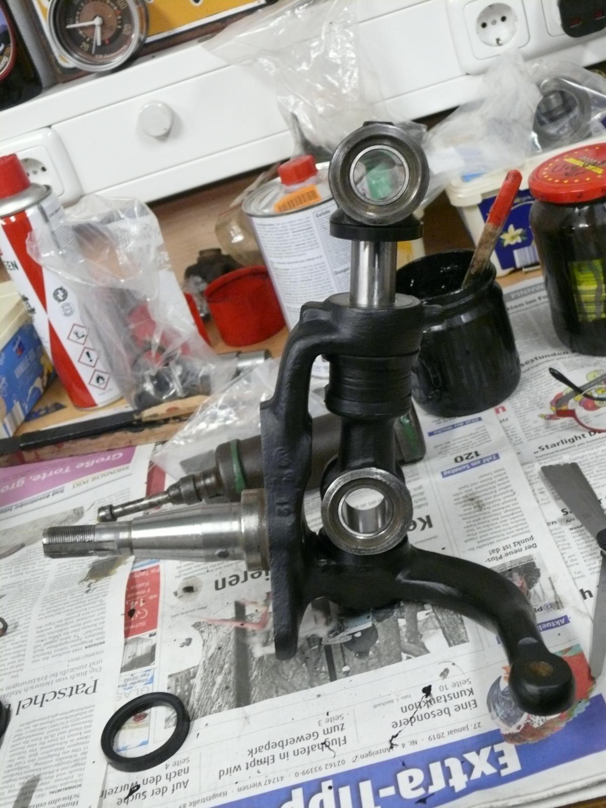

Today i finished rebuilding my front spindles.
- Michael

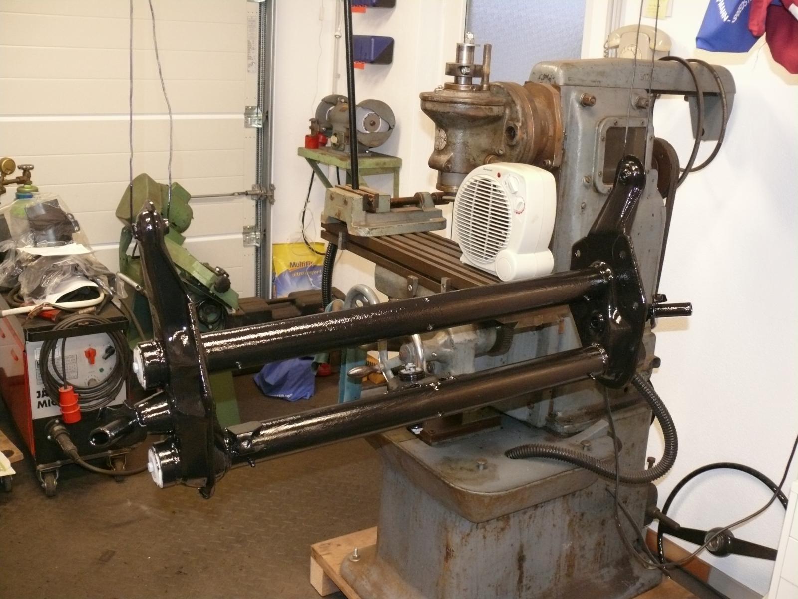

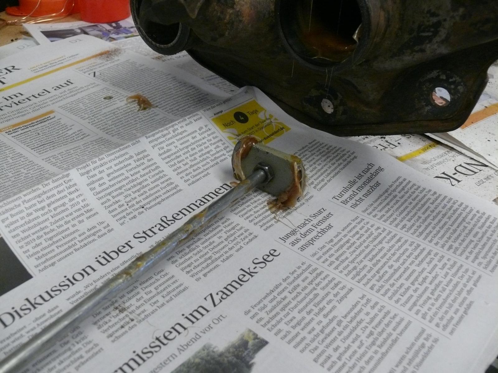

Last weekend I pulled the front axle beam apart and dragged it to a place to have it sandblasted. I should have it back on Tuesday.

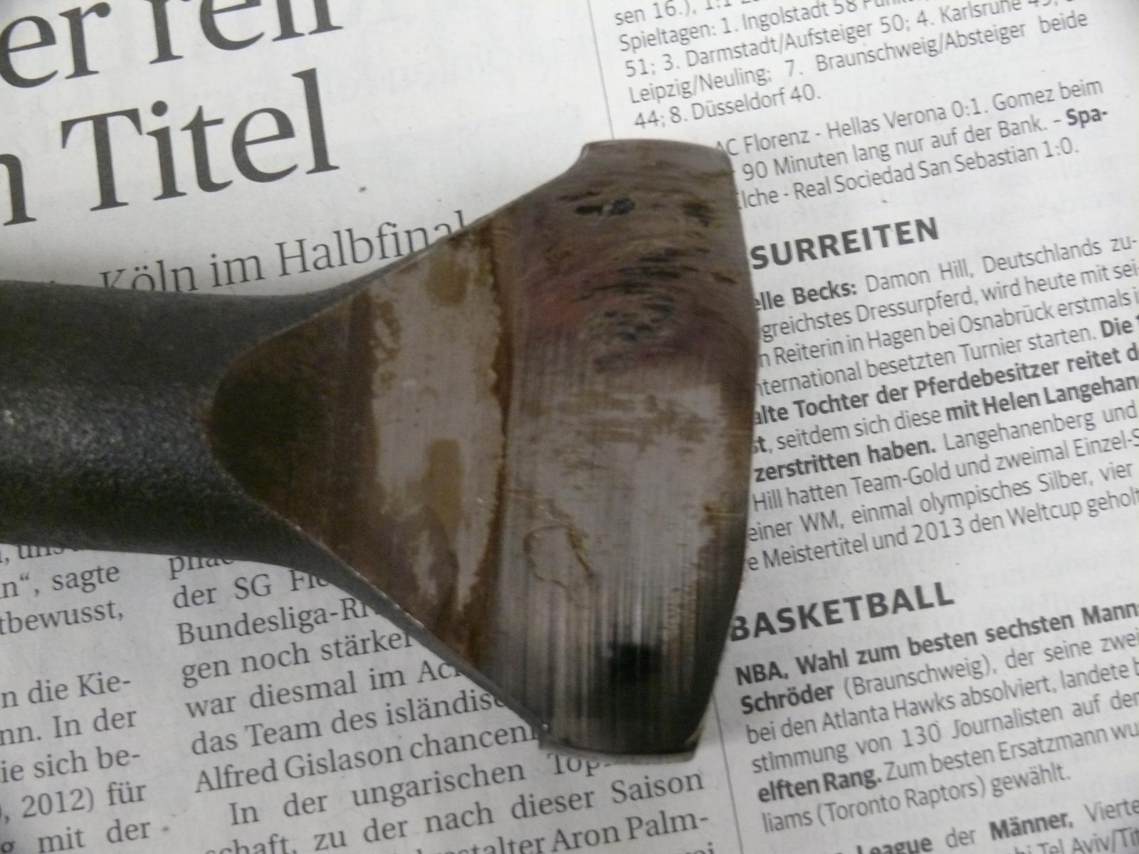

I extracted the needle bearing using this tool:
Then I made wooden plugs to close off the tubes. I don't want the blasting media in the tubes with the grease. Had that problem on a friends axle. Definitely no fun! I'll post pictures of that once I get the axle back.
I also did some other random stuff like sandblast and paint the tierods and rear break drums.

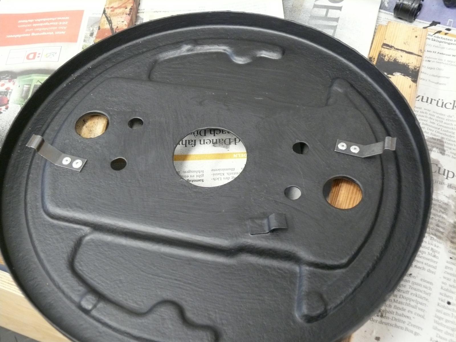

Finished the front backing plates by installing the new springs which stop the adjuster from turning.

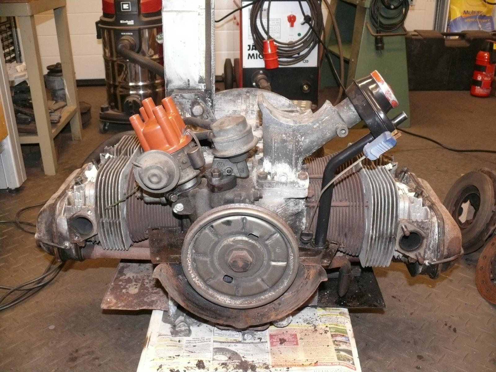

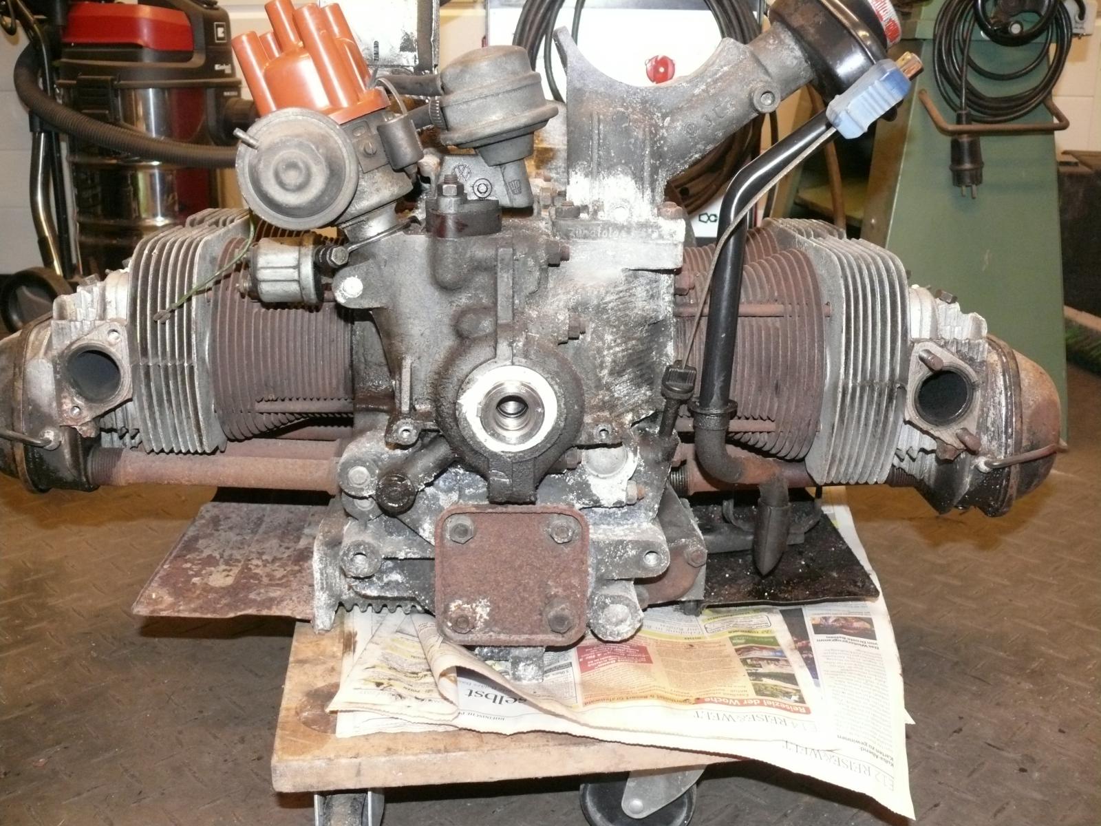

This is a dual port 50HP motor which came from a 1979 bus. I rebuilt it with new heads 53000 km and 25 years ago. I will clean it up on the outside, replace some of the engine tin but I won't take it apart for now. It is hard to read but the case is stamped with AS and the recycling symbol. I doubt the case had been recycled, I must have been new I has never had an engine number.
Some of the crud that was left after I removed the engine tin and exhaust system.

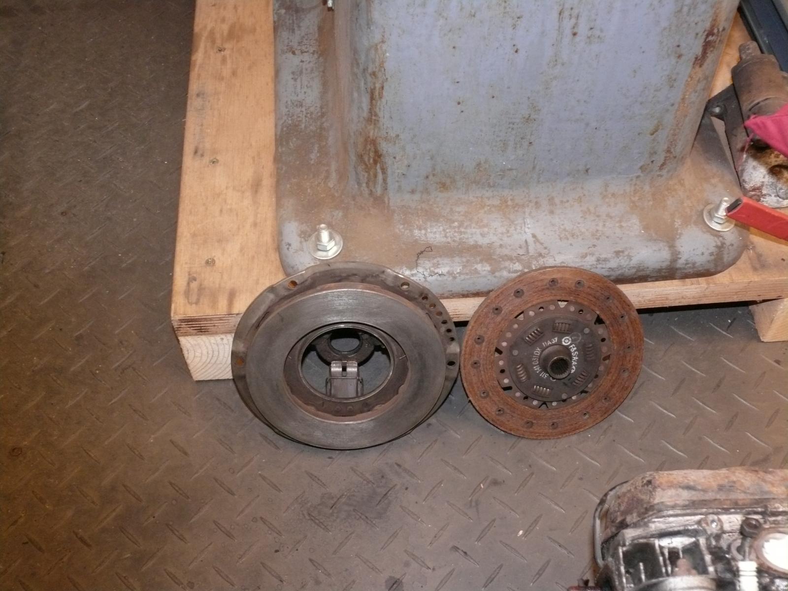

Then I cleaned the flywheel and pressure plate. The clutch had rusted to the pressure plate.
Motor with most of the tin gone:

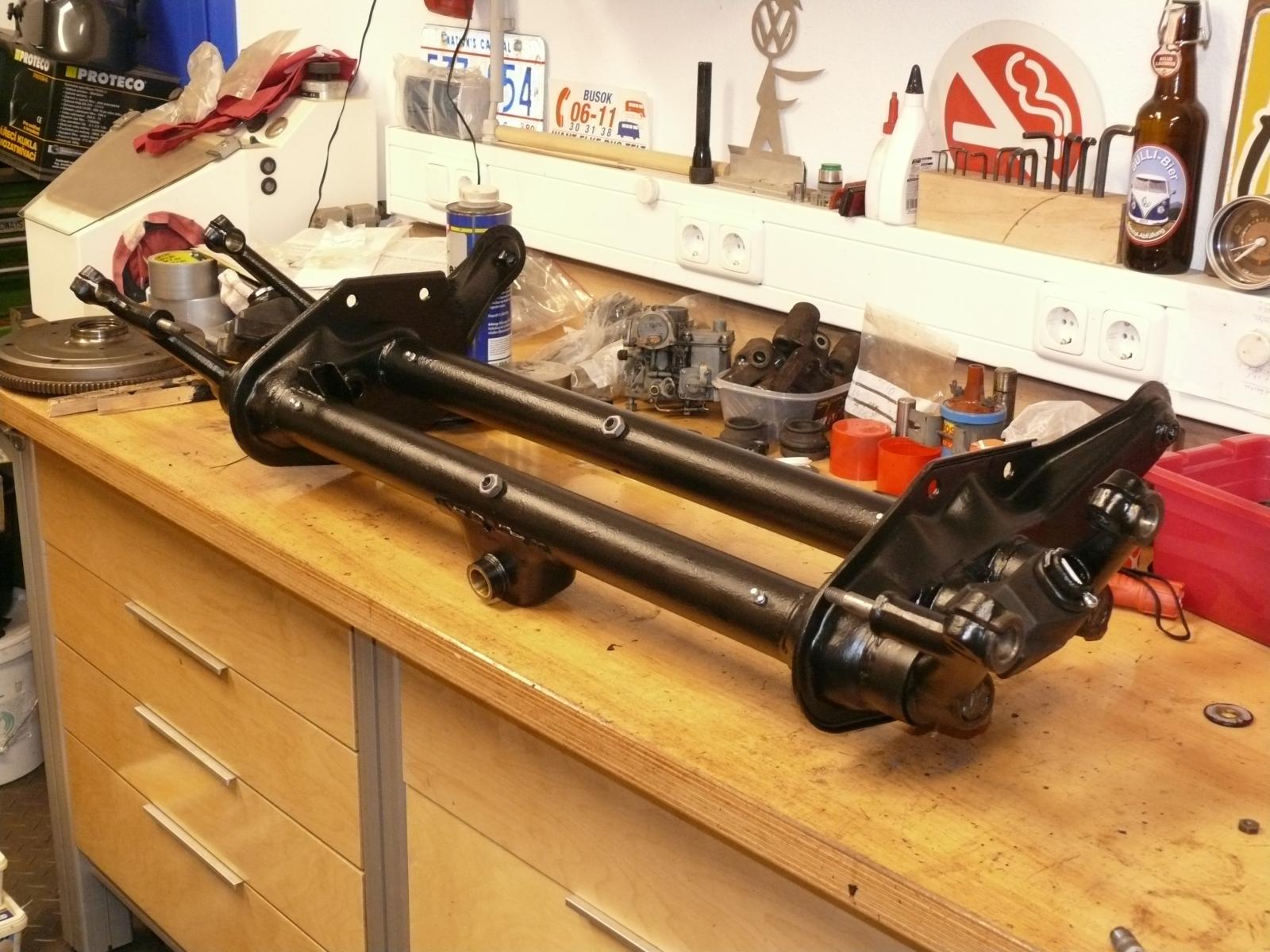

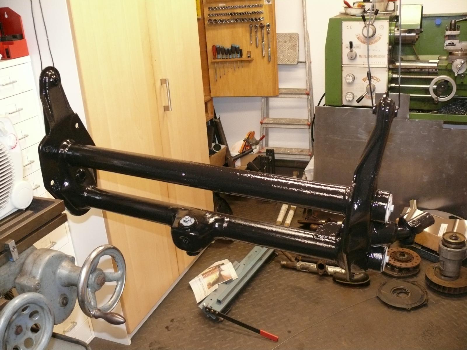

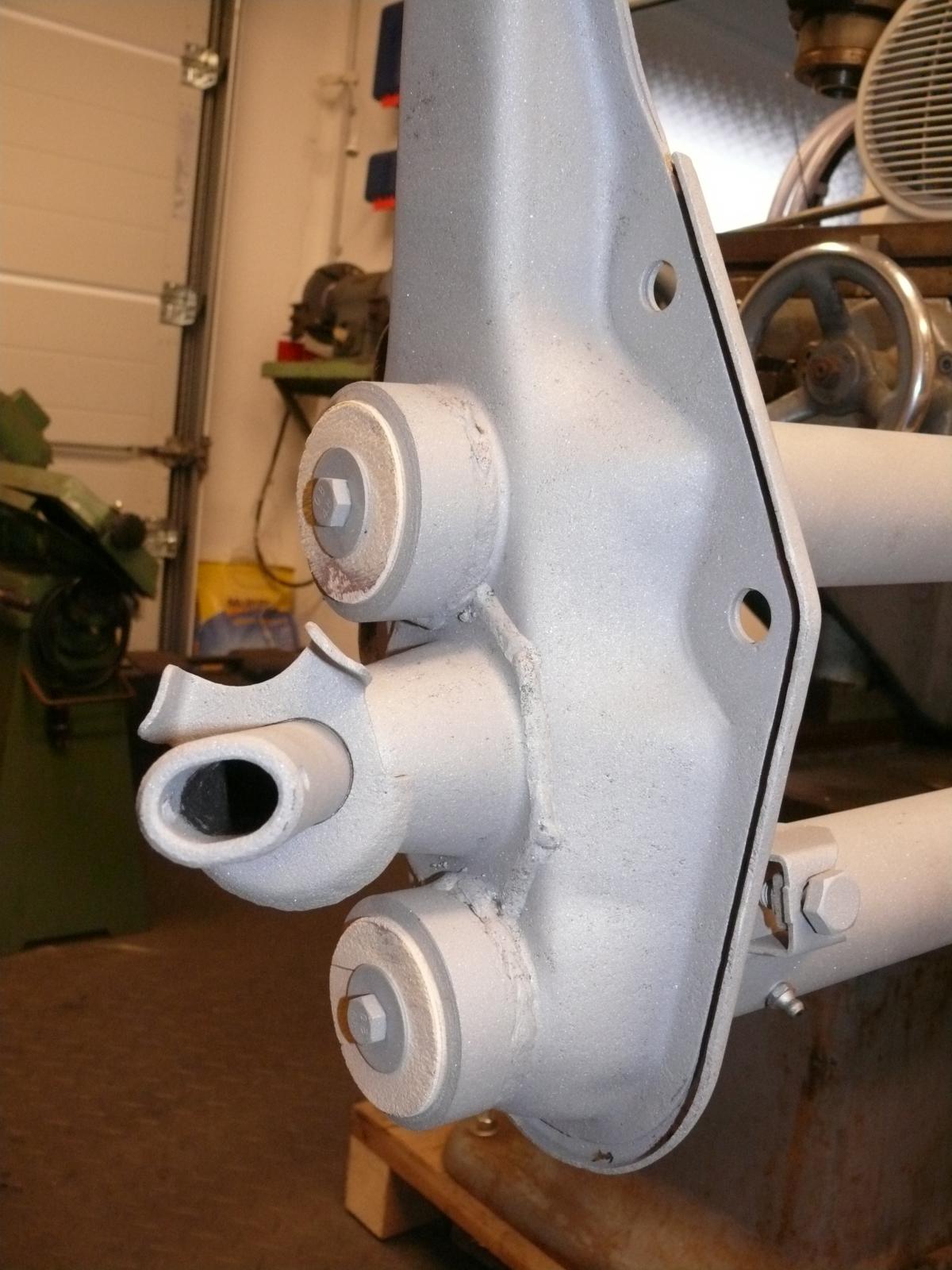

Got my front axle beam back from the sandblaster. Was definitely worth having it done. I payed only €40.00 Very Happy
The picture show how I plugged up the tubes and the link pin bearings
To prevent new rust I coated it with the first coat of Brantho Corrux 3in1
- Michael

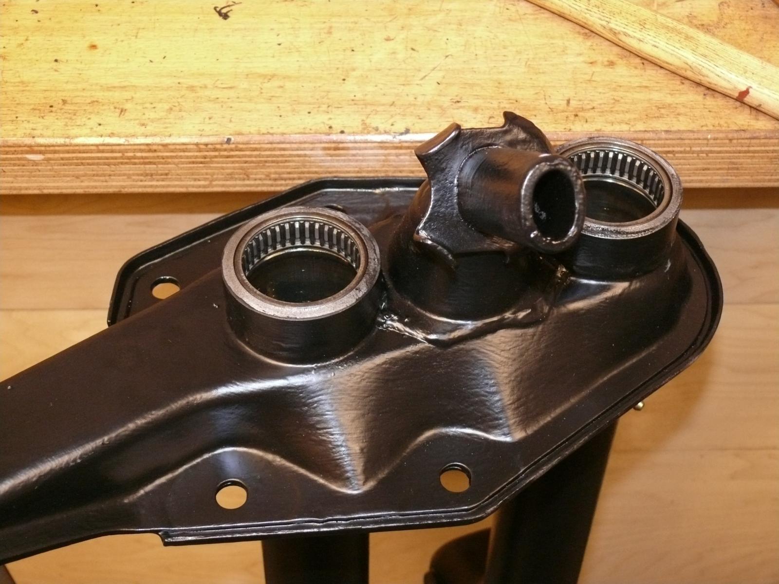

First I pulled the wooden plugs which kept the sandblast media out of the greasy tubes.

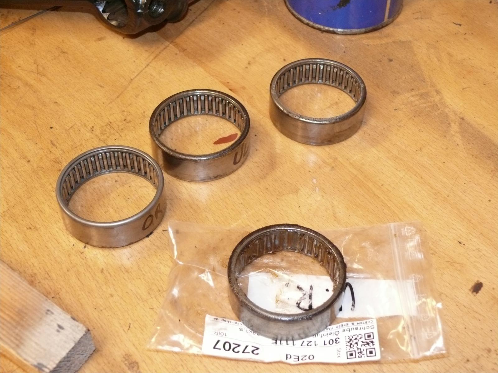

Then I removed as much of the old grease:
And then I cleaned the needle bearings and reinstalled them:
Reassembly of the trailing arms:

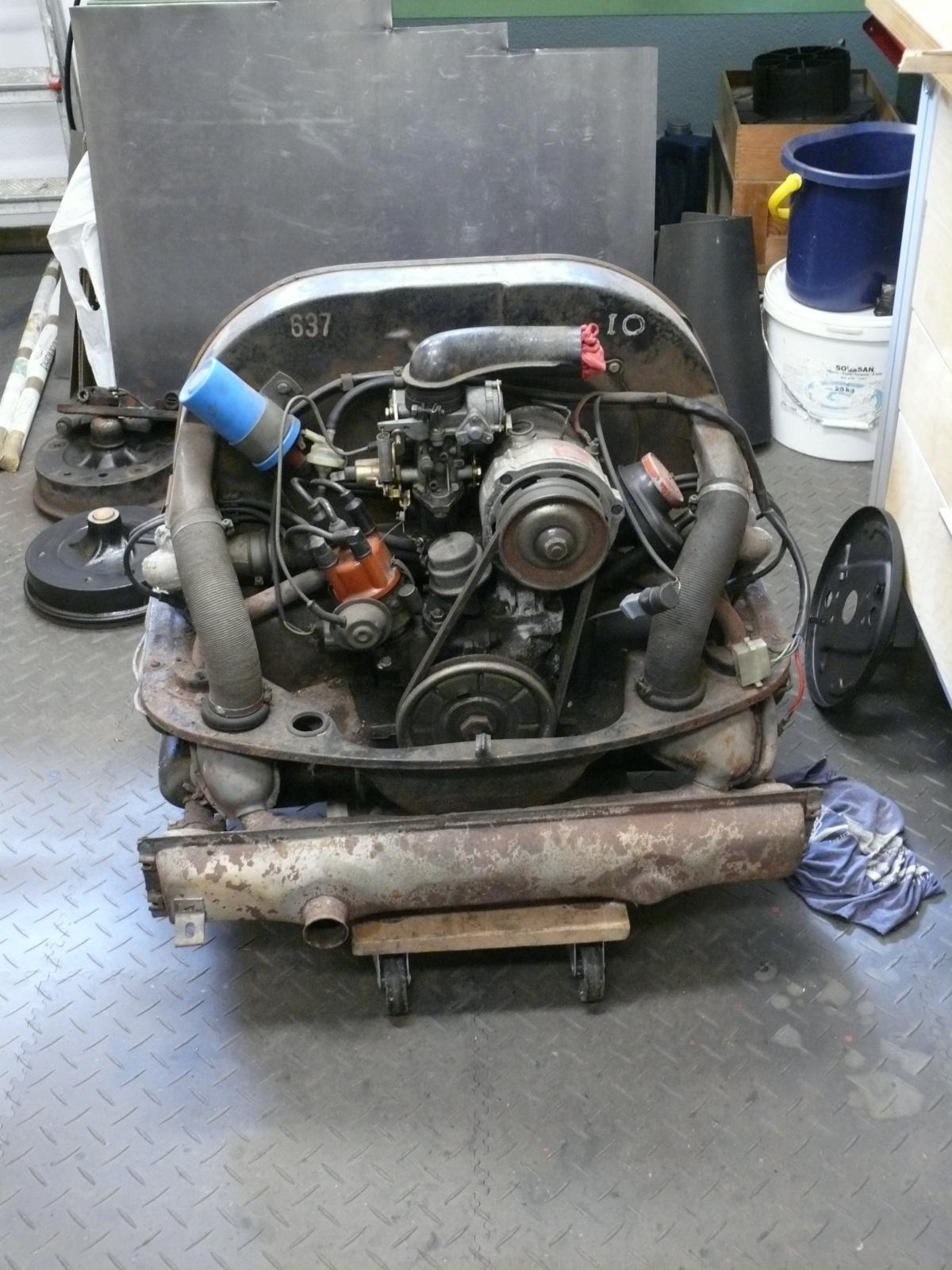

The engine is basically ready to be taken off the motor stand. Unfortunately I can't test run it while it is on the stand.
All did to it was to clean it up and replaced or cleaned and resprayed the tin. Ofcourse I adjusted the valves drained and replace the oil. The carburetor and fuel pump are rebuilt. The wiring harness is new too. Now I need to set the timing and take it off of the stand, and reinstall the flywheel. Then I can hook it up for a test run.

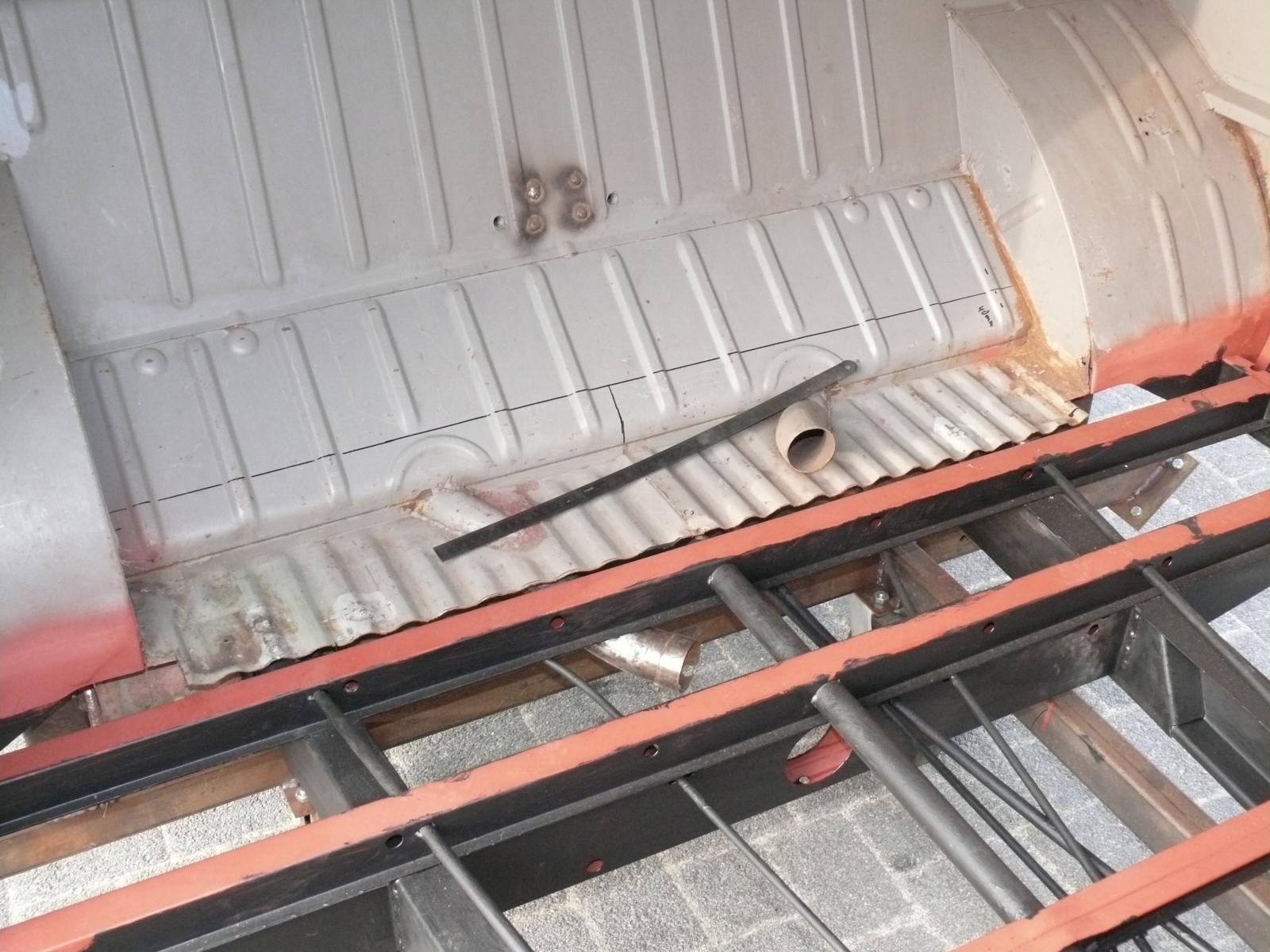

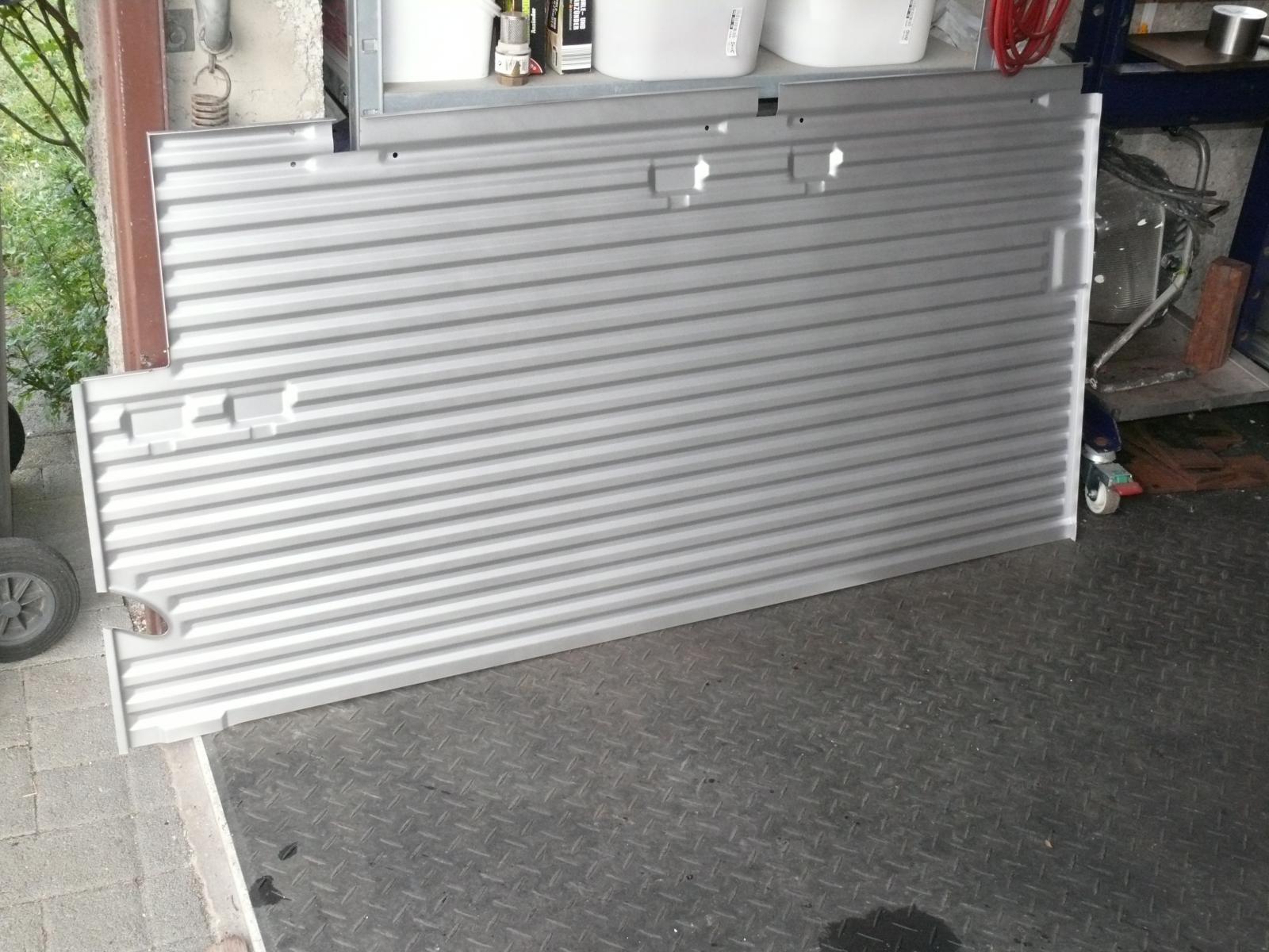

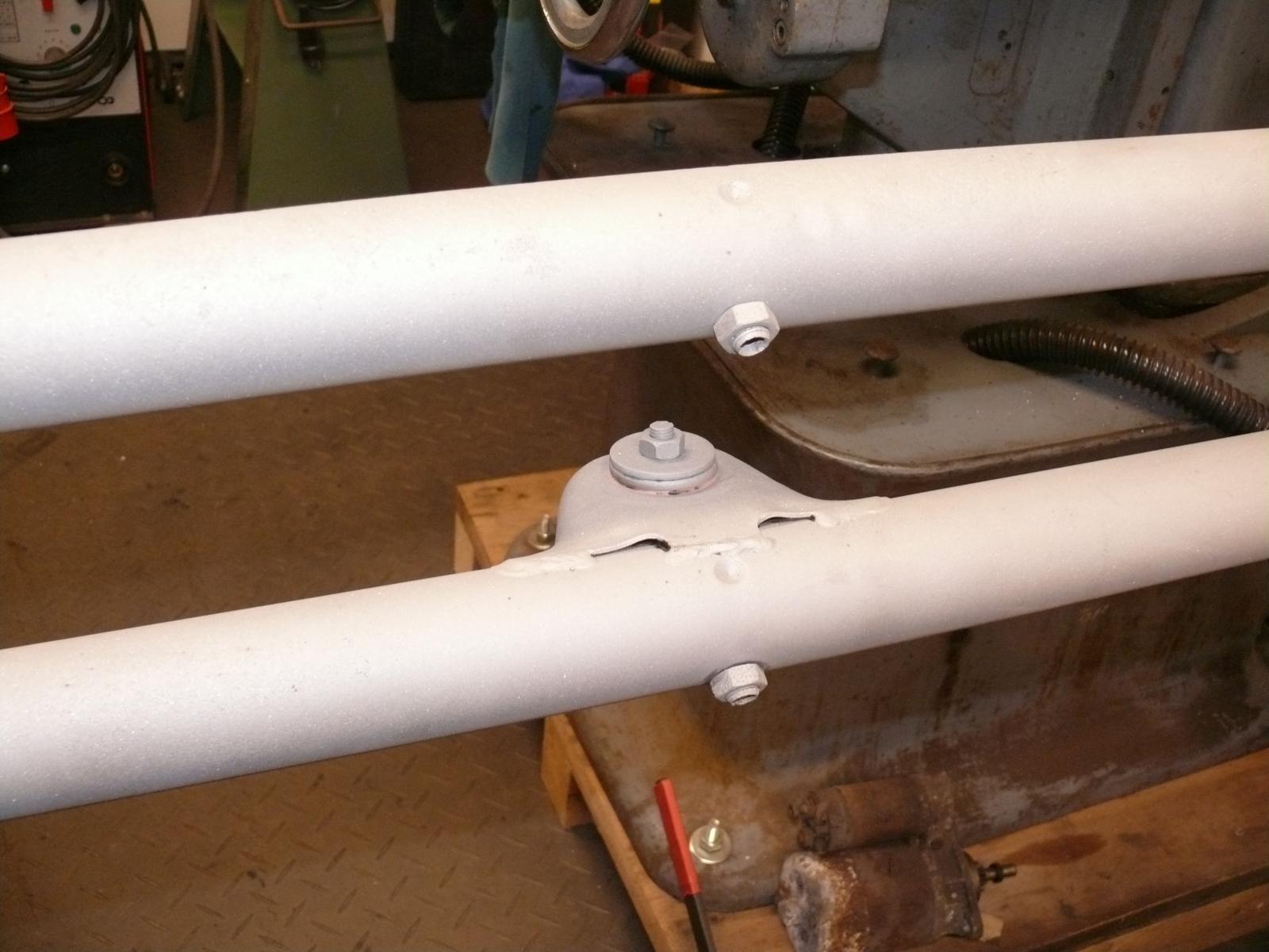

Then I decided to not use the cargofloor which I had bought more than 20 years ago. The new ones are so much better.

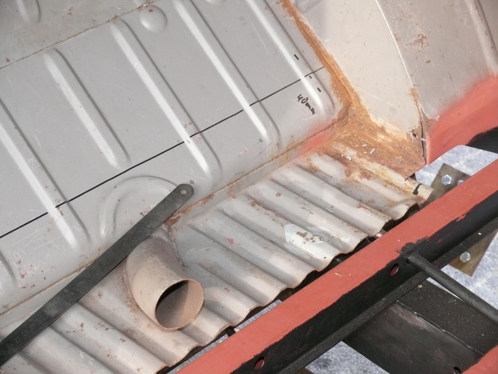

To install the floor I still have a little bit of work ahead of me. First I had to remove the last bits of the original floor.
And I had some rust repair to do:
Next I still have to clean and paint the torsionbar tube while I have easy access to it.

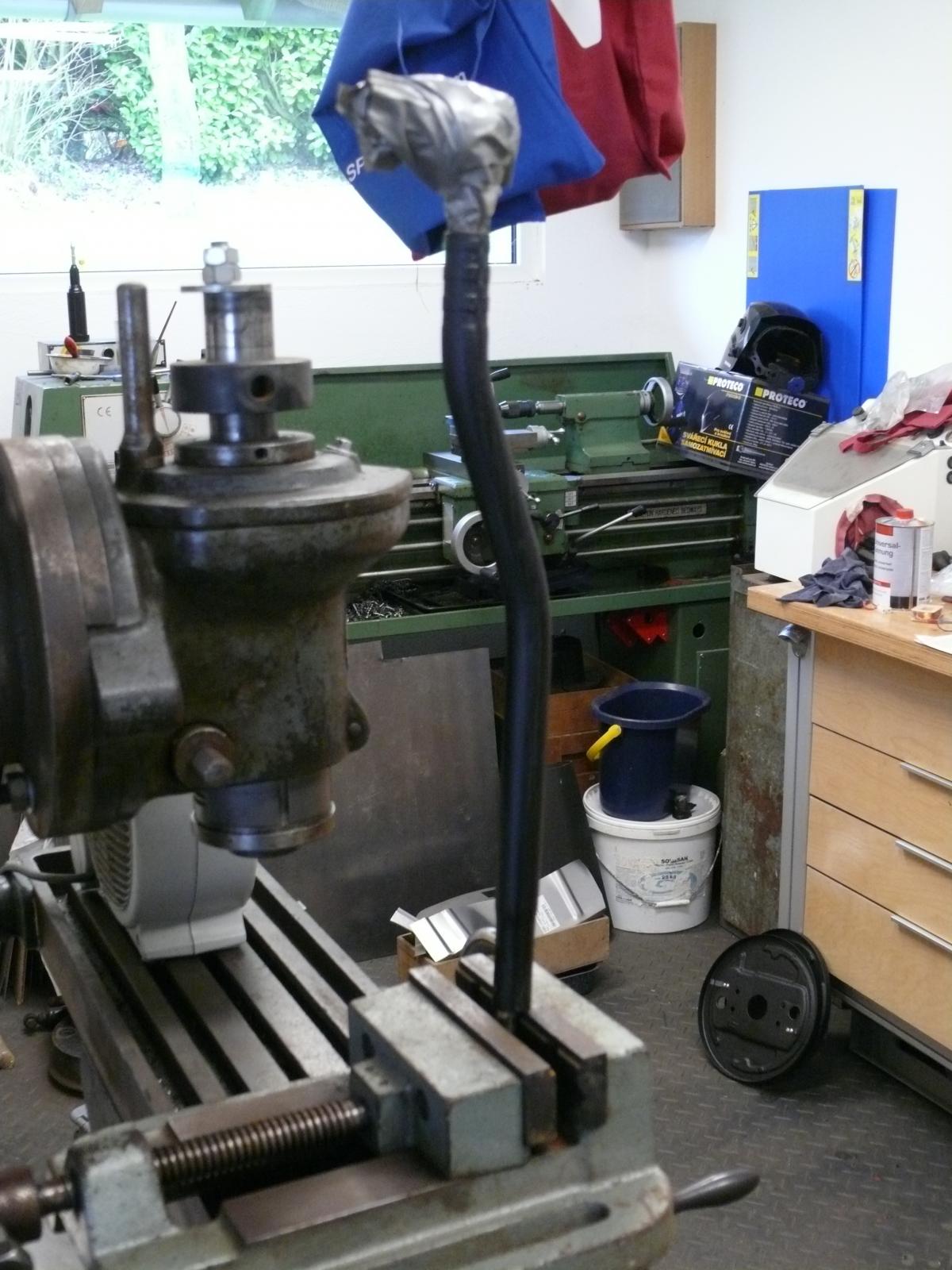

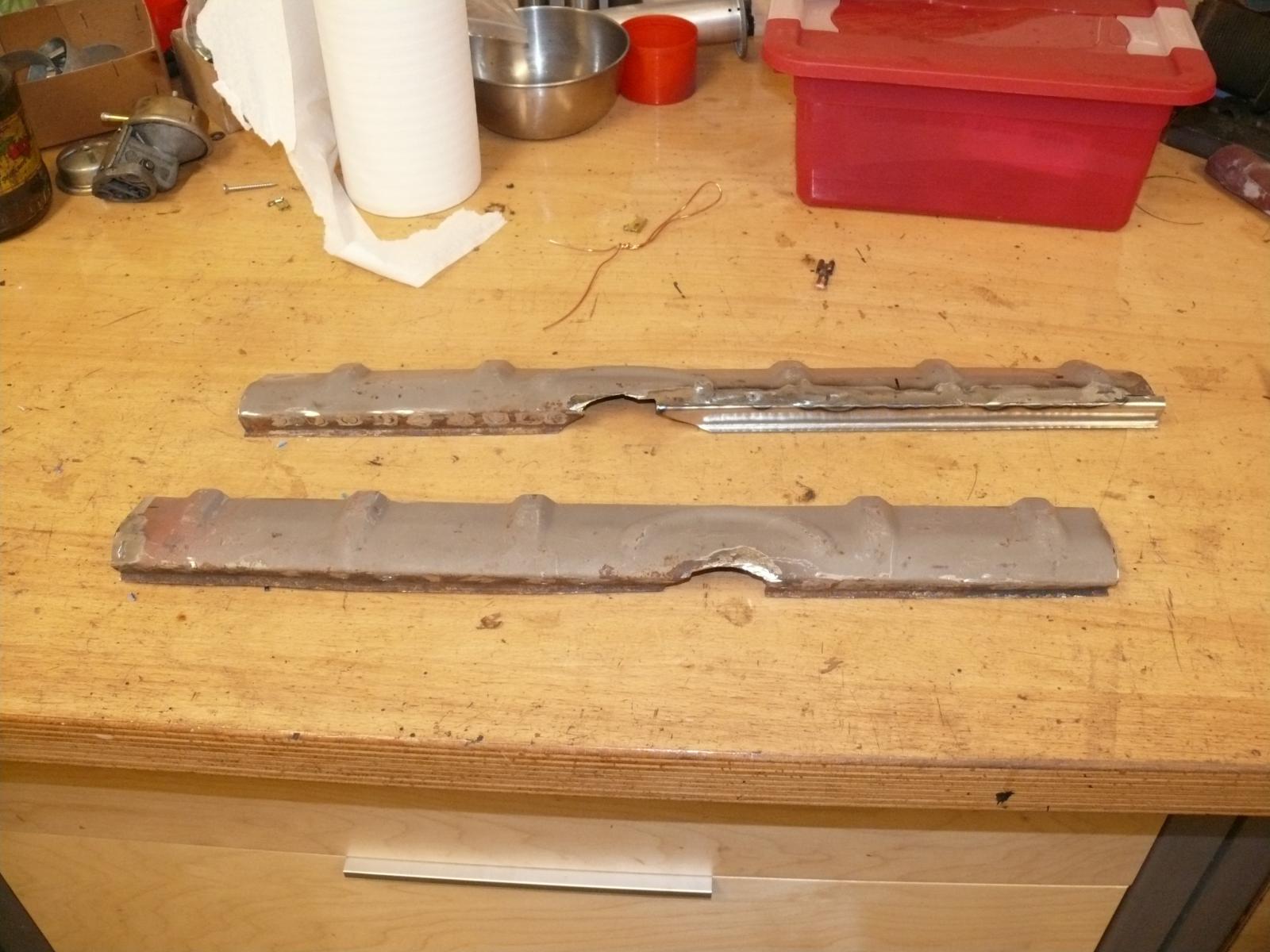

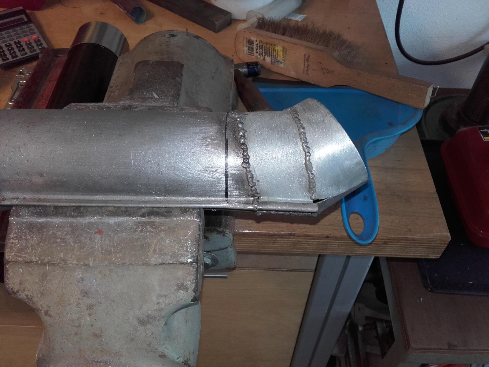

Then I tried to repair the section of the heater tube which sits right in front of the cargo area. Unfortunately you can only get a new one when you buy the whole set. This is really the part that rusts most of all of the heater tubes.
I didn't like my first try. The second one is a failure too, I did not get the angle right. I'll need to cut it apart again and tack it together with it on the car.
Removed the old floor welds from the heater tubes:
I am contemplating if I should reinstall the original rear heater or if I should go with the plastic Eberspächer heater went I used once I installed the Eberspächer heater.
