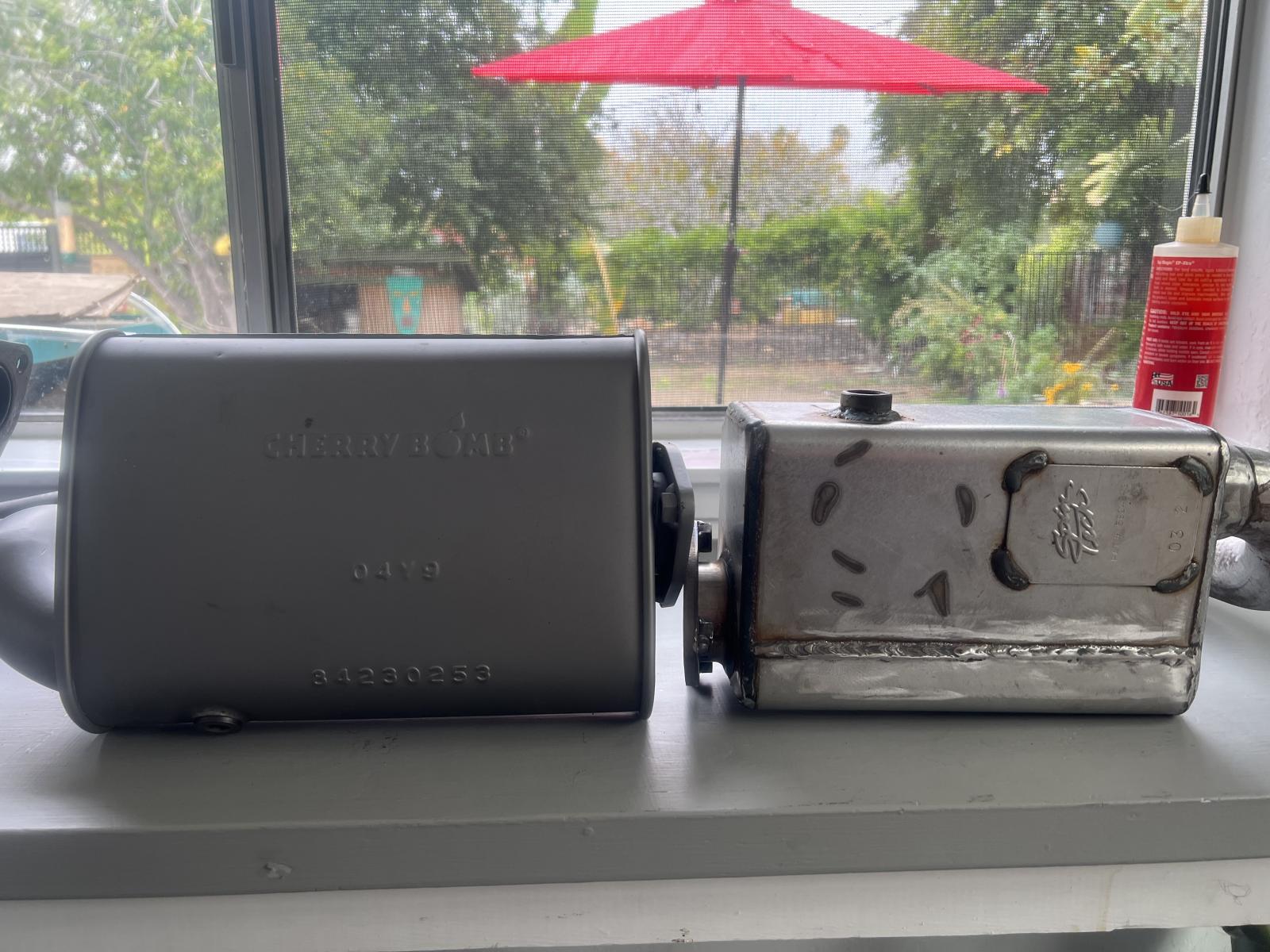

'Critter1' Justin turned me on to this small SpinTech muffler that i fabbed up to work with my S&S header.
Along with a bit of suspension raise, this should stay off the driveway.

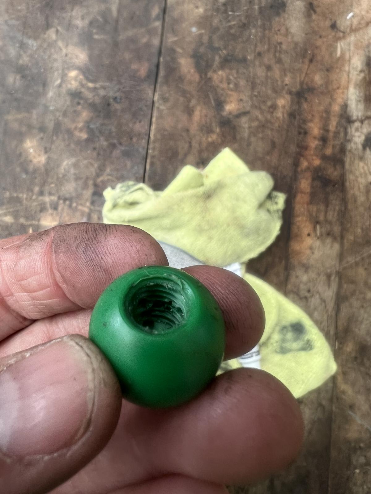

Shifting was being sloppy and found it came loose inside the tunnel again.
Shift ball was moving, and looking inside you can see porosity.
JB-Weld to the rescue again!
A good double-nutting plus some lock-tite and hopefully it'll stay this time.

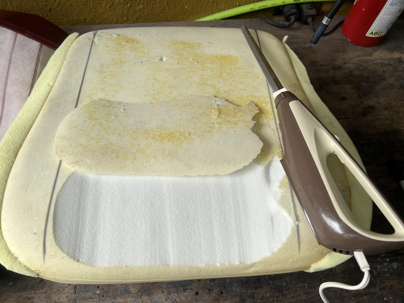

Seats were overstuffed when they did them.
Couple that with not able to slide very far back, -or- recline much,
And you can have a real crap driving position.
Here my legs were bent, my belly touching the wheel, and my head almost on the headliner.
Driving the thing like that makes even an old man feel silly.
First step was to rip the seat bottoms down and shave some foam using grandma's old electric steak knife.
Followed that with some blending using a flap-wheel on an angle grinder.
A bit lower seating and also a bit of side-bolster.
Nice to have a win.

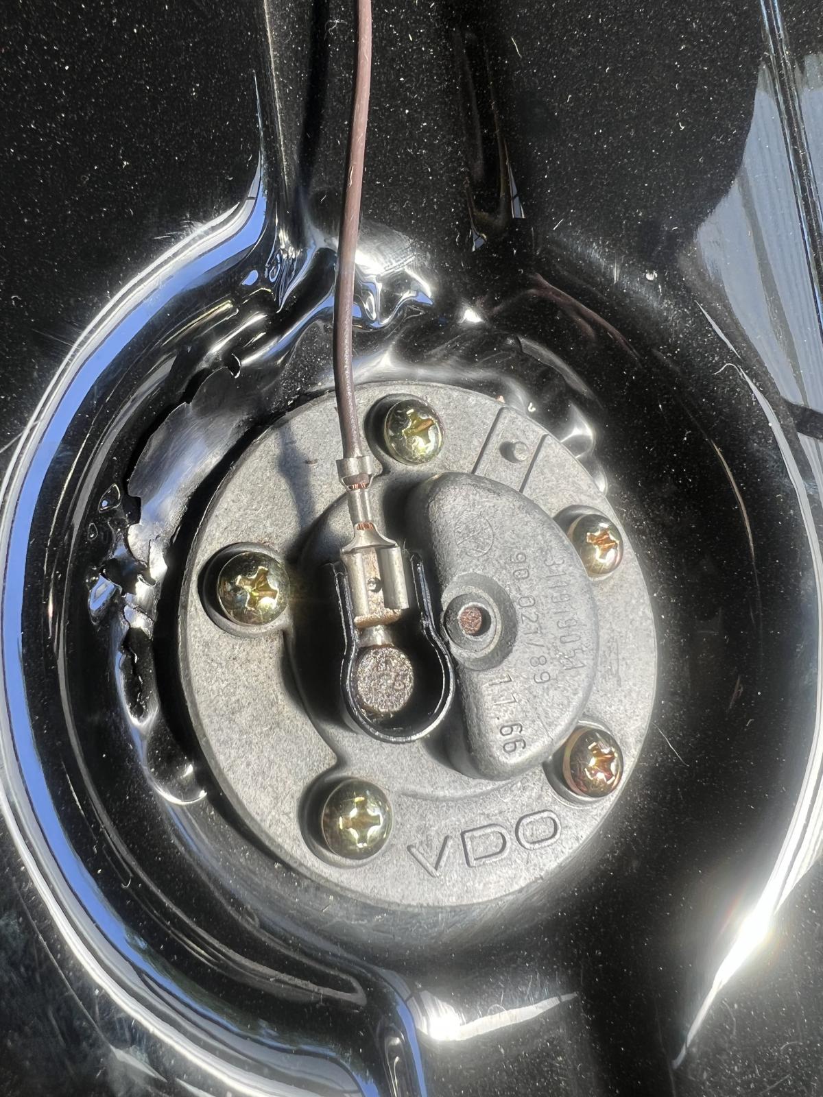

How much grief can one fuel gauge give?
I'm starting to think it's best to just give up on having a fuel gauge on these cars.
Kind of like most guys do with wipers.
Around here, only about 20% of the cars even have wipers, and the rest probably don't even work.
Ovals didn't have fuel gauges - likely because VW gave up trying.
So the gauge was NOS, but decided to peg itself past full.
Taking it apart, the needle would jam against the face at full full.
Bending the needle a bit inwards kept it from doing this,
And grounding the wire, it pegged full, but open, it returns correctly.
Yay! fixed! right?
Wrong!
Gauge would work grounded or open but not with the sender.
Using a meter is supposedly possible to test a sender but all i ever got was a needle jumping around wildly.
So i rigged up a test to tip the sender upside down and rightside up and watch the needle move.
Supposedly...
All this would give me is a reading of mostly full to totally full.
Since the gauge tested right open or grounded, i ordered a new sender from ISP.
Still no love..
Behaves the same as the sender i have.
So I guess I'm back to the gauge again..
Unfortunately i gave away the two other old gas gauges i had.
Anybody have an old gas gauge they'll sell?
Couple i tried listed here didn't get back to me...
Just to add insult, the sender leaked fuel and ruined tank paint.
Stripping/sanding/Epoxy/high-build/sanding/base/clear/cut/buff.
Ever get this sense of deja-vu?
Sucks to drag out stuff and clean the gun and all for just one little spot.
My rebuild Jim Adney sender was obviously overtightened..
Also the ISP senders supposedly have a float inside that quits floating.
Good God!
How much grief can a fuel gauge give?
I hate this car.

Steve, you might want to run a separate ground wire from the sending unit to the body, and see if that helps clear up your problem. I've done that before on a car that had a glitchy sending unit. Turns out too much paint was causing a grounding problem. Just something to keep in mind. _________________ Bob 65 Notch S with Sunroof

Ya, i paint all my junk so I’m super well versed in ground issues..
Way harder those negative grounds vs. regular wiring running on the hot side for sure.
Unfortunately that’s not the case here..

this is exactly what i did and my gauge has been rock solid ever since. give this a shot.  _________________ If you have any questions about Forged ICON 4032 VW pistons just shoot me a line. |

this is exactly what i did and my gauge has been rock solid ever since. give this a shot.  |
Same on my Notchback. _________________ 1963 Notchback - Ruby Red

Thanks to Jon for the fuel gauge.
Can tell how much gas is in the tank now!

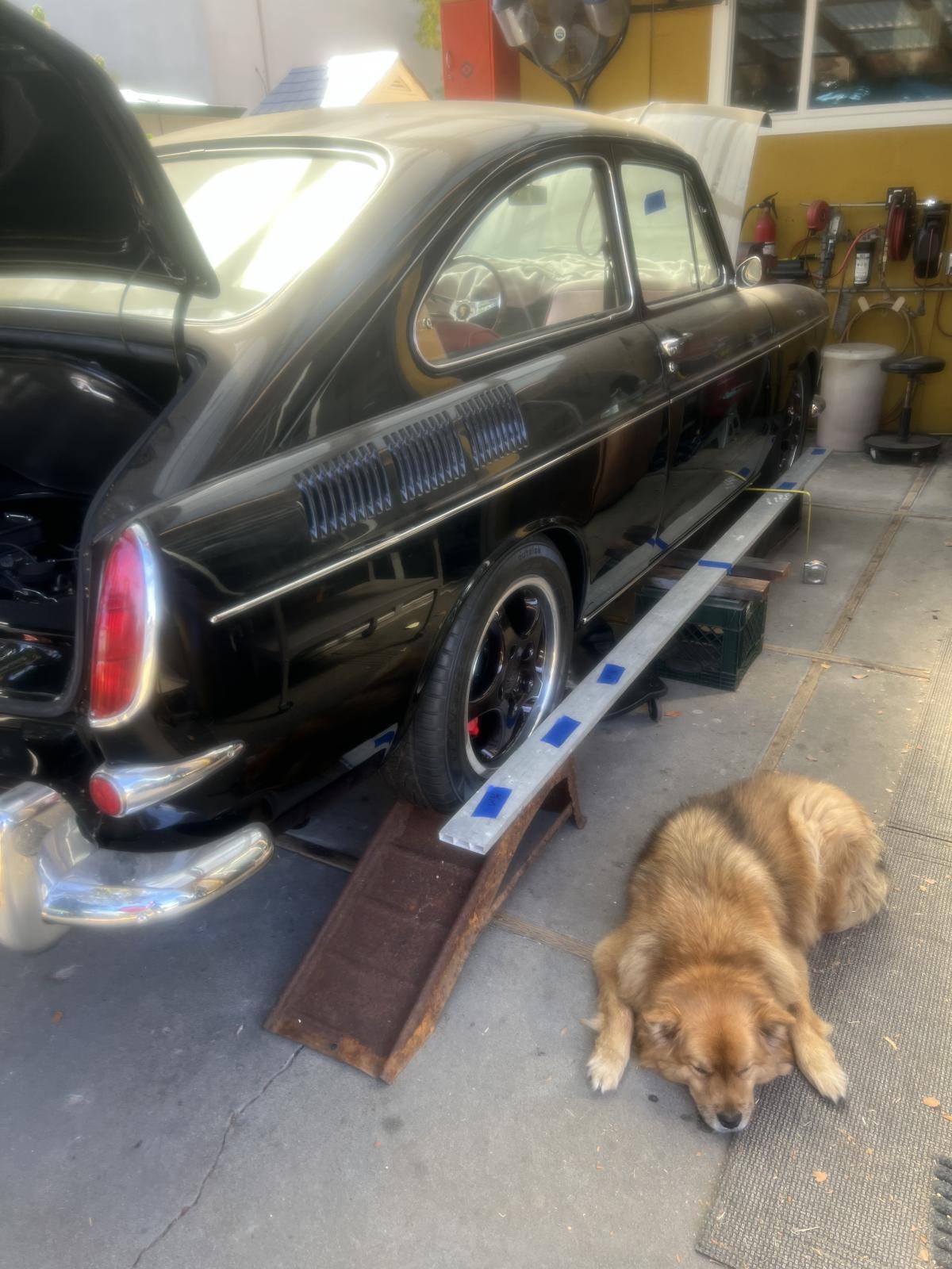

Got a really good final alignment on the thing this time.
On four ramps to load the suspension,
Two big long extruded aluminum straight-edges from my man Karl run along both sides.
Got them floating at just the right height to hit sidewalls.
Shows front/rear alignment, toe, just perfectly.
Get them tight to both rear tires, then put a tape measure across.
Wrote numbers down on the blue tape to get it all 100%.
Shortening rear spring plates finally allowed zero-toe rear.
Also coming up two clicks pulled the top of the tires out a bit.
