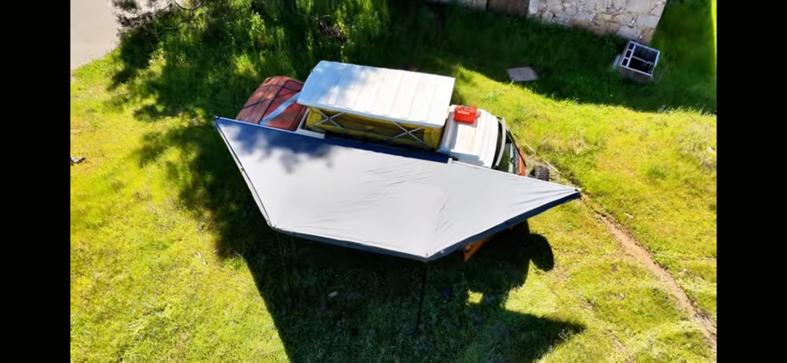

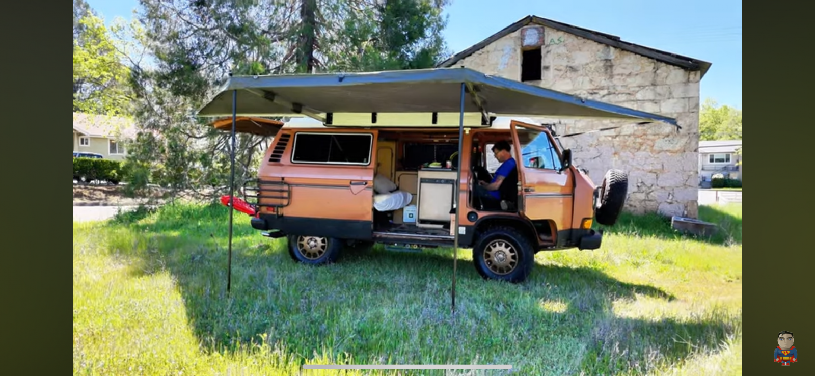

The look I’m going For : OVS Nomadic 180 Awning .
Screenshots taken from a video I found on YouTube showing me it was possible on a T3.
Fast forward-> Awning is ordered & Recieved . Then realized how heavy and original the mounting on a pop-top T3 is . Finding Rain Gutter Brackets sturdy enough was going to be a task.
Thankfully I may have found a solution…

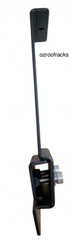

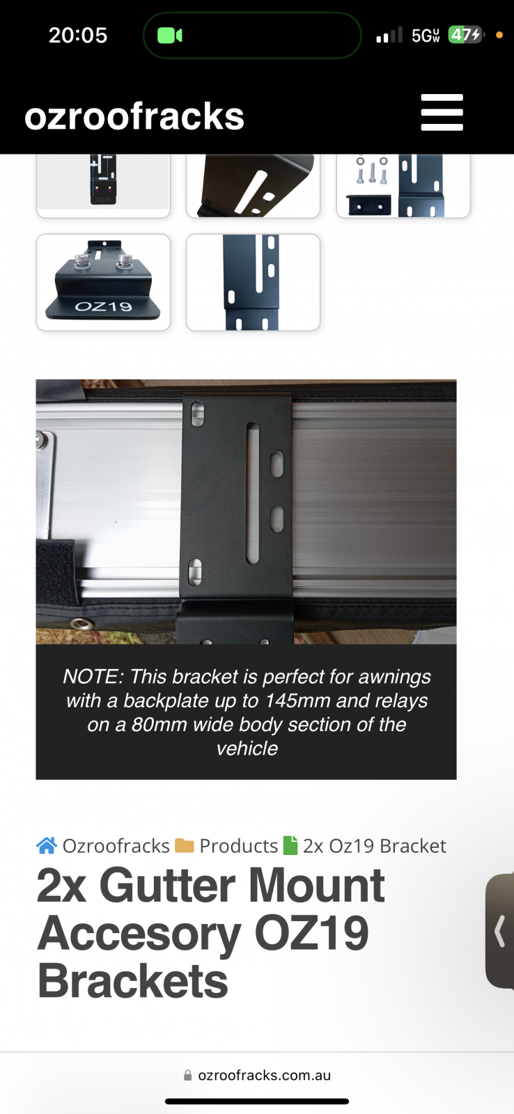

Ozroofracks on ETSY.com A company out of Austria . They make heavy duty gutter style mounting brackets for multiple vans .
Ordered yesterday, shipped out today. Will post install once brackets arrive.

I’m very interested in the actual gauge steel of the “ozroofracks” brackets.
It would be great if they’re great, but from this end of the internet they don’t
look much different than the 10-11 gauge brackets from GW, VC/RMW, etc.
No information or specs on the Etsy page.
Looking forward to your report!

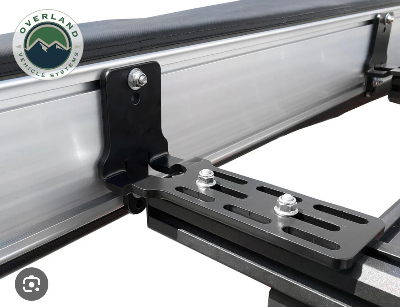

I got my OVS180 as a present, finally getting around to building brackets. The awning is not light, got some weight for sure. 45lbs give or take. Thinking 3 Rivnut body mounted rain gutter brackets plus 2 additional rain gutter brackets. 5 brackets total. All 3/16th steel. Adequate support is critical I think.
The OZ rack mounts look interesting, like to know how they work out for you.
