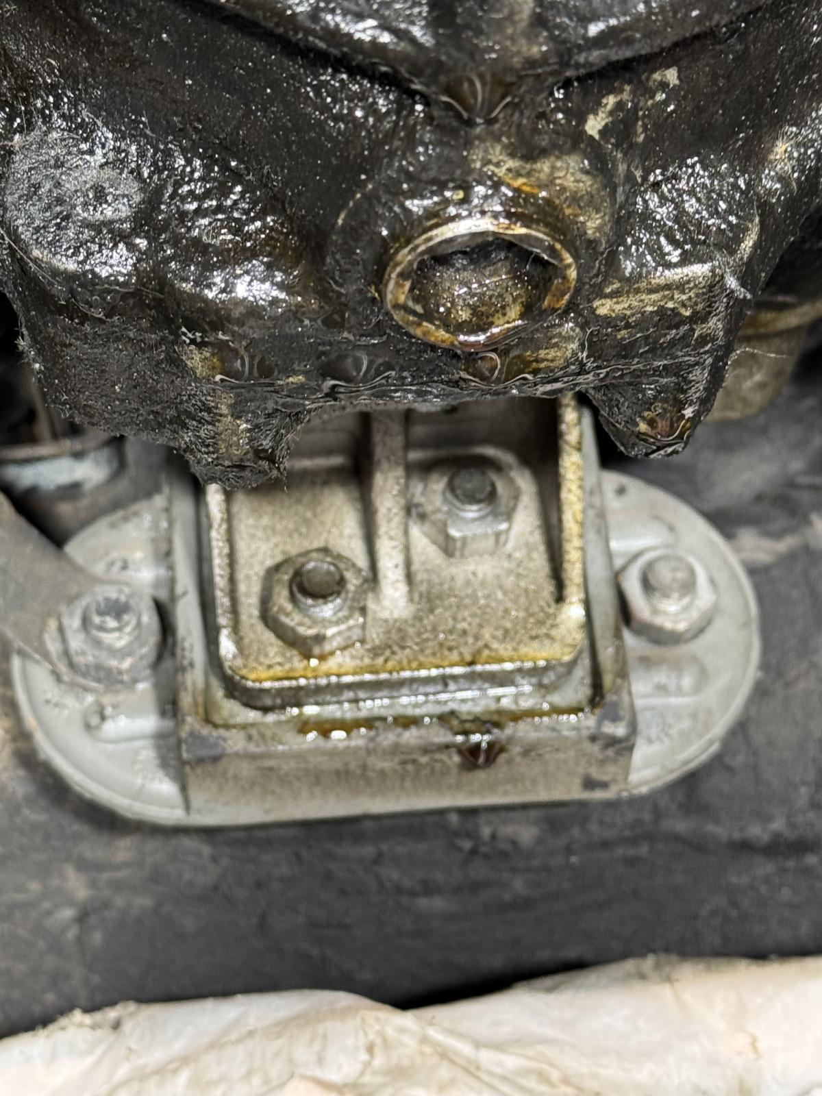

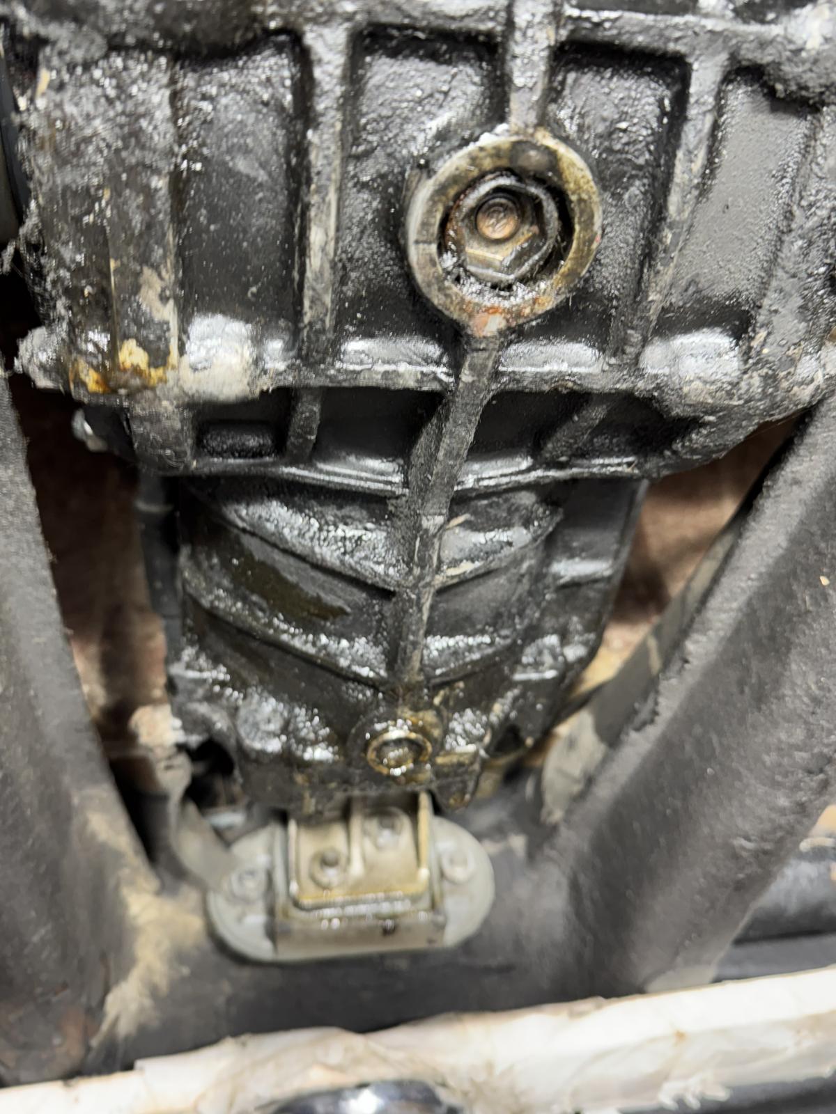

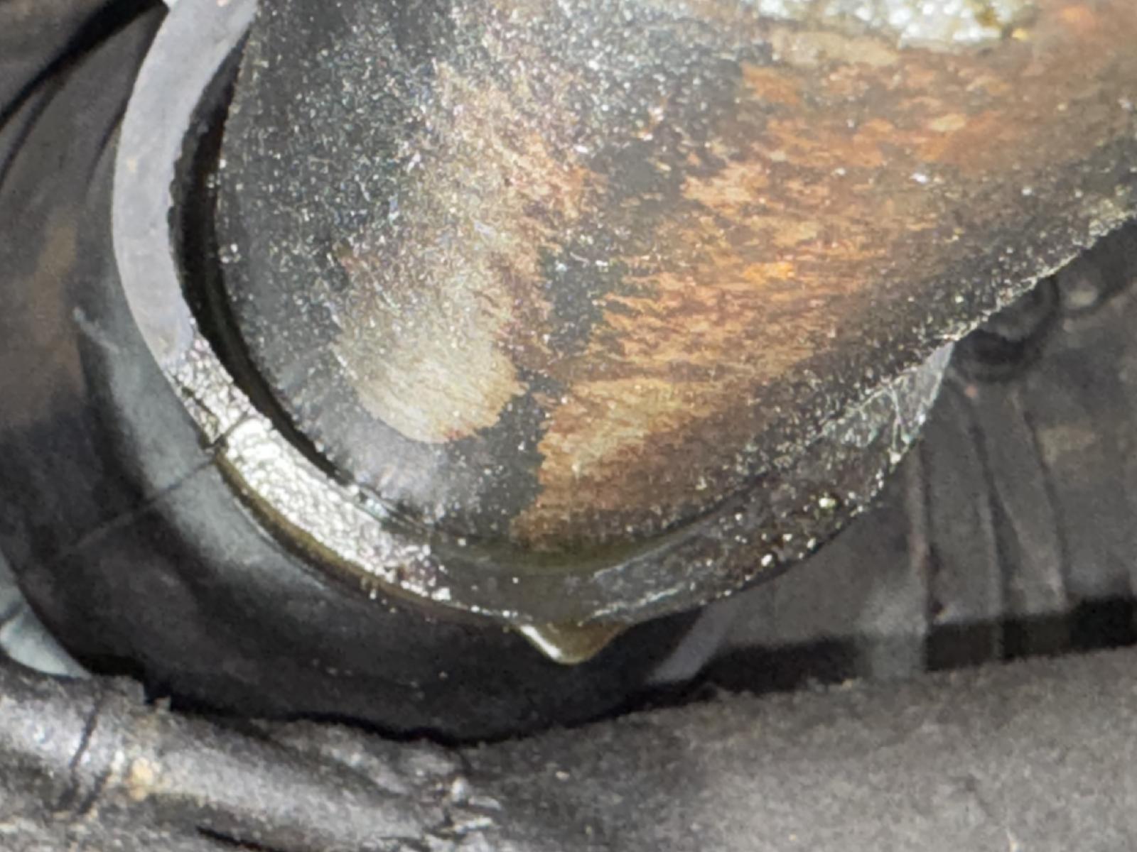

Got to gunkin’. There really isn’t that much.
The whole transmission is just wet.
Can’t loosen the fill plug so did not drain. I Blasted the fill plug, will try again.
Clearly both boots are leaking. But it seems unlikely to me that that is the only leak given how wet the transmission is— our car has been up on jack stands all winter.

So it looks like the nosecone gasket on the transmission failed (besides the axle boots), right?

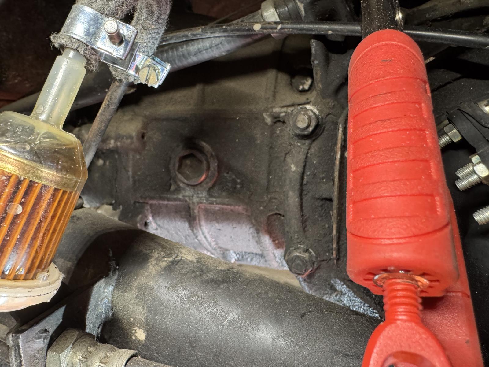

Hockey stick bushing and detent plugs could be leaking as well

Often the 3 plugs for shift fork locks are leaking or missing.
On older 311 transmissions, they were made of rubber and detoriate.
The original replacement parts are aluminium, 113 311 599
They can be installed while trans is in car.
Location is right side front, but hard to see, just beside the right frame fork.

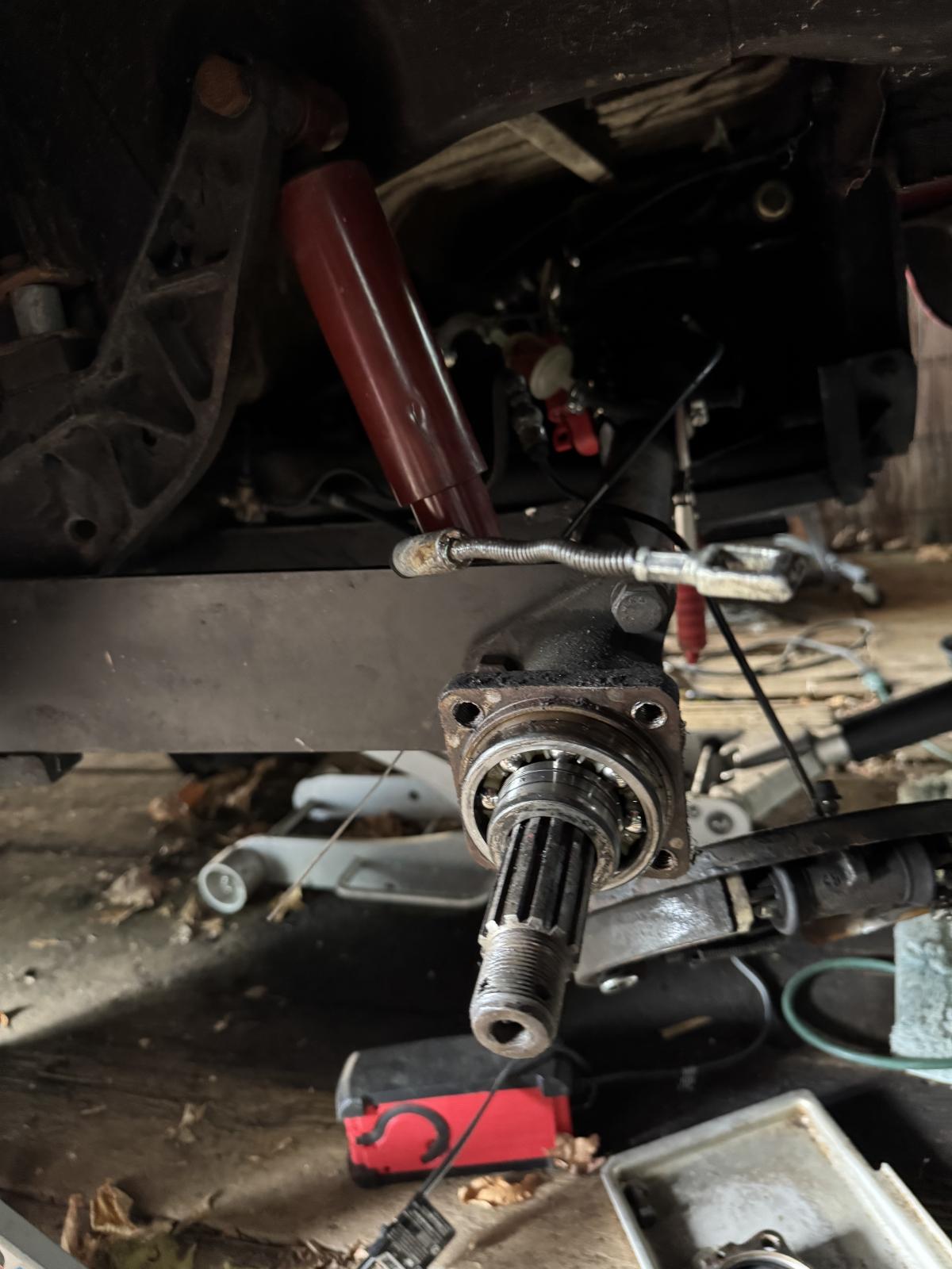

Have finally managed to remove the fill plug so removed both drain plugs, black oil is draining as we speak.
Moogie came over and was simultaneously impressed with where I had gotten to and dismayed at where our car still had to get to. Said I had the right attitude though. We’ll see.
Transmission removal next.

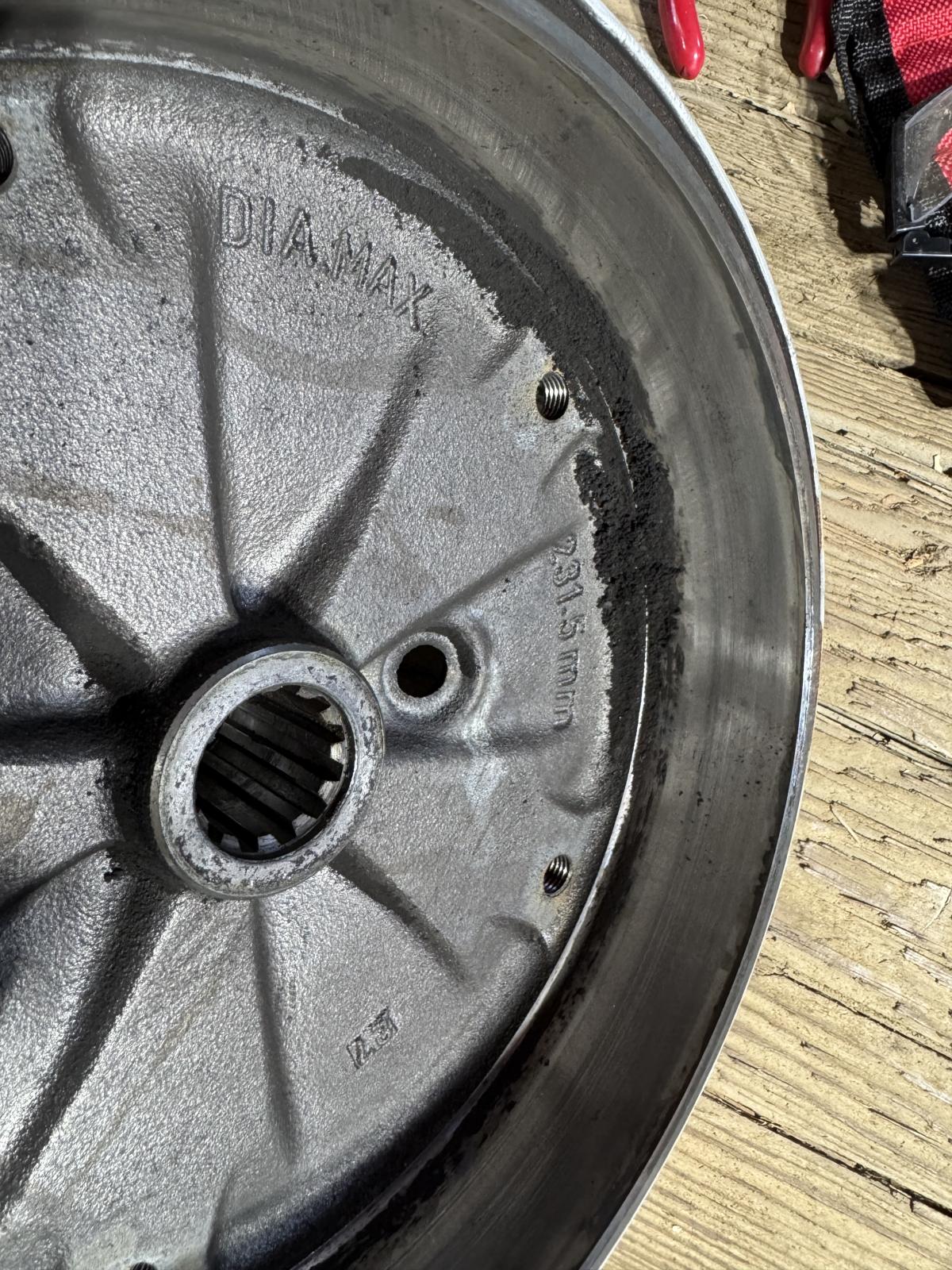

Time to check previous work and, well, this doesn’t seem right!
My guess is that the brakes are not adjusted far out enough.
What’s yours?

Back to our car today to wrestle with transmission removal. It’s funny, I know there are many out there in SambaLand that wonder what the heck I am doing. They would have gotten the engine out, taken out the tranny, repaired the clutch and transmission seals and put it all back together well, if not in an afternoon, a weekend. It is so slow going for me because I simply have not done this before and each bolt, connection, task always seems to have some trick up its sleeve that I must uncover— like an Infocom game.
For instance, it took me at least an hour to figure out how to remove the square head set screw that holds the shift coupler! And then, I needed to consult with ChatGPT to finally make it happen.
In any case, I am back on this with the probable goal of putting our car up for sale. BTW: This will be the first year since restoration that our car will not be going to the Bug-A-Fair in Terryville. Actually, I think the Karmann Ghia contingency might be happy to see someone else win that class haha.
