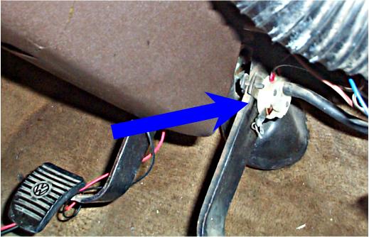

Let’s take the wipers for instance, I first time me and my wife drove the Westy in the rain, it was sprinkling and we had to go to the store. The distance is so short that we usually walk, good time to check the wipers. Worked fine there, on the way back the passenger one just sort of stopped then it fell off! The PO had glued both of them on! The shafts were broken at the threads (from over tightening I’d guess) so the wiper arms were glued to the shafts with nuts on top then painted black so you couldn’t tell. It was good to find this out at home, not a few hundred miles away in a thunderstorm. Another thing to look around for is bad repairs. After 25 years, various owners with differing mechanical ability, old aftermarket junk, and scores of mechanics my poor Westy had all kinds of bad repairs, some I’m still finding.
What is that thing? That is a switch from a cruise control that had long ago stopped working, it came off.

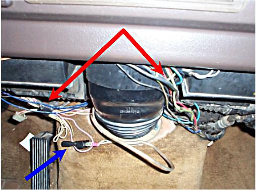

all kinds of wires that don’t do anything anymore The red arrows show A/C wires and aftermarket cruse control wires that are gone now. The blue arrow is a kill switch the PO had wired to the fuel pump. Would have been fun to figure out if I didn’t know the switch was there and It broke down.
