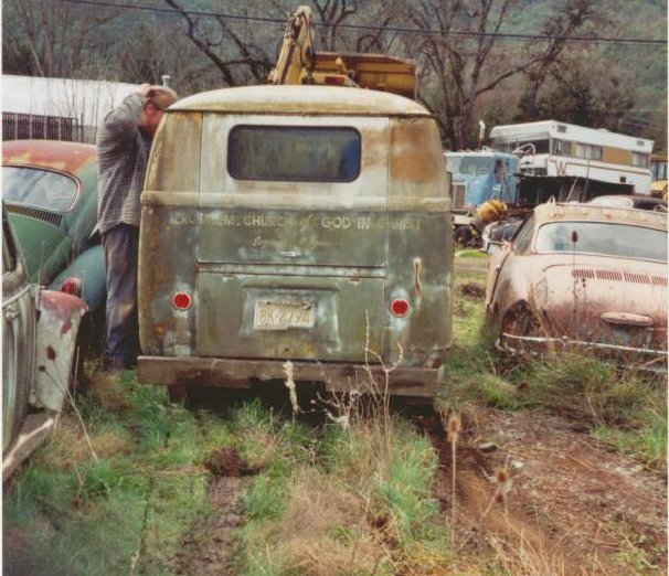

'58 dollar T/L were positioned further up
sometime in 1959 (pretty early I think) they moved the T/L down to this position and kept them there till they went to a bigger T/L assembly
make sure you get the right measurement!!!

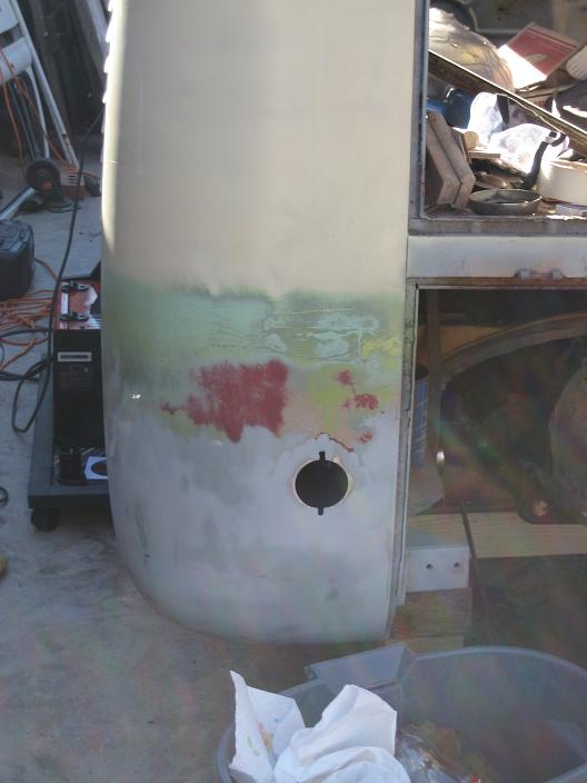

Can somebody post a pic from a 1959-1961 rearlight without the lamp?(just the cutout)
I'm not sure if it's just a round hole with 2 schrewholes or a hole with vertical cuts. (Like this)
I think i've seen both.

59 and later used the slotted style as shown above
