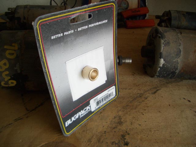

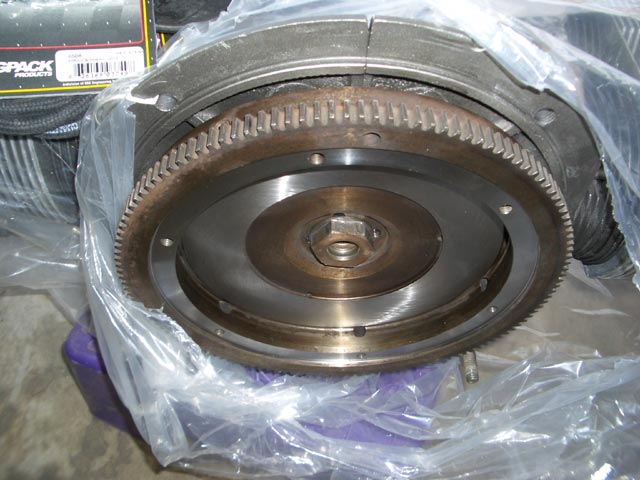

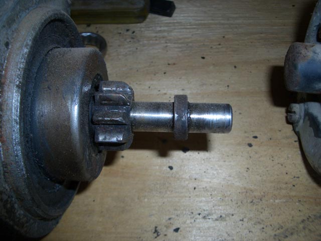

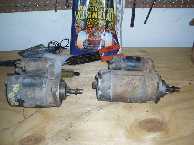

Here is what i understand. This is the same situation i have with my wife's car. It is a 66. Originally 6 volt. At some point, a half assed 12 volt conversion was performed, much like the ones i've too done in the past. Change the battery, all bulbs, and maybe the generator/or to 12V alternator. Kits are relatively cheap, and pretty straight forward. I always put off the starter, and flywheel, because they are a pain, and leaving the 6 Volt crap in there, works just fine...for a while. The starter is now spinning up a lot faster with the 12 V battery. This causes the teeth on the 6 V flywheel to wear and even chip off. Look at this example of my current 6 volt flywheel. you may be able to see the damage.
This flywheel has fewer teeth than a 12 V flywheel, wich is what i now have.

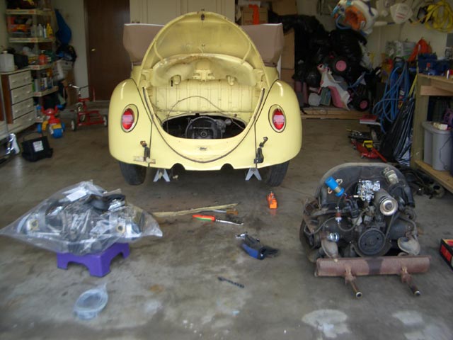

By the way, i have a new rebuilt motor with a 12 V flywheel all ready to go side by side. That is why i'm doing this upgrade. Not because i really wanted to.

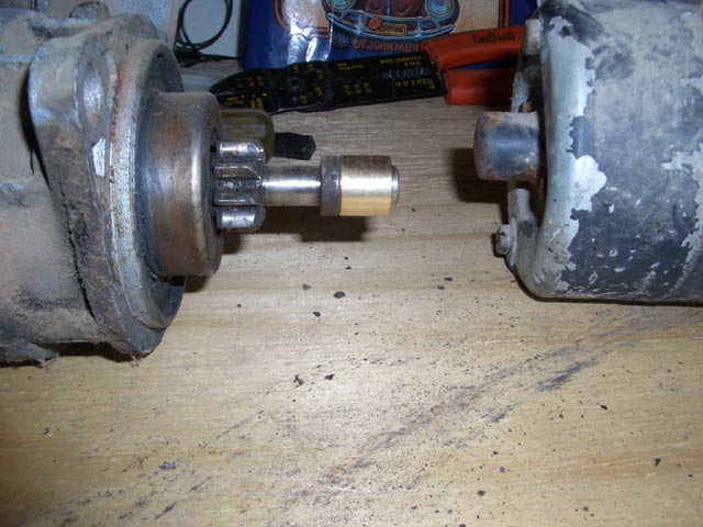

So, i removed the 6V starter and bought a used 12V starter for around $20. Here they sit side by side.

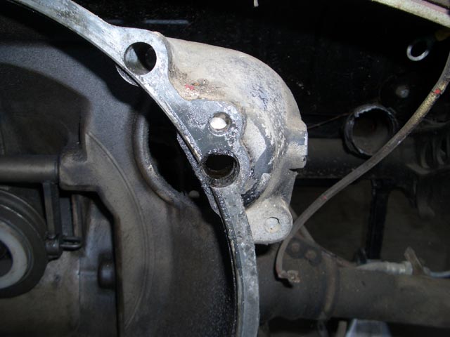

This is a close up of the 6V starter as it came out. The bushing you speak of stays in the bell housing.
The big hole underneat the little hole with all the grease on it, is where the old bushing is. You must remove it.

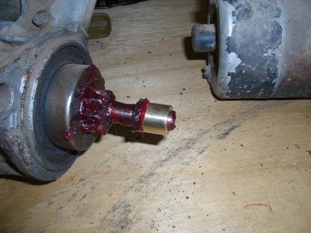

Purchase the correct 12V starter bushing for a few bucks. Should look like this.

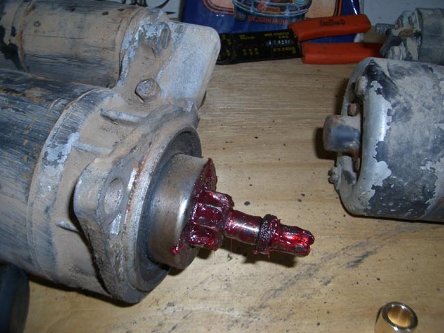

It goes here on the 6V starter.
Here is the bushing and the high temp/pressure grease you need to do this.
Put it all over the joint.
Should look something like this.
Re-install and end up like this.
Remember, the bell housing will need to be ground down a bit around the mounting bolts and a couple other spots. This is necessary to install new 12 V flywheel in old 6V tranny. No big deal, just take your time and make it right.
I hope this explains the whole bushing problem to all. If anyone wants more pictures of this or the next process, let me know and i'll post my ass off. Good night to all.

I installed the 12 V starter. Why you ask? The one that says 70 bug is a 12V.
