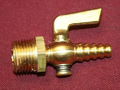

I'm also looking for this style valve on the end of drain pictures. Anyone no of a source have a link know what it's called specifically. Cannot seem to find anything similar

crofty
Judas of the North
Joined: August 09, 2000
Posts: 19568
crofty is offline
PostPosted: Wed May 13, 2015 1:30 pm    Post subject: Reply with quote
That's what's on my original '65
HamburgerBrad wrote:
curtis4085
Joined: July 22, 2011
Posts: 4806
Location: Colorado
curtis4085 is offline
PostPosted: Wed May 13, 2015 1:40 pm    Post subject: Reply with quote
Pet cock! Thank you

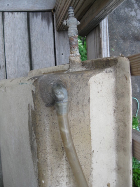

I do need some help.
I'm been desperately searching for the fitting at the top of tank that the pick up tube attaches to. Mine is broke at the barbed end
Or a link to where I can get alternative fittings for pickup
https://www.thesamba.com/vw/gallery/pix/267714.jpg

BarryL Premium Member
Joined: November 01, 2004
Posts: 13723
BarryL is offline
PostPosted: Wed May 13, 2015 6:51 pm    Post subject: Reply with quote
Remember the one in Crofty's photo is the early tank. Anyone got the plastic tank's outlet pic?
