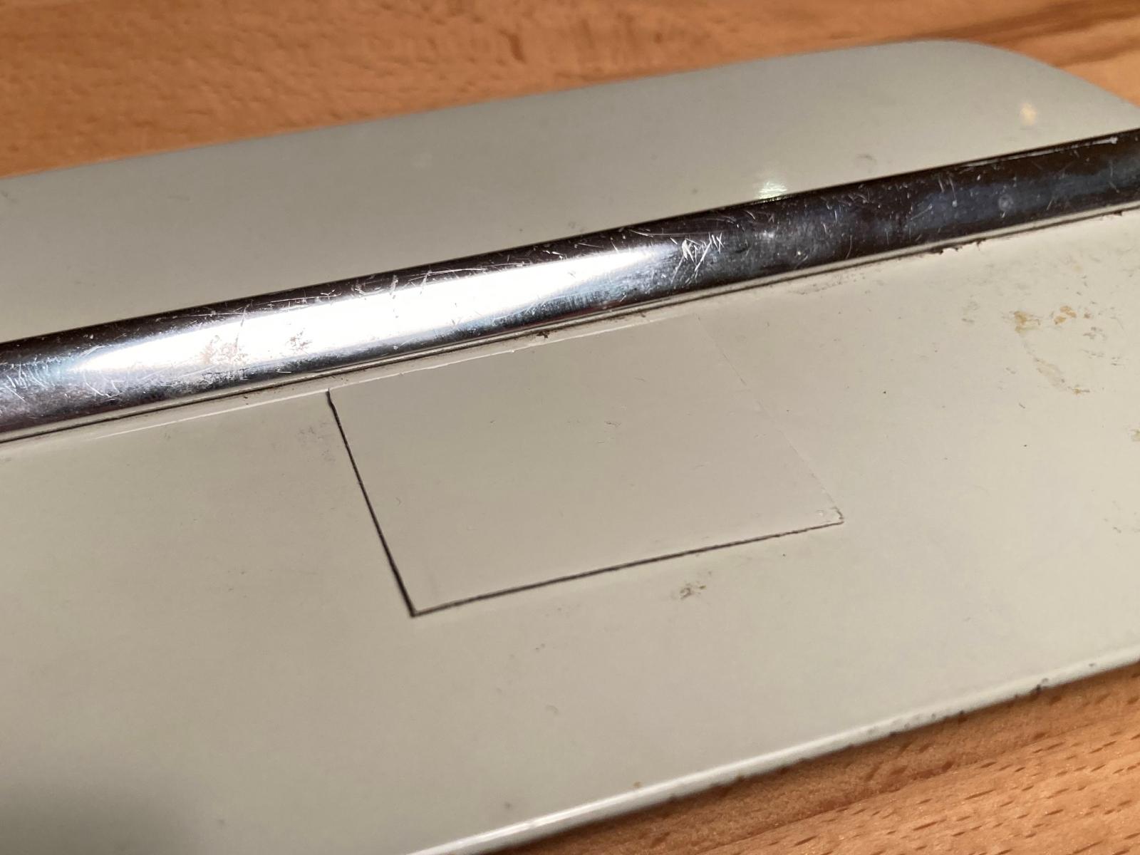

4) I tried a french company, sprido-peinture.com. They deliver single stage resin enamel and have L87 in their portfolio. I ordered a spray can:
It is better than all three before, but still too dark.

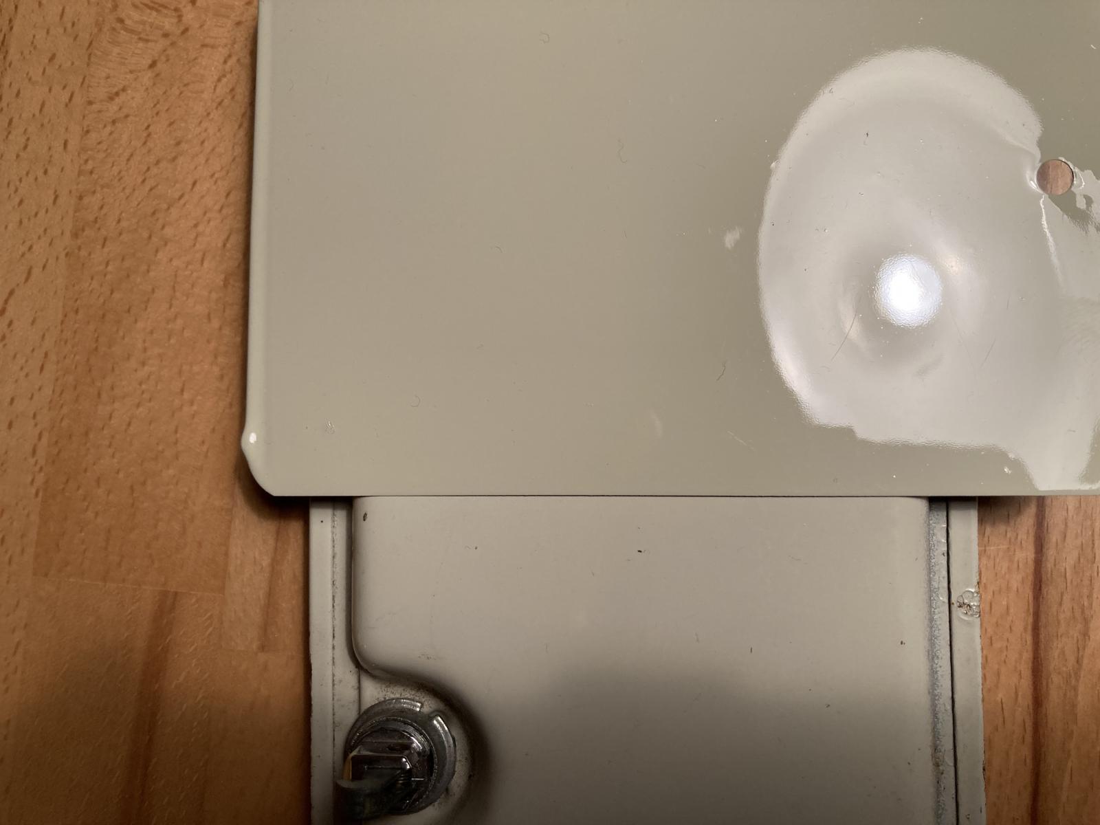

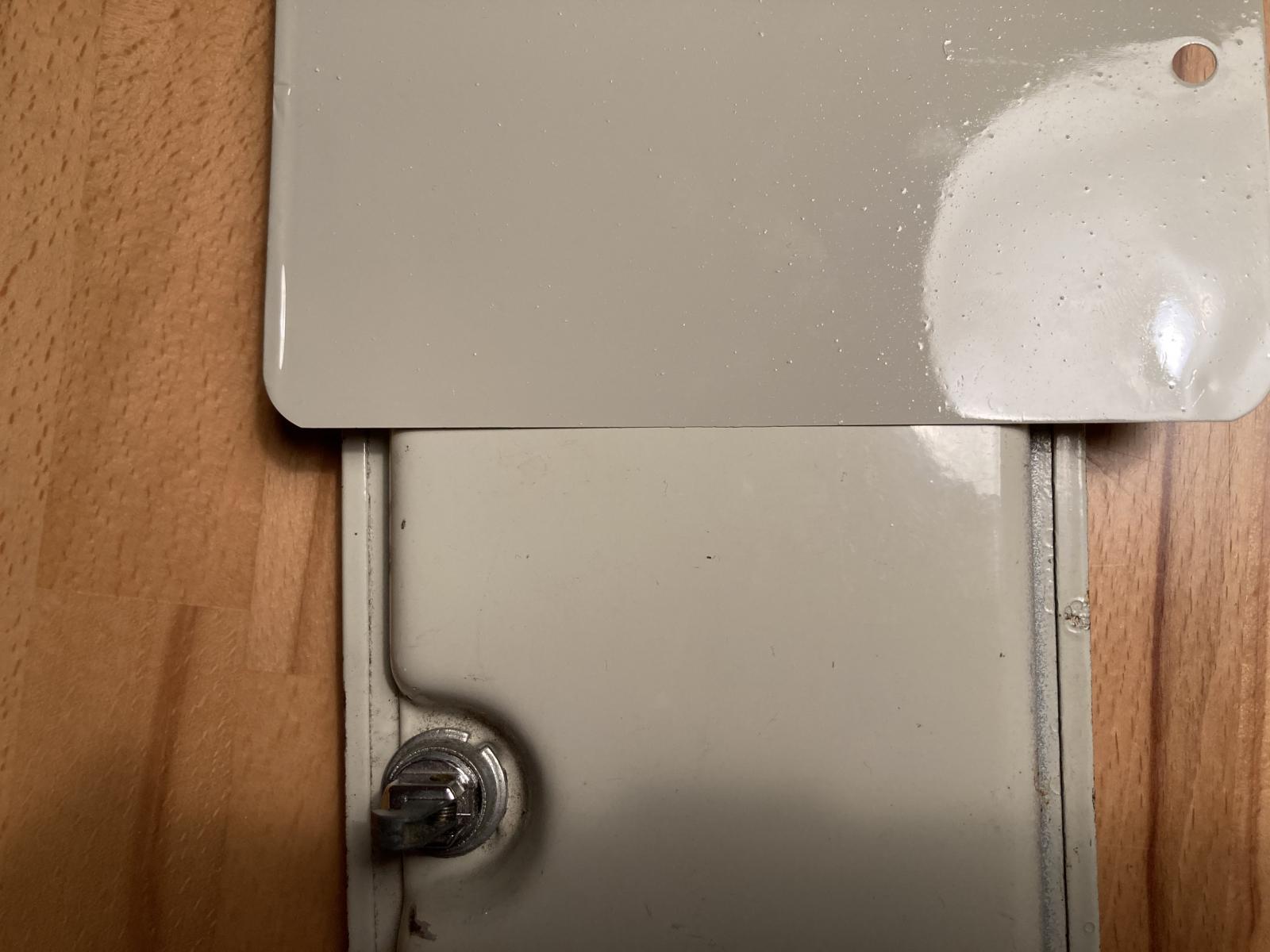

5) Last thing was ordering a colour sample from paintman.co.uk. They also traditionally provide resin enamel paint and have L87 in their portfolio. They sent me a very little sample of their "Traditional Synthetic Coach Enamel" line:
In the pictures it is still a little bit darker than the original paint, but I should mention, that the sample is more glossy than the og paint in the pictures. When the og paint is polished, it also will get a little bit darker, so I assume this formula to be dead on!
