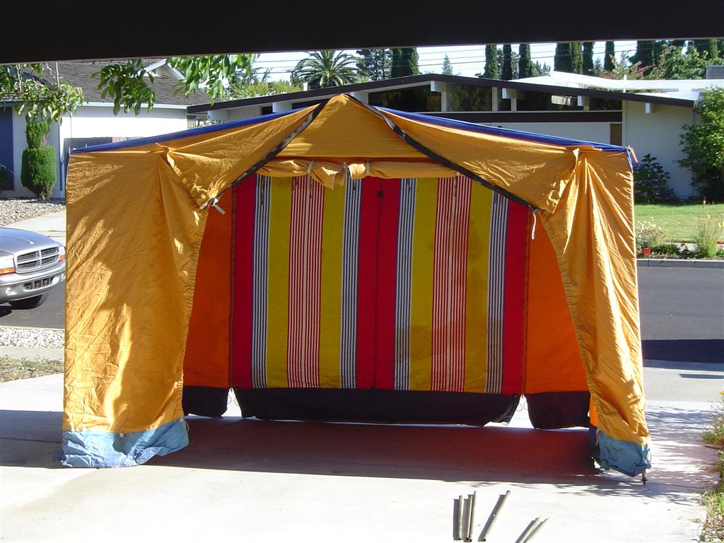

PostPosted: Mon Jul 11, 2005 7:31 am    Post subject: Reply with quote
SO L42Y wrote:
Here is some idea of the tent parts.
I am told that the blue bag is an original pole bag and that the small yellow bag as well; the bag with stripes, no.
As well as the stake hoops (stamped Made in Germany), there are metal sliders on the guy lines.
The set of stakes is not complete.
Please add or correct if necessary
http://www.thesamba.com/vw/forum/album_page.php?pic_id=216833
Craig
I have a few of the same stakes as well and the orange bag
When in doubt, logo it out!!

PostPosted: Mon Jul 11, 2005 11:08 am    Post subject: Reply with quote
Not a SO-42 tent but still interesting. I bought the tent from a guy who had a 73 westy. Not sure if the tent is a 73 or not though. If anyone is interested in the seeing the original pole bag or tent bag let me know and I'll get some picks.
Picture of an OG stake. Says Enders Made in Germany
http://www.thesamba.com/vw/forum/album_page.php?pic_id=216876
Picture of an OG stake bag.
http://www.thesamba.com/vw/forum/album_page.php?pic_id=216877

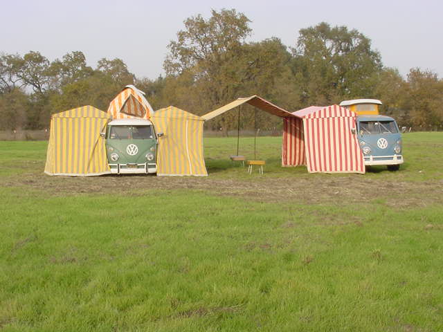

PostPosted: Mon Jul 11, 2005 11:31 am    Post subject: Reply with quote
Here's some incomplete stuff.
Privy Tent (w/o privy room) - 1956-1958?.
Came in both two and three color combinations.
Two color combinations included:
Red/White
Grey/Yellow
Privy Tent - 1959-1965? - came in the following colors:
Blue/Yellow
Grey/White
Grey/Yellow
Red/White
Green/White
Orange/White
Foyer Tent - 1961-1965? - came in the following colors:
Grey/Yellow
Red/White
Tent bags and stake bags from this era appear to have been made w/ same material as tents were.

PostPosted: Mon Jul 11, 2005 11:33 am    Post subject: Reply with quote
more SO 42 tent stuff pics:
awning poles
http://www.thesamba.com/vw/forum/album_page.php?pic_id=216878
upper frame
http://www.thesamba.com/vw/forum/album_page.php?pic_id=216879
big top tent
http://www.thesamba.com/vw/forum/album_page.php?pic_id=216880
old photo for interest
http://www.thesamba.com/vw/forum/album_page.php?pic_id=197603

PostPosted: Mon Jul 11, 2005 11:39 am    Post subject: Reply with quote
Red/White
Grey/Yellow
Blue/Yellow
Grey/White
Grey/Yellow
Red/White
Green/White
Orange/White
Grey/Yellow
Red/White
Flipseat brochures show a blue and white foyer tent as well.

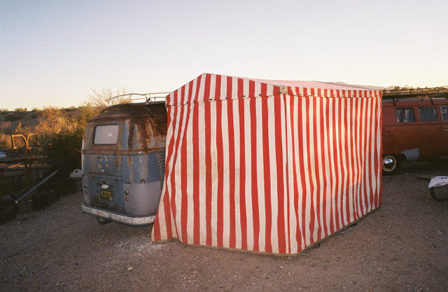

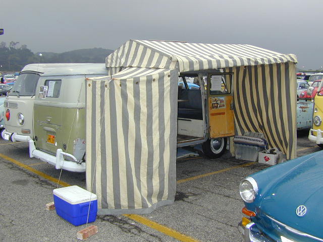

PostPosted: Tue Jul 12, 2005 3:01 am    Post subject: Reply with quote
dieselnut wrote:
Anybody know how many stakes and or guylines the "foyer tent" came with?
Foyer came with 10 stakes, no guylines included or necessary.
heres a grey/white privy
and a blue/yellow privy
and heres a photo that just belongs in this thread.

PostPosted: Tue Jul 12, 2005 7:36 am    Post subject: Reply with quote
How many stakes in a privy tent?

PostPosted: Tue Jul 12, 2005 10:06 am    Post subject: Reply with quote
I've got an orange/white stake bag and inside is 25 stakes wrapped in a box with "25 stuck" printed on the end of it. There are also two of the L-angle shaped stakes and two sets of twine. Up until that point I thought there should have been 23 stakes. I've got some original instructions....wonder if they note how many should be there.
