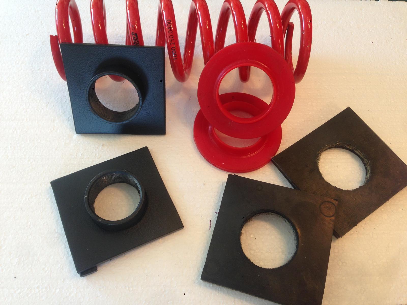

BTW: I made a spacer out of aluminum to help the Westy lean. It was pretty simple. Just got a piece of scrap plate aluminum and used the jigsaw to cut it to size. Only took a few minutes to install.

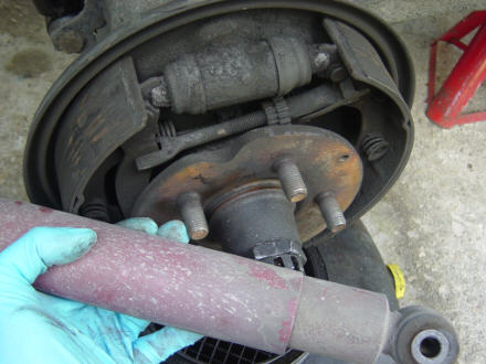

Sure, why not? I replaced my shocks with Bilstein touring blacks, not the HD ones because I heard they are very stiff for unlaiden window Vans. Still made a huge difference because my old Shocks were shot-out Gabriels.
Notice how they don't even rebound in my hand! Are yours this shot? Could be partial cause of sag.
New springs and shocks=big difference.

Notice how they don't even rebound in my hand! Are yours this shot? Could be partial cause of sag....
