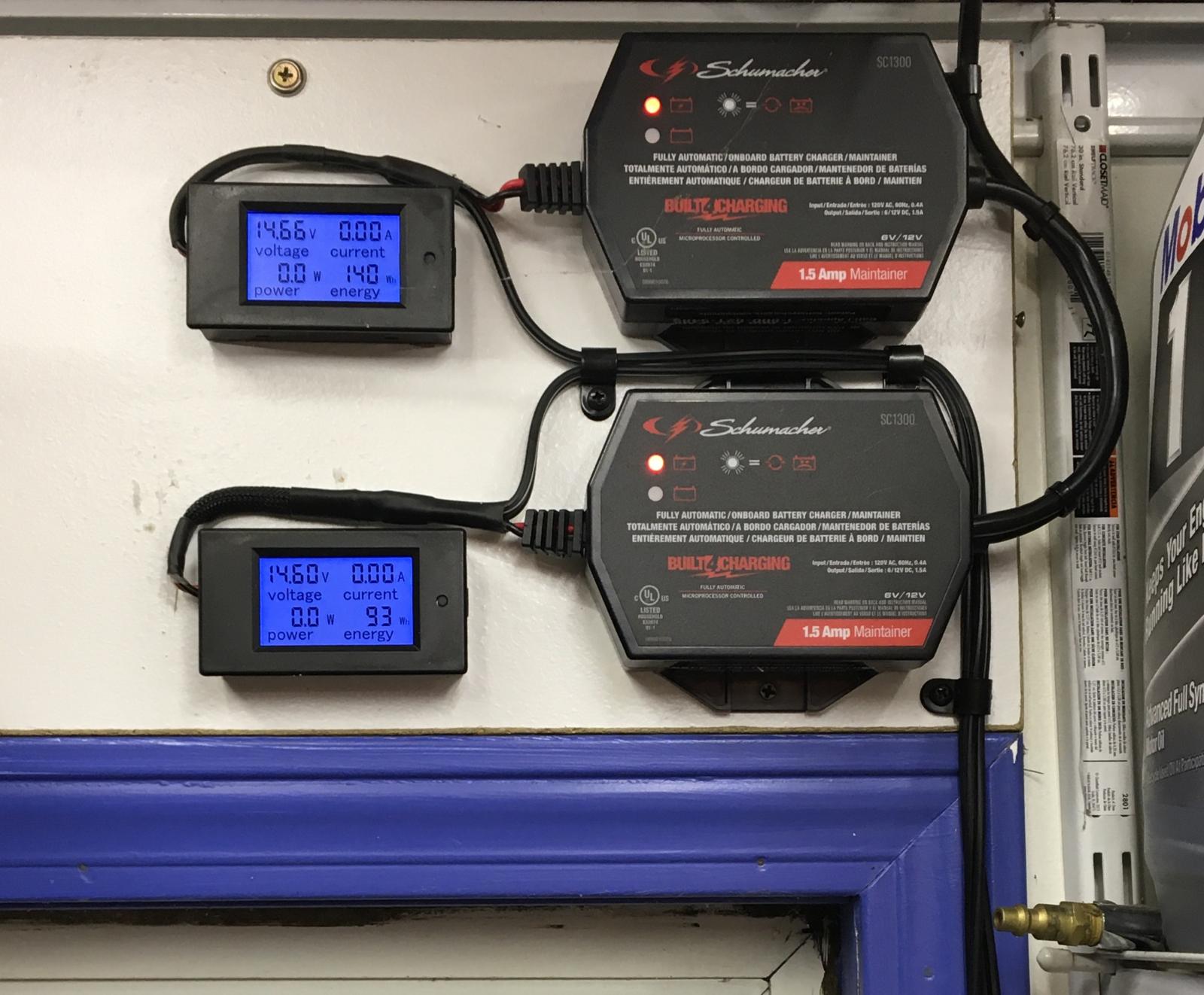

The only way to maintain the life of an unused battery, regardless of type, is to keep it charged. When your bus sits around for weeks/months, you'll need to put it on a charger. My van has a charger on board and I plug it into AC nearly every day even though it gets driven most weeks.
My motorcycles don't get ridden that often but they're always on a charger and the batteries last years.
i know you didn't ask, but a $30 charger may get many more months of battery life than spending $100 more for an AGM battery.
$30 chargers...
- Jim

Perfect thank you! Case closed. Will buy a quality regular Flooded Lead Acid battery and a charger like yours Smile hopefully my battery lasts longer than 3 years this time and doesn't give me any issues!
