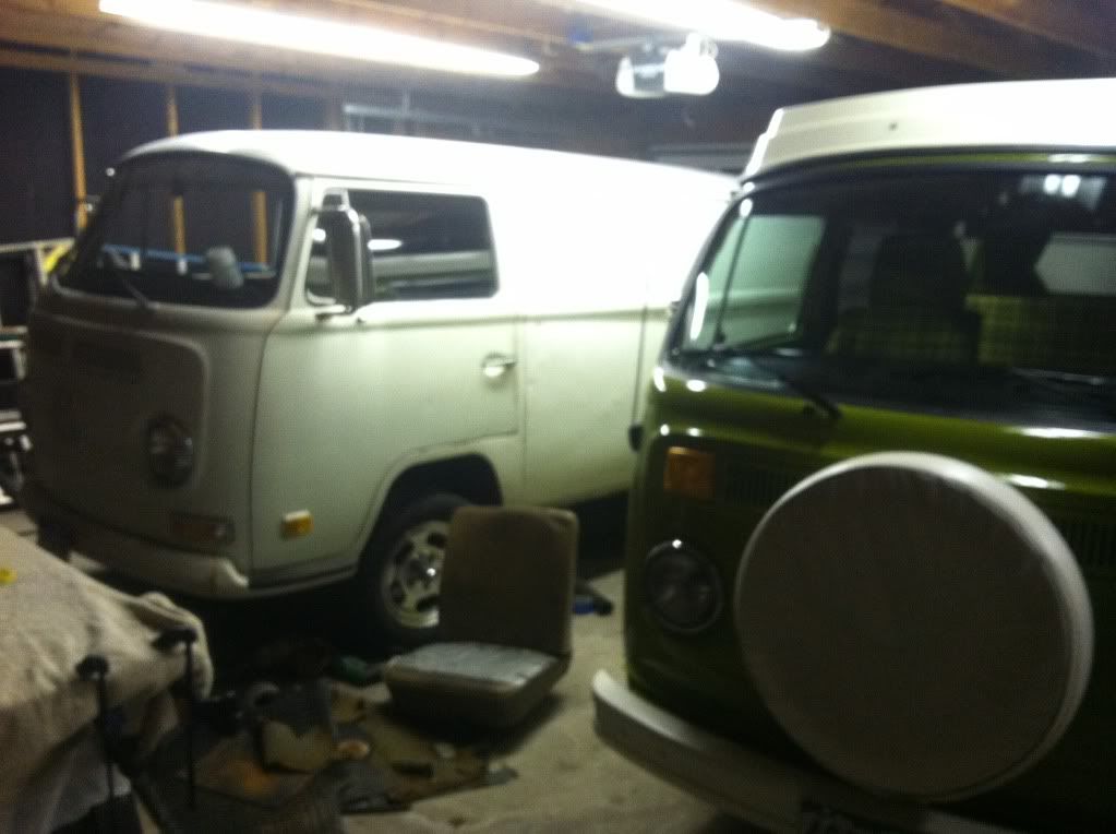

Hello Everyone. Thought I would start a thread to document my next project.
This project has no timeline and the budget is gonna probably exceed what I really want to spend. I tried adding up numbers for this build but perfection doesnt seem to have a budget. Best guess $15k. I'm bit thin on funds now so it's gonna be a slow start.
Scope of project:
New engine: 1776 with duel Delortos and upgraded exhaust. (engine in earliest stage of production, it's only on paper so far.
New shocks: Koni's of course
New wheels and tires: going OG rims and. Hankook tires RA08 ( I found the OG tires off this original bus from a guy 1500 miles away. Small world.
Rebuilt Tranny: was thinking a Rancho rebuilt one? Or have my mechanic rebuild it, or I may just replace hockey stick etc myself and call it a day. Any suggestions?
New CVS joint: German Lobros if available
New seat cover: originals are Dark Beige. Anyone know of the correct vintage
Material? Vendors? Was thinking Sewfine or WolfsburgWest for seat covers and pad. Horse hair I'm leaning towards for padding.
New door panels: the doors and locks will receive vapor barrier and sound deadner and lock rehab during this process
New headliner in cab area
New Paint: all body to be soda blasted to bare metal, any cancer replaced with new metal, should barely be any new metal. Hopefully. The cOlor will be stock Pastel White exterior and cab area, the cargo area will get painted the stock grey/off white which they painted these commercial vehicles. If anyone has this paint code please post it here.
New German body, door and window seals: German is the only choice here. All my glass is OG and deserves the best.
The under carriage is perfect but will get a recoat of Waxoil German undercoating to make it new again. All of the cavities will be treated.
New front and walk thru rubber mats. Got great deal threw CIP1. Cheaper than what manufactures sells them for. Plus free shipping.
My stero is original VW factory radio so the plan is to put period speakers in the door panels. Gotta love those 70's speaker. Not much range but boy te experience driving down the road with tunes playing threw them adds to the experience.
Upgraded headlights: new HD lights from busdepot.com
New tie rods
New engine seal
Powdercoat engine tins
New or refurbished heater boxes: are after market heater boxes as good as OG ones? I no that type 4 OG are way better than aftermarket.
Interior dome light: gonna refurbish these if at all possible.
Dash: dash pad and front facing portion of dash is mint, the metal needs stripped and paint or maybe new? Are there NOS or new metal dash available?
Heating system: rebuilt from ground up. I live in Colorado and want to use bus for daily driver when finished so it better have enough heat to keep my fellas from turning into ice cubes.
Well I may have left something off list but will update as I go. Here are few pictures with many more to follow.

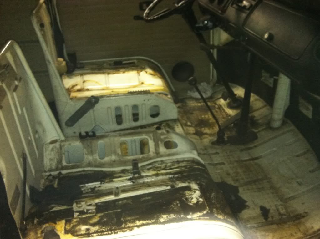

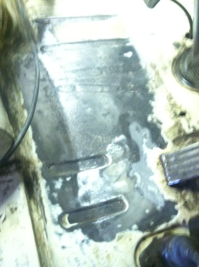

Start of project... Tearing the old tired floor and seat stand mats out.

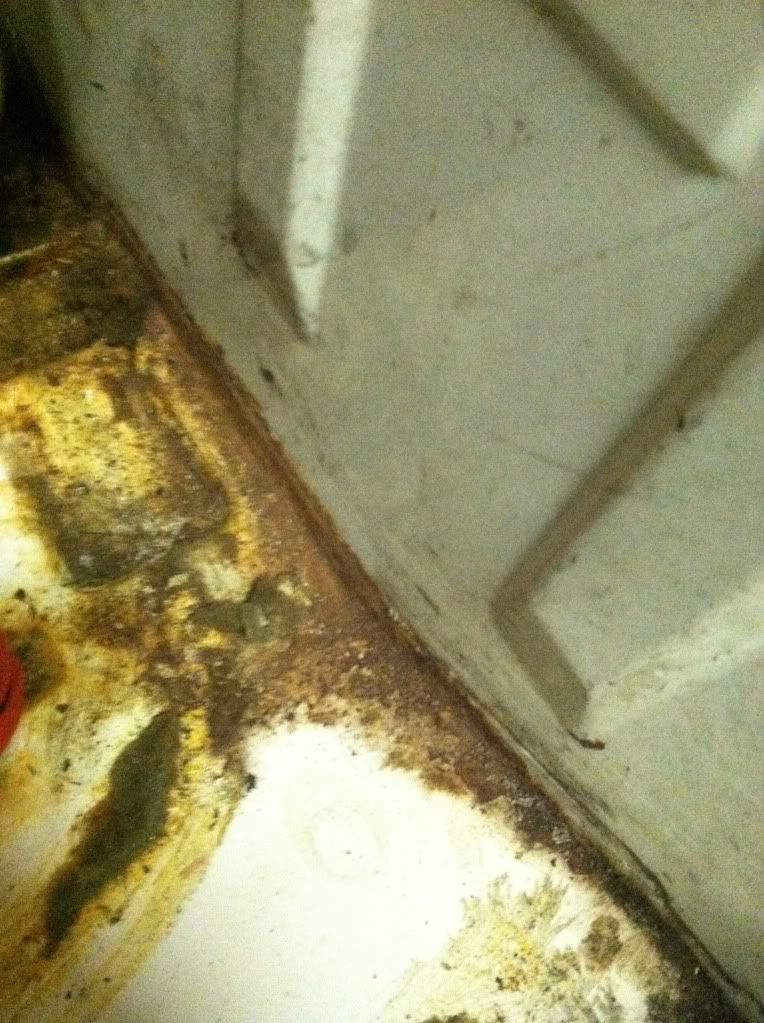

Found some rust under floor may and near brake fluid res. treated some last night. Will grind and POR-15 the rest this week.
The pictures look worse than what's really there in terms of rust. Mostly dirt and glue. The rust is mostly surface. No holes. The floor infront of driver the worst in bus. Pitting Sad there also a bit of rust under seat stand. Seems like the wheel well welds were not all the way caulked.
More to come....

That's a nice looking bus you lucky bastard Smile
curtis4085 wrote:
there also a bit of rust under seat stand. Seems like the wheel well welds were not all the way caulked. ....
The rust behind the drivers seat is very common on early buses, it's from messy brake fluid reservoir refilling or it overflowing when pushing back the pistons to install new pads.

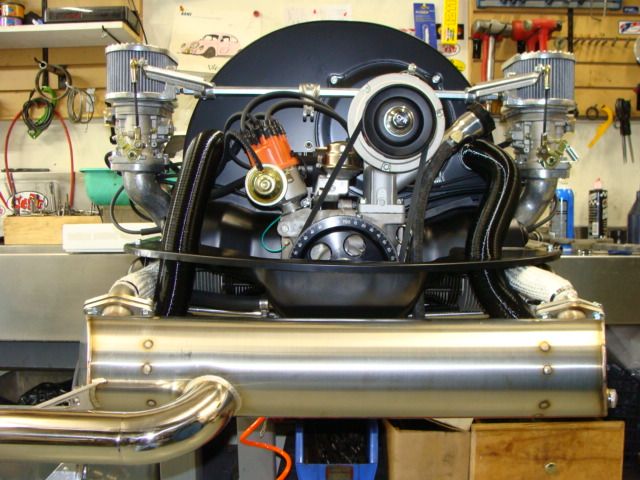

skills@eurocarsplus wrote:
Sounds good, but if I were you (don't you love when people say that?) I would go bigger on the engine. For pennies more, you can build a nice 1904/1915 and choose your rods/crank carefully and have yourself a t4 killer. If you plan on running heater boxes, consider a nice pair of L3's
I would also consider a freeway flier transmission. I have noticed in my 71 westy vs my 71 single cab a big difference in crusing rpms. I can't prove it but I think commercial's have different gearing.
Or, go 091. With the upgrade in power, you should have no issues. I plan a 091 swap in my single at some point
I love the suggestions...
I was looking into bigger engine but living in Colorado foothill mountains I'm worried going to big and not shedding the heat properly. I'm really not concerned with speed and will never be over loaded. Was suggested to me by engine builder that 1776 was safest bet.
Being incredibly green with the upright engines im at the mercy of the Bently and thesamba gurus to point me in the right direction.
A freeway flyer sounds awesome but probably would double the tranny budget. Thought stock tranny was $750 rebuilt threw Rancho. Freeway if I recall was double that. I could be wrong as I'm going from memory. Question? If I only plan on driving most places no faster than 60 mph is a freeway flyer a needed upgrade?
Well, if you are ok at 60 (use a gps to validate the speedo) then don't sweat it. My single cab is begging for mercy at 60...with no load. My westy, otoh is pretty happy at 70. It should be happier with the 1904 I am putting together.
I agree, bigger isn't always better but you really are within about 100 or so of a 1904.
Heads are the same (bore size) from a 1776 to a 1904....you are a crank and rods away. I am building a 1904 out of a 1776 now. Easy peasy.....
74mm crank
5.3 rods
90.5 pistons
110 cam
36 drla's (you are going to do anyway)
Get it all balanced and go. That should put you in and above stock t4 hp and torque
I was looking at a freeway flyer but read it could cause chronic over heating issues driving in town. Was told engine could run hot doing 45 in 4th gear. Just hearsay at this point but got me thinking. I really do not drive these old girls for speed. Just pure love and enjoyment. Doing 55mph max is fine by me. I was looking at the Rancho rebuilt trannys. Have you heard any issues with these units?

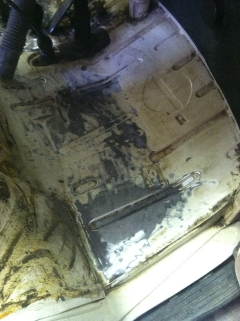

PostPosted: Tue Jan 01, 2013 10:10 pm    Post subject: Reply with quote
Started attacking the rust issues today. Wanted to go easy so i used a drill with a abrasive stripping disk. THere is some pitting in the floor but no threw spots/holes.
The Dash is cleaning up nice. Lots of elbow grease and probably couple more hours before the plastic is all clean. I will have to pull the metal portion of the dash to paint at some point.
The bare metal will get the Por-15 treatment and then rattle canned to match *Temp- till the real paint day... Soda blast all to bare metal and repaint same Pastel White is the unltimate goal.
Next step is get some 3M adhesive remover to get the glue off the pedestal. I have the fresh air deflector out for deep cleaning.

Here is a video of what it will look like when it arrives. Mine will be a 1776 cc.

PostPosted: Wed Jan 02, 2013 2:09 pm    Post subject: Reply with quote
Without knowing the specs on the engine, no one can guess....
Cam?
Heads?
Compression ratio?
Crank?
Rods?
I mean...you can turbo a 1600 and eat a 2180....
the engine virtually the same. same cam, same heads, same crank, same rods, the only thing different in this build would be piston size.
the 1776 Im getting has upgraded heads port polish and bigger valves, same as the bigger engine.
