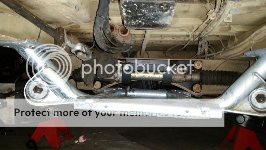

i would say that power steering is and absolute must have. it make the whole experience of driving these old busses a pleasure rather than a chore.
living in the uk and having a rhd doka with out power steering it was always on the list of wants but rhd t3 power steering racks comarnd a high price, i do not like the idea of eps so anouther solution was sought.
the rack has the same stroke as the standard t3 ps rack so there is no loss of turning circle. it was sourced from a very popular and common car. which makes them cheap and easy to source, there is no reason why this could not be done with a lhd t3 and lhd rack if the origional ones are becoming costly and hard to source.

I have PS , I'm wrestling the fuel tank and noticed all the parts in the way and just got caught up on the thought. My lines are good.
Axeman, I'd like to know what PS rack you've found that works?
