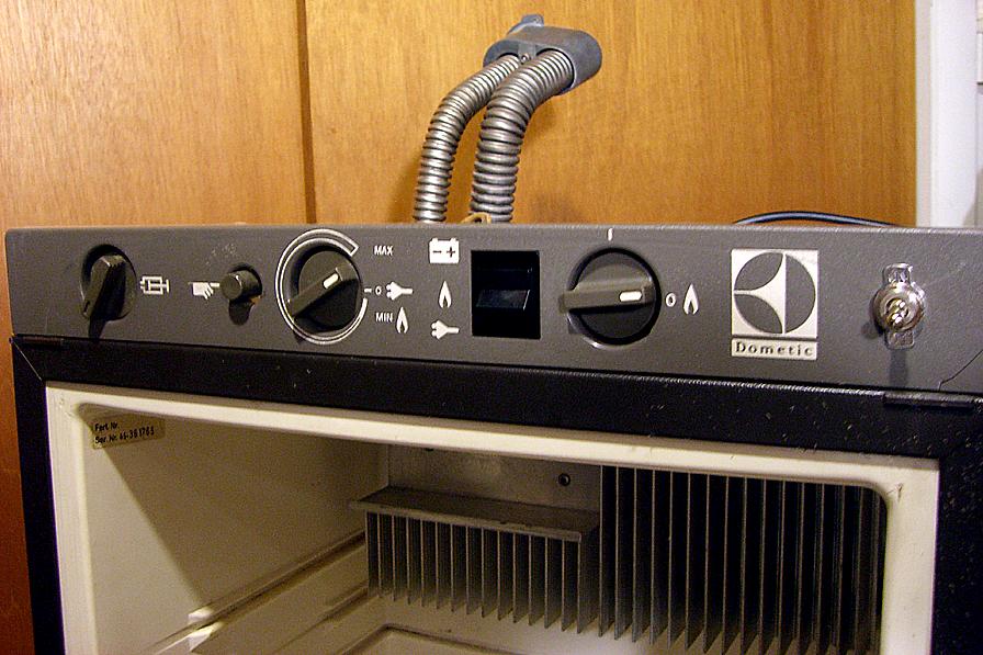

Well, I had long understood that the first time I had pulled Winston's Dometic 182b that I had neglected to service the Dometic's propane burner.
Well, for starters, I'd put the wires for the auxiliary power socket I stuck next to the vent across the vent ducts. Had to disconnect them, they shouldn't be in the way when I REINSTALL the fridge. Made a point of inverting the fridge several times while I serviced the burner--the first time, I did hear some WEIRD gurgling from the coils, maybe the air WAS working out of the ammonia. Or maybe not, but I didn't think it would hurt anything. The vent hoses and the lower drain are clear of obstructions.
The insulation connecting my spark starter to the ceramic plug in the combustion chamber was frayed, and there was carbon all over the electrode, cleaned that off, and the end of the thermocouple. Put some rubber tape and a shrink tube over the frayed wiring and crimped the plug to the piezoelectric switch--THAT was loose. Got a nice shock out of it. Made a new gasket for the burner assembly out of heavy neoprene while the jet was soaking in Acetone. I did find the body of a tiny little spider in the nozzle.
Shocked
I'd cleaned everything else out pretty well the first time I'd worked over the fridge and did the GoWesty air pump mod. But I've NEVER heard that fan on the back turn on, and from the shape it was in, I don't think I'm likely to do so.
My current plan is to wire two very high quality Panasonic 12 v. Muffin fans together in parallel, attach them to the wires for the fan BEFORE the thermal switch, which I've disconnected, and then rig a switch in the hot wire going to the front panel of the fridge. Then I won't worry about when the fans turn on--I'll decide that--and I'll know they'll be working then. I'll have a fan blowing air across each set of the coils and then out the vent at the top of the fridge when I want them to.
I took a good look at the worst of Winston's rust behind the fridge--that was easy to do because I reached down and felt the old fiberglass insulation, and it was DAMP. I haven't filled the tank for MONTHS. The fridge hasn't been on. THAT DID IT! It's all gone. The rust, in fact, isn't that bad, but that's sure why there's rust in that spot and no where else.
Ducked in to Home Depot and found a 10' x 24" roll of that Reflectrix insulation that MightyArt likes, for $11. Not quite sure how to attach it--Home Depot was selling Aluminum tape right next to it, I've also got carpet tape and spray adhesive. It does look like interesting stuff, they say it's good for radiant heat and sound deadening.
I looked everywhere for the rust neutralizers Loogy's recommended--couldn't find Osco (I think it's actually called OsPho), Auto Zone says that they carry Evapo-Rust, ours didn't, and nobody had MP-7 = The Must for Rust. I asked a good garage what they used, and ended up with a quart of K;ean Strip 'Phosphoric Prep and Etch' which seems to be a phosphoric acid solution. It warns about prompt re-rusting, but also says it does a good job of prepping for painting.
I took a wire brush to the seam, used the shop vac to vacuum away the loosened material, and hosed the whole area down with the stuff as a spray. I may repeat that tomorrow. The stuff seems to be having some effect. Once it dries, I'll spray some leftover Hammerite (It encapsulates rust!) over that, and then attach the Reflectrix insulation some distance above that. The seams and gaskets of Winston's water, electricity, and city water ports all seem to be fine, actually, and I used my filler to prevent leakage all last year. I think that fiberglass is more EVIL than r39o's rear heater core.
Once the Hammerite's dried over the damaged area, I'll spray on that Mercury Marine Corrosion Preventative = WaxOyl and no insulation will be on the lowest inch of the area behind the cabinets. The side panel will still need to be welded or replaced, it's bad along the seam and nowhere else, but that should buy me some time. Dang it, I've only taken Winston to work during the summers, I want to cover some ground in him.
I'll have to rig the two fans for mounting, I like the split hose some have used for dampening vibration, and then it's screws or baling wire to hold them close to the Dometic's fins, I think.
Anybody have any suggestions?
And I am very tired.
Best!

PostPosted: Sun Apr 01, 2007 10:32 pm    Post subject: Project Concluded, with the Usual Embarassing Error Reply with quote
Well, that's done. I made one silly and embarrassing visible mistake, but, on the whole, everything I planned on doing is done, and what I can test looks good.
All right--I did what I said I was going to do in my earlier posts--when I found that wretched fiberglass still damp when I hadn't filled the tank since August, it went. Every bit of it. I should have taken Bucko's kindly warning about the gloves and the long sleeves, but I got away with it. Rust, gunk, everywhere, it's all gone.
Then I wire brushed the rust scale away, vacuumed everything off, used that Klean Strip Phosphor Etch and Paint, and put down the three coats of white Hammerite to starve the rust for oxygen. After Bucko's warning, I wrapped the connector for the 'city water' with fusing rubber tape and re-rigged my auxiliary socket so that there was wire enough to clear the refrigerator exhausts. Then I used the removed fiberglass and cut sheets of Reflectix (I got the name incorrectly in my earlier posts) to the same size. Here's what it looked like when I was done:
The mounting squares worked fairly well, the aluminum tape was the best. I used a razor blade and holder to cut the hole in that for the refrigerator exhaust. Once that was in place, last night I sprayed a good thick coat of that Mercury Corrosion Preventative = WaxOyl, so wax DID get in there. But it's on top of the rust, in between that and the air. I'll seal the outside seams with acrylic sealer in time. In case anyone's wondering, that little strip of fiberboard that wedges the fridge on the left side had fallen off--I used a heavy staple gun, and it's going NOWHERE, now.
I had two very high quality Panasonic muffin fans that I'd bought a long time ago from an industrial electrical supply company to cool my computer case. Never used them for that, I ended up buying a very noisy, very cool 'Tornado' model from 3DCool instead. The only bad thing about these two fans was their 'telephone wire' gauge connectors, they even had the direction of the fan and the air flow stamped onto their cases. Finally had a chance to put them to work in the place of my old fan.
The man at the Radio Shack said I was mad! But he also said I should wire the two fans in parallel and put an on-off SP switch in the ground circuit. I soldered 16 gauge wire onto the connectors of the fans, I should have used crush-splices, because one of my solders snapped off and I had to use one anyway when I spliced in some wire to repair the connection. I did use the crush-on twist splices for my two junctions in the fan circuit.
I wired in an old fuse holder into the power circuit--the yellow wire on the Dometic's fan circuit--and putting in the switch was fairly easy in the ground wire. I used a toggle switch from Ace with screws and ring terminals on the wires. I have little confidence in my soldering. You can see the red power wire holding the fuse holder and the blue/black wire running to the switch in the front console in this picture:
I used split rubber tubing--actually insulation from the sprinkler system cable I used for moving fuses to the new fuse box--on the fins, and 3.5" #8 Machine screws, through the fan housing and with washers on the heads to press the fans tightly against the hosing as they gripped at the fins.
It was a little fun getting all those long screws through the fans and the fins on either side of the cooling tube, but I managed it. The task would have been easier had I found and employed longer screws. Here's a good look at the final mount:
I hooked up the fan circuit to a little 1.5 amp 12v. battery charger, and they ran and moved a lot of air, so they're certainly not using that much power! I'm always a little amazed when something works. I used a 5/8" drill bit to punch a hole through the Dometic's top plastic panel, VERY CAREFULLY--that's old plastic, I put some 'Goop' urethane glue over the cracks I found in that. I had to use a carbide cutter on the Dremel to make the hole exactly the right size and smooth out the edges. And here...
Shocked
Is the embarrassing visible mistake. I forgot that that top panel is partly covered over by the wooden panel that encloses the Dometic's front door on a Westy. Here's where I put the switch, which was a very good spot in terms of the wiring:
Two centimeters, at least, to the left, folks. I was sufficiently grouchy when I found that the molding covered the switch to cut a notch in the plastic trim and use the Dremel and cutter to make a slot in the wood of the panel just big enough to let the switch move. When it did, it operated both fans very satisfactorily, even with the refrigerator off. You can feel the air coming up and out the vent on the side of the 'kitchen counter.' The two fans running together are quieter than the four in my computer case, but audible. Here's a picture of the entire set-up:
With the usual struggle, everything went back together again and into Winston, and of course I was eager to see if the fridge would light. I put my piece of brake line to the bottom of the vent... I blew in air... I pumped my GoWesty retrofitted pump... I clicked my re-insulated and cleaned sparker... I pushed the fuel button. For an hour and a half. And got... JACK.
Oh, goody. At least I could test the sparker by spraying just a whiff of starting fluid up the vent hole and hitting <WHOOSH> that... But... Nothing...
And then I remembered that I'm not the only victim of that $!!!)*&@ panel. The dratted thing hides the 'I' indicator of the gas valve at the top of the refrigerator. You can see it in the photo above, but not when the fridge is back in the van. I had it in the 'O' position.
Well, that was stupid. UNDERSTANDABLE, but stupid.
Shocked
10 minutes later, the fridge lit very nicely.

Curious about how hard/how long it takes to R&R the fridge. Pretty sure I am going to find the usual horrorshow of damp yellow fluff back there and a bit of tinworm to scour away. But I am mostly interested in making the fridge work better/quieter — mo' better fans and whatever TLC it might need. Is this a day or two to manage? I am living in a 6th floor unit with my rig parked behind a nearby retail business. I have space and reasonably secure privacy to work but wouldn't want to have my Frida eviscerated for a long period of time.

I'm glad to hear I'm not the only one that has struggled to light the fridge only to find I had the gas in in the off position.

Removal is surprisingly easy: screws on each side through the cabinets; unscrew the vent; disconnect the propane and electric; slide it out. Easily done in less than an hour by an amateur like me after reading about it in the Bentley. Air pump recondition, fan refurbish, and reinstall I can't comment on, mine went to the dump after doing too little for too long.
Excellent. Mine works (worked? It failed to light last I tried…but that was without pre-cooling, since I have no shore power) well, it's just noisy and I think it struggles a bit, given its age and lack of attention since installation. Sounds not much different from pulling the dash and I have done that three times in the past year Brick wall

To me, it sounds like. It's 10x easier than pulling the dash. Very Happy

Hmm, not so much easier than the dash if you don't disconnect the right gas line and kink the ^&%&^% out of it. The Bentley (cursed be its name) says, blithely, "disconnect the gas line" with an arrow helpfully pointing to the wrong fitting, the one for the stove. I assumed the one I wanted was the one I could see, not one obscured by the cabinetry. Once I pushed the fridge all the way back in, fighting with the flue for every inch, I was able to get the right connection off and it came out quite easily.
So what are my options if the copper gas line is a tad…bent? Do I get a plumber to make a new one? Or can it be used as is?
This is exactly what I didn't want, to have the pieces out and no way to put them back in.
On the plus side, the insulation looks surprisingly good, if a bit dirty. I haven't pulled it yet, as I have reached my quota of disappointment for the moment. Found out why the stock fan makes noise: one of the blades hits a pipe on the back with each revolution — tingtingtingtingtingting…So a little muffin fan is waiting to go in its place.

Prolly past that now…as it's sitting here in front of me.
Going to see how well it goes back tomorrow. I know to remove it properly now. I'm not as bothered by what I see behind it and when I can do a proper ServantOfElwood job, I'll revisit this.
I'm not sure where the two leads go for the fan, which is + and which -. I don't know that it makes a lot of difference as the fan is right up against the fins where the stock unit was and will pull air either way. I'd prefer it pushed air into the fins if possible. Looks like yellow is + from what I can tell above.

So upon reinstallation, I seem to have made the supply line to the fridge leak. I got it reconnected and when I crack open the tank valve a half turn, I get some bubbles from the soap I liberally applied. Seems like a tight connection but I will re-do it presently just to be sure of it. Failing that, how can I cap the fridge line so I can still use the stove when I am afield? I hate to think I have killed the most field-worthy part of the Dometic but I'll deal with that separately. Do I just add a valve in the line before it gets there?
Hoping this is all academic but it would be a shame to lose the ability to cook as well as chill food.
