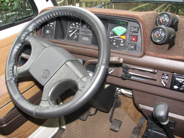

PostPosted: Wed Nov 14, 2007 2:02 pm    Post subject: Reply with quote
uther wrote:
TOW'D wrote:
up here in the muddy rain coast of BC
the best thing we added to our syncro was front wheel mud flaps
ours are made from light weight conveyor belting and fit the whole wheel well - large "fender"washers and bots to hold them on.
Sure keeps most of the crapola out of the sliding door.
pictures please!
r
We went for the functionable (read funky) look
the oil pressure and volt gauges are from a jyToyota PU.
The Vacuum gauge was built in 1938 and used in the steam plant that I helped dismantle.
I have a 1/4"shop air hose zap strapped under and back to the FPR on the motor where I Tee'd
we try to run at 10 inches of mercury
17 to 22 inches at 1000rpm near sea level -
this 2.1L wasserboxer is strong motor everything except hot oil pressure is good
it has to be the fastest motor to start that I've ever had-
Just a couple of flips with the starter and it is running in all types of weather
this photo
The mud flaps are from the same place the vacuum gauge came from.
not fancy but very good for keeping the mud out
snowed like mad a couple of nights ago and it was no problem for syncro da Dr. Mayo in low low

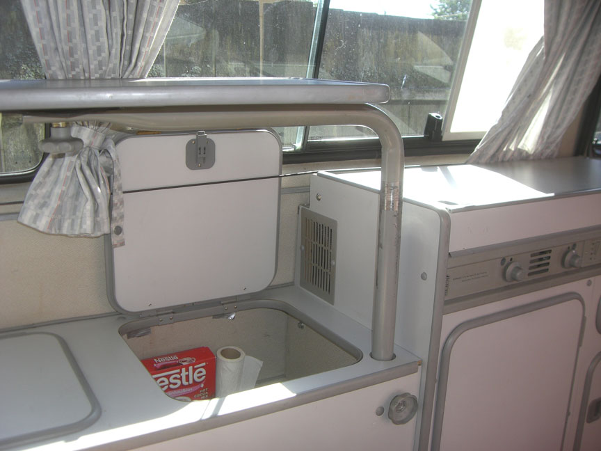

I did Sodo's table extension and we love it. Saying that, have seen table extension done with tube on outside of table leg rather then inside. Not saying one is better then other, but thought it was interesting way of doing it. http://www.brick-yard.co.uk/forum/forum_posts.asp?TID=30514
