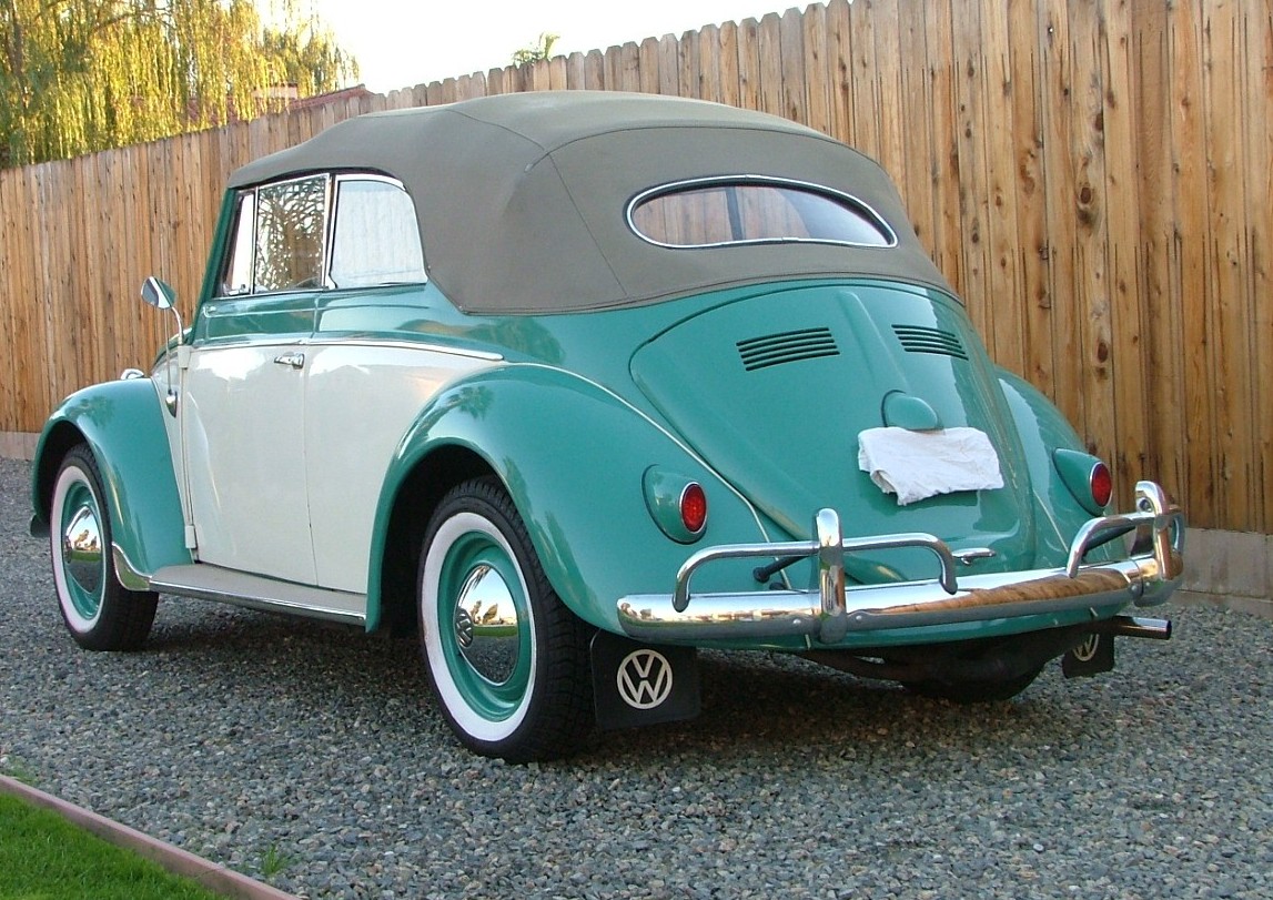

Sent a msg to the author of this thread, but seems he hasnt been online for months.
Anyone have an idea what color he is working on?
Looks like a darker sea foam green, but i dont know.
Anyone know the color i would appreciate a PM
Thanx

Java Green?

I saw tones of java looking back, but im not convinced, maybe a darker Turkis?

Here's a full size photo of the car I found in his Gallery
http://www.thesamba.com/vw/forum/album_page.php?pic_id=311979
In this photo, yes, it sort of looks like a darker Turquoise.
I don't think this car is a VW color at all though.

the paint looks like Volkswagen Turquoise code 95588 year 1960.
