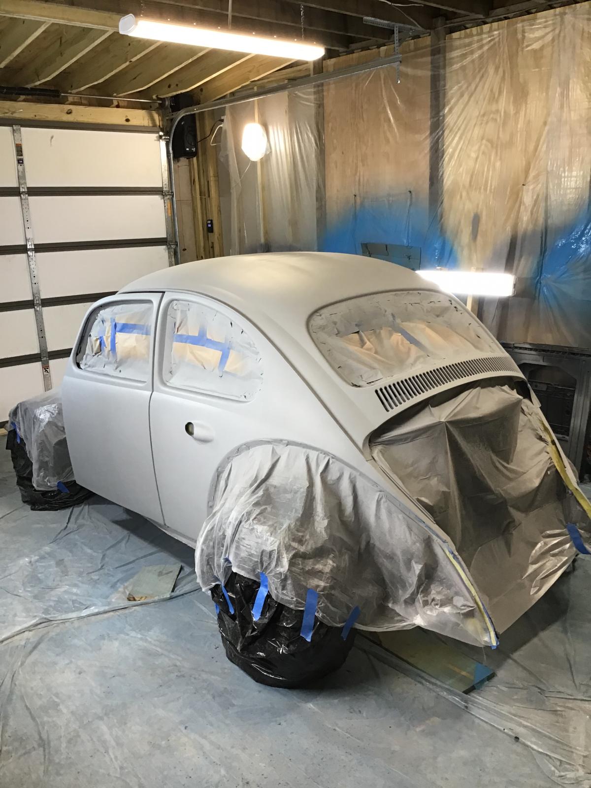

I just finished laying the 2K primer on my project. I wiped car down with a microfiber cloth and some acetone in a spray bottle b4 the primer. A spot that I had made a previous repair and sprayed with rustoleum primer from a can started to gum up and dissolve when rubbed with the acetone. No other areas were affected.
I don’t expect the acetone will have that effect on a 2 part primer so I will be using it again followed by a tack rag b4 I apply the basecoat.

Will acetone have an adverse affect on 2K primer? I will be hand sanding(wet) today in preparation for laying the basecoat early next week. What is the best solution for final wipe down of wet sanding residue b4 the tack cloth?

Going thru my shop supplies and just realized I have an unopened 32oz bottle of Rustoleum wax & tar remover. It specifically states:
For use before & after sanding.
Viiking stated earlier in this thread that wax & grease removers are usually based on acetone. Any experience with the rustoleum product & does it contain acetone?
