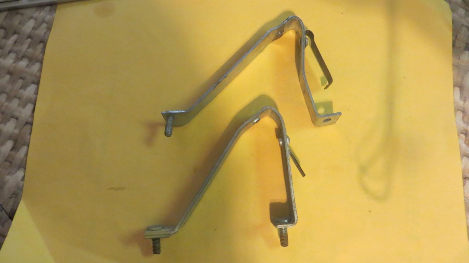

Here is an early snowflake from my vert. Build date Aug 9, 1955, no part numbers and the diffuser is like the heart taillights. There was also a gasket between the glass and reflector.
Different brackets also,the bottom bracket is from my vert. Notice the bottom is angled different than the top bracket and the ground is also different.
I would have to drill a new hole on my fender to use the top (standard) bracket.

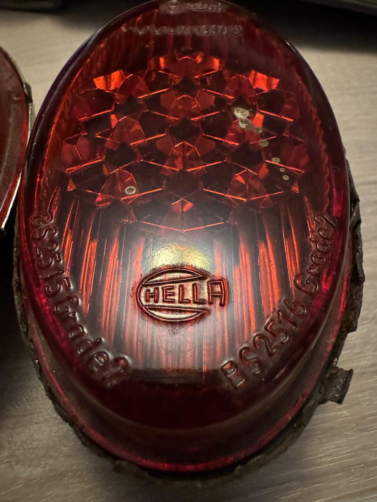

Here are my collection of Hassia and Hella lenses with small and large logo.
I would like to know what lens is for what year. For instance a 59` euro spec?
