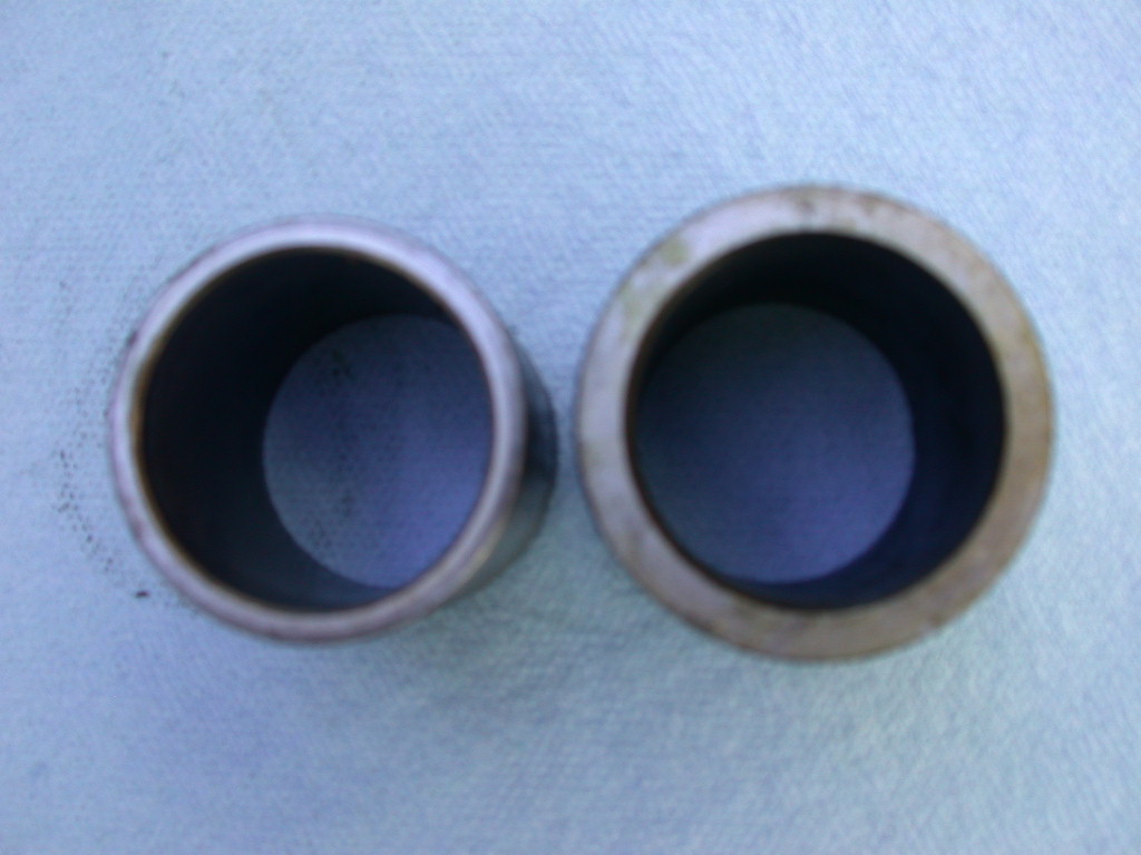

One of the reasons I was intent on performing this service (aside from not knowing the history of the rear bearings) was a note in the Bentley manual that the rear bearing spacer on vehicles prior to VIN 25ZBH119362 should be replaced with new sleeves. My van was a candidate for this, so I decided to see what the difference was. The VW part number for the spacer is 211-501-281-E.
In the photo below (sorry about the poor focus) you can see the new spacer on the right is quite a bit thicker than the original on the left. I'm assuming that this extra thickness was an upgrade needed to better withstand the 360 ft. lb. of torque to be applied to the new axle nut.
I was a bit disappointed in the appearance of these new spacers, however. At $61 apiece, one might have hoped for something that didn't look like it had been cut from a length of plumbing pipe. Sad
Then again, one shouldn't judge by appearances...
