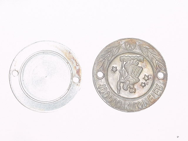

Are these 100K badges real or reproductions? How can I tell the difference?
Back side. Not the greatest pic...

Added to the original post. I'll see if I can get a better one later.

PostPosted: Sat Sep 02, 2006 9:08 pm    Post subject: Reply with quote
OK...........simple answer: They are both fakes. The St. Christopher lacks detal around the letters and laurel leaves. Easy check is the dots between the leaves. They are not sharp and lack defination. The letters " E" in Kilometer are rough and not precise. St. Christopher looks almost bald and the Christ child has no face. It is a '60's cast piece.
The body badge is also a fake. The leaves lack the detail and the letters are not precise. These badges should be as sharp as a die struck coin and have no casting flaws or weak detail. The reverse of the body badge should have the maker mark "tweer&turck....Ludenscheid.. on the bottom of the badge. The originals are so sharp on the edges.......you can cut yourself with them... They also have beautiful finish....not the "mat" finish of your examples.
I'm sorry to be the bearer of bad tidings. Sad

PostPosted: Sat Sep 02, 2006 9:15 pm    Post subject: Reply with quote
Almost forgot.......the originals are very thin. Thinner than you would expect, because the metal is a much higher quality.

PostPosted: Sat Sep 02, 2006 10:12 pm    Post subject: Reply with quote
Good thing I didn't pay any $. They came a box with a bunch of other parts a guy sold us.

I'm glad too........the real badges are really quite rare when you consider how many cars must have qualified. The British re-poped them in the 60's and once you have seen the originals you can spot the fakes across a room........but most people are never given that opportunity and the fakes have taken on a life of their own. There are "good" fakes and bad ones. The ones you posted are in the good catagory. Unless you have been a collector for years and know the differences........those are really quite nice and are traded for around $80 all the time. The real badges sell for around $200 and are cheap at that price.

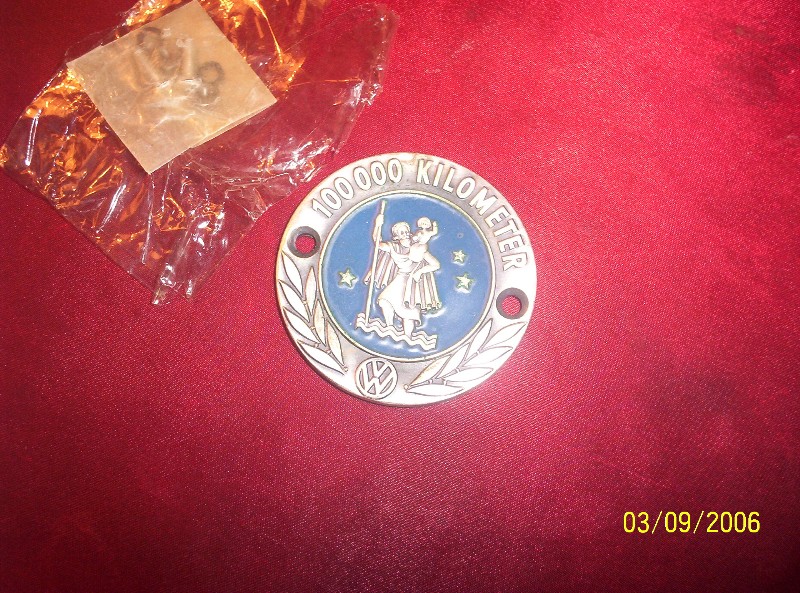

This is what came with my 100,000 presentation set

PostPosted: Sun Sep 03, 2006 10:56 am    Post subject: Reply with quote
The early sets came with a beautiful VW embossed folder, with a certificate, a stickpin, and both badges with screws.

PostPosted: Sun Sep 03, 2006 11:04 am    Post subject: Real I hope? Reply with quote
My picture probably isn't good enough to see all the detail.
This the first time it has been out of the wrapper.
It looks like it has darkened with age.
The one in my car has turned almost black (dark gray)
On both you can clearly see Christs face and the dots between the leaves.

PostPosted: Sun Sep 03, 2006 11:21 am    Post subject: Reply with quote
You will also note that on Dan's example the St. Christropher's left leg is distinct and on the first example it's almost an after-thought. The hand holding the staff has clear and distinct fingers as well. Also notice how well the letters are formed. St. Christopher's beard should have clear and seperate hairs visable too as well a curl to his hair at nose level. The color "blue" is very much like the blue used by Hazet screwdriver handles. It is very obvious when compared with a known fake.

PostPosted: Sun Sep 03, 2006 11:32 am    Post subject: Reply with quote
Yay its real !
And the one in my car is real too!
Click on the picture and detail is much better.
Again, the value comparing the fake with the real thing.

PostPosted: Sat Sep 09, 2006 4:42 pm    Post subject: Re: 100K Badges Reply with quote
Hello,
All two are genuine. there is not reproduction divides. the two divide are 100% originals!

PostPosted: Sat Sep 09, 2006 6:01 pm    Post subject: Reply with quote
Hmmm. There seems to be a differenc of opinion. I'm gonna see about some better pictures and let you both take another look.

PostPosted: Sat Sep 09, 2006 7:00 pm    Post subject: Different opinion Reply with quote
My money is on Bob.
He has been collecting for a very long time
And knows his stuff.
