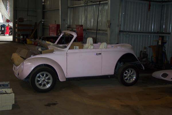

Does the 78 Super need supports welded before removing the body from the chasis? I have heard there is enough support and it is not needed. I know that rust is not a problem. Thanks in advance _________________ DAC

Posted: Wed Dec 20, 2006 7:38 am Post subject: |
Yeah I believe the PO did a really good job on the body - he owns a body shop.
It looks like they powder coated the pans as well as completely painting the body and I can't find any rust on it - not bad for $1200. It arrived in about 1,000 peices with a motor out of a pre '67 Bug & half the wires cut
They did not align the body and only put in half the body bolts and left the heater ducts off so I gotta take it back off. I WILL keep the doors shut though
I'll take some pics of the interior this Saturday. Oh it's for my wife - pink just isn't my color  _________________ DAC

Posted: Wed Dec 20, 2006 2:13 pm Post subject: |
I'd say for only $1200 you did just fine!
When I replaced the convertible support rails on my car, I had to redrill some of the body mount holes, because the support rail holes were slightly off. Now that could be a result of my pans being replaced once before. (I can't tell for sure, but they might have been done by a previous owner.)
Is that the same issue that you are having?
