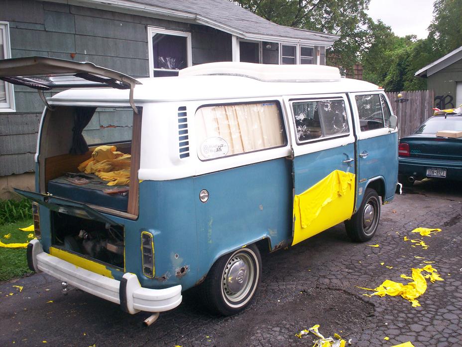

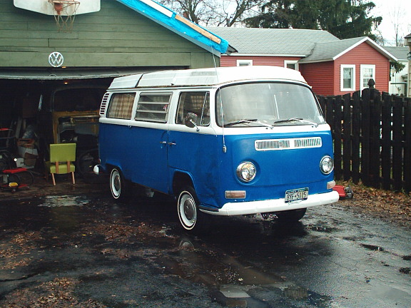

I have painted three Buses with a roller and it was pretty easy and the results were decent. The first one was a '72 Westy I picked up for $100 an just waned to get it looking decent enough to sit in the driveway without pissing the neghbors off too much. It was an inexpensive exterior latex from Home Depot. I got a gallon of each color and had plenty of paint left over. Regardless of the fact that I probable spent less than $50 total to do it, it's most definitely an improvement.
Before:
After:

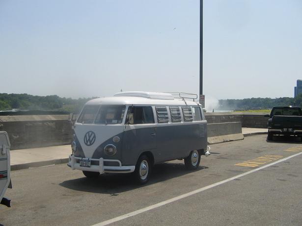

The second one I did was my '62 15 window that needed a quickie repaint to cover the PO's "artwork." It was hotter than the fires of hell the day I painted it and I used Rustoleum High Gloss Enamel right off the shelf at Home Depot. $7 a quart. If I remember right I used 2 quarts of the grey and one quart of the white. I used two good heavy coats and the paint laid out fairly flat and had a decent shine. I went from this:
To This:
Here it is on the Canadian side at the Duty Free in Niagara Falls: That's the mist from the falls in the background. Note the designations on the pavement:

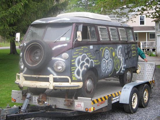

The other Bus I roller painted was my '74 Riviera. I was contacted by Fox Studios to do promotion for Little Miss Sunshine in NYC Labor Day weekend....the only catch was that I needed to be on the set of the Today Show with a yellow and white Bus. I wanted it to be easily removeable so I used Behr High Gloss Exterior Latex from Home Depot. I was painting the Bus less than 12 hours before I had to be on the set of the Today Show so I had no time to prime it. Took 6 coats of the yellow to cover the Neptune Blue and I onoly had time for one coat of white. I used about a gallon and a half of the yellow and maybe a little less than a half gallon of the white. The nice part was that with the good coat of wax that was on the Bus, the yellow paint peeled off like vinyl. Here are some before and after....then back to the OG paint.
Original Paint before:
On the set of the Today Show in Rockefeller Center:
Back home peeling the paint back off:
Paint all peeled off, rebuffed and waxed:

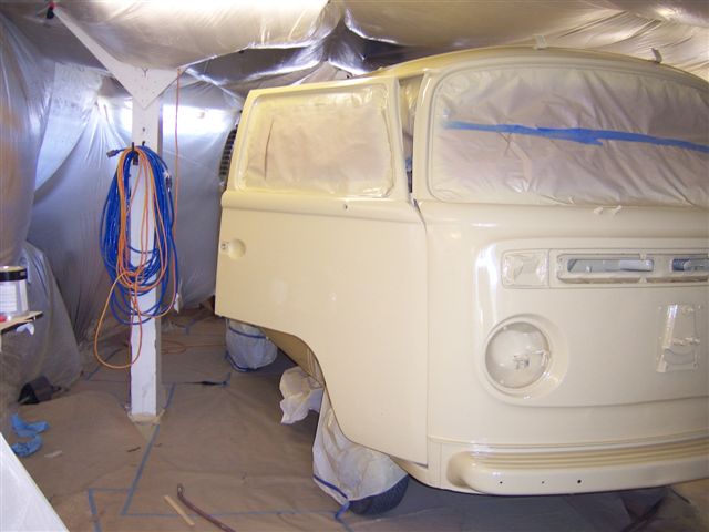

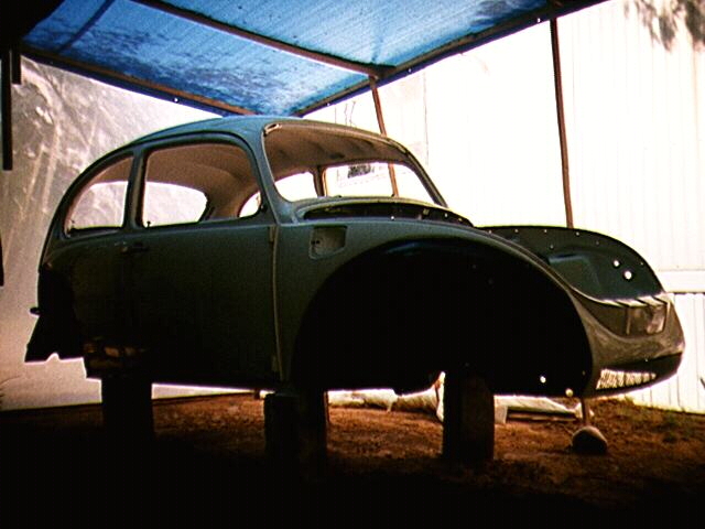

This is what I painted my bug in. A bunch of furring strips, held together with drywall screws. And you can get a big roll of plastic at HD for 15 dollars or so. A stapler is handy to attach the plastic. The first booth was made with PVC pipe. Real cheap and fun to work with. But a windstorm took it away.
Or don't worry about a booth or neighbors. Just drive out into the boonies, preferably right after a rain. Rent a little generator to run the compressor.

Looks like you have a garage... a good weekend is all you need. Dakota Beige

Now THAT'S inspiring...I can't wait to get my Westy sprayed next year. I'll be going the garage route as well.
