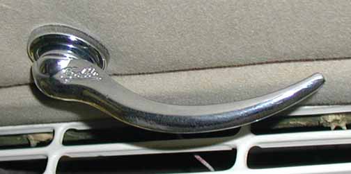

3 folds have a crease/groove down the middle like the door handle and window winder like this:
3 Fold Ragtop handles are like finding hen's teeth - believe me, I need one!

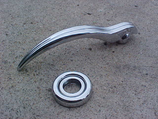

2 folds have a solid handle, like the door handle and the window winder like this:

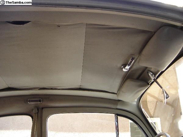

Eventually in '63, they went to a folding type handle like this for Deluxe models:

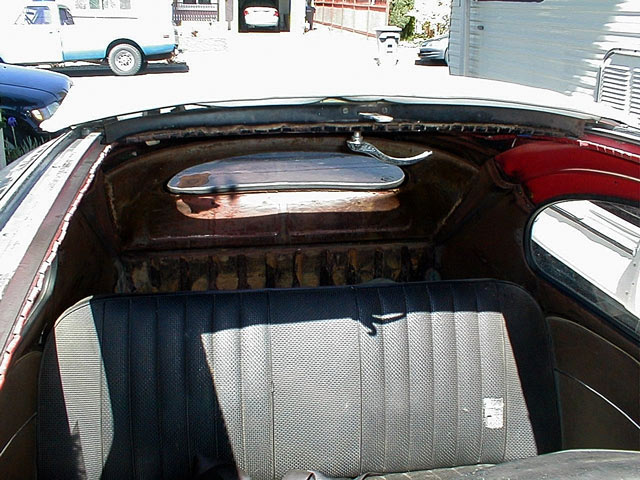

It should. I have a 2 fold handle on my 3 fold roof right now.a picture of it is herehttps://www.thesamba.com/vw/gallery/pix/336498.jpg

Yes, all the handles used the same spline size. If need be, you can even install an inner door handle to get the sunroof to open
