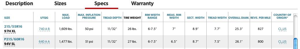

Ok, so I've been reading these forums for a few weeks regarding an upcoming tire purchase to go on some used CLK's for my 90 Multivan.
I really was leaning towards the new BFG KO2's , but they are heavy, wear faster than other tires, and then I read about BFG customers having blow outs:
https://www.consumeraffairs.com/tires/goodrich.html
I also seriously considered the Nokian but their newest tires (2.0) are made in Russia. For some reason, their cheap price and russian quality is deterring me. And why don't big dealers (tirerack etc) carry their tires?
Now, the Michelin Defenders have a few good qualities, despite the fact that they don't have the right load rating.
They last forever, they are quiet, they are reasonably priced, and I haven't heard of anyone on here having problems with them. I read A LOT about how they don't have the right specs, but I have yet to see reports of issues.
So I'm planning on going with Michelins (Defender or Premier LTX from Costco). Part of me is thinking that with my new 16" clk rims, I'll have a much stronger "sidewall" with any tire than my current stock 14" rims, ie. more vertical metal and less rubber = stronger.
Am I crazy? I feel like all the hate of Michelins here is just talk. Does anyone have bad experiences with Michelins on vanagons? If so, please share before I pull the trigger.

You said it y'self:
...they don't have the right load rating...
Personally, I'm gonna stick with the correct load rating.
Tires take a lot of abuse, and the load they carry is just the starting point.
Add in road surface irregularities, asphalt/gravel quality, bumps/potholes
of every size, cornering forces, emergency evasive maneuvers, etc. etc. and
it doesn't take much to go beyond the capabilities of a marginal tire.
Better to err on the side of caution...or please don't drive next to me... Rolling Eyes

less rubber does not = stronger.
all sizes can and are made to different specs.
get a tire that meets the specs and driving conditions you expect to use them on.

They give it a load rating for a reason. Please heed it and keep everyone safe.

My Michelin HydroEdge tires self destructed-
the sidewall disintegrated and separated from the tread. NOT SAFE!!!
After that, I switched brands found a tire well suited to Westys:
Goodyear Assurance Triple Tread 215/55-16.
97H load rating
(GoWesty sells 215/60-16 with lower load rating.)

PostPosted: Wed Jun 01, 2016 11:43 pm    Post subject: MICHELIN UPGRADED THE DEFENDERS! In 15" Reply with quote
DEFENDER LTX M/S
Consult this post:
http://www.thesamba.com/vw/forum/viewtopic.php?p=8029389
and this post:
http://www.thesamba.com/vw/forum/viewtopic.php?p=7871770
and this page, if Tire Rack doesn't play 'Moving Target' again:
http://www.tirerack.com/tires/tires.jsp?tireMake=Michelin&tireModel=Defender+LTX+M%2FS
Yes, Virginia, there are Defenders that are safe. But they start with 15" rims.
