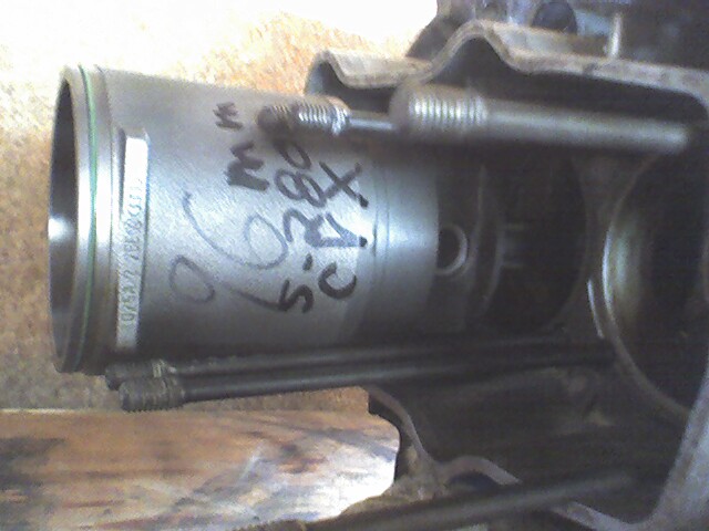

Above you see a cylinder about to come off a piston. You can see the wrist pin in the rod. If this cylinder comes off another cm the oil ring will pop out. Note that this piston is at TDC; if the piston were lower in its stroke then the cylinder could not be pulled this far from the case.

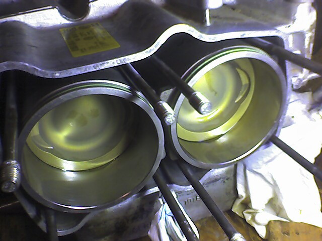

Above you see the cylinders pushed all the way back in the case. The pistons are both half-way through their stroke, one rising, one falling. You can see the green rubber seal in the groove near the top end of the cylinder.

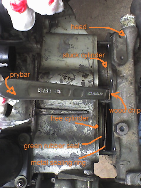

Looking down on the right head, still in the engine, about to pry the cylinder off the head. (Or is it the head off the cylinder?) There's a wood chip between the prybar and the head to protect the aluminum head.
Using a cheater bar on the pry bar to push the cylinder out of the head, back into the case. With good leverage, and with a pry tool that fits under the cylinder tab, a cylinder that seems impossibly stuck can be easily separated from the head. |
