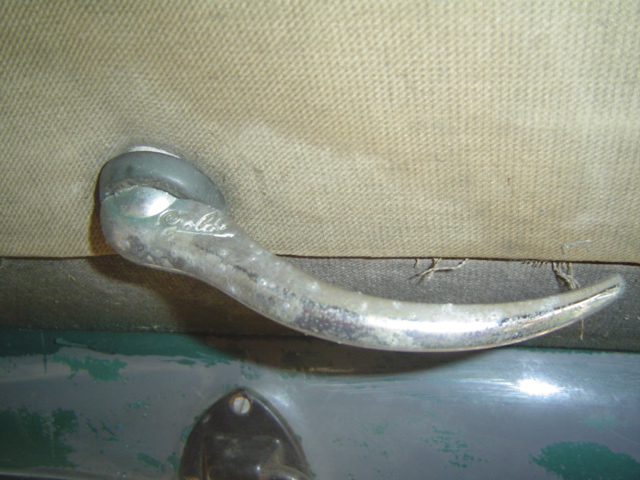

My 56 handle doesn't have the golde script on it. Does that mean it is aftermarket?

my 56 has the golde script. so i think your handle could be aftermarket.

I also own a late 1955 (June of '55) Deluxe Sunroof that has never been restored and it has the grooved "Golde" handle on it's 3-fold sunroof mechanism.

Non Golde 3-fold ragtop:
Sitting in a 54 oval, known history since 57, then the ragtop was there.
Its a Webasto.
I got a historic car, every scratch got a history...
