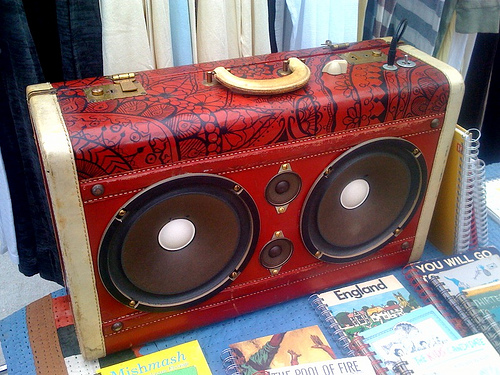

Found this website
http://theboomcase.com/
http://ghostwagens.blogspot.com/
http://vintageswampcooler.blogspot.com/

Wonder what type of battery set up they use in those boomcases. Wish there was a pic of the internals
