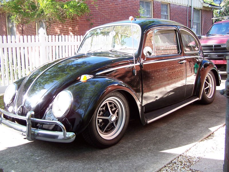

I'll start it out.

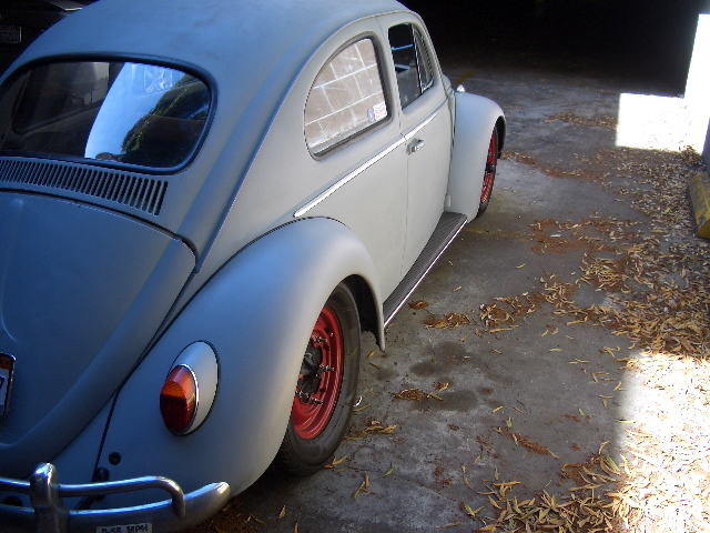

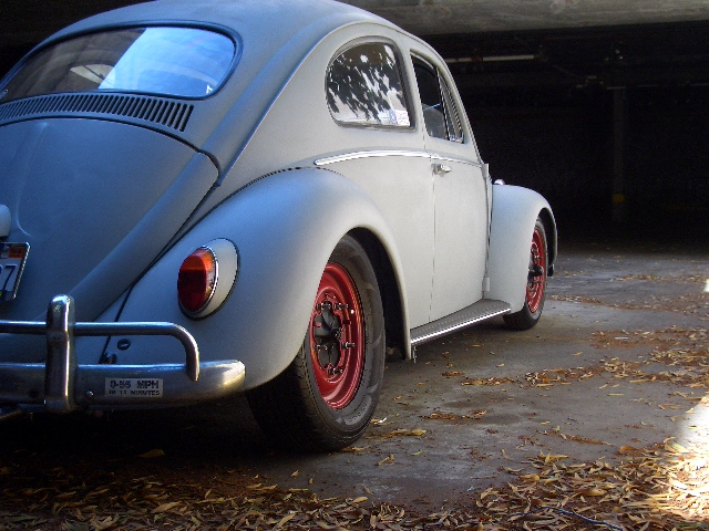

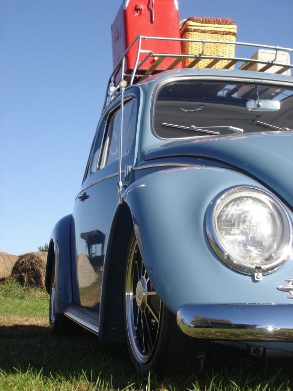

FRONT
Michelin XZX 145/15
Appliance "Pacers", powder-coated, 5.5"
Volksfab 4" narrowed beam with Berg adjusters, NOS needle bearings
CB drop spindles, rebuilt by me w/ NOS king and link kit
Caster shims- 1 set, no flip kit
Old NOS KYB heavy duty "reds"
Stock wide 5 drums brakes
REAR
Falken 205/65/15
Appliance"Pacer", 5" deep-dish.
Short axle 65' transaxle
Lowered using a protractor to set splines exactly where I wanted
NOS torsion bar bushings
Stock Cofap blacks
Stock wide 5 drum brakes
I loved this stance with the Pacers, I might have picked the rear up a hair as the camber was a little too much for my liking.

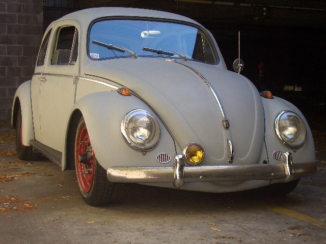

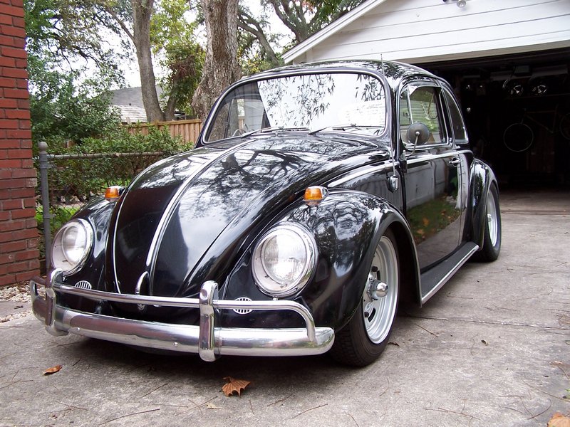

FRONT
Same tire and suspension as above except wheels
Rostyle- "South African Sprintstar", 4.5"
REAR
Same as above except wheel and tire
Sigma? 165/15
If I was to change anything: I will widen the rear Rostyles to 6" so I can run the 205/65/15 out back to fill out that rear fender. I will be chroming the SA Sprints very soon. I'm too apprehensive to try and stuff a 205/65 on that 4.5" wheel. The car rides a little more bouncy than stock as I am almost sitting on the rear snubbers, but this is typical of lowered swing axle cars. Back of the headlight buckets slightly rub when a big bump hits during a sharp turn, I picked up the bottom Berg adjuster one tooth and it doesn't scrub the buckets any more. Having the adjusters set so they fight each other a bit makes a HUGE difference in ride quality. The Volksfab beam is second to none in quality.

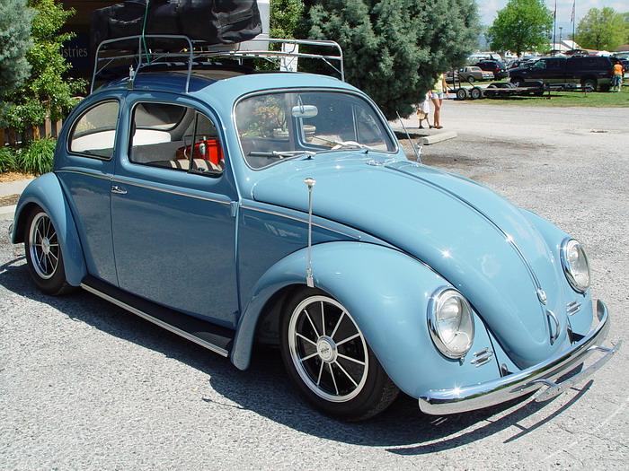

I think this is a awsome thread for those looking for the ride hight they desire... this is my 62'

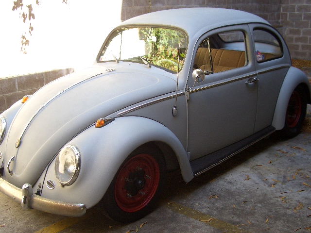

My rear suspension set up consists of...
> Stock Smoothie 15x 4 ' inch rims
> Nankang 215*65*15 tires
> KYB GR2.. Oil base shocks
> Lowered 2 splines in the rear
And my front suspension consists of..
> Stock Smoothie 15 x 4' inch rims
> Nankang 135*15 tires
> Empi lowered shocks
> Stock Beam with welded in adjusters
i plan to go lower.. narrowed beam.. etc..
Jr.LBR
" Traded in my Bible for a little black cat "...

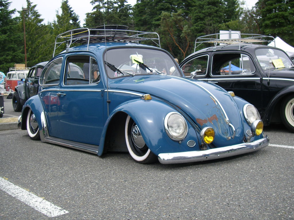

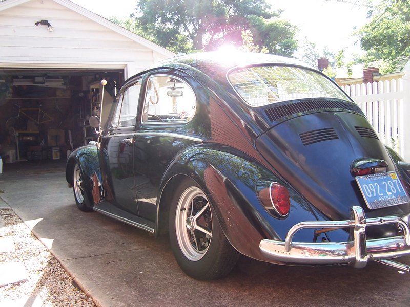

Awesome thread!!! This will help people in a huge way. Even though mine's a fat chick I'll give it a shot. Ok...My turn:

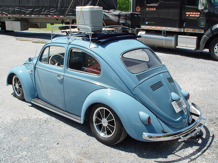

1969 Bug.
Suspension-
Front-
Dropped 2.5" Lowered with a stock width adjustable beam, AC Industries front disc brakes, stock spindles, stock balljoints.
Rear- Dropped 3" Lowered one inner spline in the rear
Wheels- Empi 8 knockoffs 15x5.5" w/ 4" backspacing
Tires-
Front-
195/60/15's (slight rubbing on fender edge, switched to 175/65/15's, slightly narrower, no rubbing)
Rear- 205/60/15's
Over all the car rides very well.
[/GVideo]

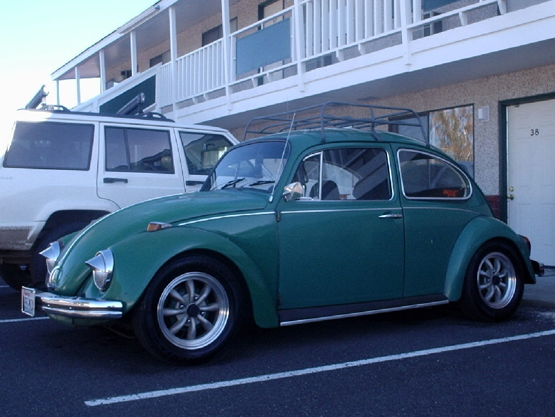

wheels: stock 15x4 smoothies.
tires: front 145/65 continentals, rear 165 nankangs.
front suspension: 5" beam(was a 3" with adjusters i pulled off a vert, cut some more and powdercoated) wide 5 discs with drop spindles and a flip kit. no shocks. empi bushings. 2 sets of caster shims.
rear suspension: notched and extended spring plates(extended this week, still gettin the alignment dialed in) whoever makes those chrome shocks i had lying around. down 2 outers and 1 inner.
front is up 1 or 2 inches now..
i'll get some better pics and update it this weekend....

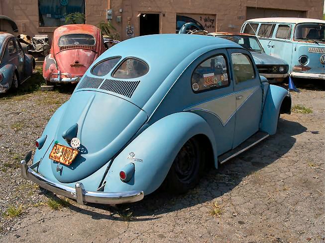

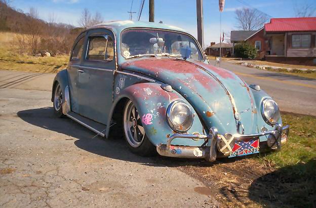

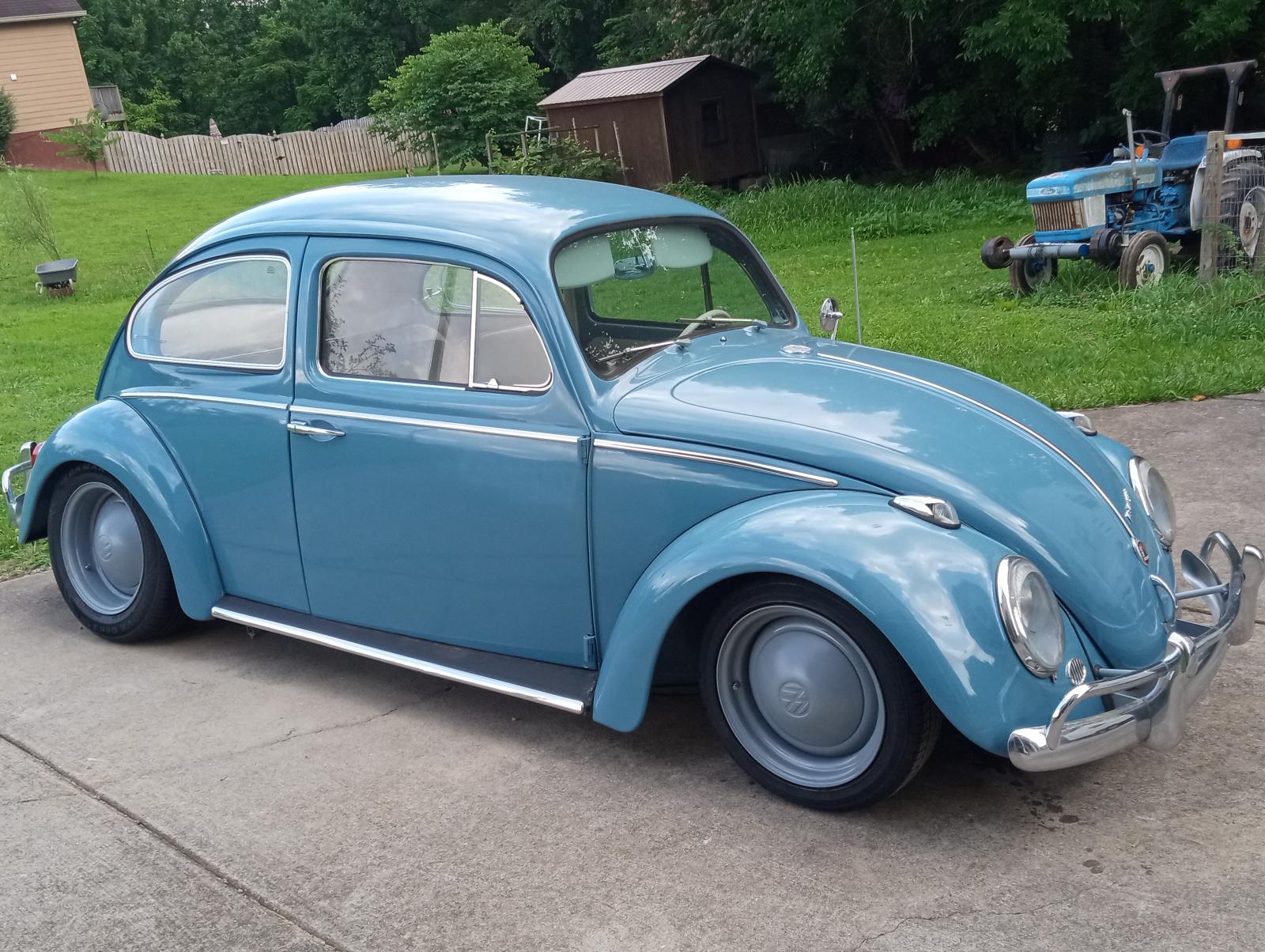

This is my 59 ragtop.
5''beam KCW
adjusters
drop spindles
4.5 BRMs up front \ 135 tires
5.5 BRMs out back \ 165 tires
short axle
drum brakes on all 4
stock shocks in back
NO shocks in front
no rubbage at all. can go lower, got about 3\4'' clearance an full turn range.
about 1 click in the back with the stock torsions , but have bigger torsions so it is clicked lower.

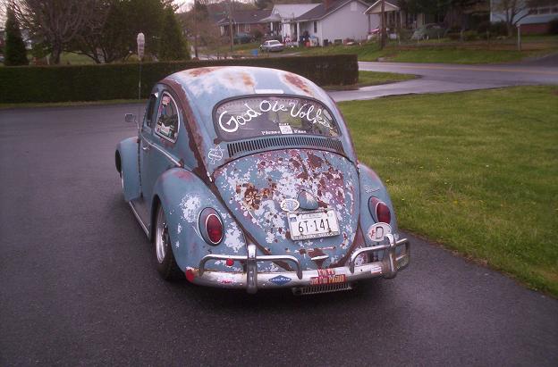

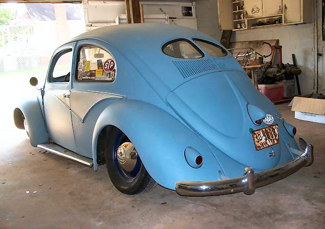

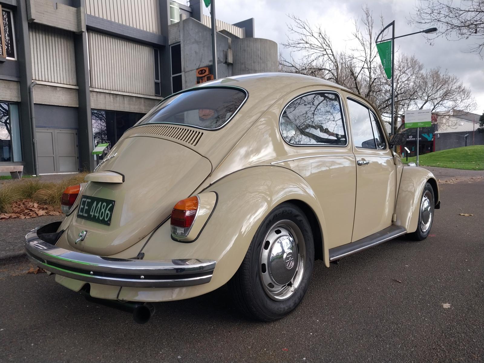

FRONT
7.5 inch narrowed and 1.25 inch sectioned beam
1.25 inch raised panhead
CB drop spindles
flipped tie rods
custom steering to eliminate the short drivers side tie rod
tubbed front wheel wells
1.25 inch sectioned headlight buckets
modified blinker housings
2.5 inch raised gas tank
self fabbed air ride
stock 4.5 smoothies with 145/65/15 tires with portawalls
REAR
two inch transaxle/engine lift
notched and 1.25 inch extended spring plates
short axles
stock 4.5 smoothies with 185/60/15 tires with portawalls
drive your split.

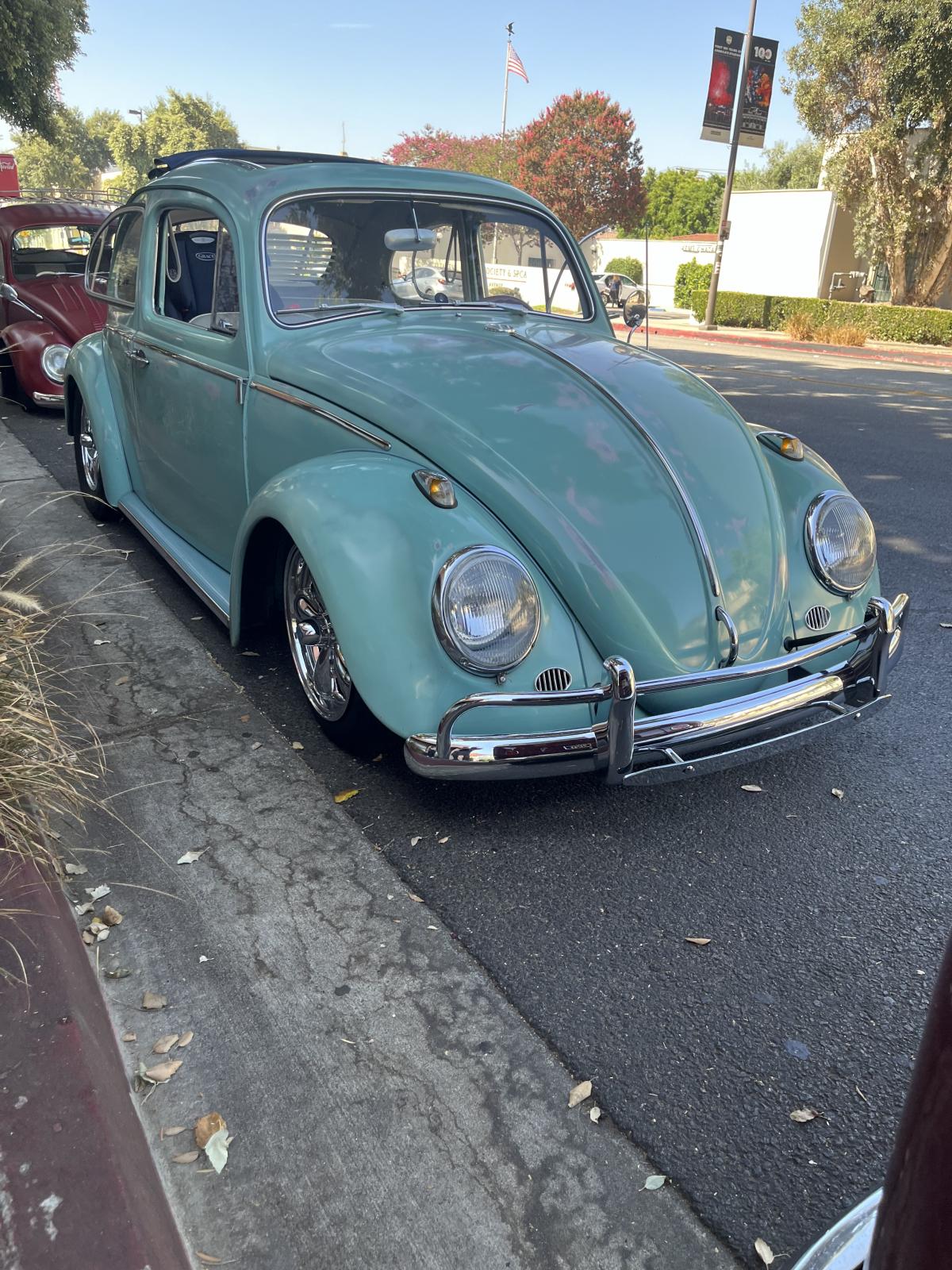

'67 Bug:
Front:
2" narrowed beam with adjusters
CB 2.5" drop spindles
CB Perf. Wide 5 discs
145's
5.5" 5 spokes
Rear:
Early Axles
4+, 4- on the splines
195/65r15's
5.5" 5 spokes
'67 Sunroof
Eric
78x94 with IDA's....oober fun
Horsepower is an addiction........Addictions cost
lots of money!
Hose & Fittings

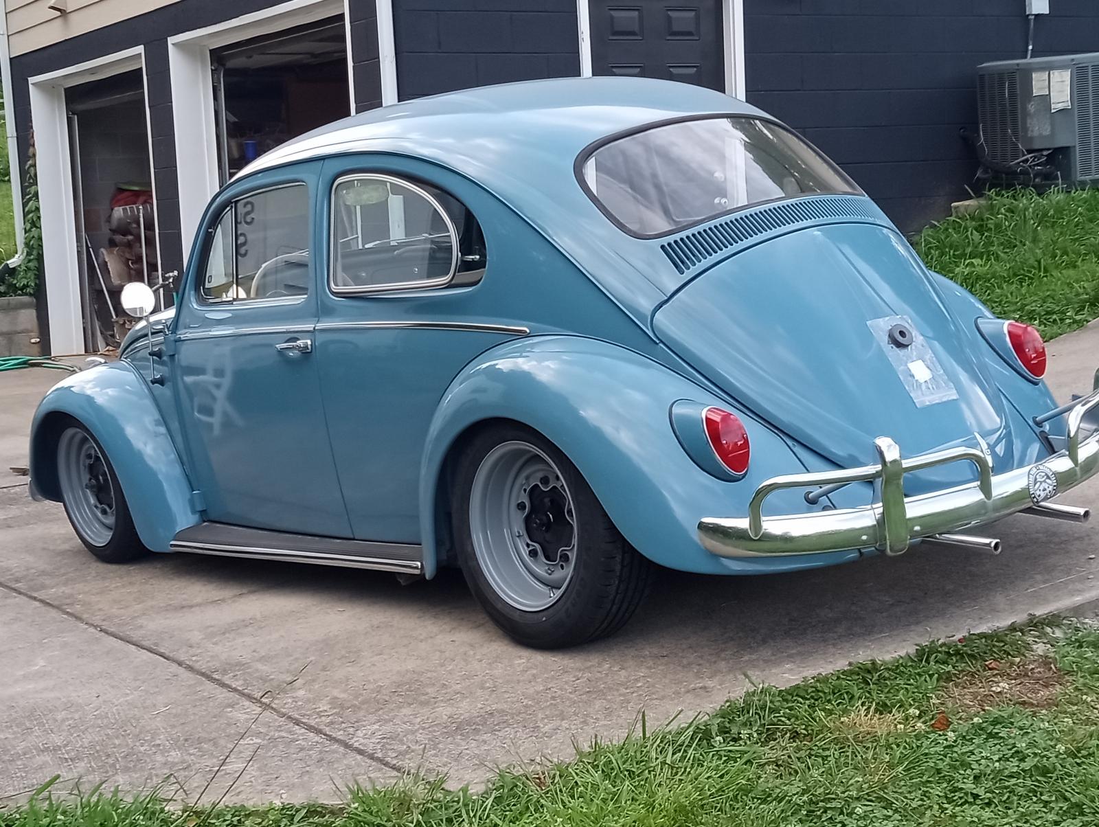

Here is my chit!
52 Split bug
Front -
7" narrowed adjustable beam, home built
NO SHOCKS, No drop spindles
125 tires on stock vw smoothies
Stock 62 drum brakes
Rear -
Adjusted two outer splines down
Stock shocks
195/60 tires on smoothies in these pics, but I usually run 165
Stock 63 drum brakes
62 Beetle
Front -
4" narrowed adjustable beam, home built
NO shocks
CB drop spindles
135's on fake 5.5 fuchs
Stock drum brakes
Rear -
Two outer splines
stock shocks
165's on fake 5.5 fuchs
Stock drum brakes
• Metal Fab & Quality Suspensions, Type I-II-III. Since 2004 •

FRONT
6inch narrowed beam with no shocks
gene berg avis adjusters
cb drop spindles
4.5 randars with 165 45 15s
stock drums
REAR
3 clicks
notched spring plates
5 inch randars with 165s
stock drums
