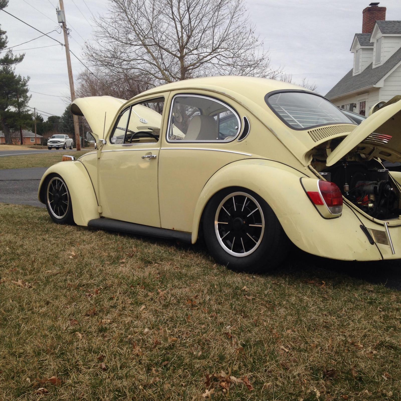

PostPosted: Fri May 14, 2021 11:46 am    Post subject: Re: Pictures of tire, wheel, and suspension thread for FAQ's Reply with quote
lowN2slo wrote:
Front
CB Drop spindles
4 Inch narrowed beam
15 inch Empi 5.5 wide
155's
Rear
Drop plates
185's
I like this look! What drop plates did you use?

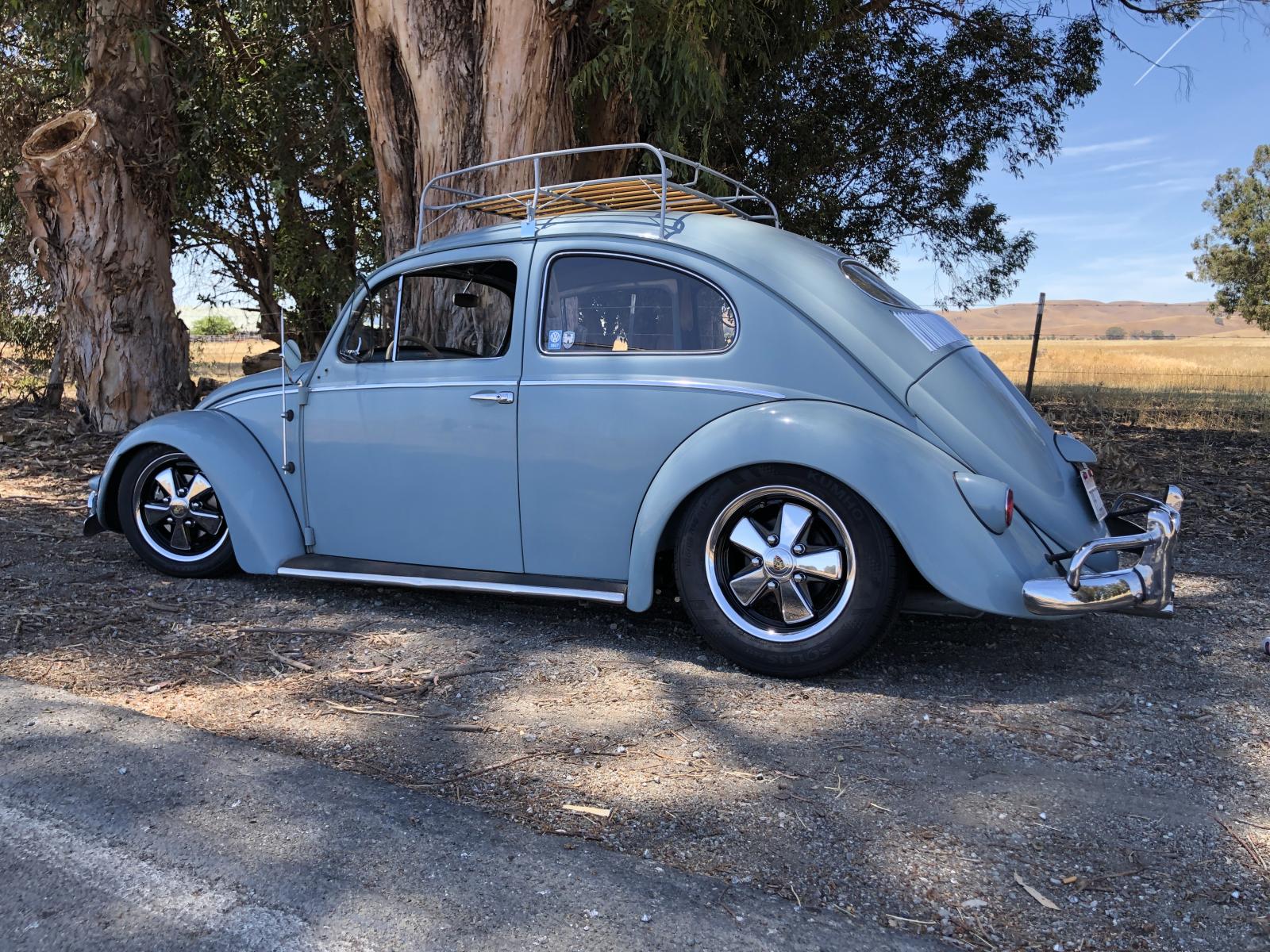

Finally finished lowering my 57'
-Front
4" narrowed adjustable beam form Aircooled Vintage works, no shocks
Disk brakes
4.5" replica Fuchs
155/60
Castor shims
-Rear
2" adjustable lowered spring plates from Air Cooled Vintage Works
6" replica Fuchs
195/65
Long axles, I plan to put disks on the rear to lose the adapters and bring the rear in 1" on each side. If the tranny ever needs to come out id like to swap in short axles

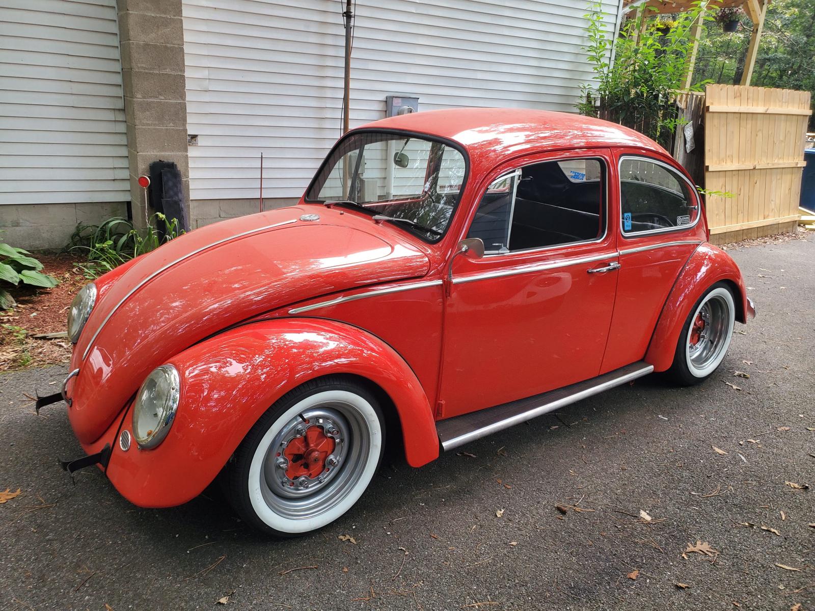

PostPosted: Fri Jun 18, 2021 2:46 pm    Post subject: Re: Pictures of tire, wheel, and suspension thread for FAQ's Reply with quote

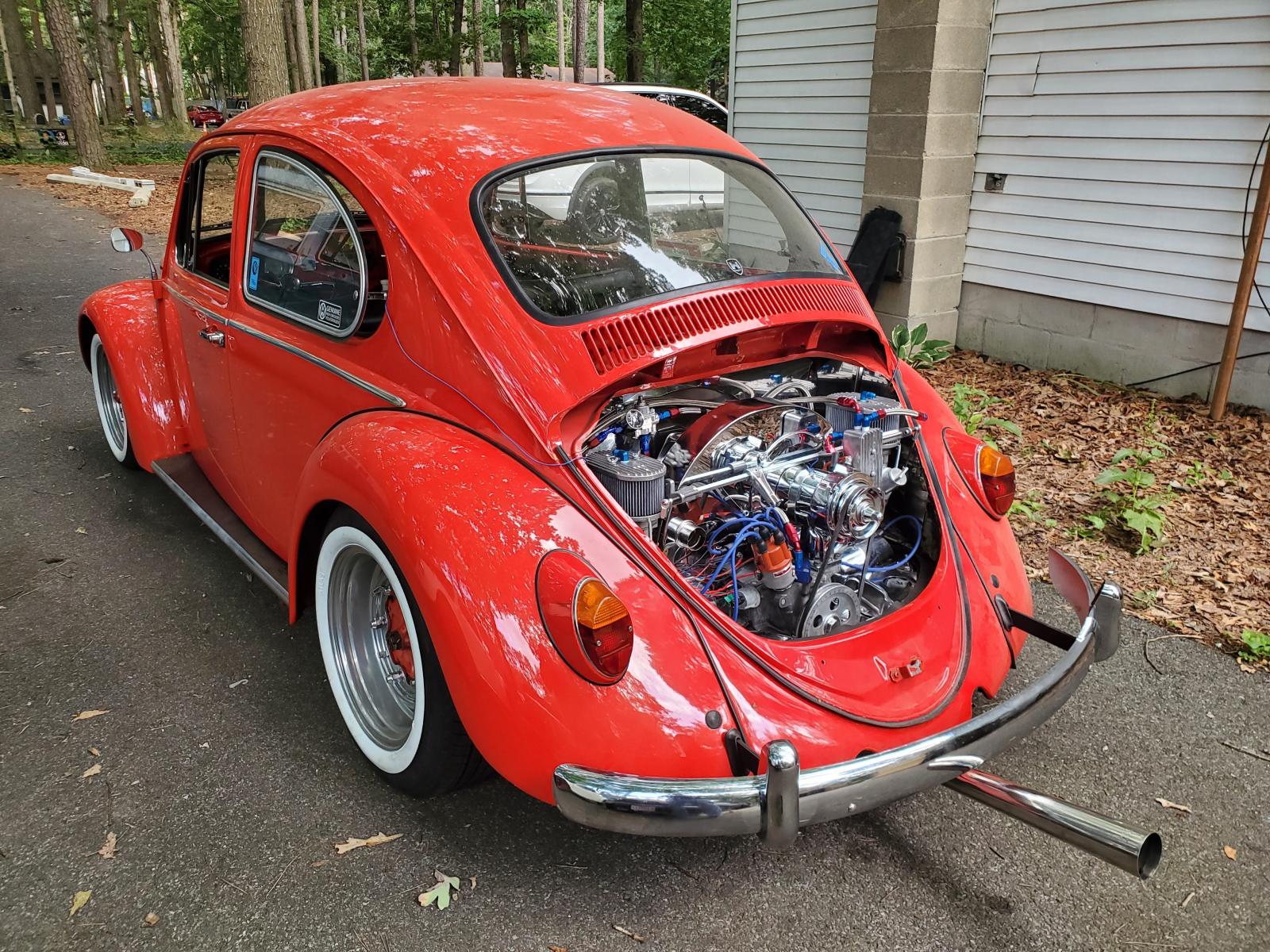

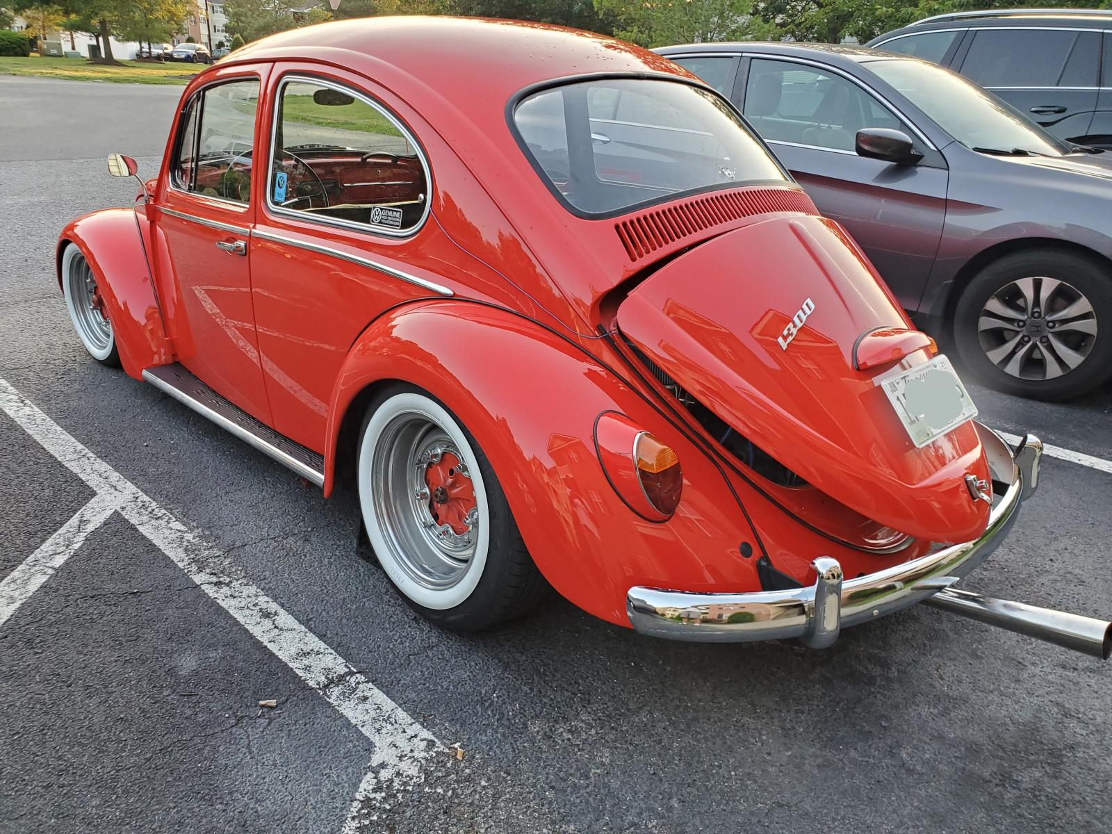

Just finished up my bug. 62 Beetle.
Front: 4” narrowed beam/2.5” drop spindles by slowlowvw out of Virginia. Conti 145s on stock smoothies w/ a skid plate. (No Headlight Bucket cutting needed with these tires)
Rear: extended/notched spring plates also by slowlowvw. With conti 185s on stock smoothies.

CAREFUL. I put short axles on my 67. I'm running the same wheel and tire combo on the back and I was given some adjustable spring plates. There is NO WAY I have room for them. The adjuster would hit my tire. I'm going to have to put 3/4" spacers on the back to clear. I'm HOPING your disc brakes will push out that far, providing the space needed...but I'm unfamiliar with added offset due to discs.

10-4, thanks. Axle swap is a ways out anyway, just going to start with the disk brake conversion to lose the adapters, I haven't been able to determine if the disk brakes add any width

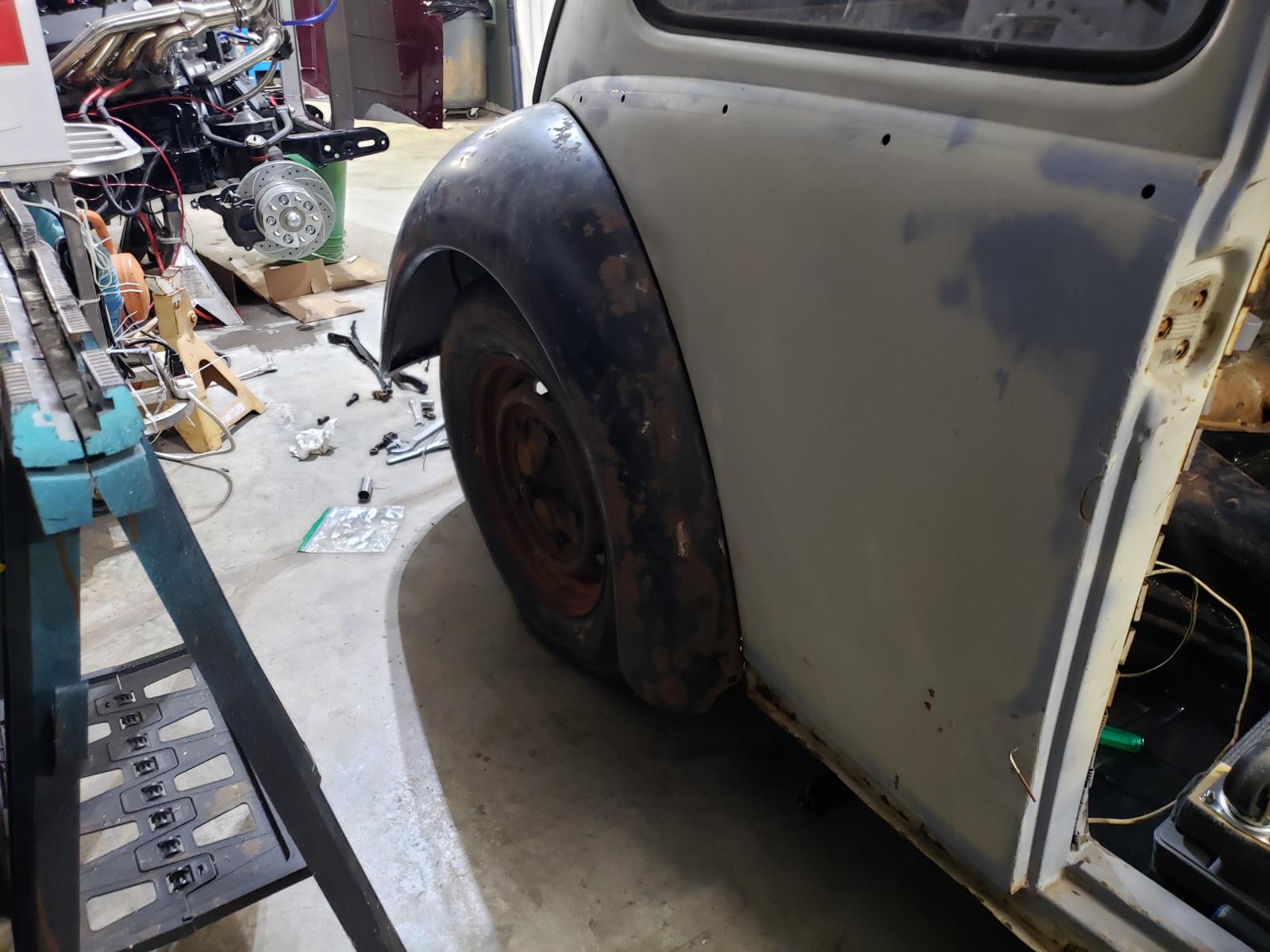

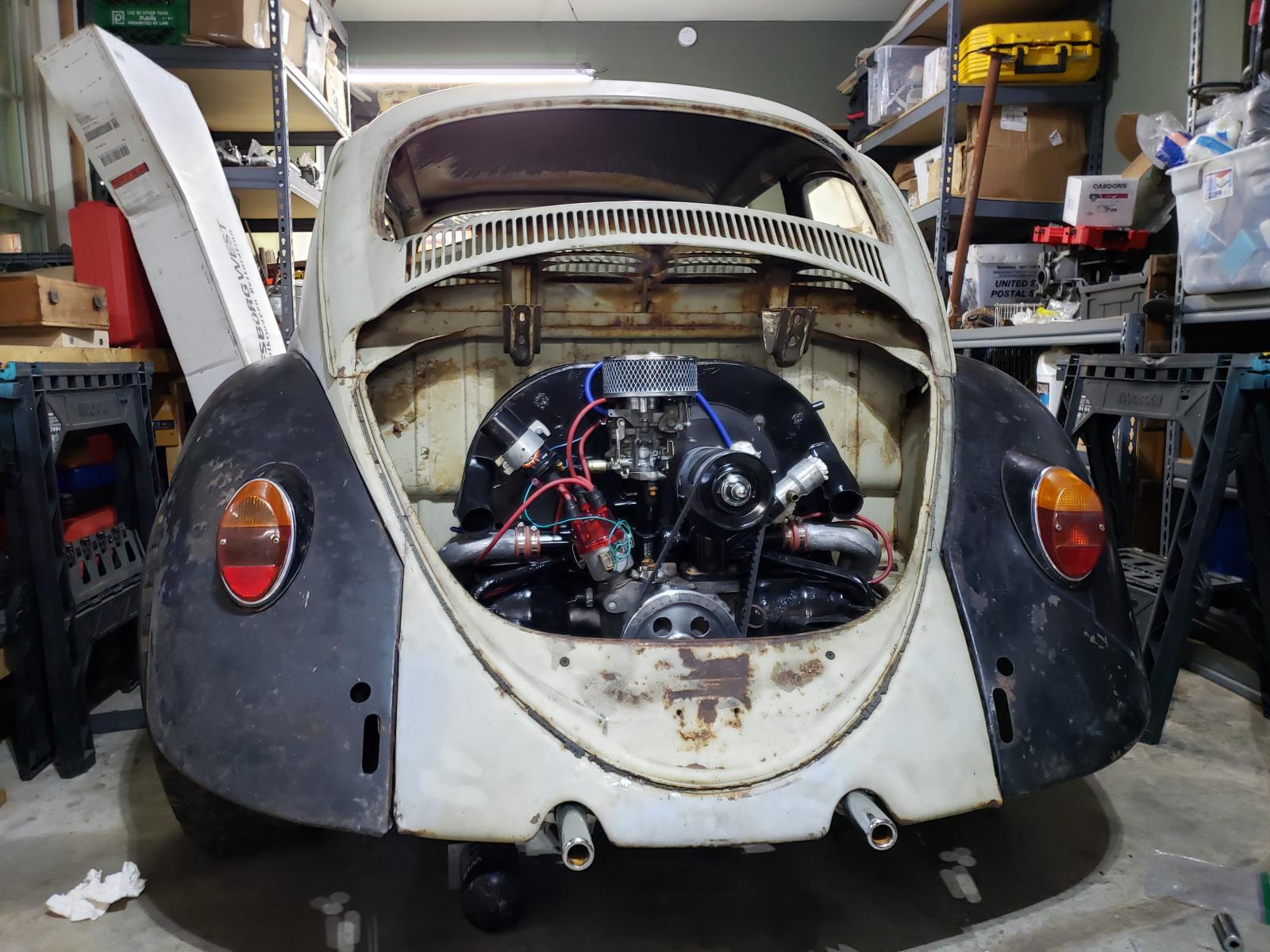

if i could get some measurements like the picture shown that would be awesome. heres my car with one outer notch dropped and stock tire size. but it hasent settled yet.

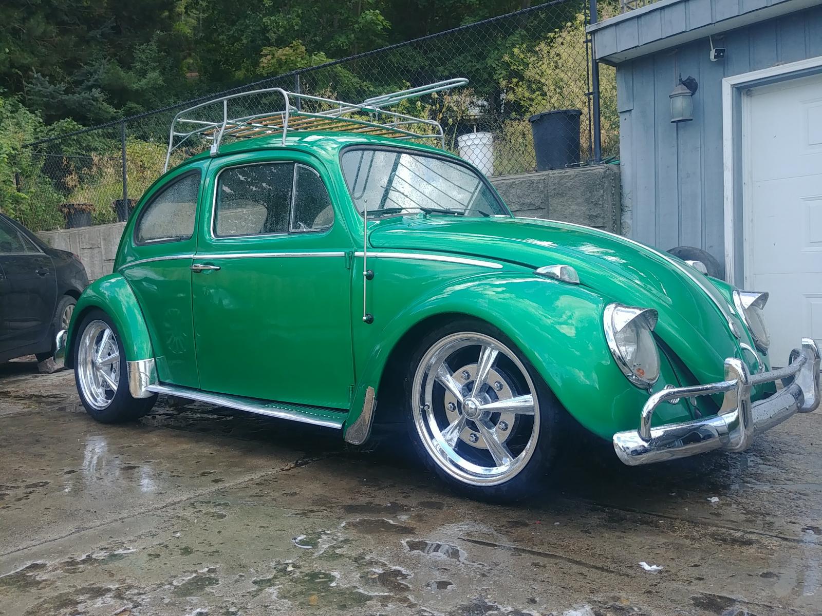

PostPosted: Fri Aug 20, 2021 9:41 am    Post subject: Re: Pictures of tire, wheel, and suspension thread for FAQ's Reply with quote
Fantastic thread, helped a lot. Here's mine i just took off the stands.
Front:
No shocks
2.5" drop spindles
Roughly 4.25"s drop.
205-40-17s on 17-7 rader
Rear:
1 inner spline
Stock shocks
1" spacers
215-45-17s on 17-7 rader
4" drop.
Bare in mind this is just off the jack stands and me push/pulling on the bumper a bit. May lay out some more after a spin

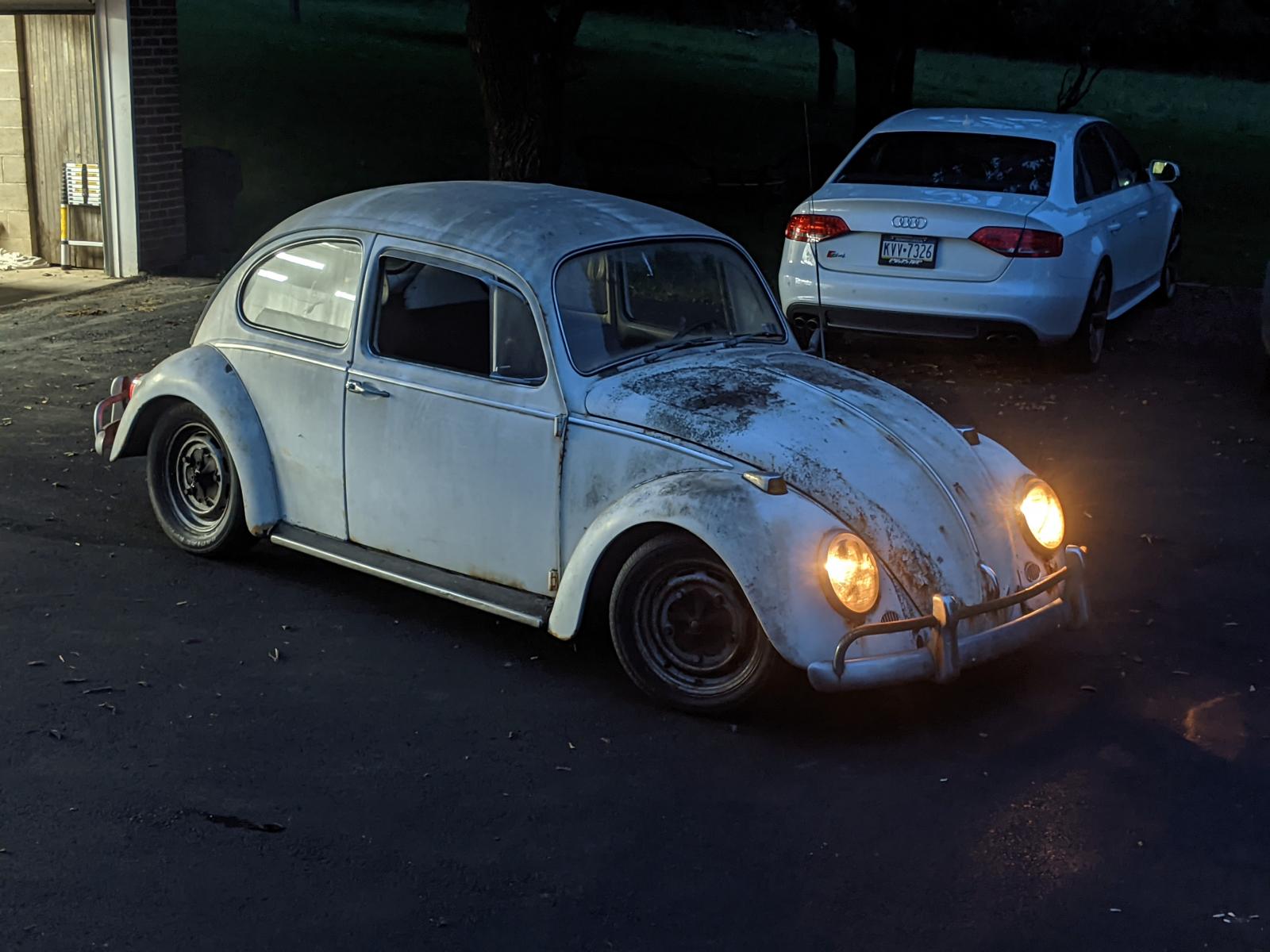

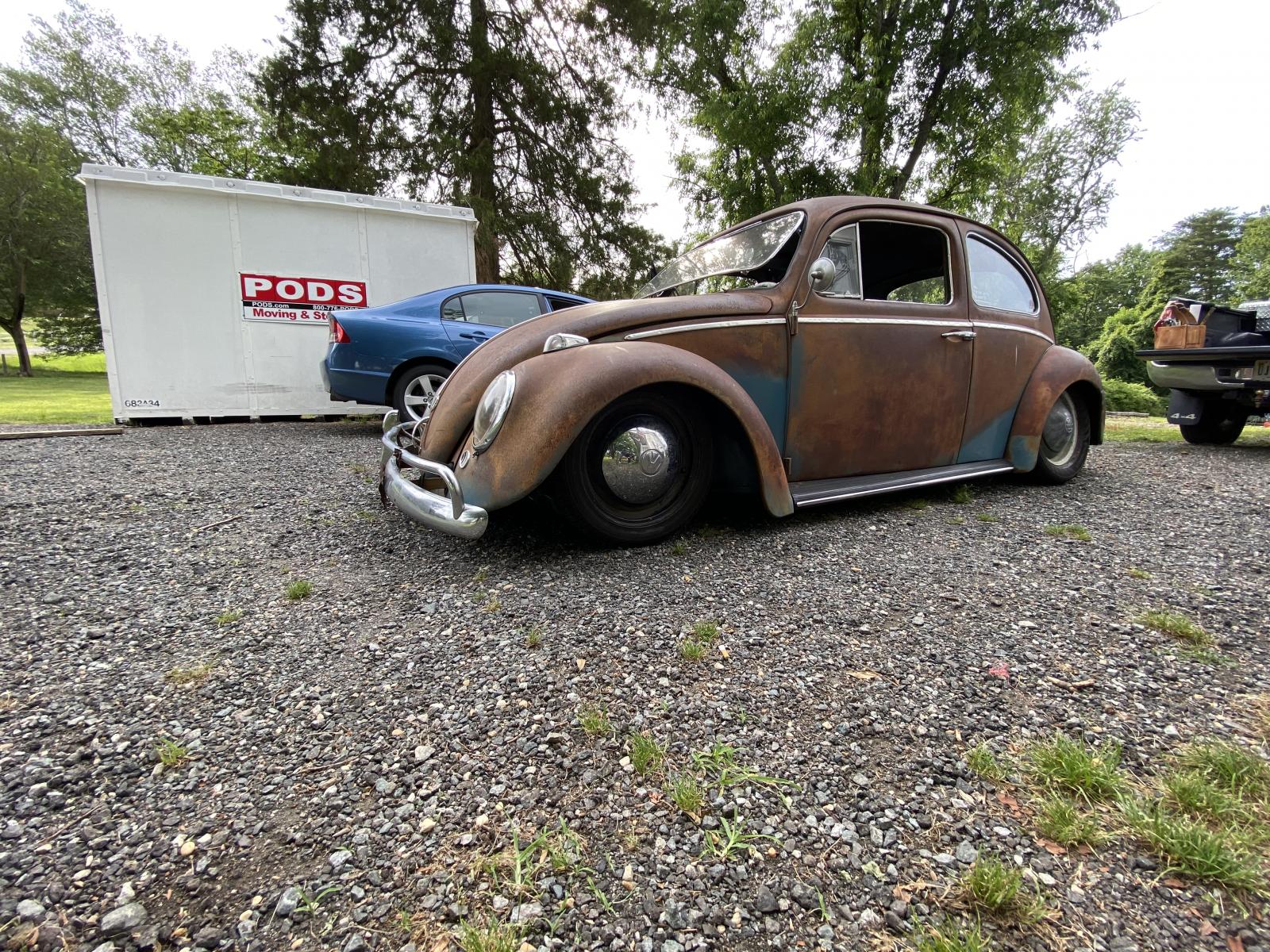

1966 "Pigalle Special" I just rescued.
Stock wheels
Front:
EMPI 2" Narrow front beam
Drop spindles. I kept the drums.
Tires- 155/60
Rear:
One click outer spline
Tires- 185/65

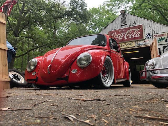

casper67beetle wrote:
FRONT SUSPENSION: DubAir Suspension / ViAir Compression / 2gal Tank
McPherson Air Shocks
3” Narrowed Beam
Nankang AS-1 / 175 55
Smoothies 15x5
REAR SUSPENSION: AtomWerk Adjustable Spring Plate
Doetsch Tech Progressive Gas Shocks
Nankang SP-9 / 195 65
DeepVeez Widen Smoothies 15x7
NICE! that thing is Bad Ass. Enough about the suspension. Tell us about your engine build. Lookin beautiful in there.

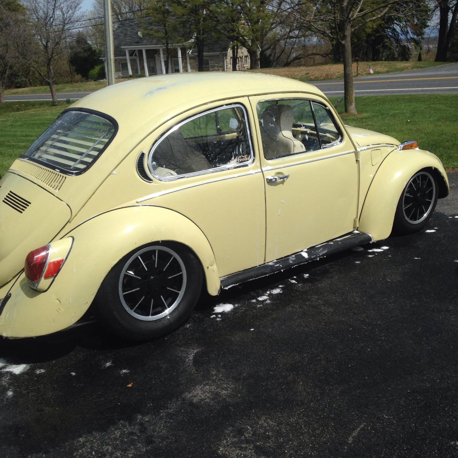

ericgordVa wrote:
71 standard
repop gasburners/black Porsche logos
front- 145R15 firestone tires
3.5in stock narrowed beam
drop spindles
5/8 throughrods
monroe 756 shocks with 3/8 hydraulic line
HD swaybar
CB disc brakes
rear- 205/70/15 cooper tires "do not rub"
no torsions
no bumpstops
jaison710 bag bracket kit
2500 bags with 3/8 hydraulic line
480c comp with 4 gallon compressor

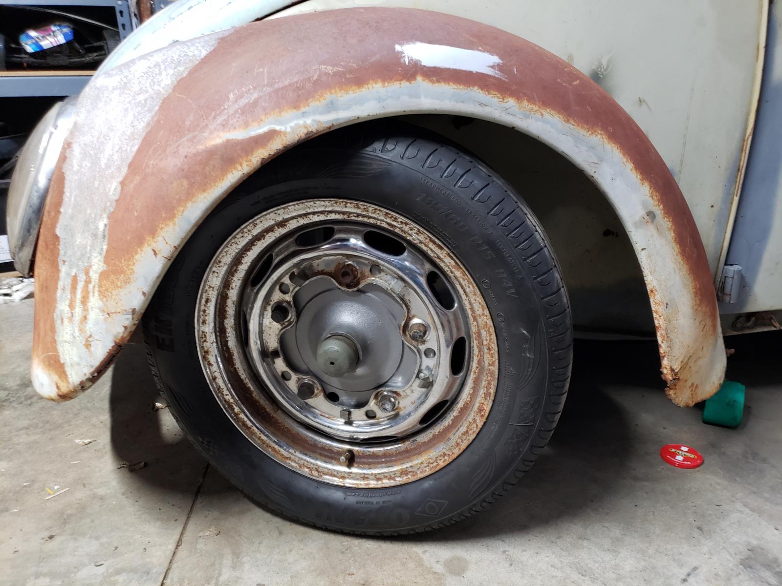

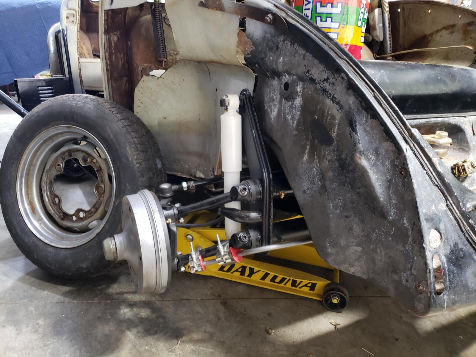

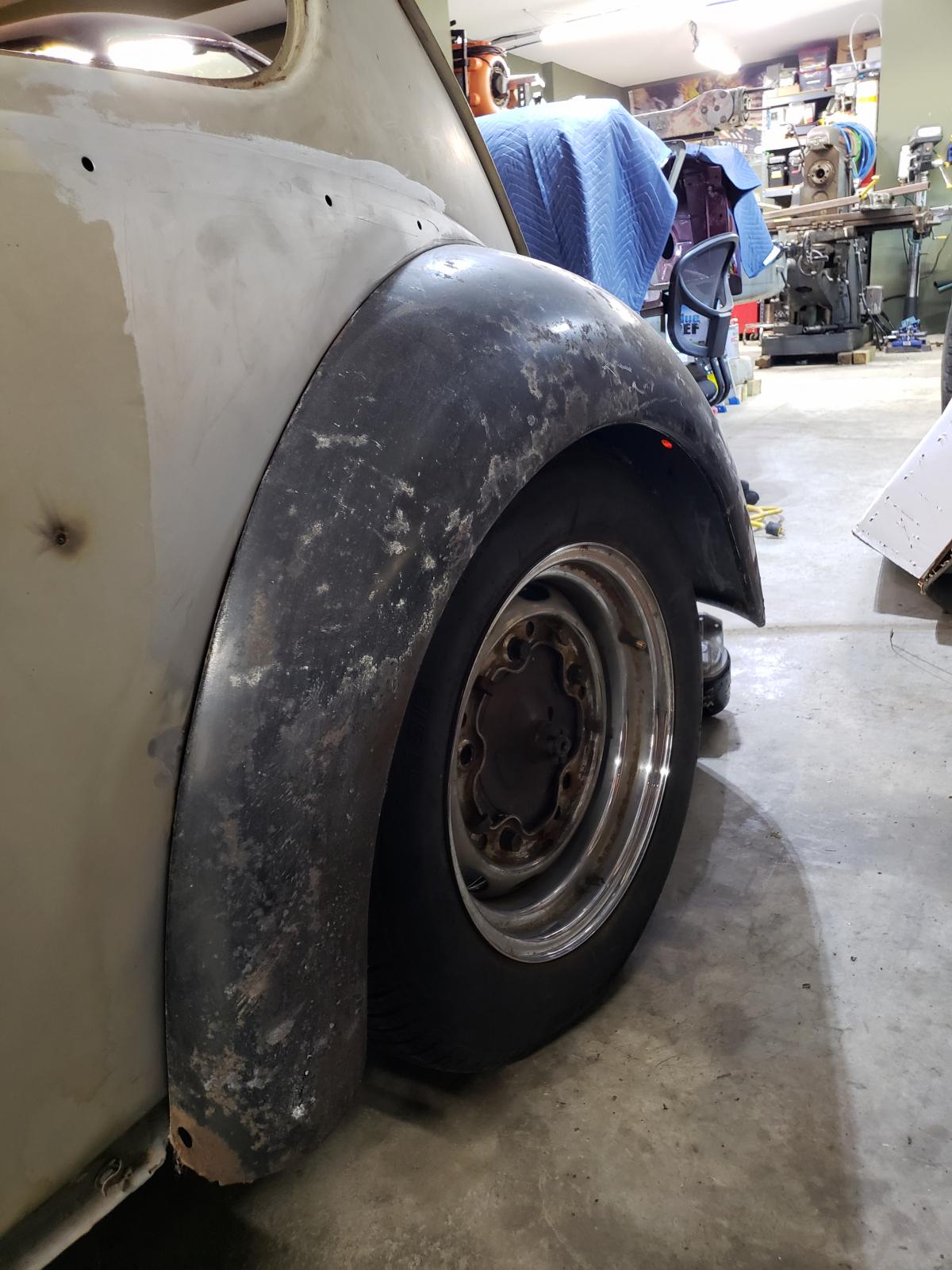

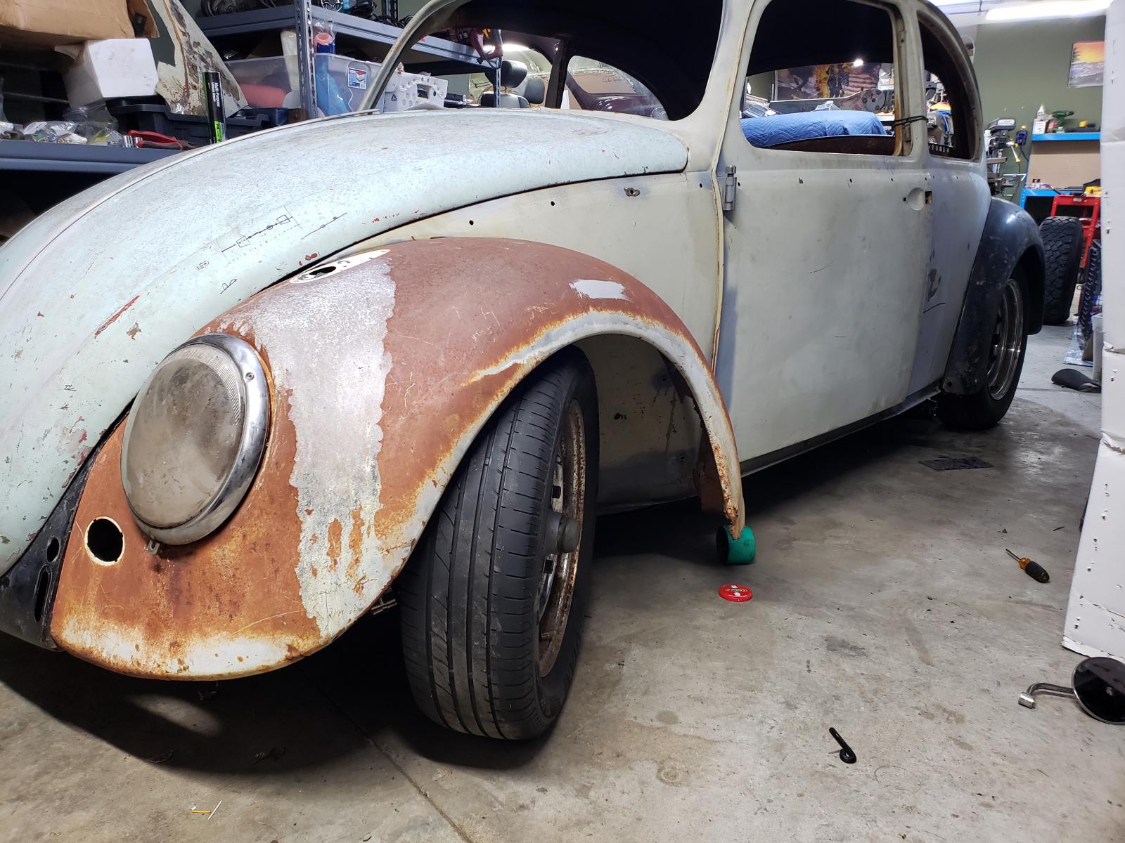

Rockin a stock width beam. specs as follows.
FRONT;
-stock width beam
-welded in sway away adjusters
-stock drums
-4.5in 356 replica rims(well, the one under the fender is)
-185/60 r15
REAR;
-lowered one outer notch
-stock drums
-4.5in replica 356 rims
-165/80 r15(need to be taller and wider IMO)
I dont get why so many people automatically jump to the whole "gotta have a narrowed beam" thing. unless your running wide or large offset rims i dont see the point unless your slamming the crap out of the car.

Kinda hard how to tell how low it is without a side shot from a distance.

maybe 3 inches from stock? ill take measurements later.

That’s pretty low. How bad is the rear camber?

Only 2.2 degrees negative camber
