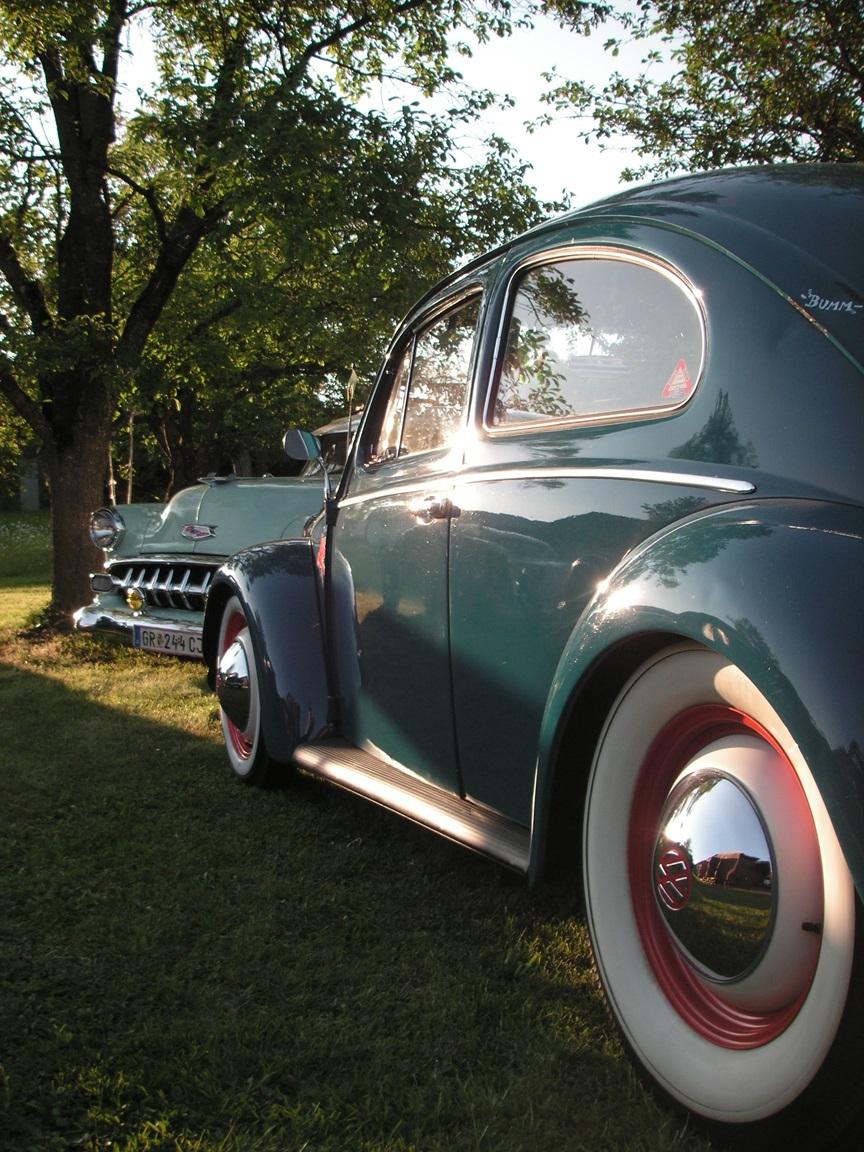

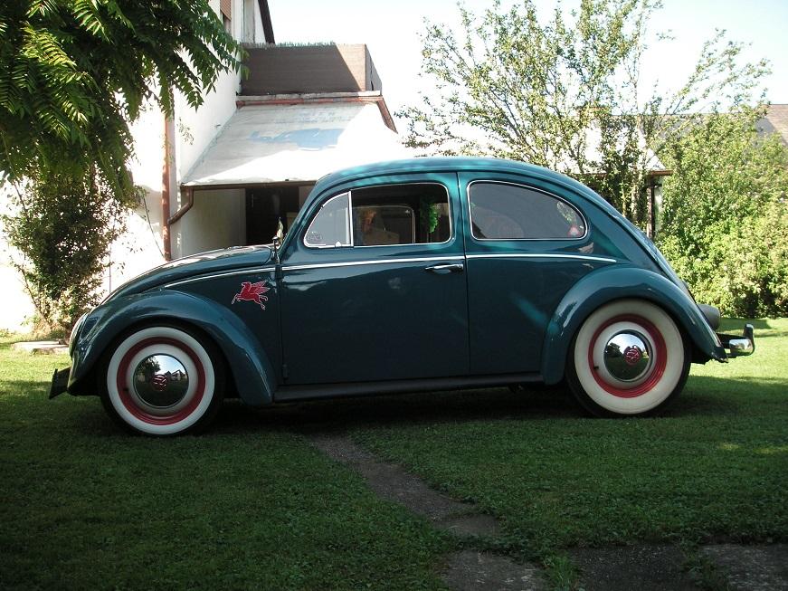

To each their own, I guess. Many different routes to take.
Personally I totally dislike narrowed beams, small radial tires, widened deep dish rear wheels and slammed stance. Most all look broken to me and compromised in ride quality. Not hating on all of those you guys, just saying. I am on the other side.
4.50 Firestone and 6.50 Goodrich on 3.50-16 Barndoor bus wheels. dropped spindles. about 3/4 click in the rear. Rides perfectly smooth with added tall highway gearing with factory 4.375 and 1200.

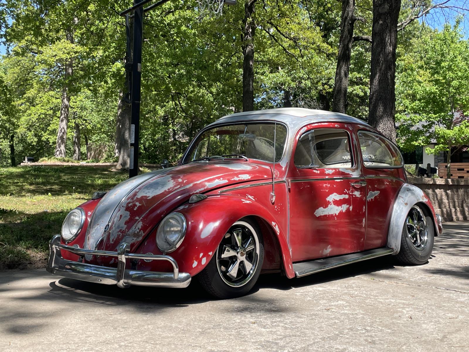

1963 Beetle
3.5" beam and drop spindles
4" rear drop plates, limebug shocks
4.5 fuchs with 125s
6 fuchs with 215/70s (likely to go to a smaller tire as they do rub on big dips)
TastyGarage
That is a good looking Lowered VW.

Mike Fisher wrote:
You ran the Mobil Economy Run! Wink
I wish I had ! Very Happy
Tomorrow going on a 600 mile round trip to Southern Germany, let's see about the economy side of tall rear tires.... I will report back on mpg Wink

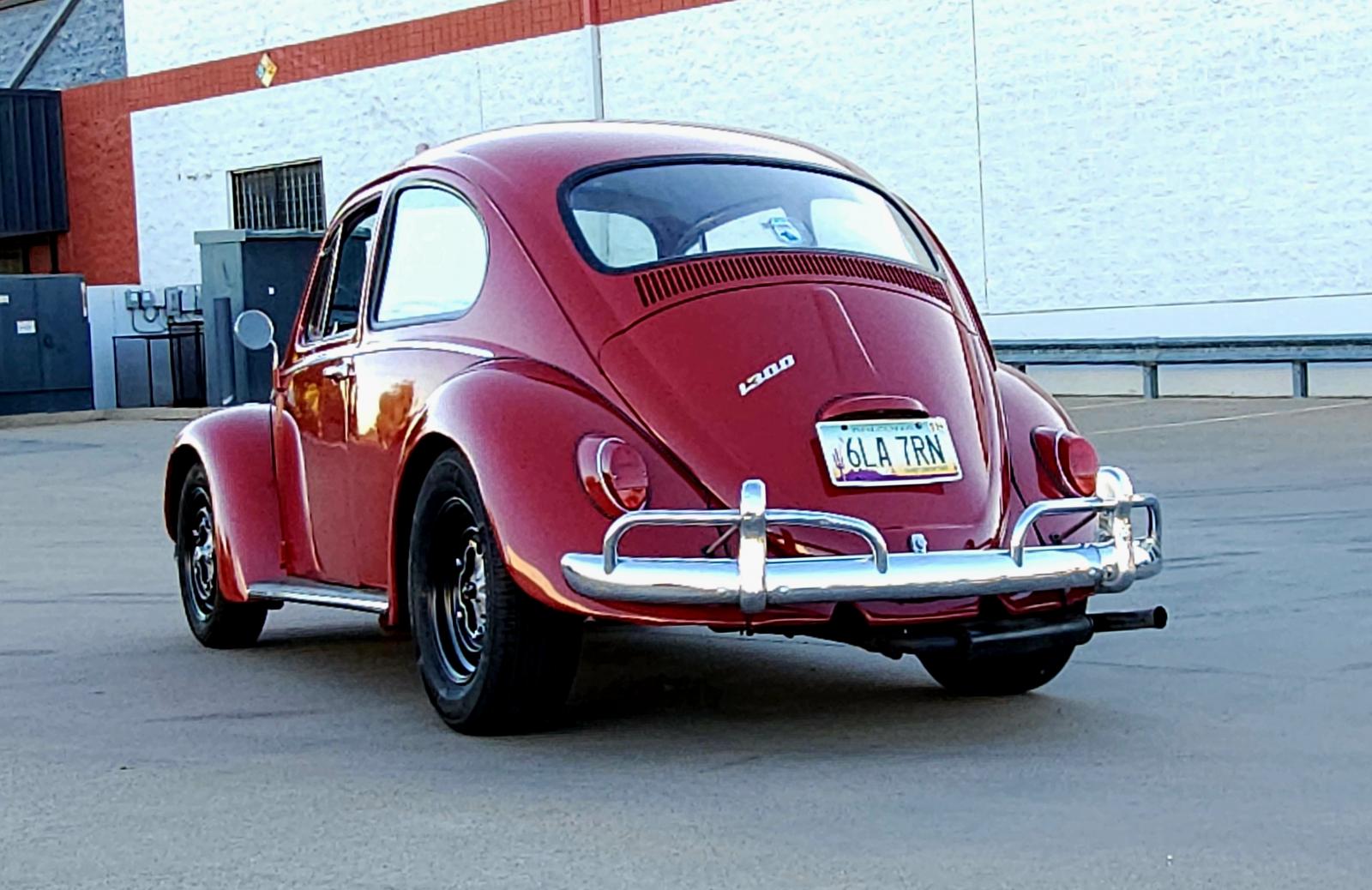

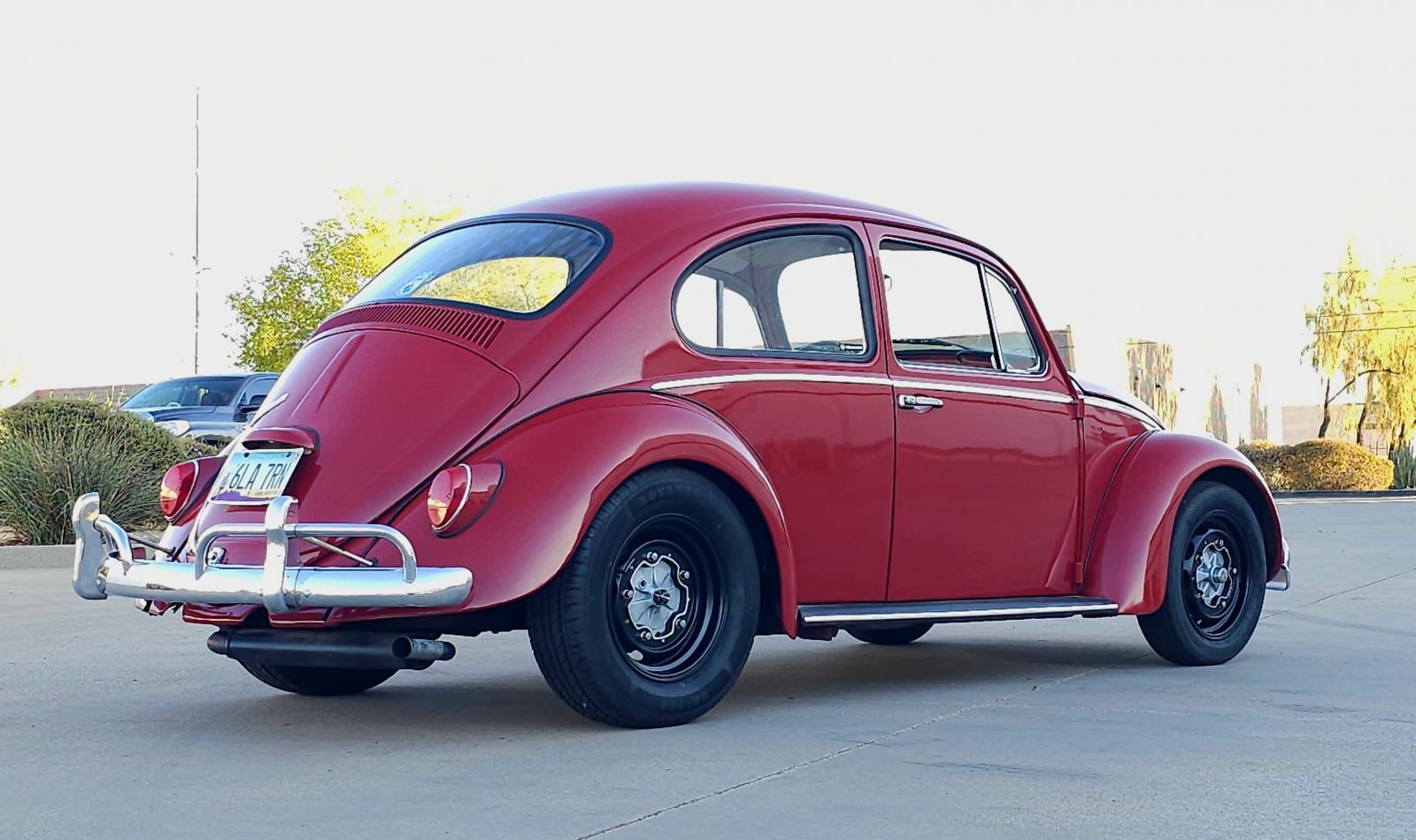

Haven't posted in 10 years kinda fell out of the VW scene. My 64 has been in storage for the last 10yrs, but picked up this 66
Just did
MOBELWAGEN Wheels
4.5 with 165 65 15
5.5 with 215 65 15
Drop spindles
1 outer click on rear

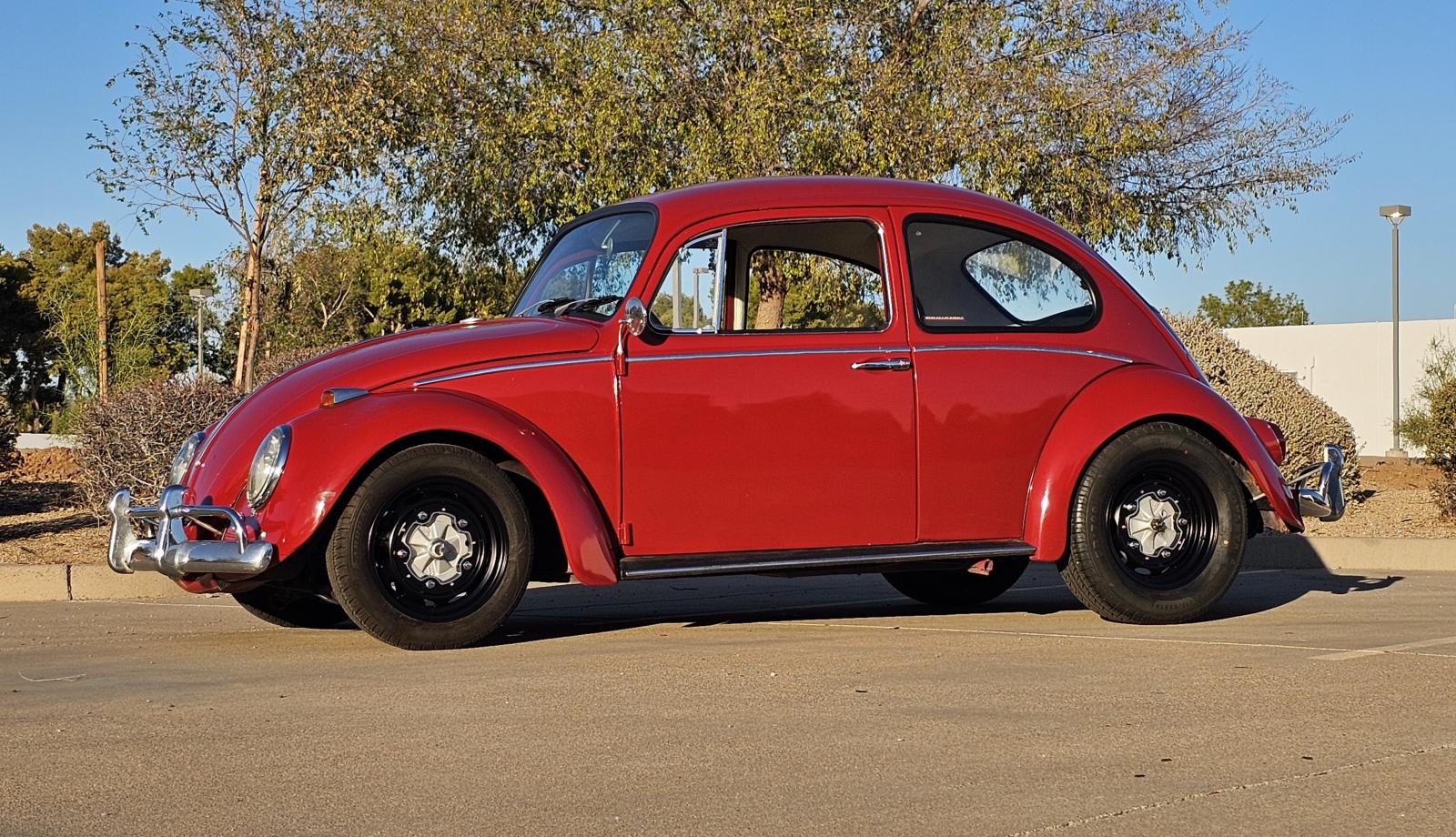

PostPosted: Thu Nov 14, 2024 9:12 am    Post subject: Re: Pictures of tire, wheel, and suspension thread for FAQ's Reply with quote

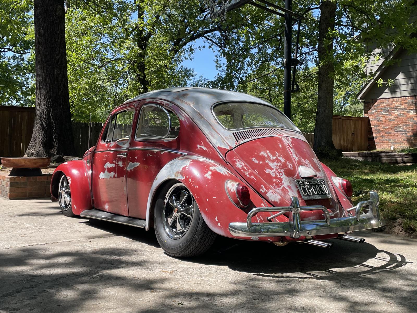

Droppy spindles, one spline in back., sway bar, gas shocks valved for th 700 lb curb weight175/60 and 205/70. Handled good before the wreck. Crying or Very sad
