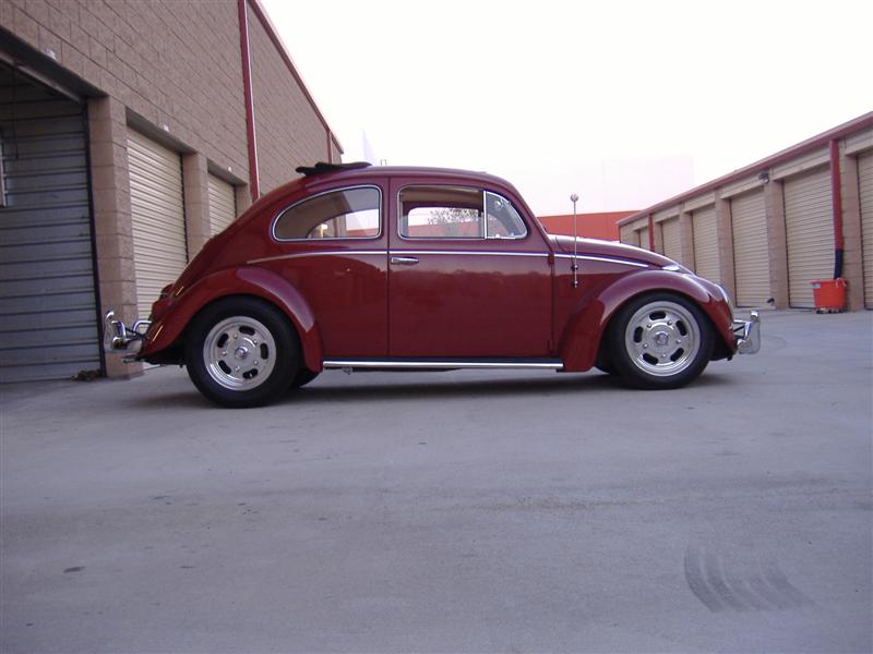

PostPosted: Thu Oct 04, 2007 12:40 am    Post subject: Reply with quote
-'61 Sunroof
-Front:
-5" KCW Beam
-2 1/2" CB Drop Spindles
-No shocks
-5.5" Fakie 5 spokes
-135's
-Rubs on headlight bucket, top of fender, and inner fenderwell.
-Rear:
-Dropped 2 inner notches
-KYB Gas-A-Just shocks
-Everything else stock
-185/65R15's

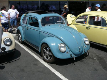

PostPosted: Thu Oct 04, 2007 12:45 am    Post subject: Reply with quote
'59 Sunroof
-Front:
-2" CB beam adjusted almost all the way down.
-Original Ansen Sprints 15x5.5
-145's
-Rear:
-All stock
-205/70R15's

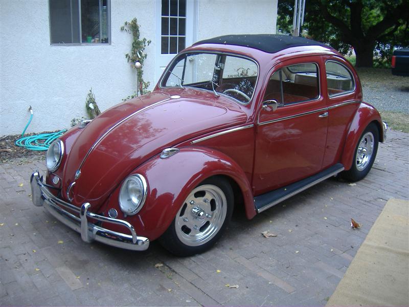

PostPosted: Thu Oct 04, 2007 3:16 pm    Post subject: Ok, here it goes Reply with quote

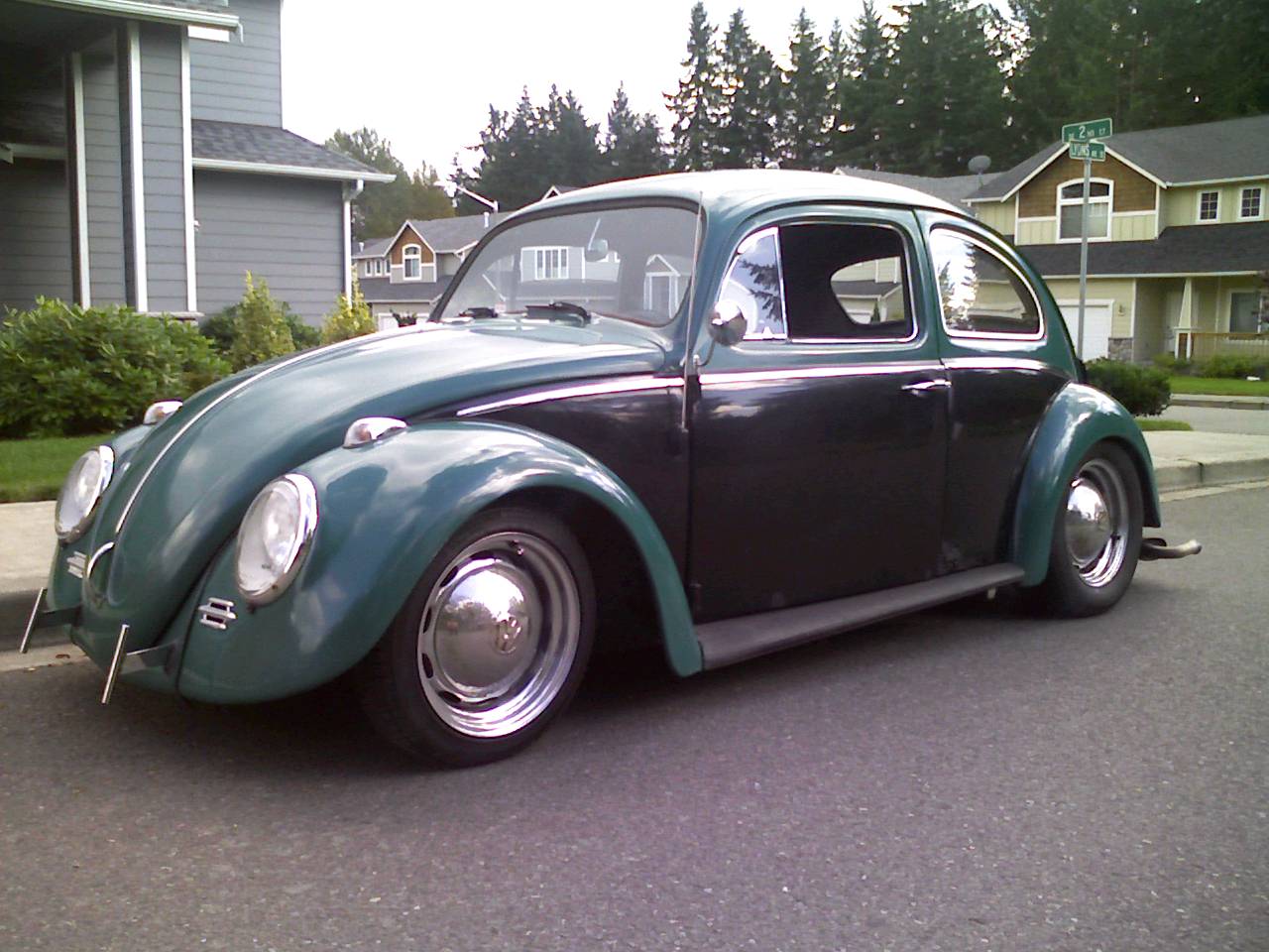

Front
-145/65/15's (tirerack ecocontrol continental)
-keoki 4" narrowed beam
-Stock spindles
-empi lowered oil shocks
Rear
-205/65/15's (toyo's)
-Just finished 1 outer spline drop
-Gas charged stock shocks
-bump stops pulled

me likes the way your car sits, i live in seattle. nice stance!!

why did you pull bump stops?? thinking of getting better shocks, kinda bouncy,, running kyb's now.

I thought I remember reading somewhere to yank them off when you dropped the rear, I did so and haven't had a problem. This is my daily driver and i drive it pretty hard.
How low is your car? kyb's are good shock, but chances are they are gas shocks that you have. I just replaced my fronts with empi oil shocks and they made it a bit less bouncy.

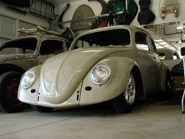

PostPosted: Mon Oct 22, 2007 10:56 am    Post subject: Reply with quote
this is my new car...(formerly cage66's)
it has a 6.5" beam drop spindles
down roughly 2.5 notches. Will have extended springplates soon.
165 in the back 165/45 front
the pics are without an engine

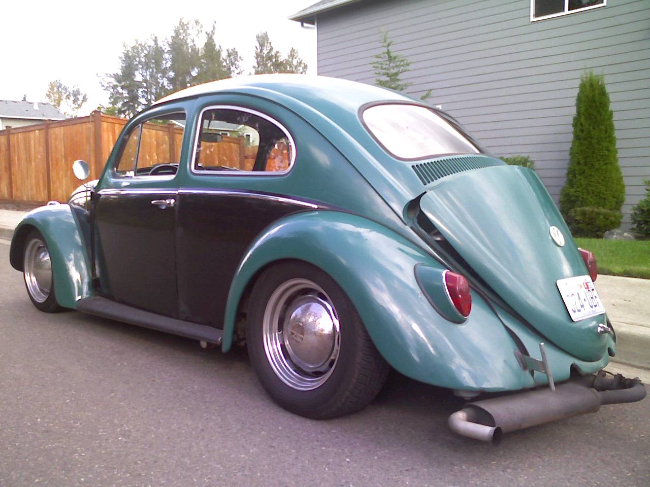

PostPosted: Tue Oct 23, 2007 2:24 pm    Post subject: Reply with quote
This is Matilda. Specs are:
FRONT
Nankang 135R15
painted stock steelies (4 inch)
TNT Auto Service 5" narrowed beam with SAW adjusters, stock needle bearings, no shocks
CB drop spindles
no caster shims yet (need longer bolts)
stock drum brakes
REAR
some old 165R/15
stock IRS dropped I THINK 2 outer splines
urethane spring plate bushings (sanded to fit)
notched spring plates (need to be deeper)
stock length oil shocks (something cheap from AutoZone)
stock drum brakes

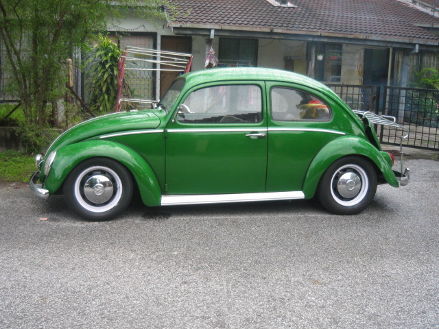

PostPosted: Tue Nov 20, 2007 10:22 pm    Post subject: Reply with quote
my 62
converting to ball joint axle
front Very Happy toyo tires 185 60 15
shock : 79 datsun ( rear )
rear Very Happy toyo tires 195 65 15
shock : kayaba gas a just
https://www.thesamba.com/vw/gallery/pix/396800.jpg
https://www.thesamba.com/vw/gallery/pix/396801.jpg
next project narrowed 2 inch beam

It looks like an MnM on wheels..........but like it! Wink
