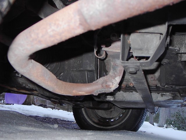

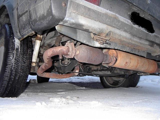

you can stop the exhaust cracking by using the old clamp style flange. Gives a good seal and helps to eliminate vibration.That one is 9 years old.

Not sure exactly what you are pointing out in the photos. Is that a Tiico header pipe? If not, where did it come from. The two version that I have had from Tiico both had a mesh flex at the 90 degree elbow turn to the cat. The first one (which was on the van when I bought it) cracked at the plate that bolts up to the manifold.
Josh
