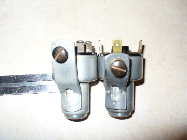

BFY does not sell an oval ignition switch.
Here's the difference between an oval switch (left) and a later one. The oval requires a longer mounting tab.
So cut and weld if you have too!(the bracket i mean).

GDOG57 wrote:
...So cut and weld if you have too!(the bracket i mean).
Not so simple. The oval's switch's bracket is directly inline with the centerline of the switch. A 58 and later's bracket is offset to the side.
But if you must attempt this, start with a 58-59 only switch so you still use a SG key to match with your door handle and deck lid handle.

PostPosted: Sun Nov 25, 2007 10:42 pm    Post subject: Reply with quote
Your right,i see it's a little off,it was a thought!
