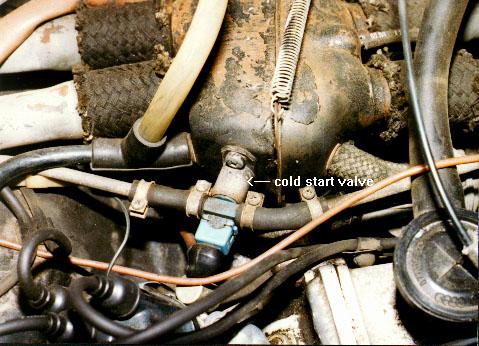

Type I engines / Early Type IV (early bay - 1968-1971 and european Type I - 1979 - and carbureted Type IV 1972-1974) be sure you
Use Cloth Braided Fuel Line - NOT rubber Fuel Line.
Make sure to remove any fuel filters from the engine compartment.
Type IV engines (late bay - 1975-1979) make sure you use cloth braided REINFORCED lines - NOT Cloth Rubber Fuel Lines - they sell them for the Porche Fuel Injection systems.

What's up with the cloth? I've got reinforced rubber FI lines

The cloth ones insulate from heat. The rubber - while reinforced is not designed to operate in the temps that CAN happen in the Air Cooled engine compartment. Think on it - the heads themselves - if you are going up a HUGE incline - may reach close to 400 degrees. Melt City! The cloth helps stop that from happening.

Furthermore I am not sure I have ever seen externally braided FI hose, none that I have bought from my Portland VW supplier has ever been externally braided and certainly none that I have bought from NAPA or other chains. As for underhood temperatures, the Bay window bus has the lowest normal temperatures of any vehicle that I am aware of, the entire engine compartment is on the inlet side of the cooling air stream. All engines are capable of putting out a lot of heat just as much and likely more than a T1 or T4, a couple of years ago when my then teenage daughter blew a water hose on my WBX and then drove the 11-13 miles home it melted the thermostat housing and all the wiring near the head, but the fuel line did not let go or even appear damaged.
On a carbureted engine I will agree that externally braided line has a history of giving better service than smooth line, not because the external braid is inherently better, but because the normal stuff sold by FLAPS once tended to be of dangerously poor quality. The quality of regular smooth fuel line FLAPS sell does seem to have improved markly over the years though.

The FI fuel line is re-inforced internally, and you can see it in the cross section. The advantage to using this is the condition of the hose is easily verified, where the cloth braided hose hides the condition of the actual hose inside, (ie. cloth braided hose "looks fine" but could be dry & cracked underneath).
The FI line costs a bit more, but so does having your bus go up in flames.

When VW people speak of braided fuel lines I take that to mean an external cloth braid. Most if not all rubber FI rated line has internal fiber reinforcement, and has very high quality rubber. The line you want to use on a FI engine will say for use with fuel injection, it will cost you somewhere between $5 and $10 a foot. If it doesn't say for use with FI do not use it. Don't depend on the vendor to hand you what you want, read what it says on the hose.
Regular smooth fuel line will also have an internal ply and may be rated as high as 200 psi which is well above the pressure of a T4 fuel injection system. This hose may have sufficient strength to handle that kind of pressure when new, but the quality is typically lacking and it will age rapidly. Again if it doesn't say for use with FI do not use it on your FI engine.
For carbureted engines the externally braided, cloth covered fuel line has a history as being of good quality, many rightfully choose to use it. If you are going to use smooth fuel line at least don't buy it from Home Depot or a hardware store. I don't go to my local auto parts to buy lumber or toilet brushes so why would I go to a HD to buy fuel line.

The cloth covering was not intended as a heat shield. It's purpose was to prevent 'chaffing'. I only use it on the hose going thru the firewall. The rest of the hoses are reinforced FI hose 'Goodyear'. I just recently replaced all the hoses after six years of running the same type hose and the Goodyear hose held up better than the braided hose when twisted 180 degrees, no cracks.
