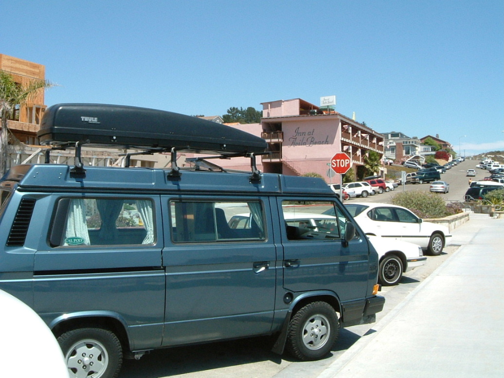

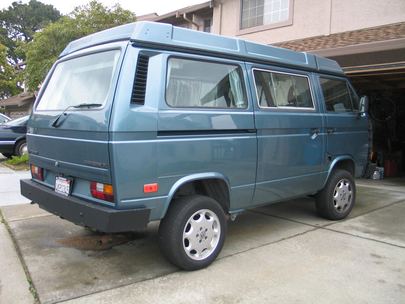

PostPosted: Sun Jan 06, 2008 2:56 pm    Post subject: Pictures of 2WD springs installed.... Reply with quote
Here are some pictures of my '87 Westfalia with the GoWesty 2WD springs intalled:
https://www.thesamba.com/vw/gallery/pix/405640.jpg
https://www.thesamba.com/vw/gallery/pix/405642.jpg
https://www.thesamba.com/vw/gallery/pix/405641.jpg
Today when I was taking these pics I noticed that GoWesty did NOT install an extra shim on the left rear spring to compensate for the "Westy Lean", which was there previously. But because these springs are a bit stiffer than stock, the lean isn't as noticeable. Still, if you have GoWesty do the work, you may want to ask for this extra shim if you have a full camper.
Ride height as measure from wheel centerline to fender lip is as follows:
Front: 18.5"
Rear: 18.5" (slightly less on the left side as previously mentioned)
